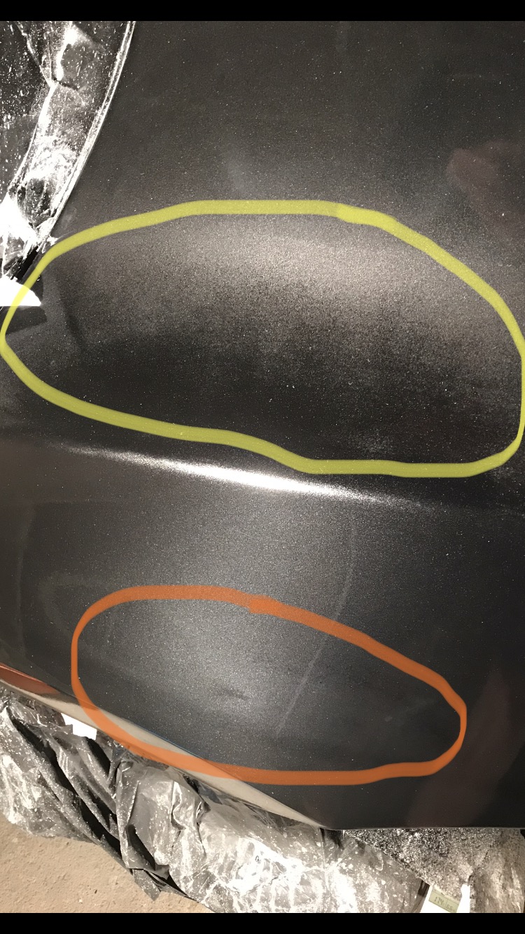

I sanded with 1000 grit a long way back from the repair area first then masked up the car.

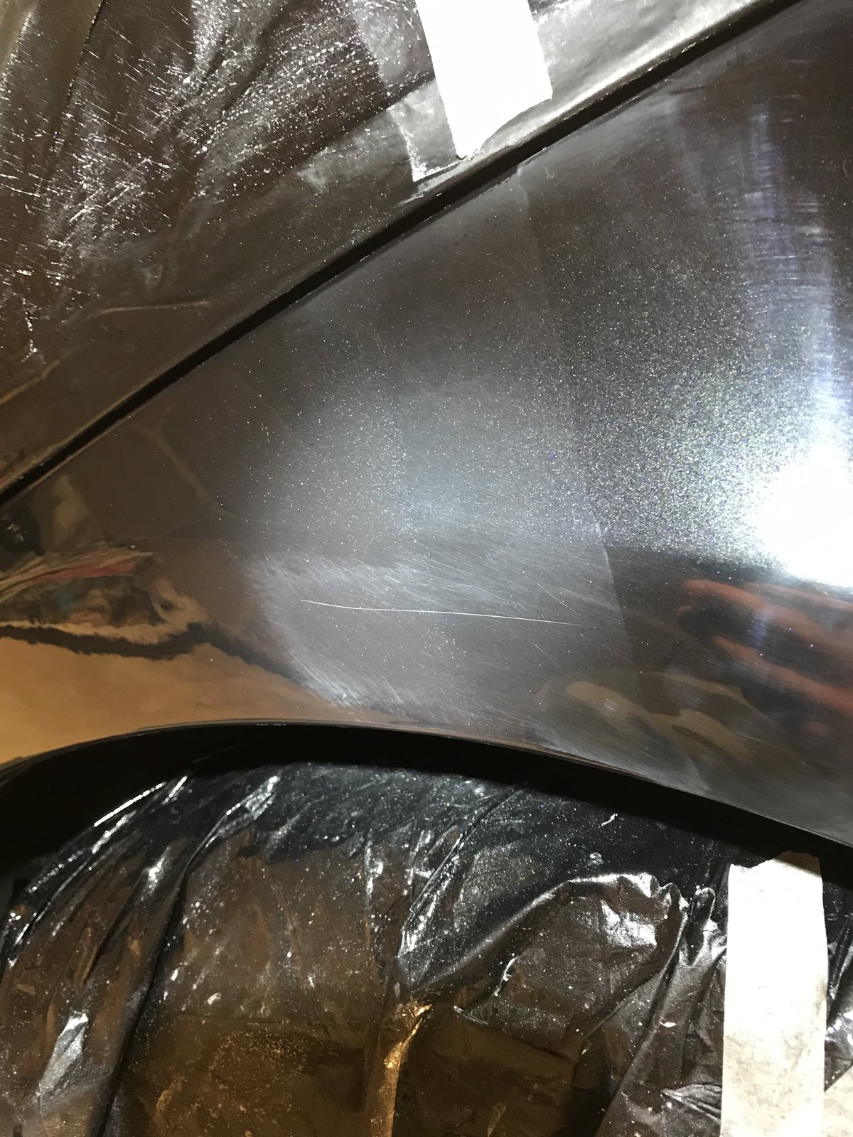

A few coats of base coat applied with gun facing away from the masking, the colour match looked good.
Masked up again a bit further back with a soft edge.

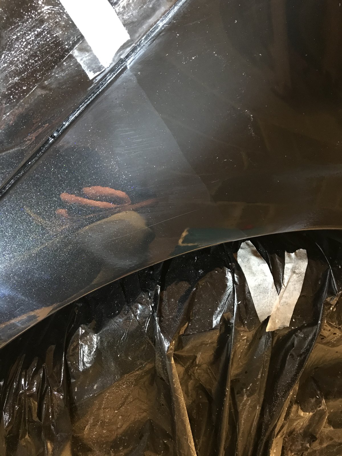

Two coats of clear again spraying away from the masking, it had a bit of orange peel but nothing that couldn't be easily sanded out. I hit the dry edge with a bit of blending solvent but not sure that it was a good idea as it almost created a run that I needed to take off with a tungsten stone.

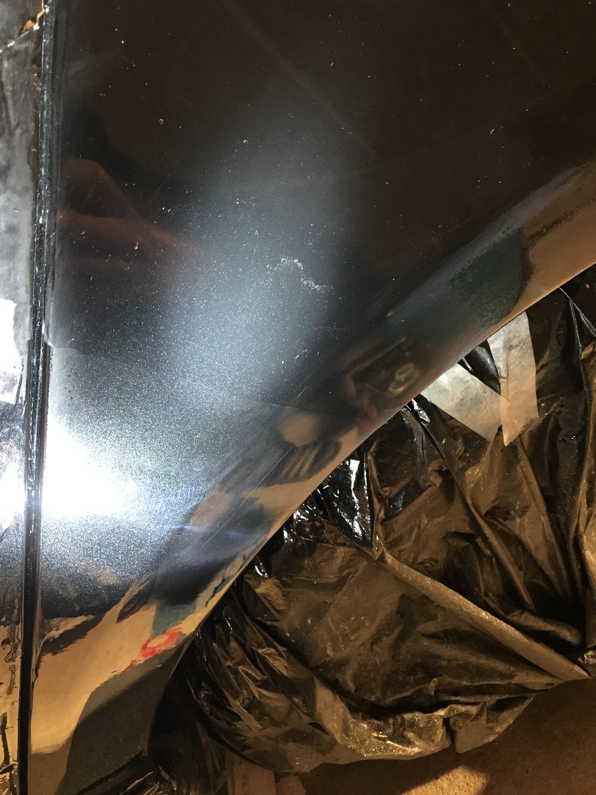

There was still a bit of a dry edge around the edge of the new clear that doesn't show up in the picture but after sanding and polishing it was perfect.

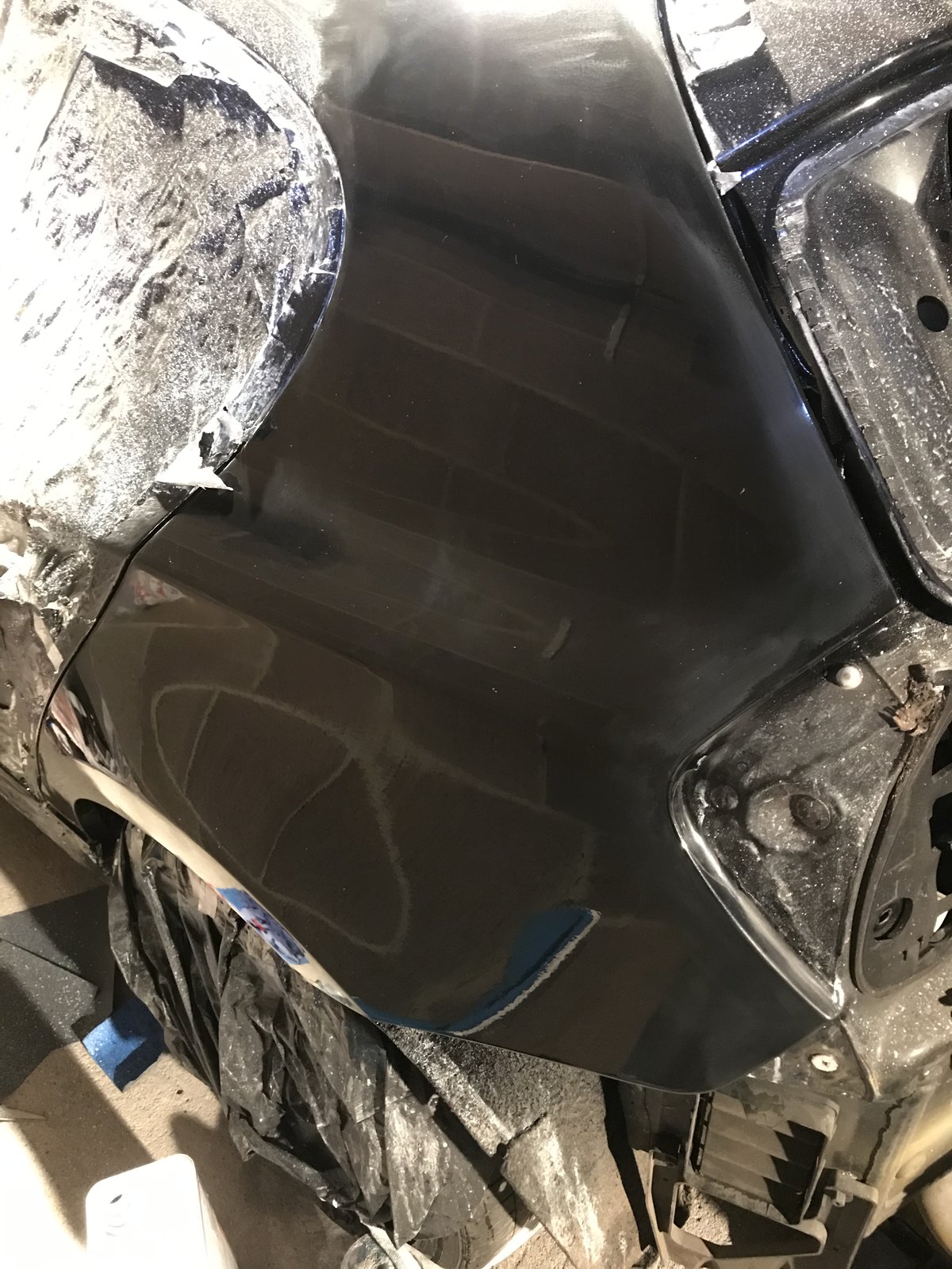

One year on it still looks perfect.
