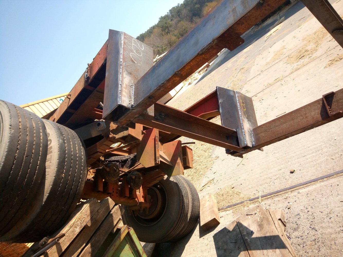

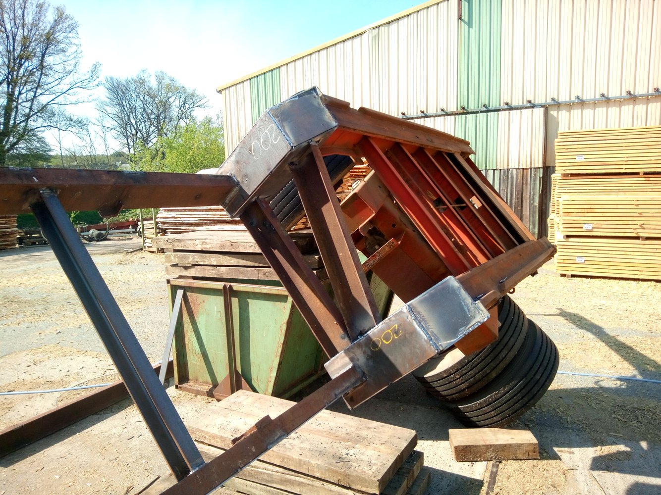

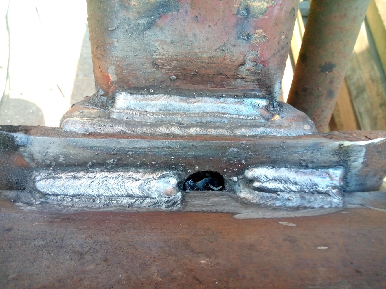

Diagonal cross X, in C or H section at the drop down, and triangular gussets.Just a thought - a few diagonals might not go amiss

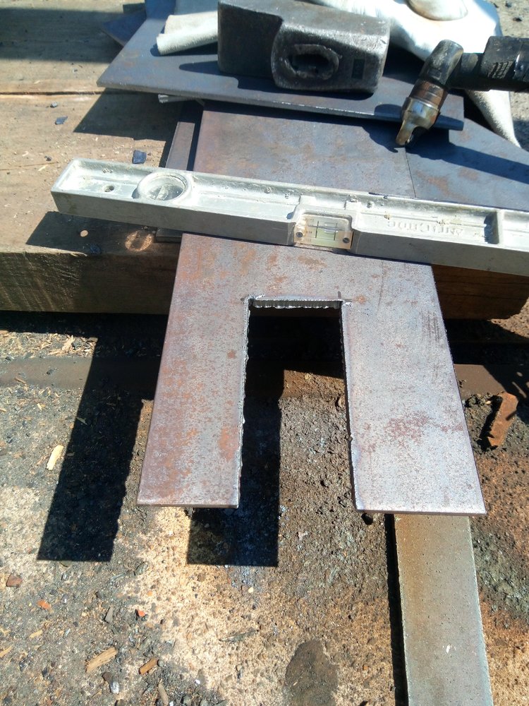

Yep, metals ordered, and on its way.Cap that bit of UC off will probably help too. It's not great against twist.

I was thinking anywhere in themain long chassis - stop it lozenging . . . if that's a real wordDiagonal cross X, in C or H section at the drop down, and triangular gussets.
Work in progress.
We've got some bits, working on a cunning plan.I was thinking anywhere in themain long chassis - stop it lozenging . . . if that's a real word

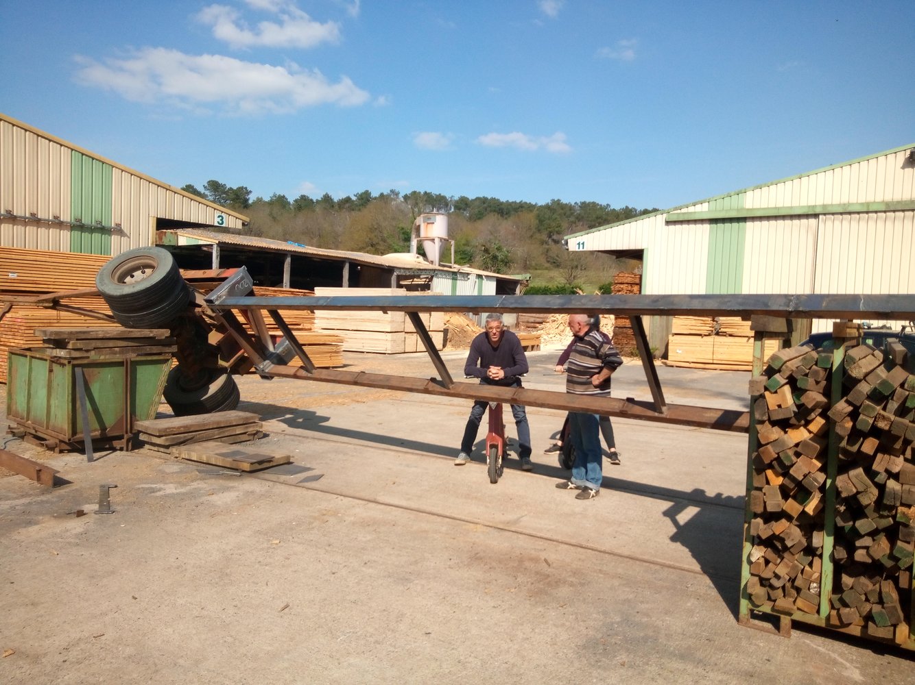

Its alway's going to flex at that length, so doesn't to be too stiff, of it'll bust welds somewhere.
Totally agree, but 35 cm rods. D'oh.Try an keep your runs the full length of the joint, even if it means a fresh rod. Lots of stop starts should be avoided especially in a stressed application like this.
No, me neither, he's been told to paint it grey.Coming on well.
I do not envy stripy top man.

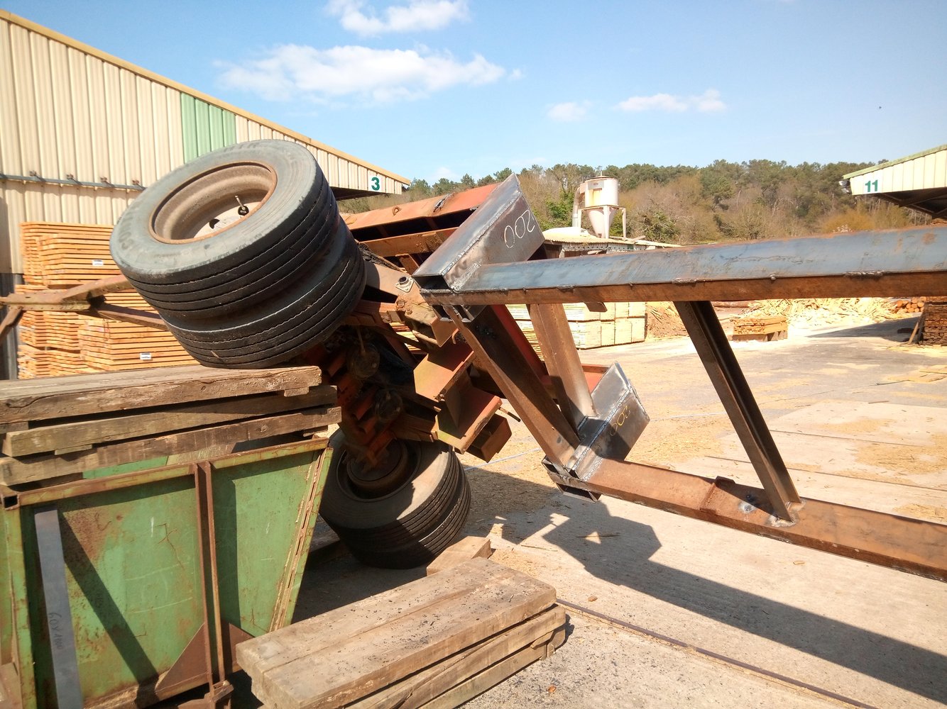

That’s one heel of a projectOther half of the X brace tomorrow, flick it in the other sense, and I think I'm done.
Yeah.. Thanks.That’s one heel of a project

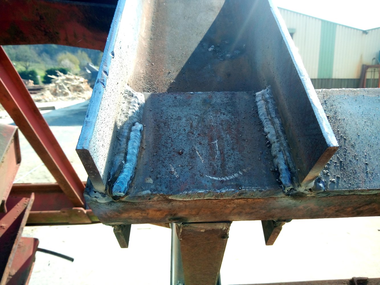

One can but try, and do ones best, God knows my welding improved, but I can still see where I've fluffed up. Honestly never done that much electrode sinking into metal before. Interesting, another couple of weeks and I might have nailed arc welding, but I've only ever used 6013's so should probably exp element with other flavours, and some issues with undercut when filleting? Position ? Too many amps?Nice work , interesting read and cool project to be involved in
