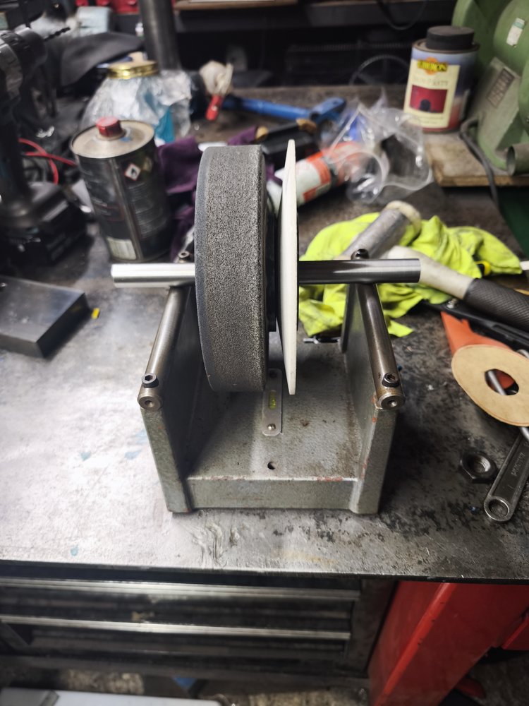

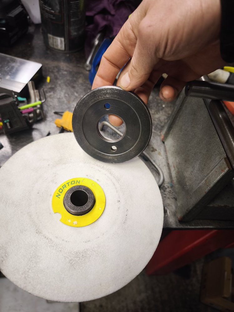

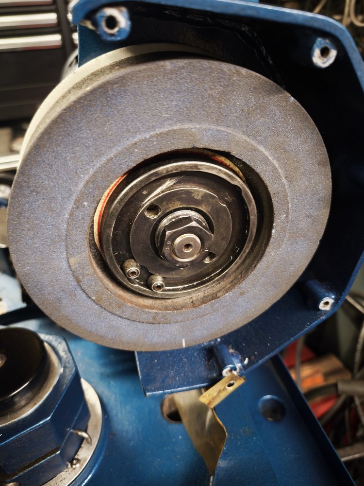

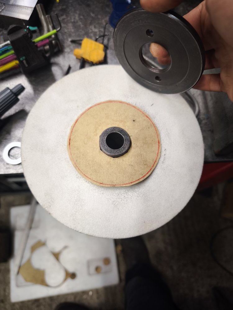

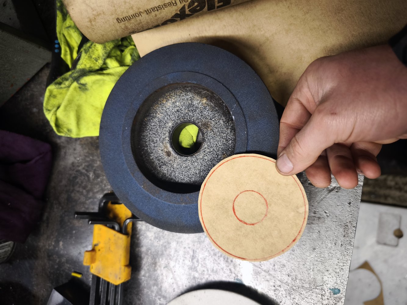

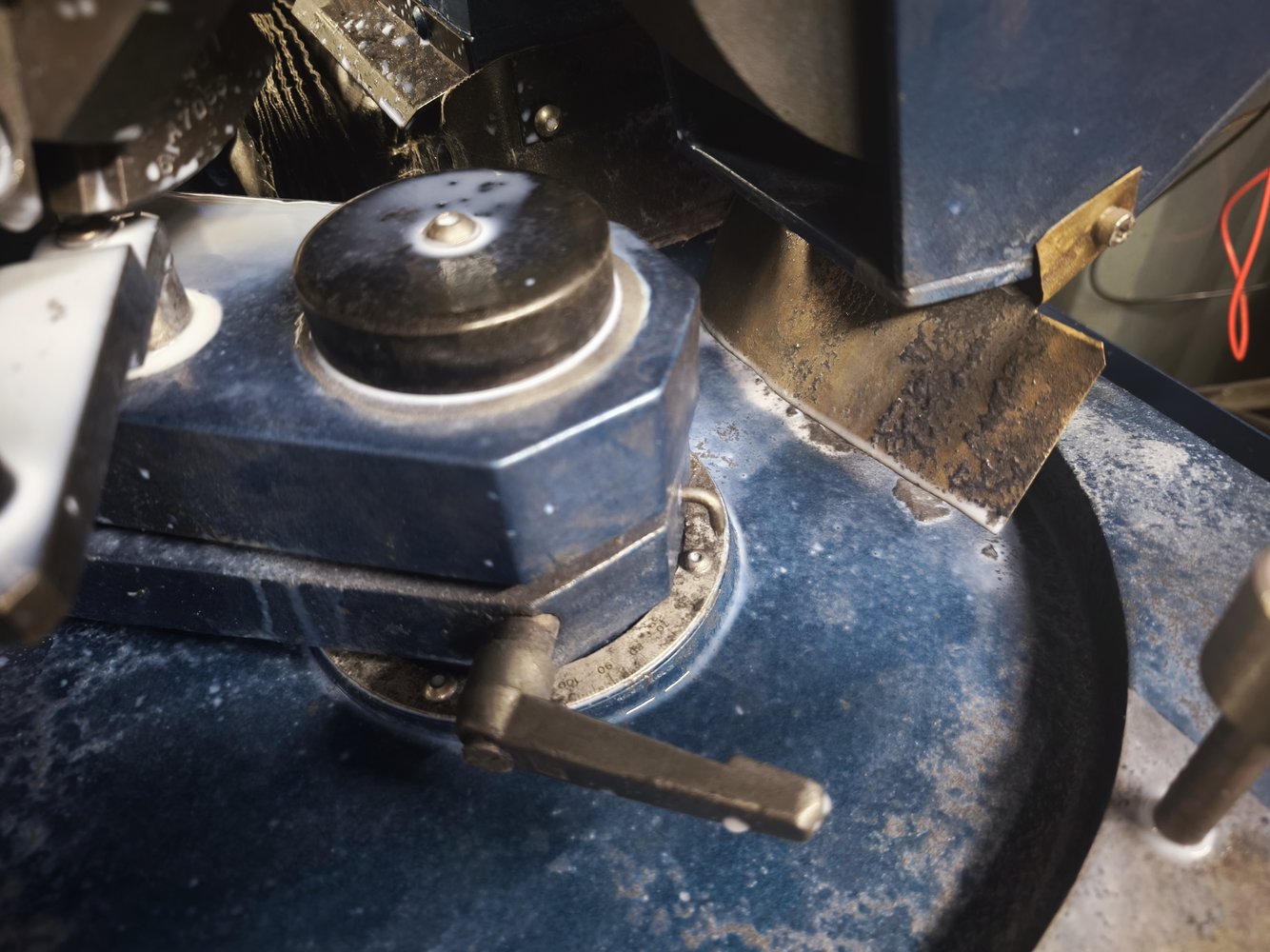

Today I finally got around to the Brierley again.

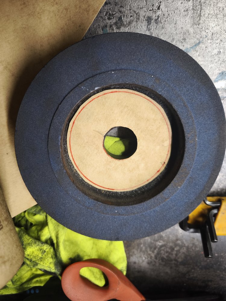

The main grinding wheel had missing paper blotters. I made some new ones out of gasket paper.

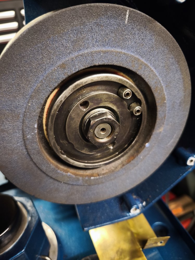

The dish wheel I bought a while ago still had its blotters but one of them did not make contact with the large nut/flange due to the cup of the wheel.
I also made a blotter for that.

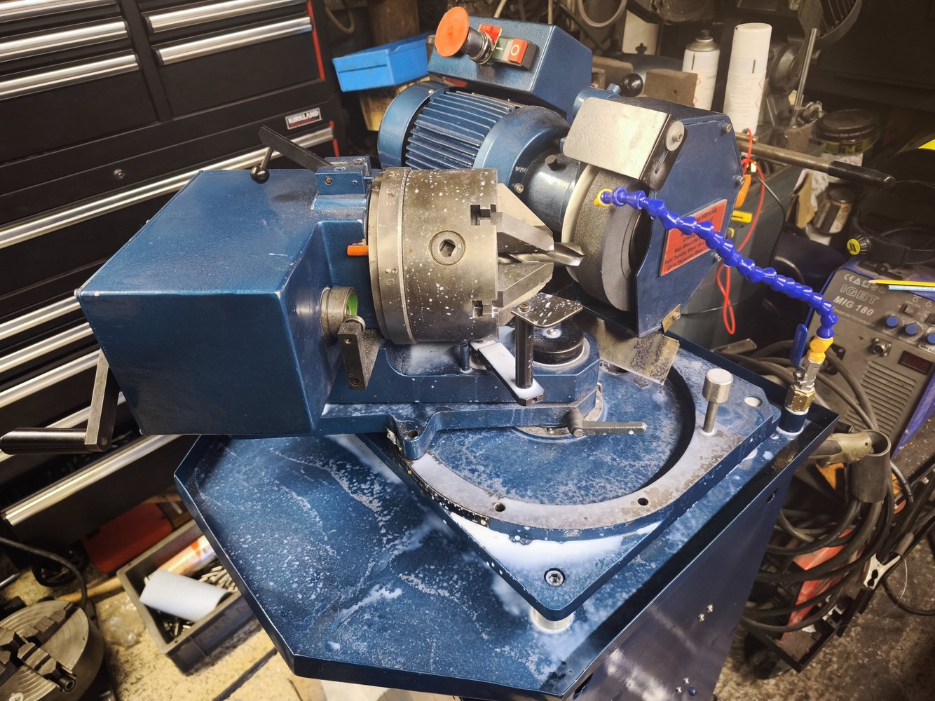

The next problem was that the dish wheel was now too thick and when the wheels are mounted on the motor shaft, the large nut was rubbing against the outside of the bearing and bearing retainer.
I required a washer the same ID and OD of the wheel arbor/shaft.
The one I made was too thick which meant the nut securing the wheels on the shaft was only engaging on a few threads.

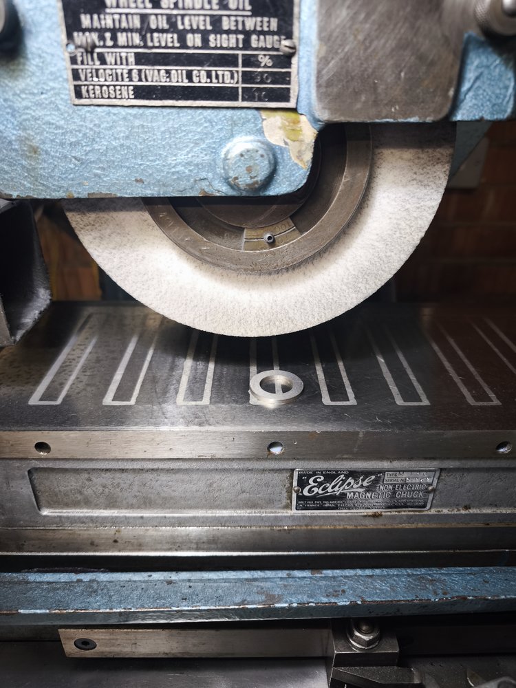

I ground the washer down on the surface grinder.
A better fit

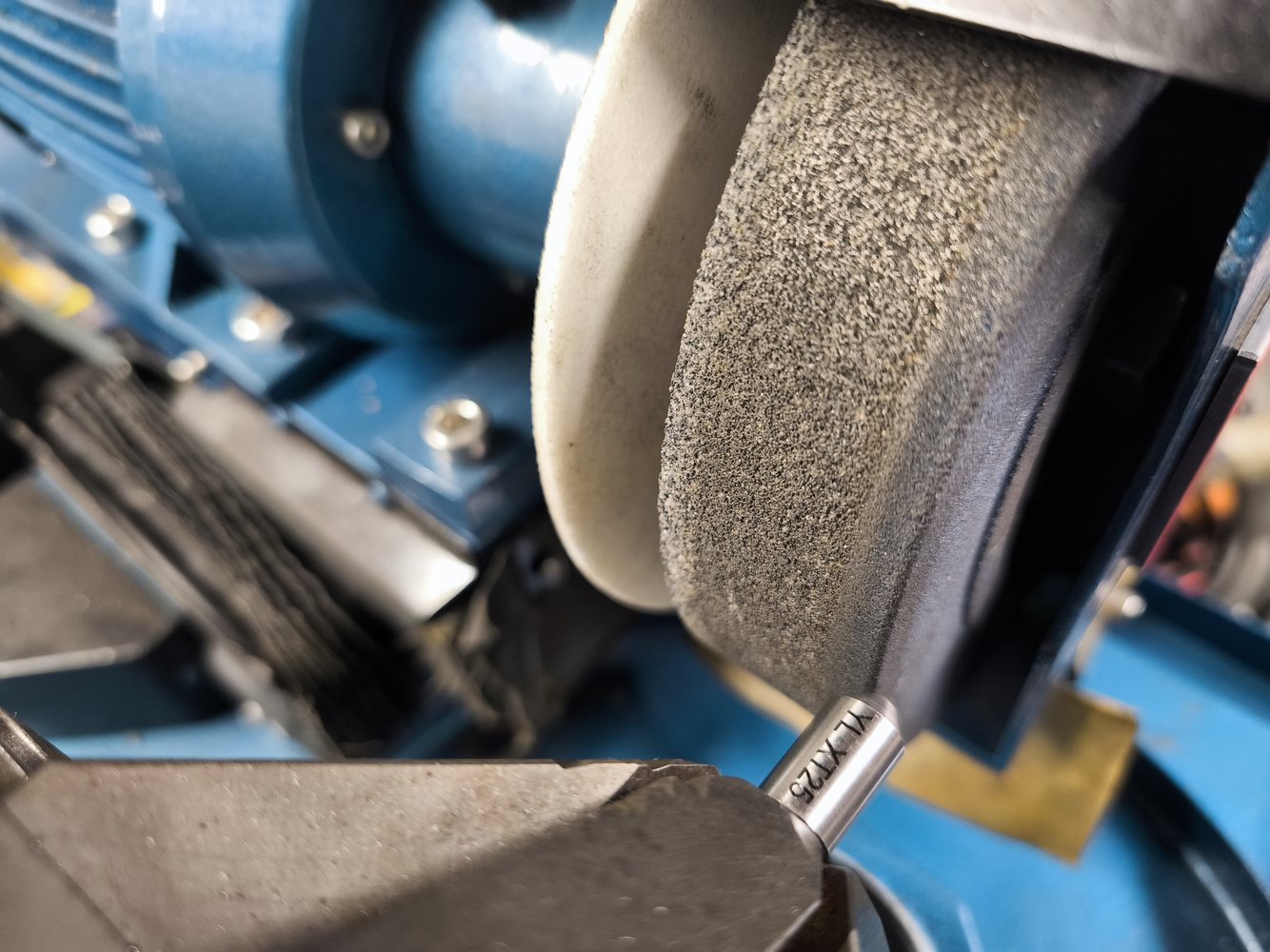

I then balanced the wheel. It took quite a while to get it just right.
