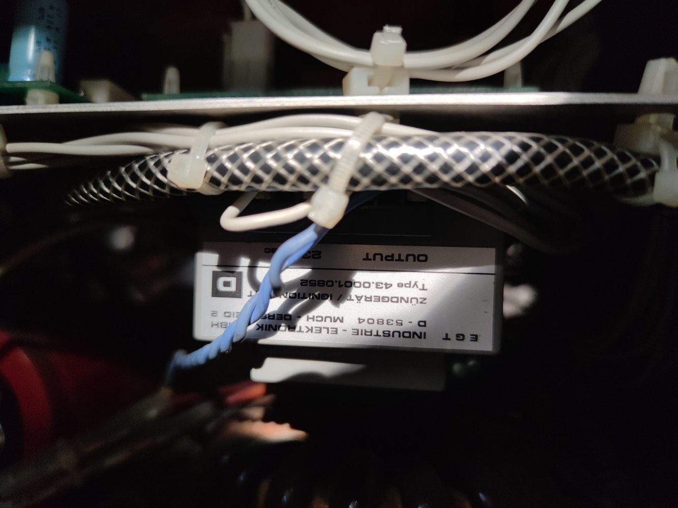

where is it mounted? on the right side behind the cover?Can you measure 230V on the in side of the HF unit (the grey box, labelled EGT SIG..., mounted downside up) when pressing the trigger.
These units sometimes fail. You can get these from EGT Industrieelektronik for about 120,-€ new.
