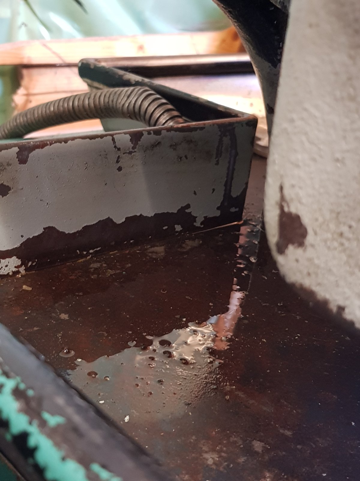

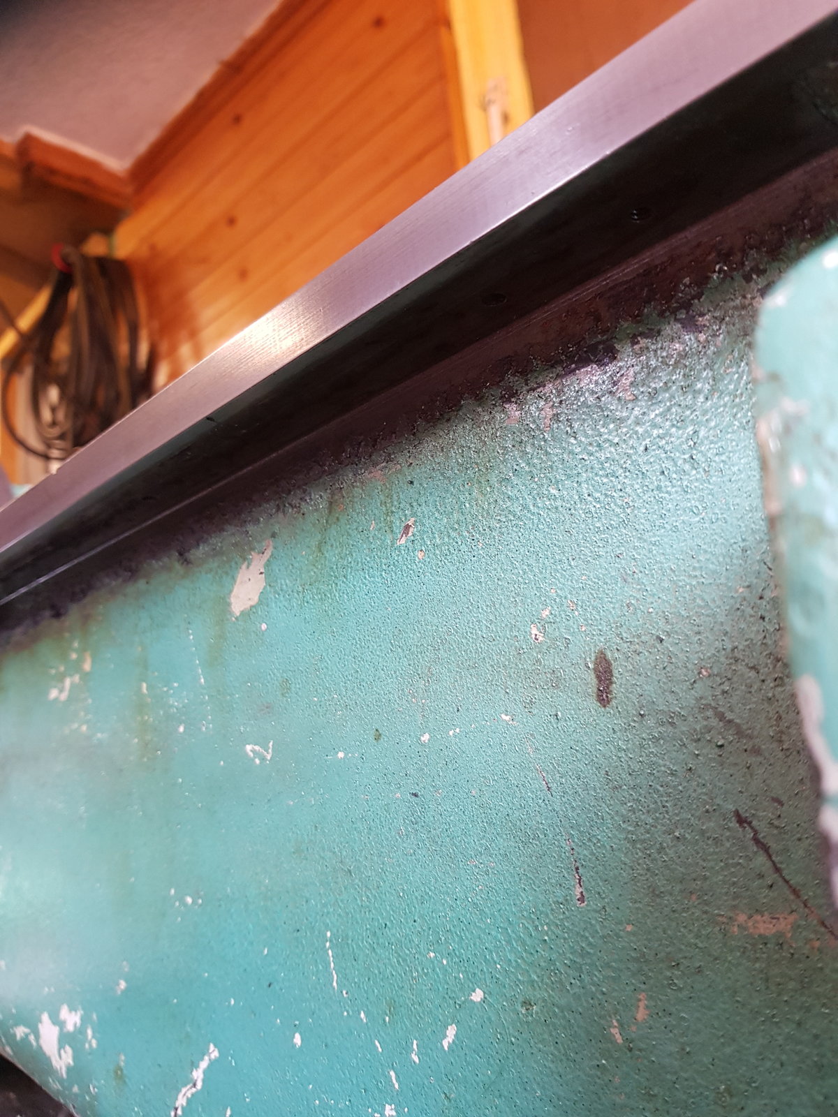

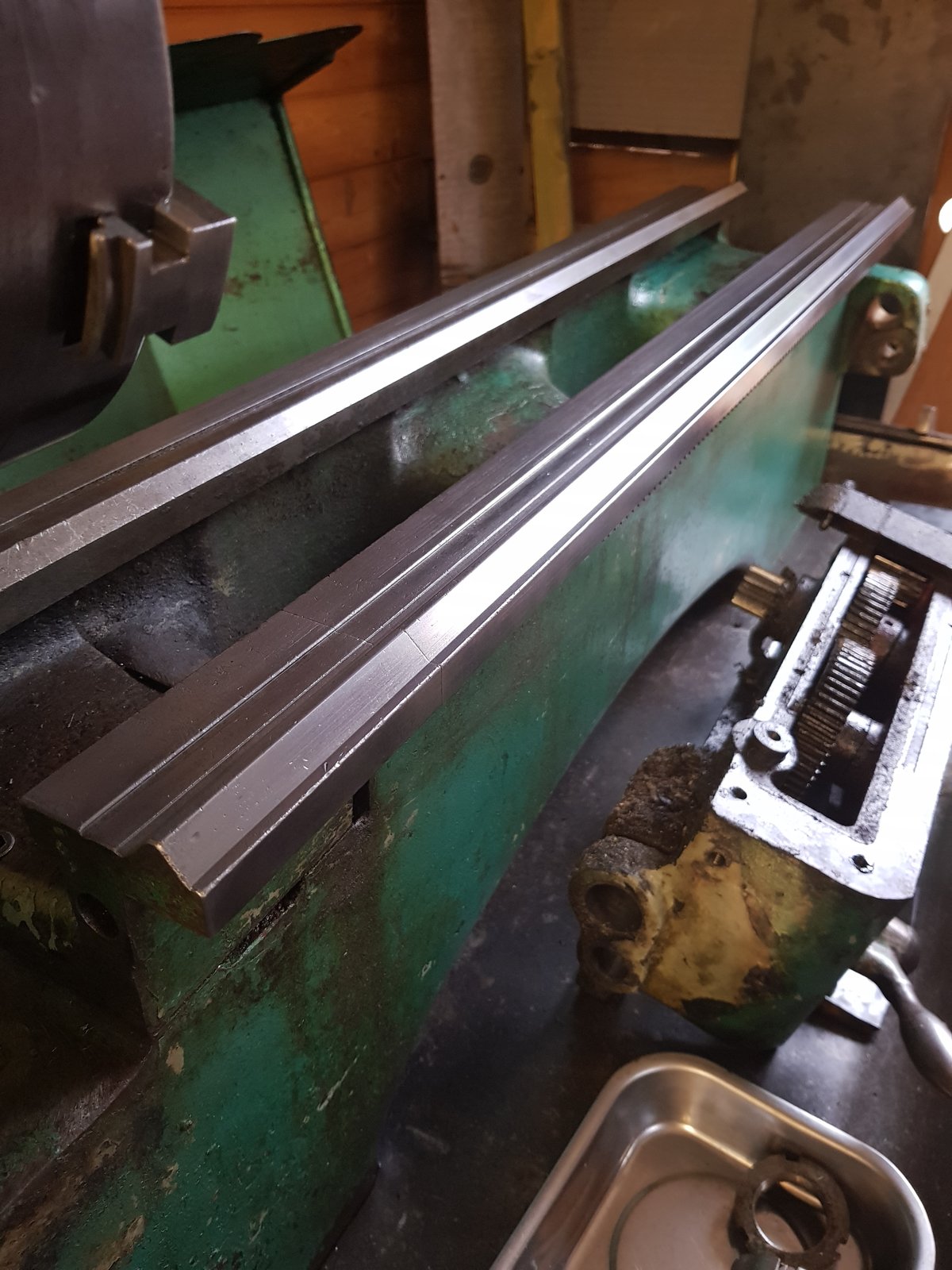

Made a start on cleaning up the lathe bed..done one side and will do other side tomorrow.

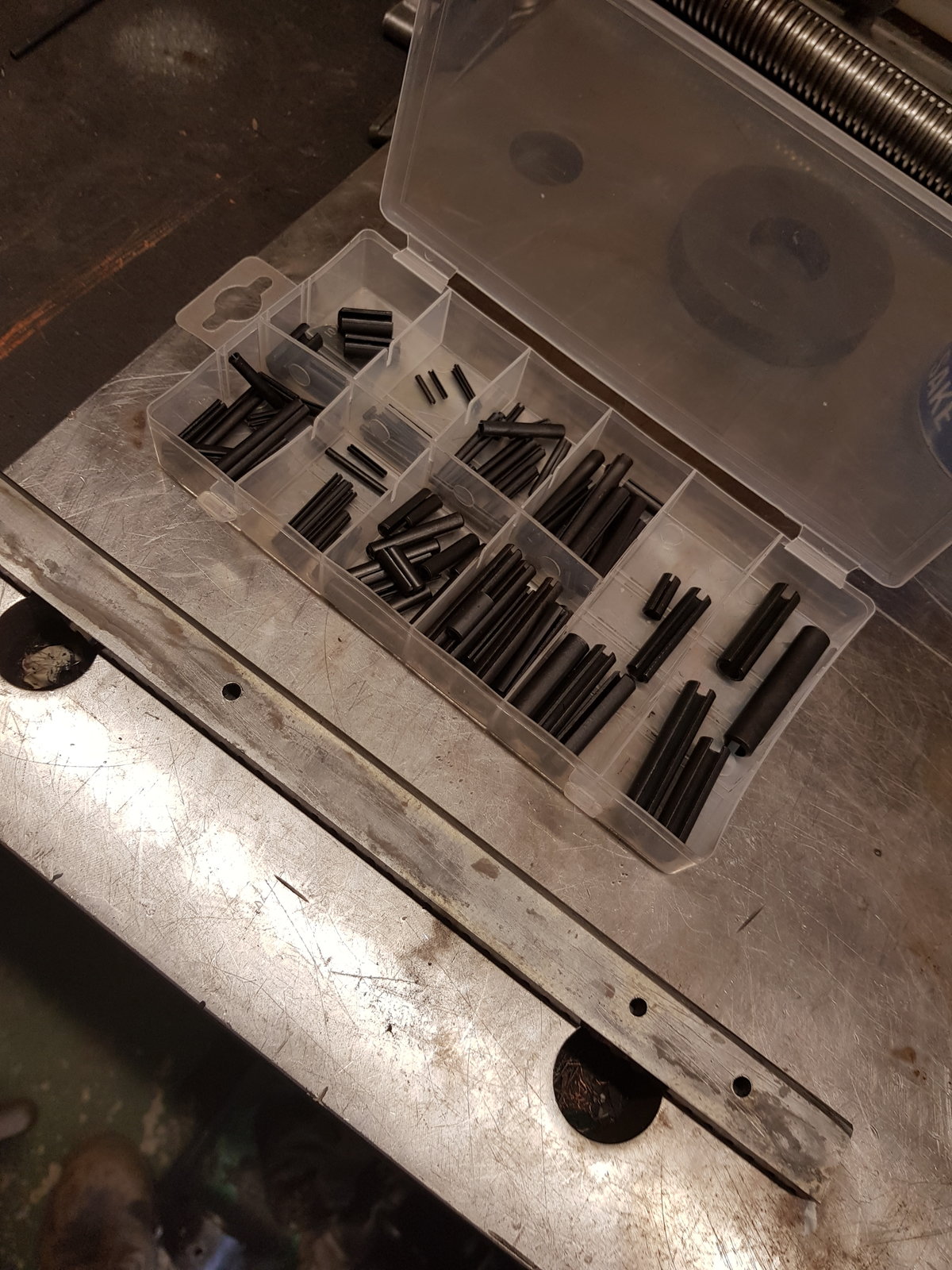

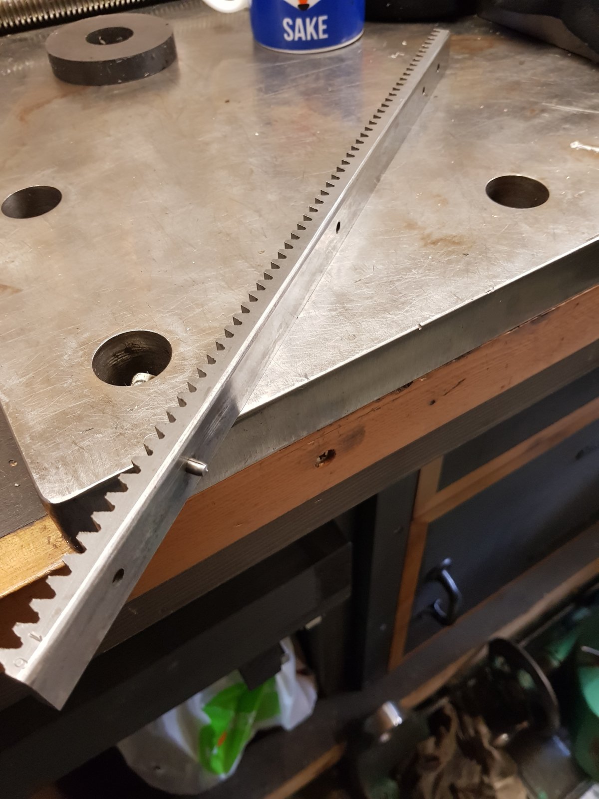

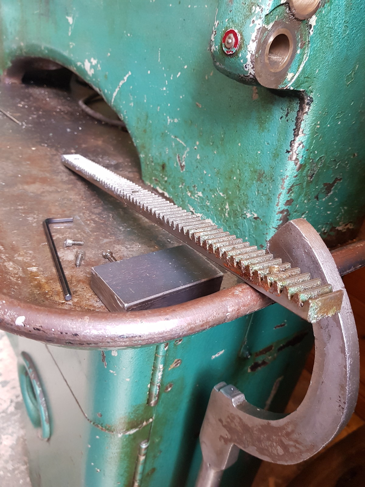

As per my offer earlier if you want a single dowel making mate it no problem.Good point guys...
You could do a proper job of it and thread the rack and make a couple of part threaded dowels.
Not something I would do. A dowel is a location and the two parts are most often drilled/reamed when in position. If you tap one side then there is a chance your tapping may be off slightly thus throwing the pin out of true. Also turning the end of a threaded section of rod could again give you small errors.You could do a proper job of it and thread the rack and make a couple of part threaded dowels.
They're only for location, so doing that is creating work for no benefit.
In something like this then it may not matter but a dowel is the method that was used and personally I think it is still the method to use.
If the holes are enlarged or out of shape so that a dowel no longer does its job then it should really be reamed for the next size dowel.

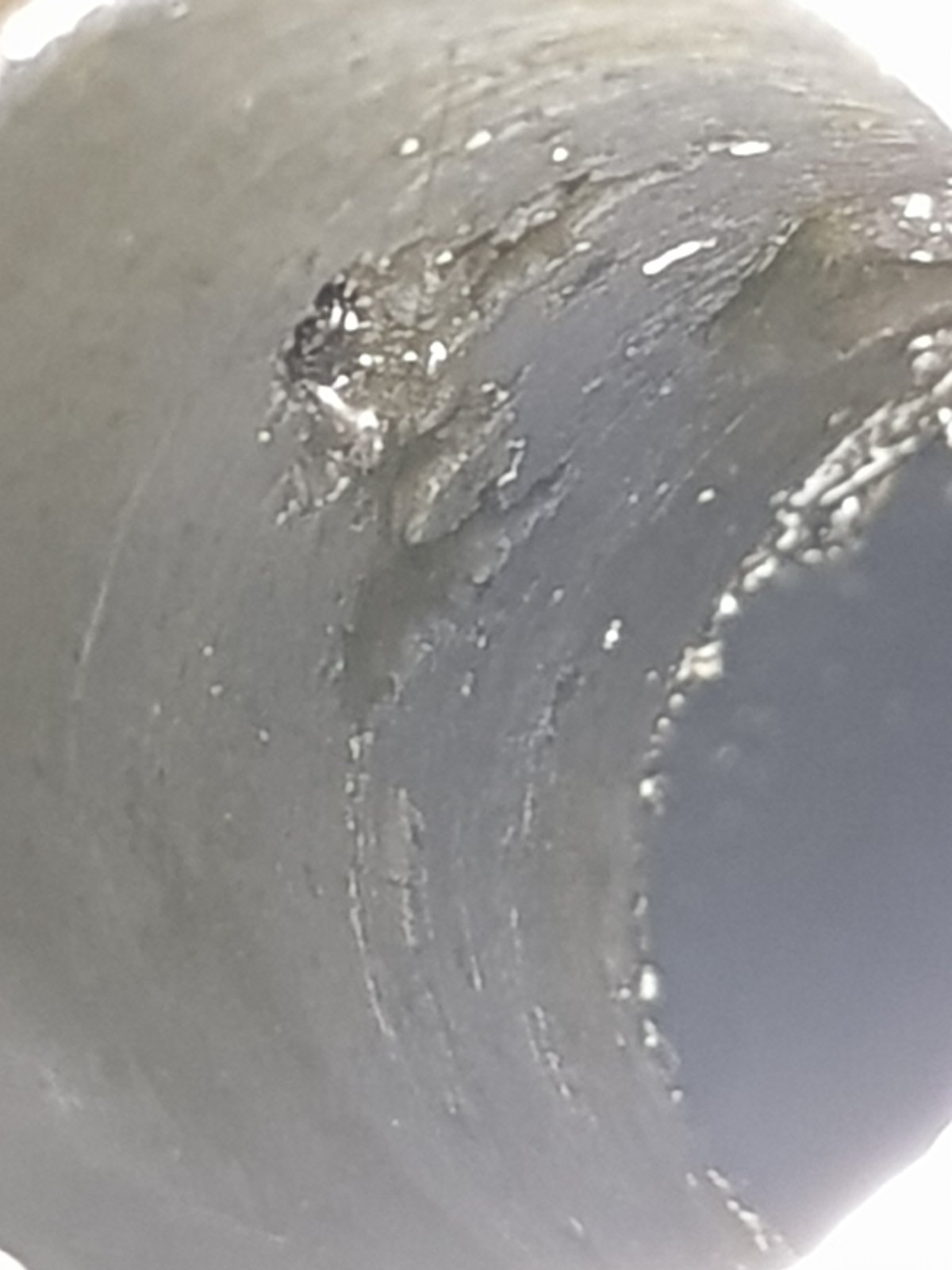

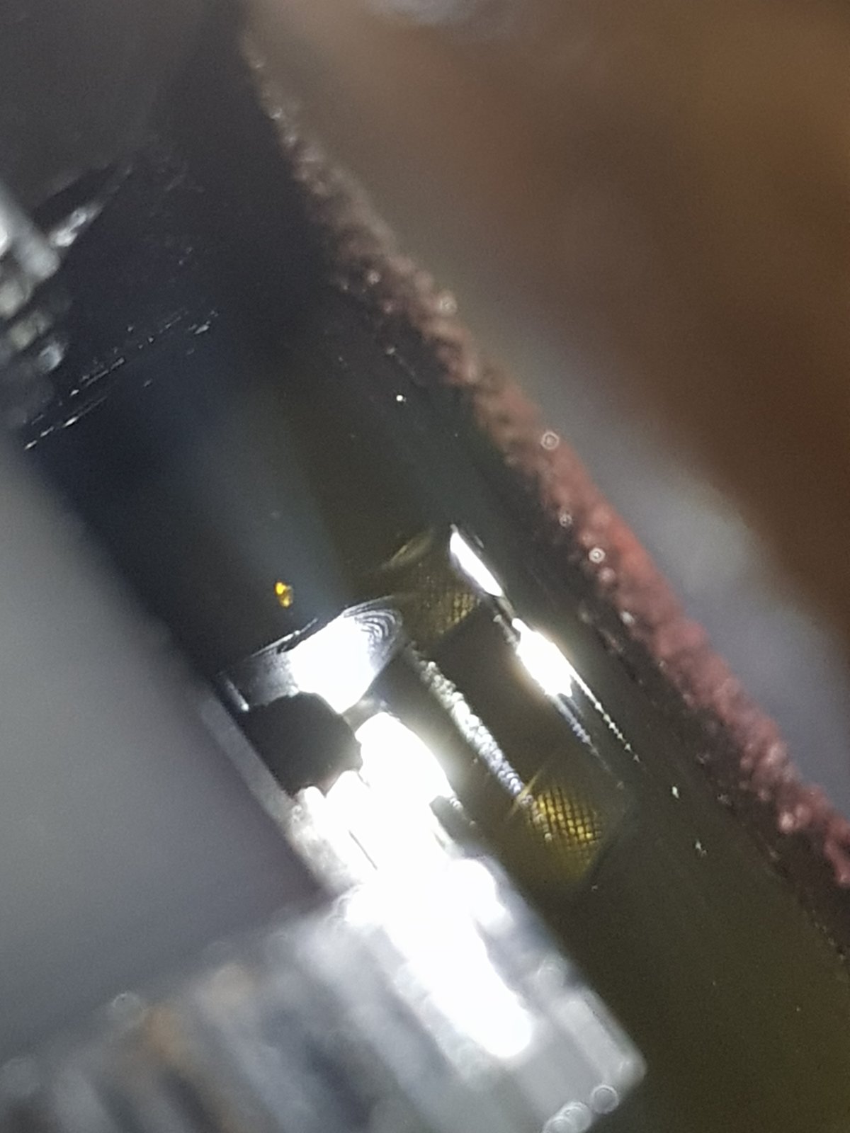

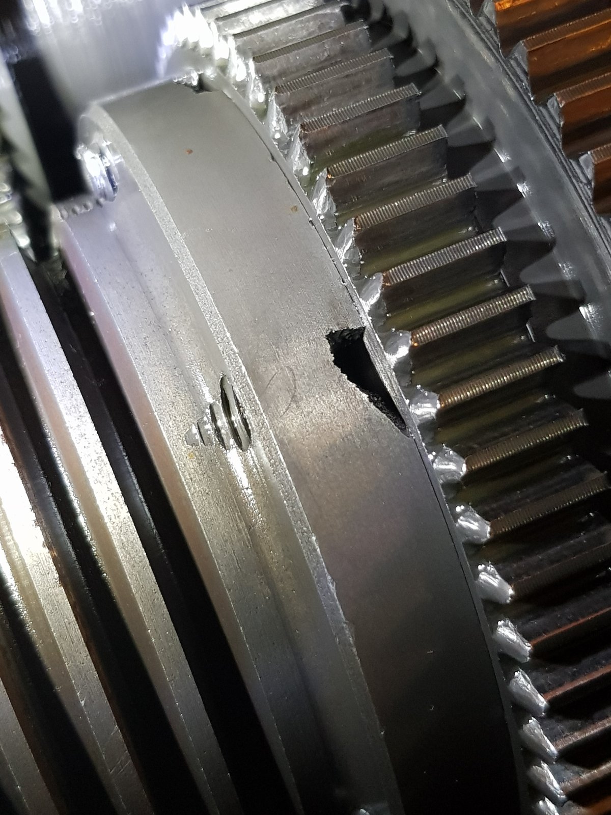

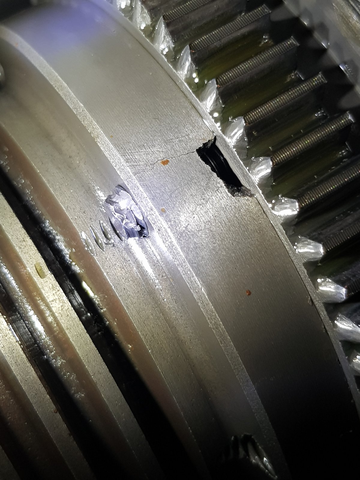

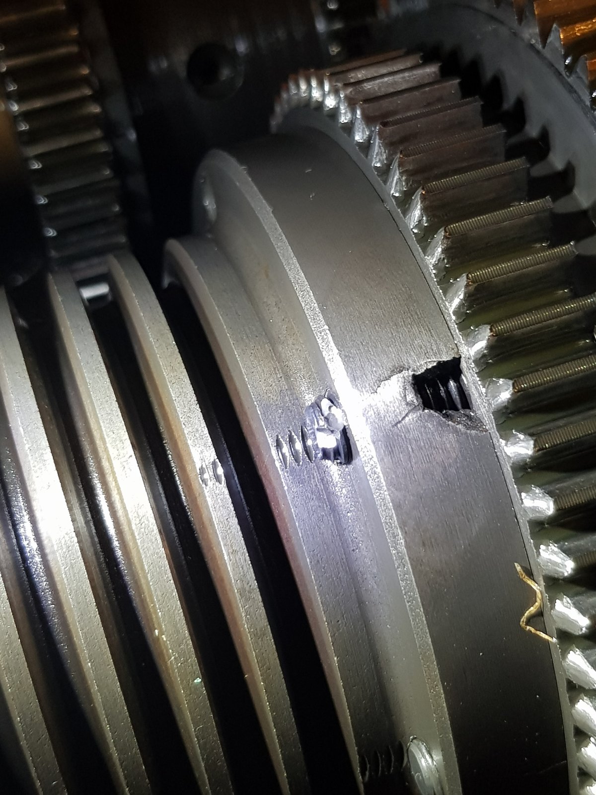

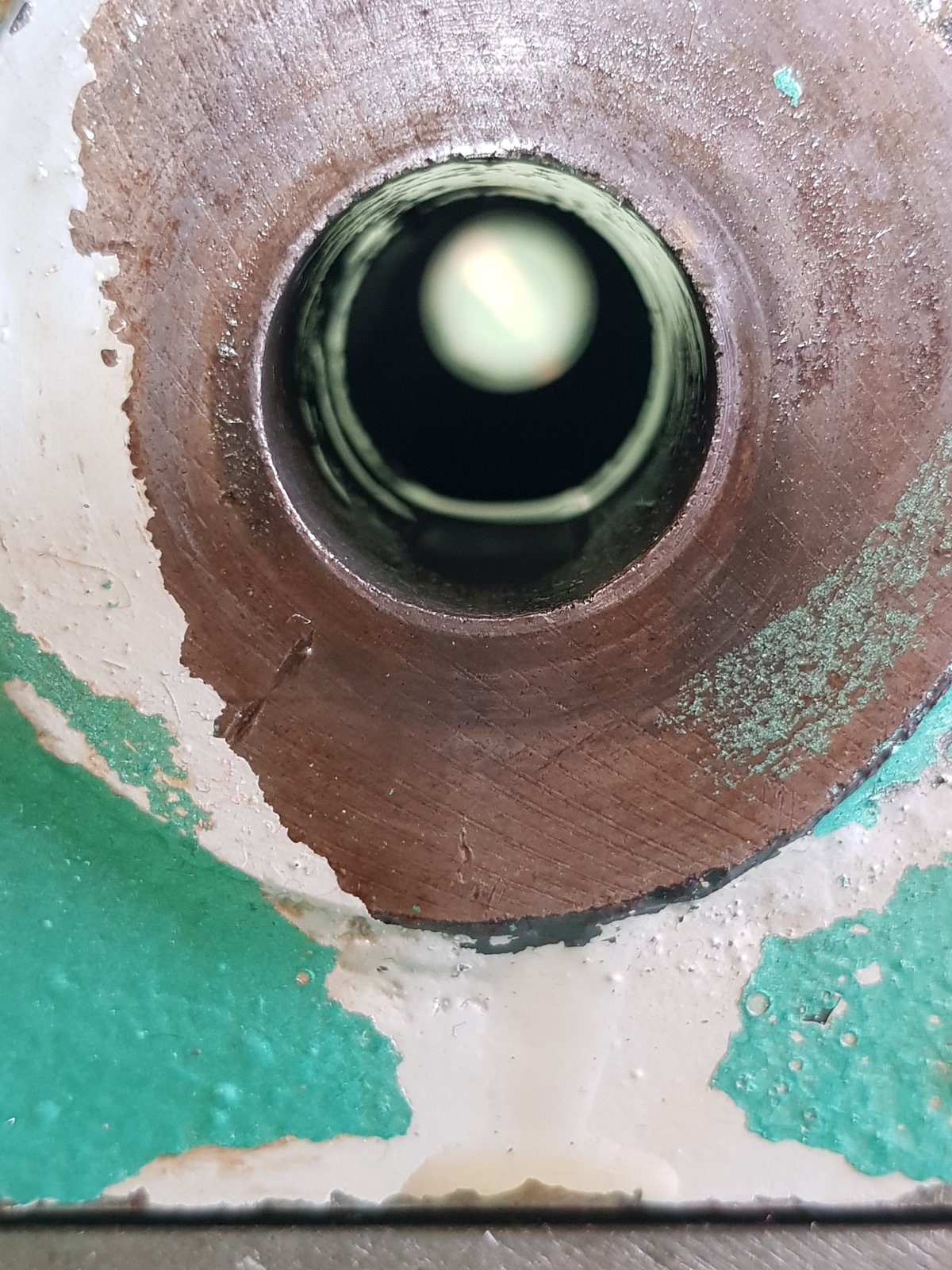

Yes it's the case that is pourous. I drained the oil out. And you can see pit marks inside. I could strip out the box and try seal it with something. Its under no preasure so should be ok. As for the gears i will have to replace that part as its fractured in a few places.Not so good on the gears, looks like some dipwad has been changing gears when in motion
They may still be ok to use though, just have to try and see.
Regarding the lever, not 100% sure what I am looking at but if it is just the casting is porous then it should be possible to give it a good clean and use some sort of plastic metal to fill it I would think.
Its all sent to try us. But i now more determined to fix it if it sits me on my ass lol
Its fractured in a few places...The teeth all look fine, I wouldn't worry too much about the gears.
