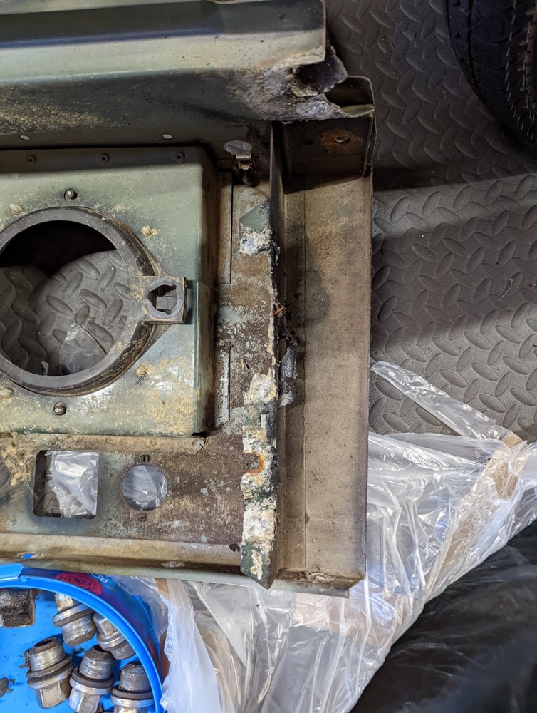

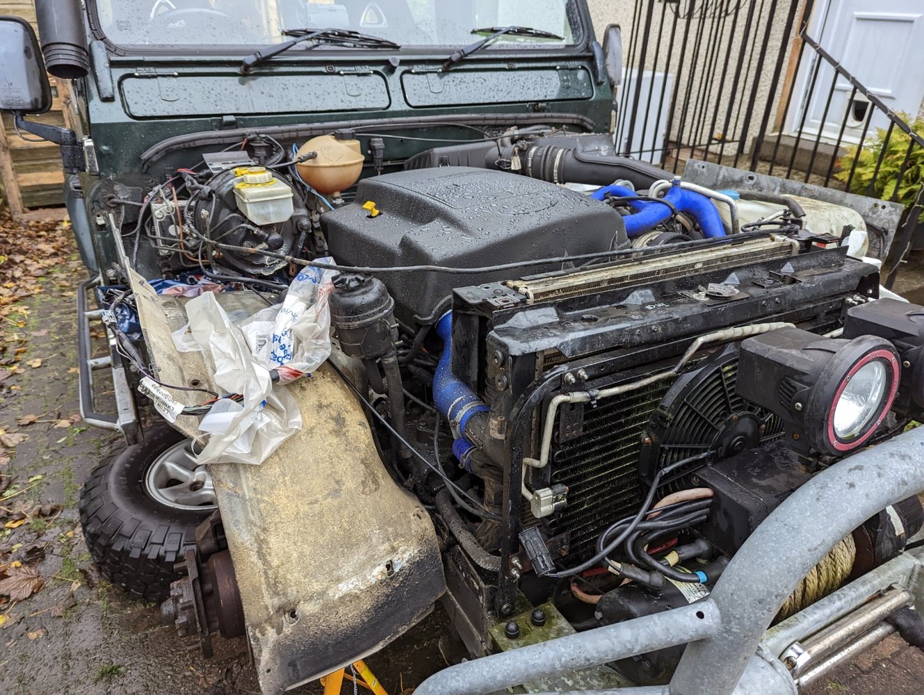

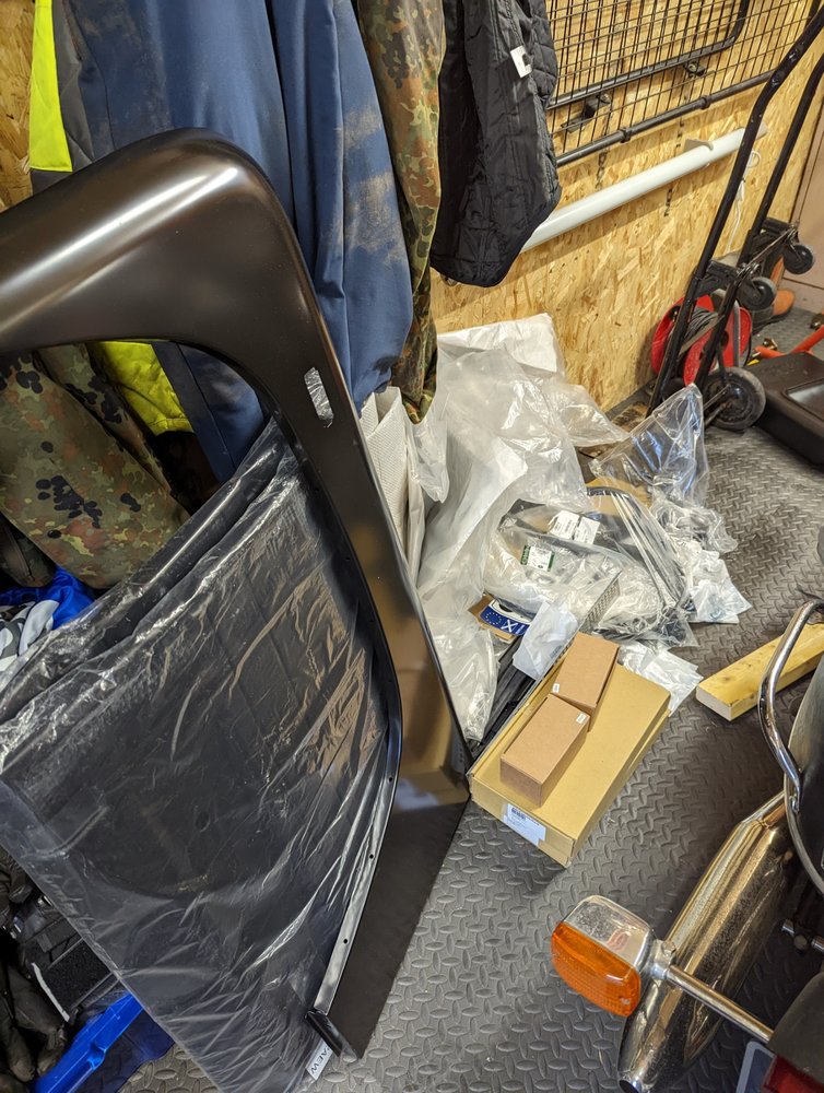

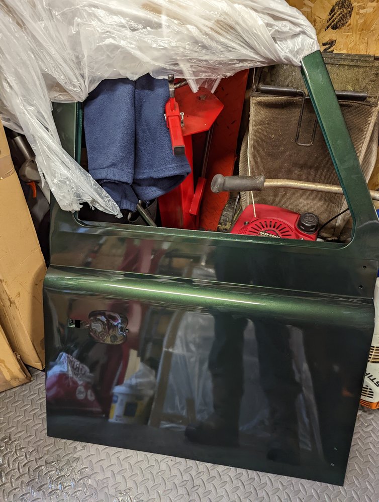

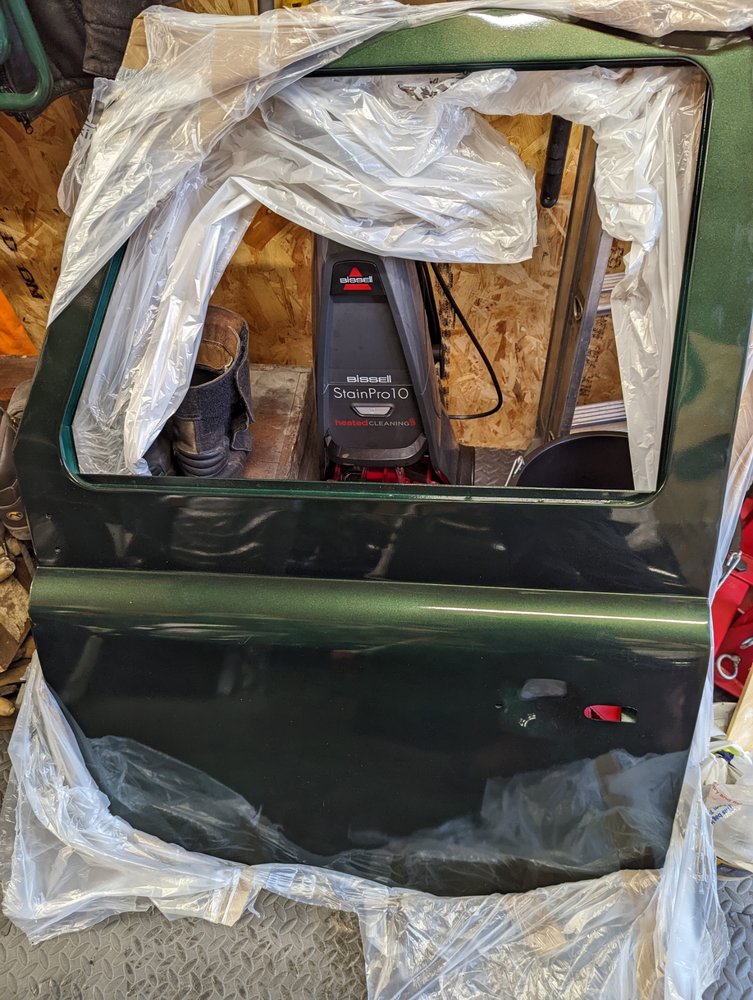

Hopefully looking at the last significant jobs on the Landy this year:
1. Front doors, the bottoms of my original doors are rotten and the aluminium skin starting to bubble, ideally I want to fit new doors: thoughts on galvanised doors from Shielder https://www.shielderchassis.com/defender-doors/ or SP https://www.sp-4x4.com/category_s/144.htm or any other alternatives?
2. My original windscreen rubber has perished, suspect worth spending the extra on an original Landrover part?
3. The lacquer is lifting in places on the bonnet and front wings, so I will have a go at spraying the doors outside and if they turn out ok I will redo the bonnet and front wings and hope the midges are not out!

, can't say I've had a problem with that seal and it's been on there for 5 or 6 years now. Just sit it in a warm bucket of soapy water whilst you remove the old one.
