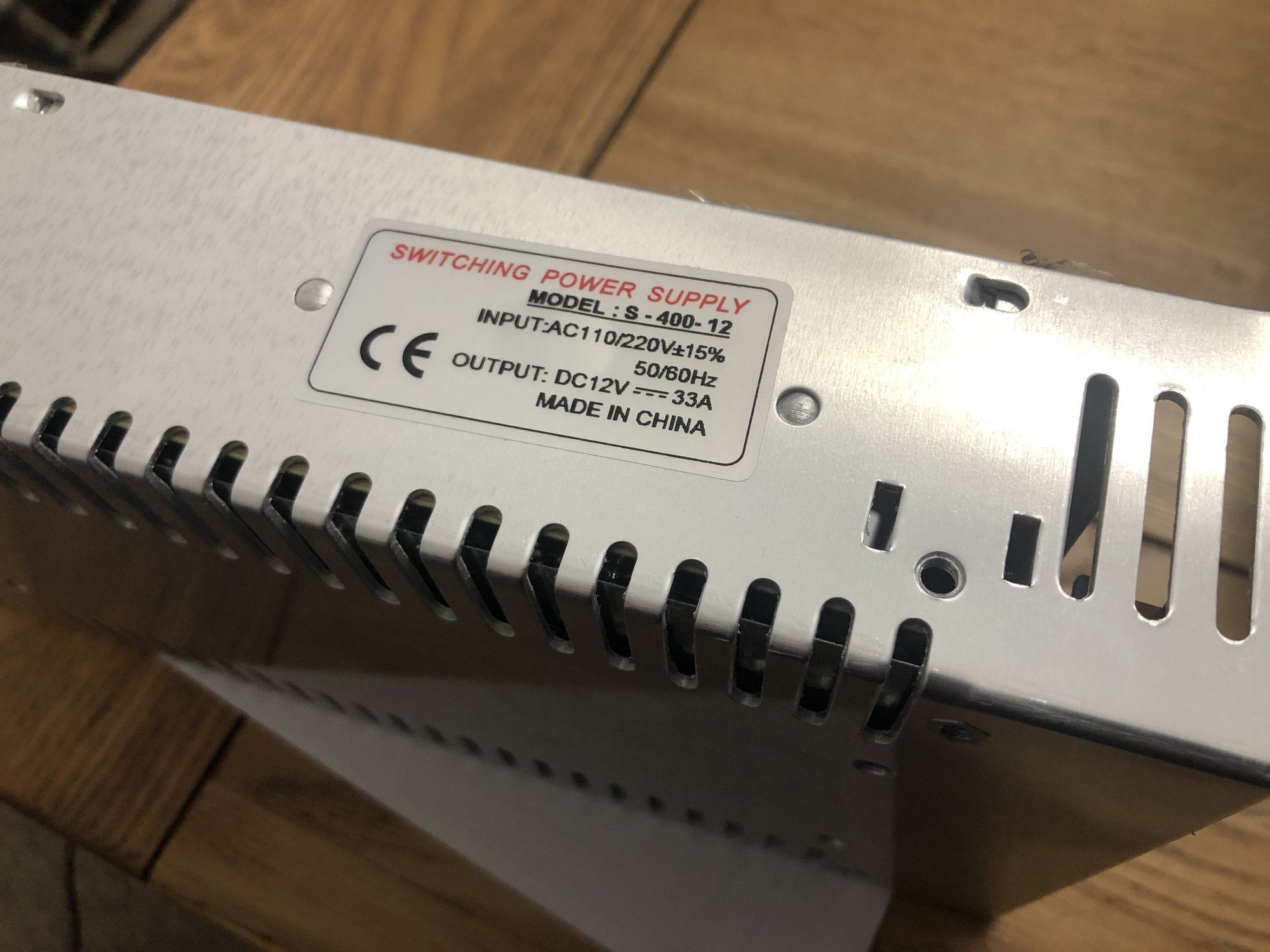

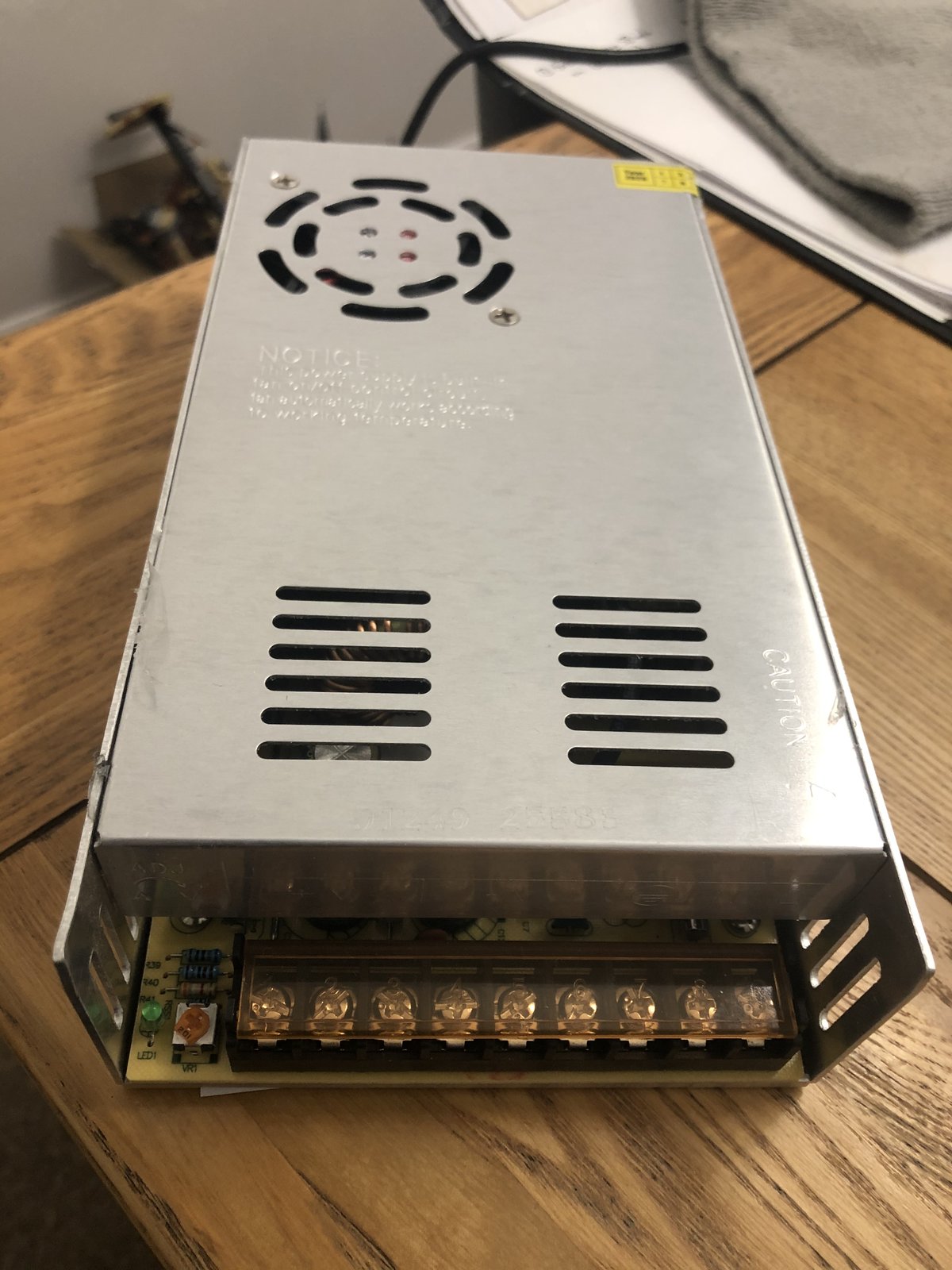

Mine came from here and delivered a couple of days after ordering - https://www.ebay.co.uk/itm/12V-Air-...e=STRK:MEBIDX:IT&_trksid=p2057872.m2749.l2649Well my power supply turned up today, just need to find a supplier of a 5kw “all in one” that is decent and can deliver before christmas ?
Any suggestions ?
Why the all in one? Seperate one cheaper and not much more faff as you need to run an exhaust etc anyway.
Spot on with that power supply. Watch all those live terminals though![]()

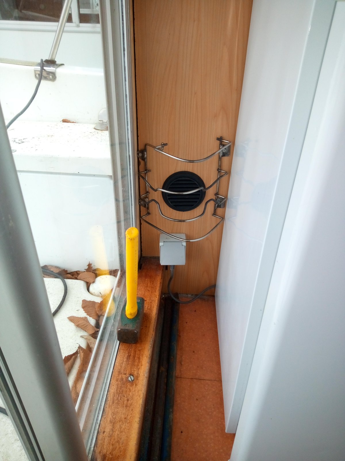

First hour it ran produced a horrible smell, provoking a throbbing headache I've bought home.
Unpleasant smell to be expected for first few hours according to the manual. Doesn't mention headache.

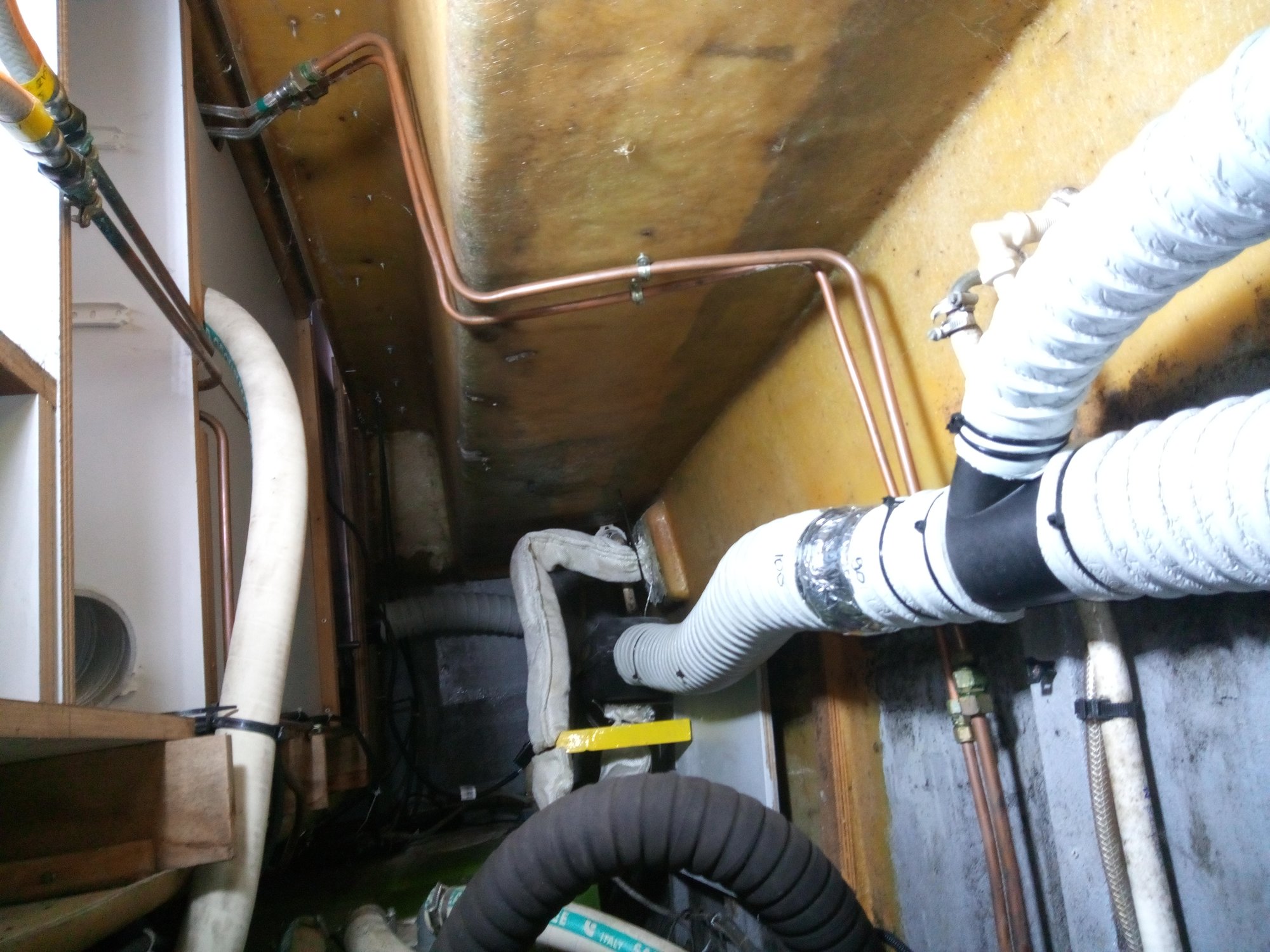

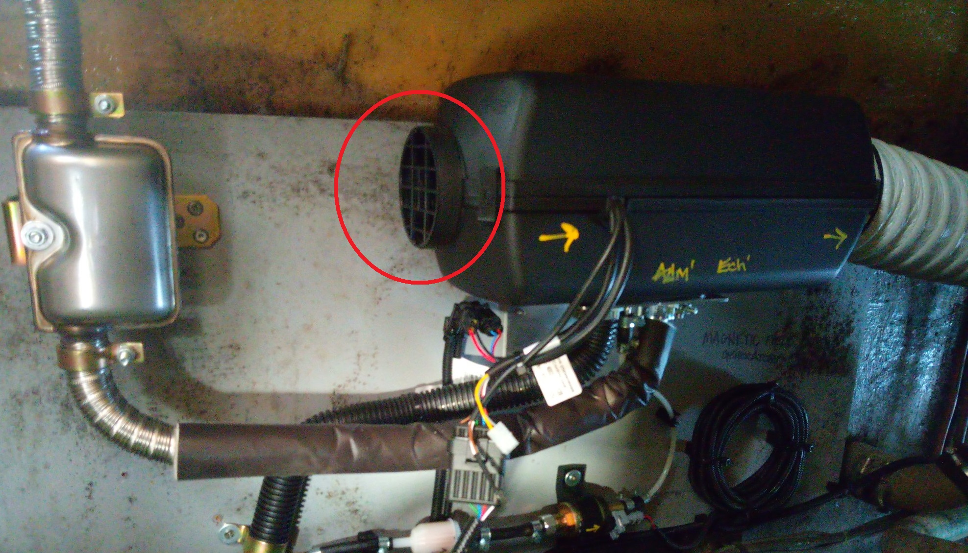

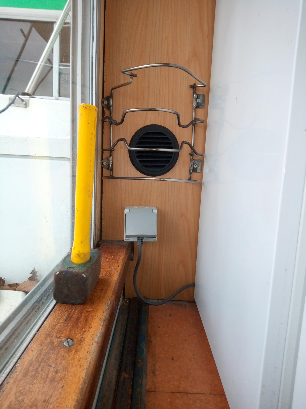

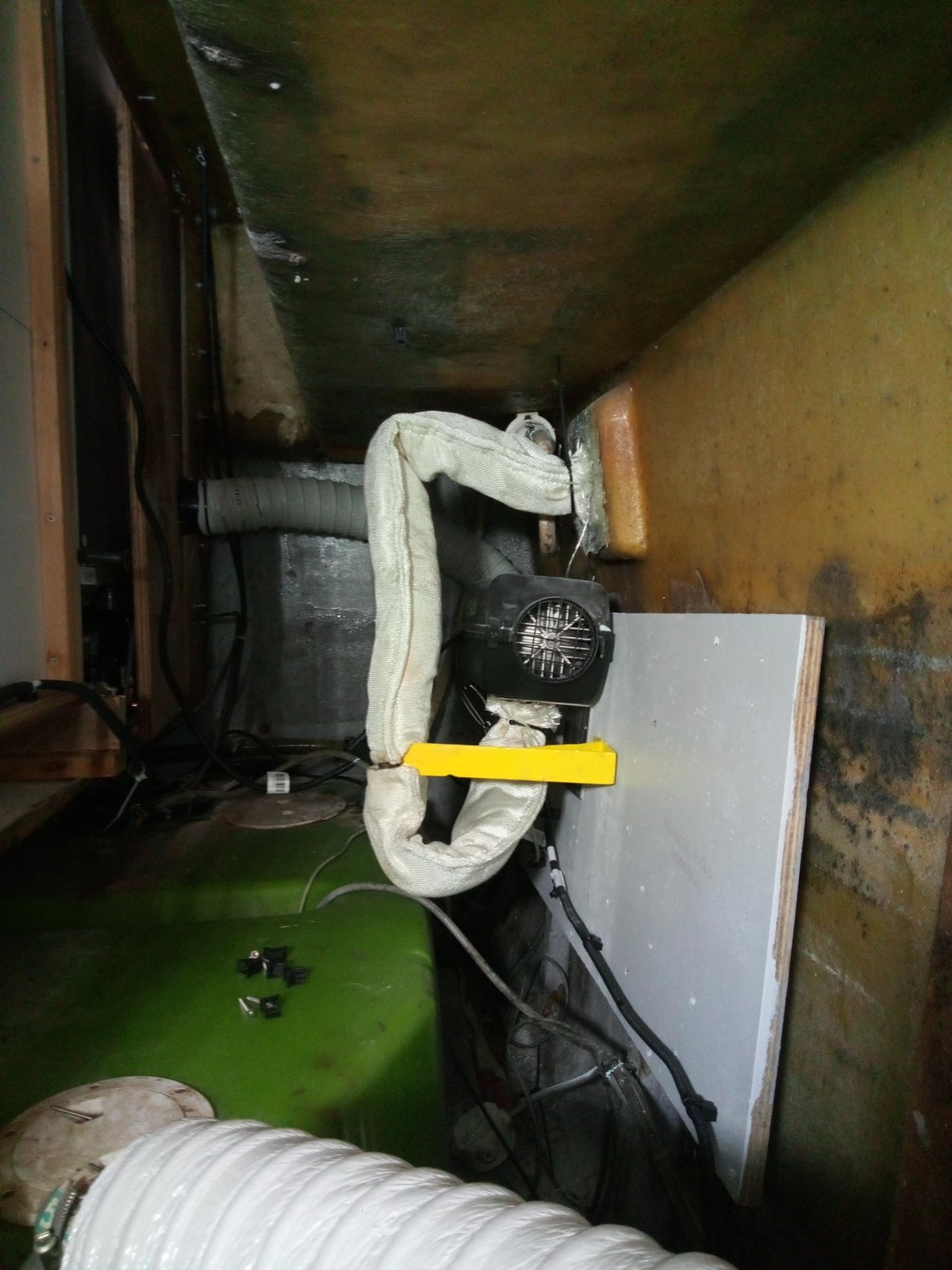

Are you heating the space that the heater is in or is the outlet ducted to somewhere else? If somewhere else then duct the inlet to that space as well, that will prevent the heater from drawing fumes from the exhaust drain point. It should also heat the space quicker

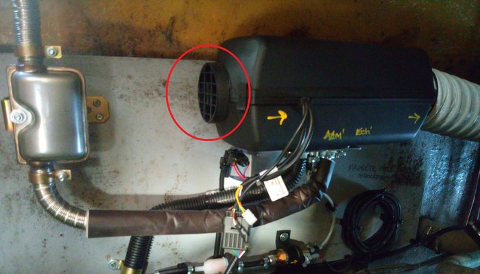

Evening folks, the air inlet for the heating air, there are two options...Yes the big inlet
needs to be ducted to the heated space, ideally away from the heated outlet
I know you have changed the layout compared to the above picture but I could see the inlet on your current configuration
Correct.That's the main, big, plastic, inlet - NOT the smaller, metal, inlet (the combustion inlet) - which should come from outside the heated space.
