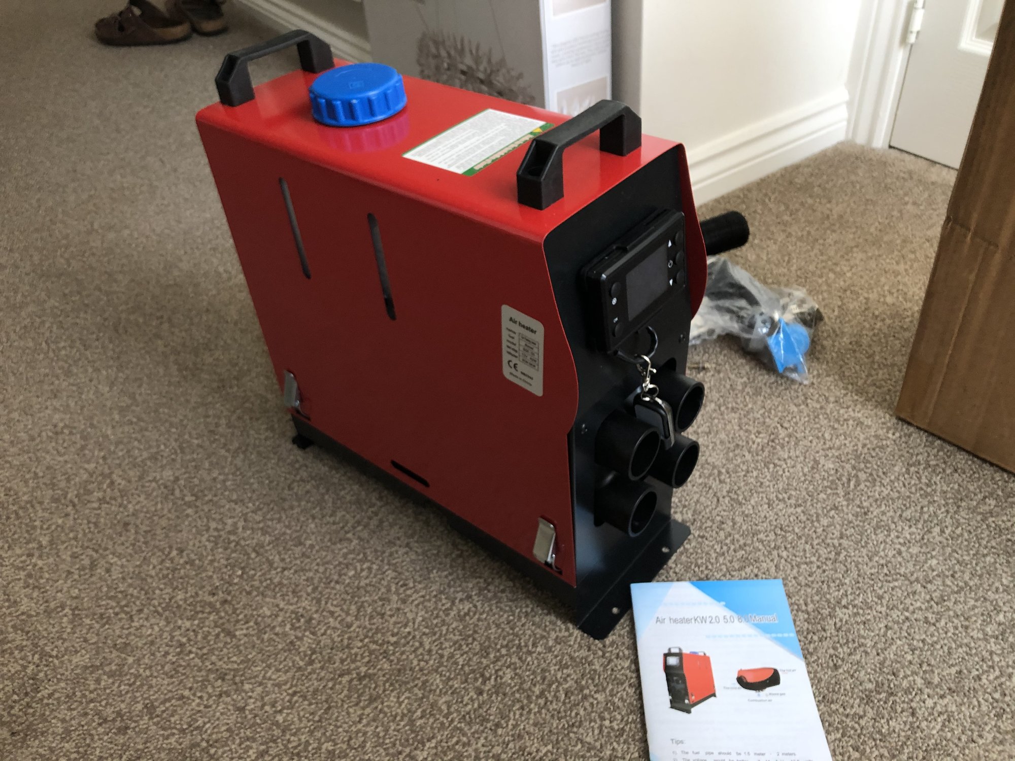

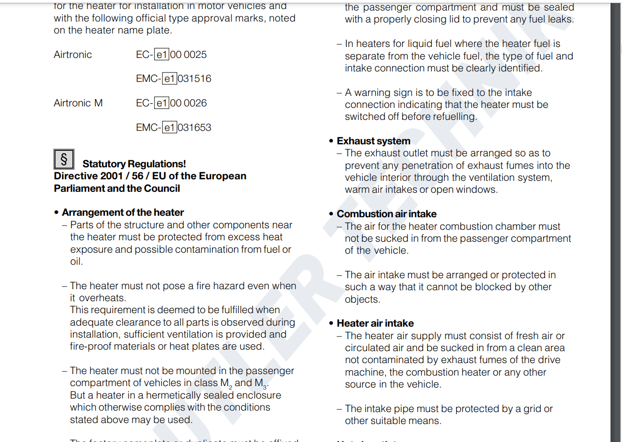

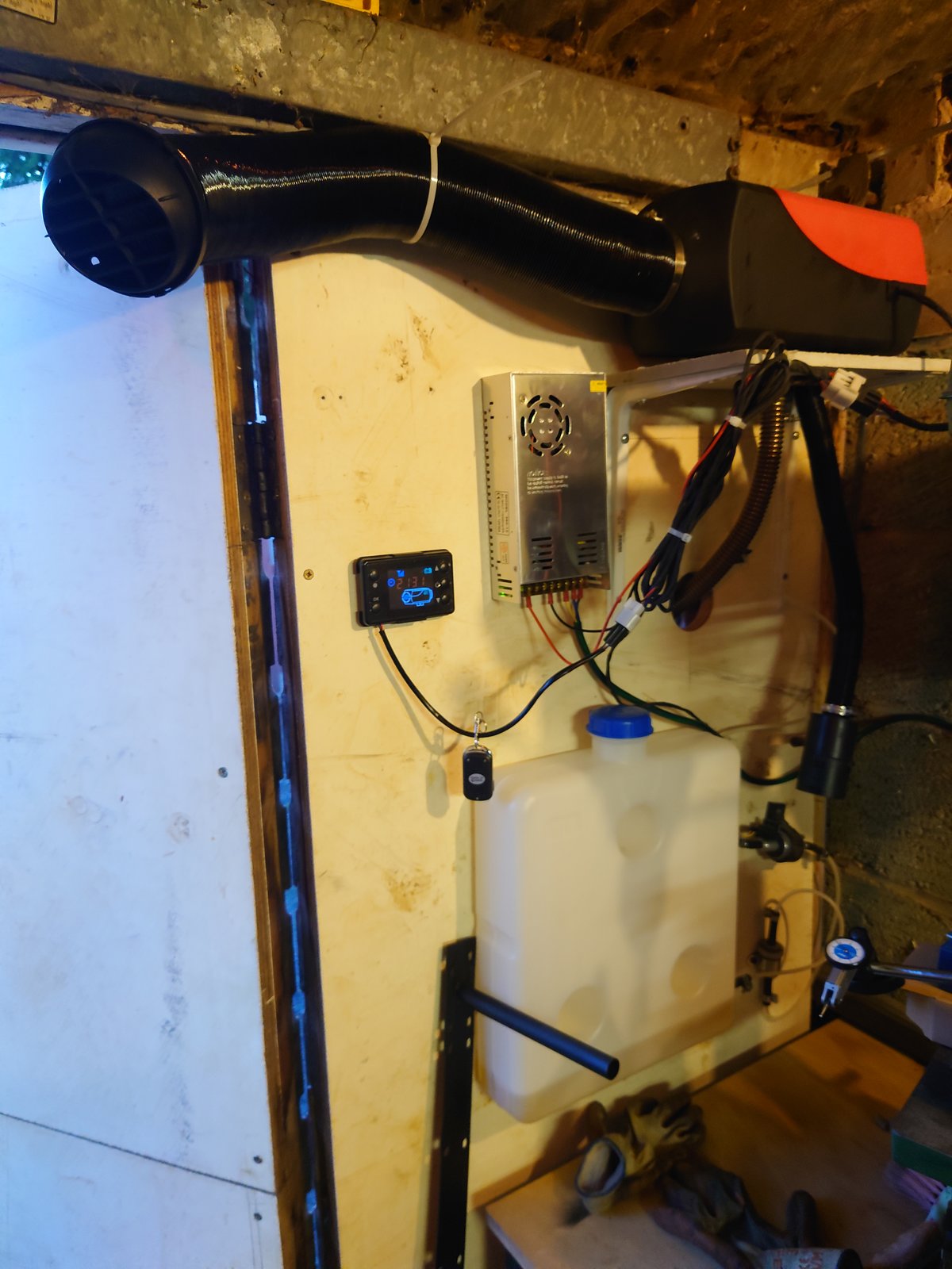

it is possible for a fault or failed start to cause exhaust to be emitted from the combustion intake. it is unwise to pipe it anywhere but outside with the exhaust.
I've had a few beers, I'll return to this tomorrow with a clear head, even a false start, which has shown up as an error, failed combustion, surely is can ventilated and exhausted.
Imagining, the pcb fails, false start, combustion, but no fan, yes I can imagine combusted gas, smoke, we'll say, if the fan failed, could come out the inlet, but it would take the flame detector to ...
Tomorrow, I'm not explaining myself properly...
I'll think about this, I'm an experienced fitter / installer / repairer, but not a guru...
