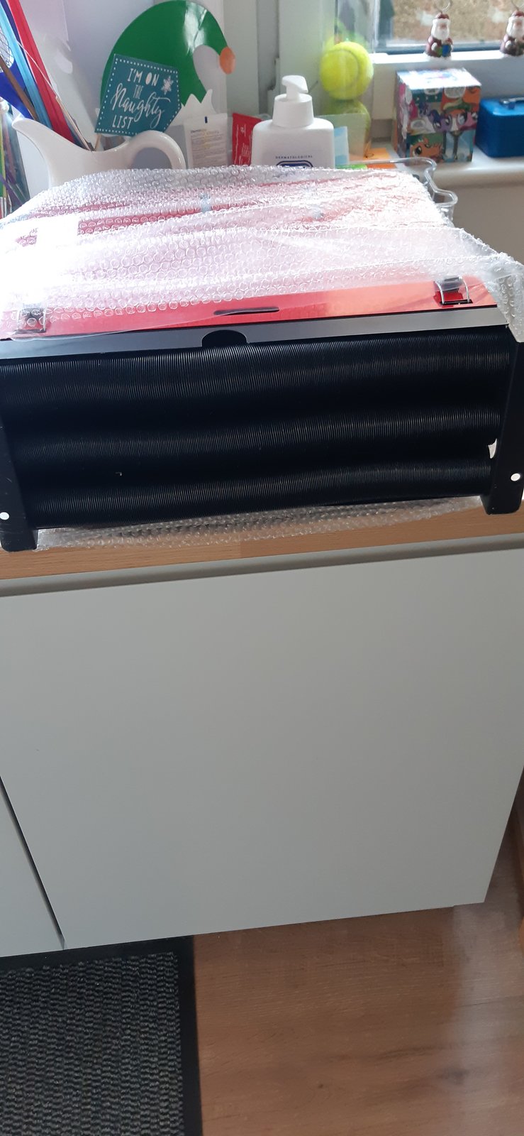

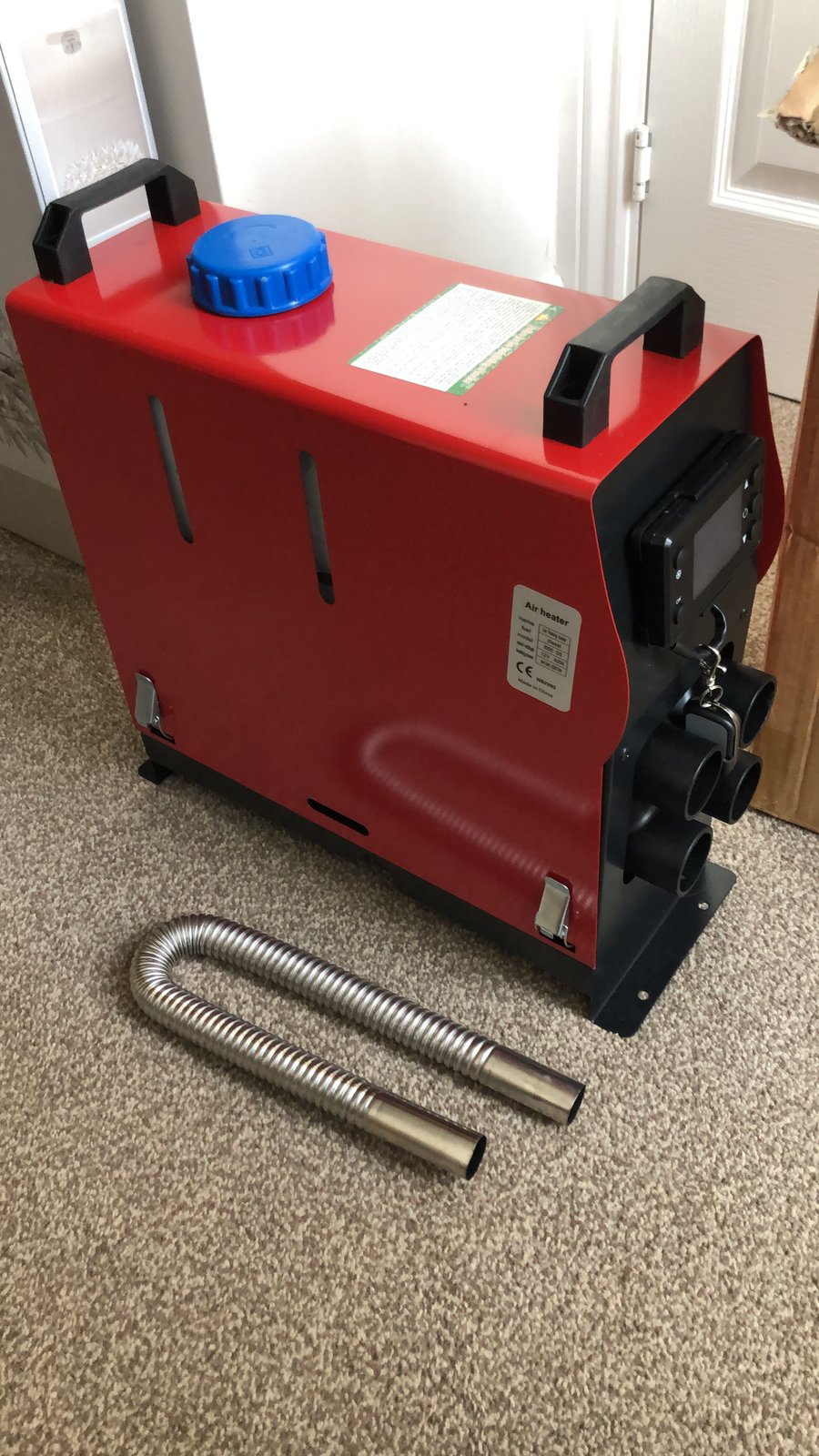

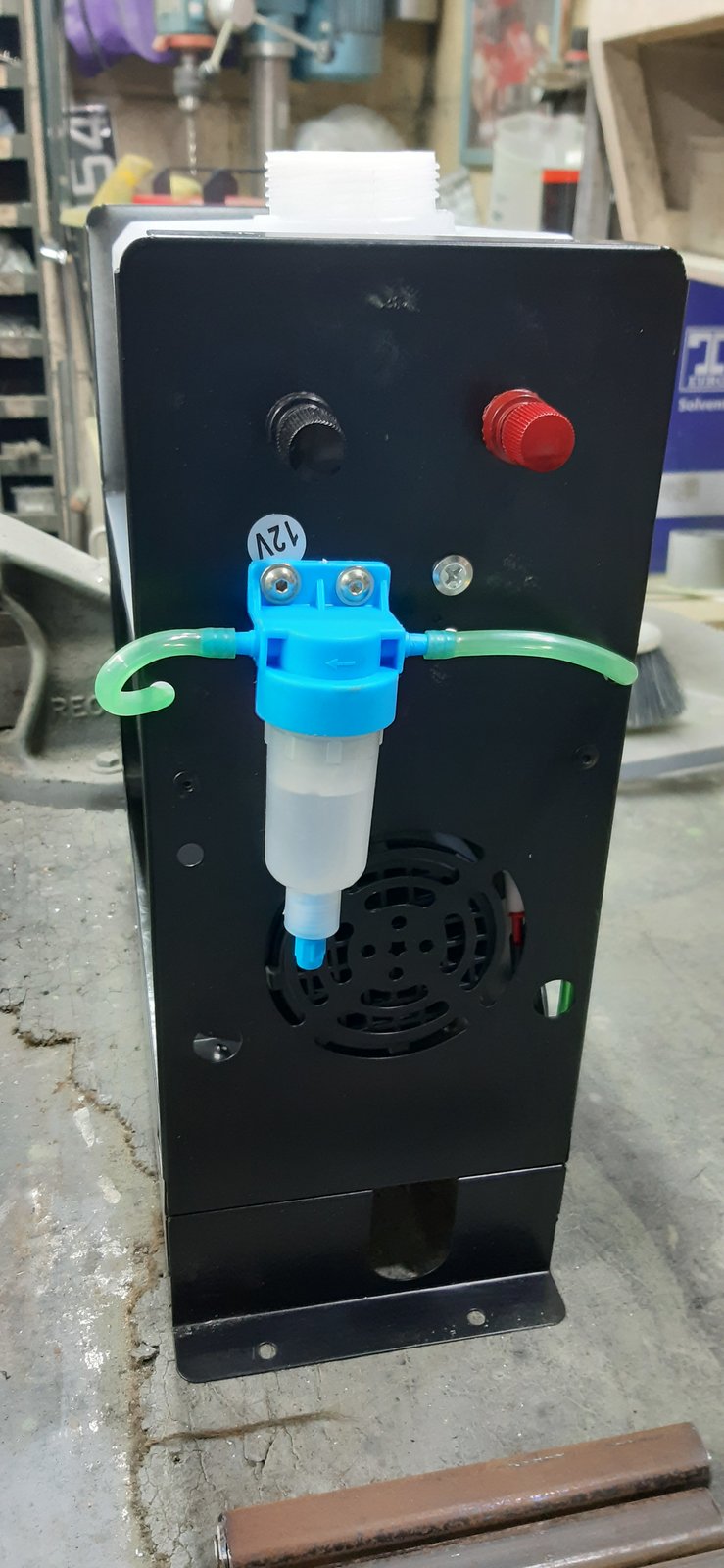

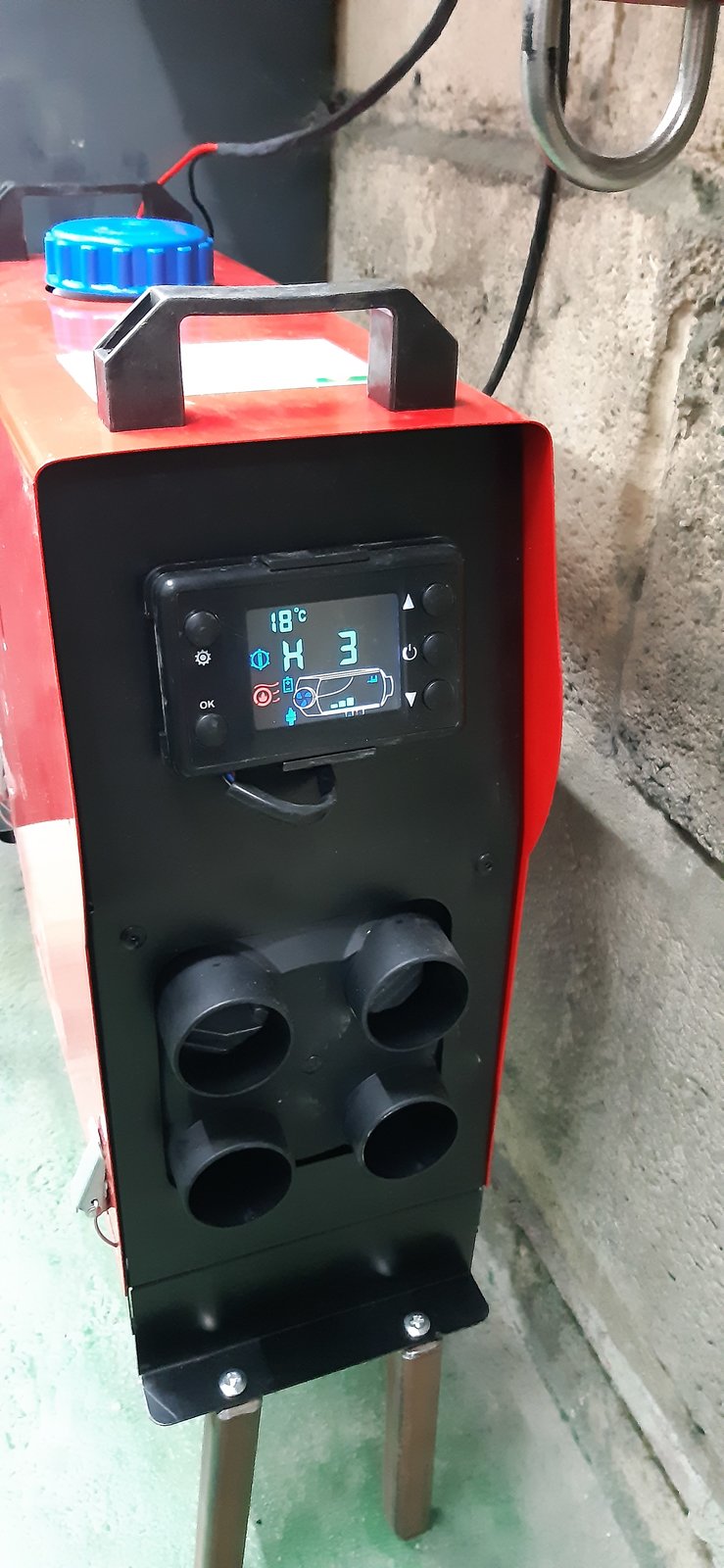

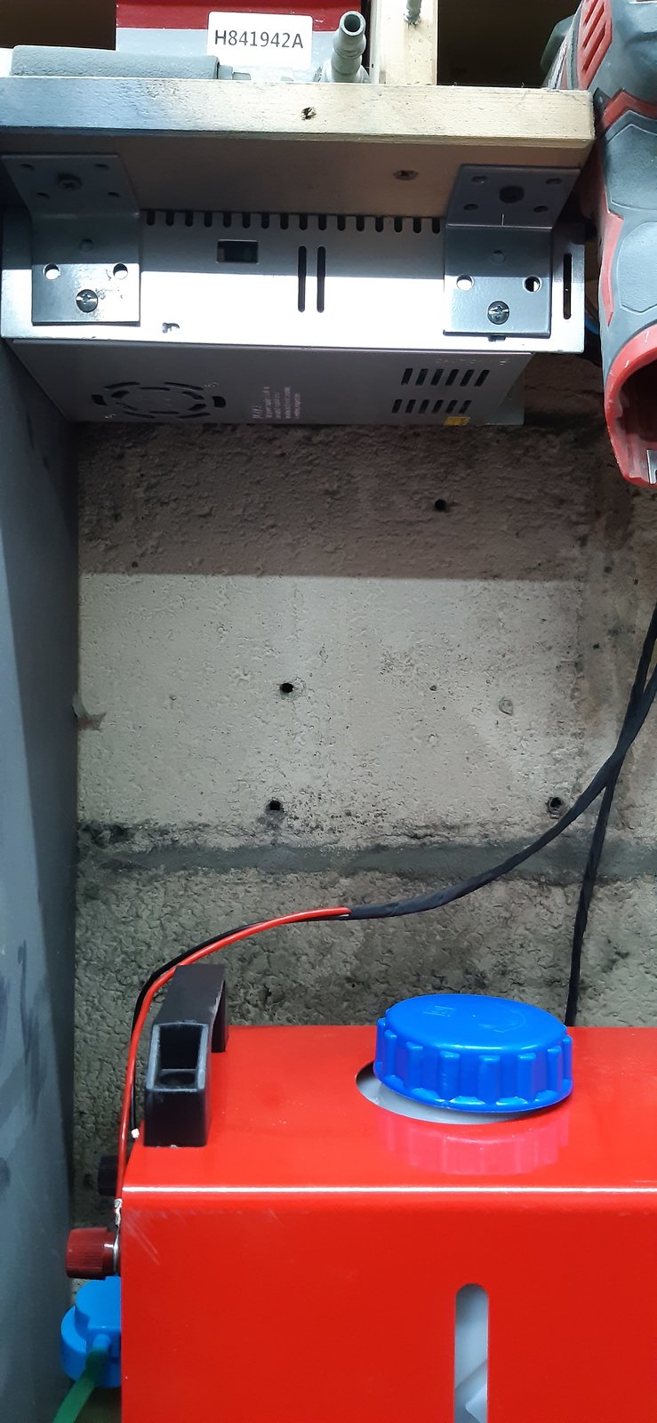

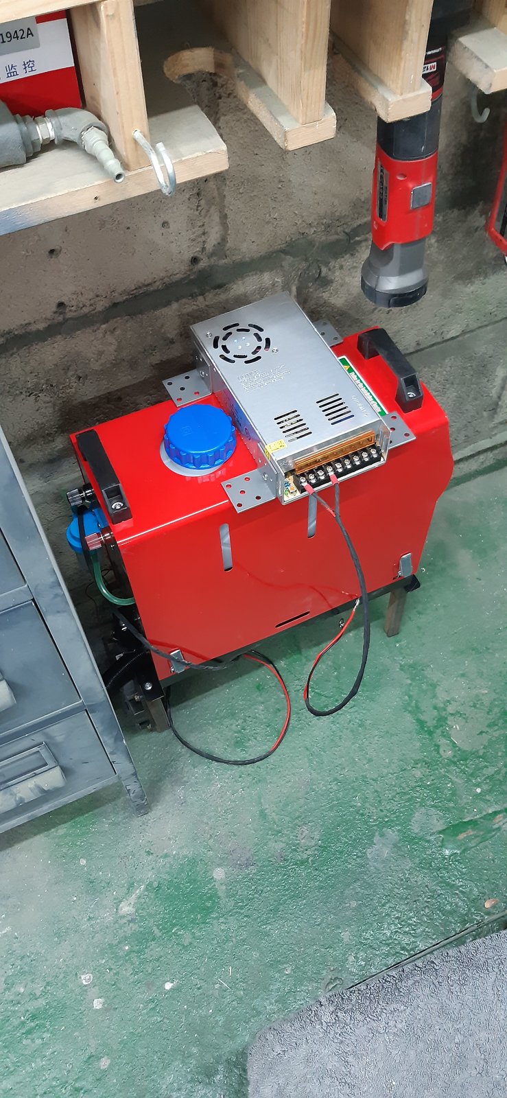

Well look what arrived today !!

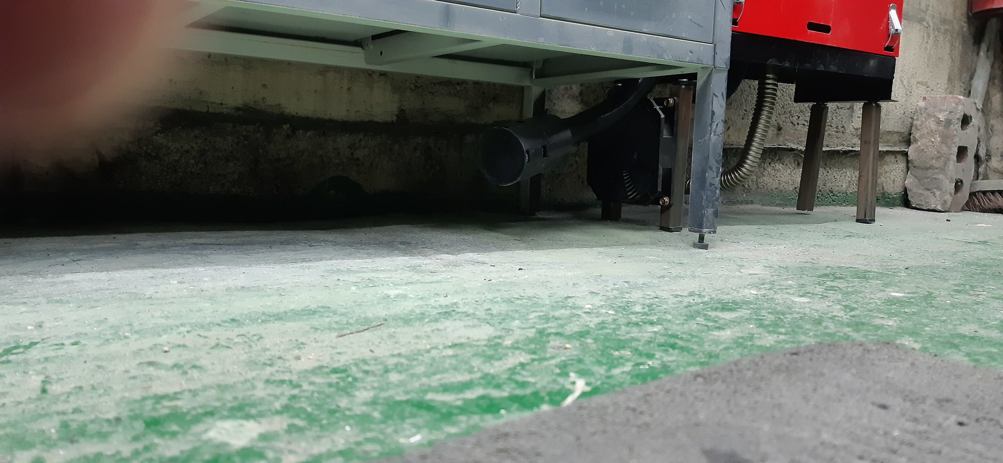

need to get a big enough SDS / small enough core drill to go through the wall now
Identical to mine, is yours going to exhaust through a block wall?

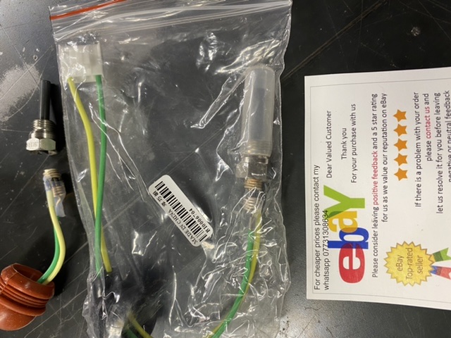

Cr500dom I would order a new glow plug now ready for the imminent failure. A member was good enough to send me a used espatcher glow plug about a year ago and it’s been fine since, too impatient to wait for a delivery of a Chinese version. It’s been running on diesel and can’t fault it.

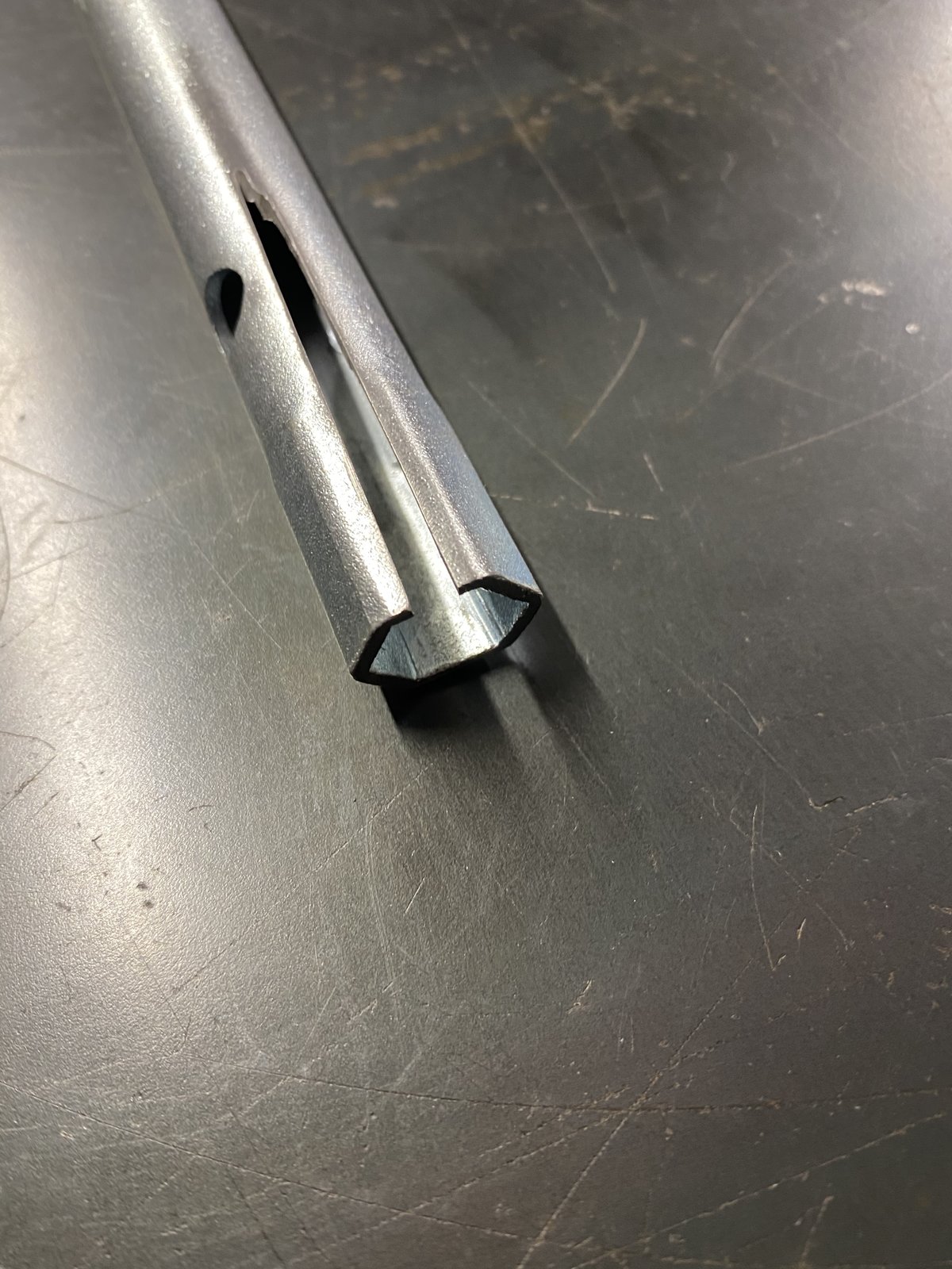

Oh and a box spanner / modified. To remove old glow plug cause if you use long nose pliers like I did it snaps the end off![]()
Modified 12mm box spannerView attachment 264121
Single skin brick.
