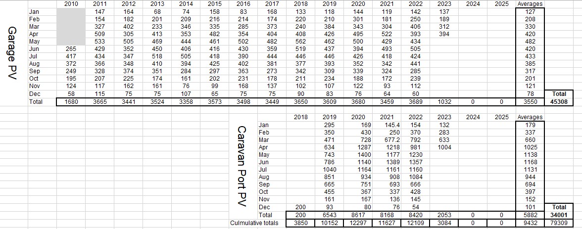

Gaz1, not sure if this will be of any use to you but see below my figures since my system went in.@J1nx

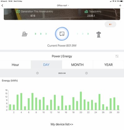

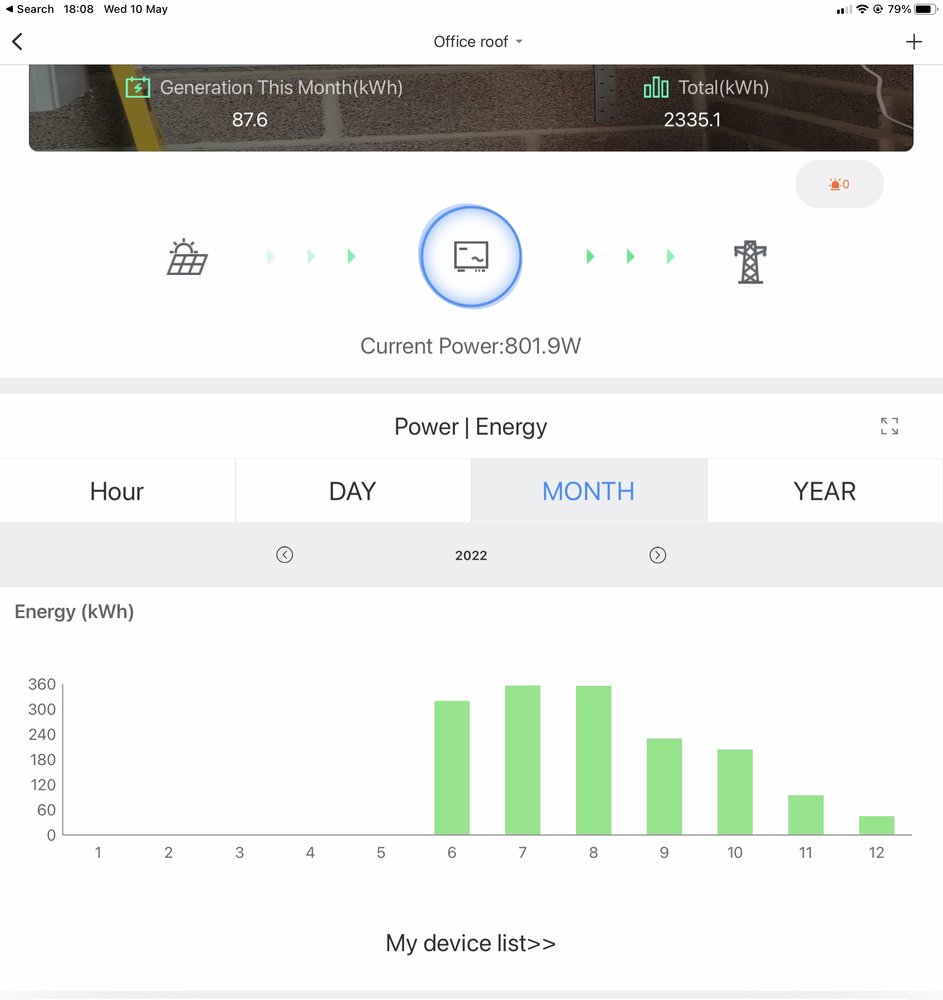

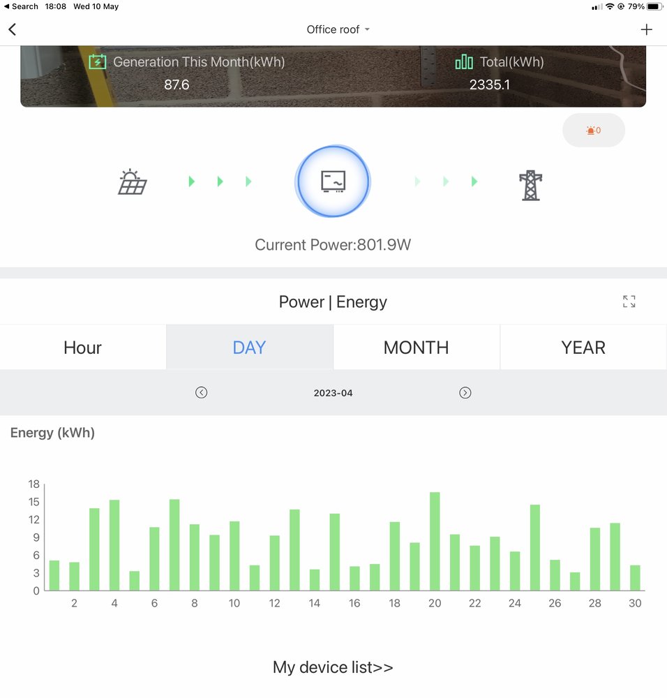

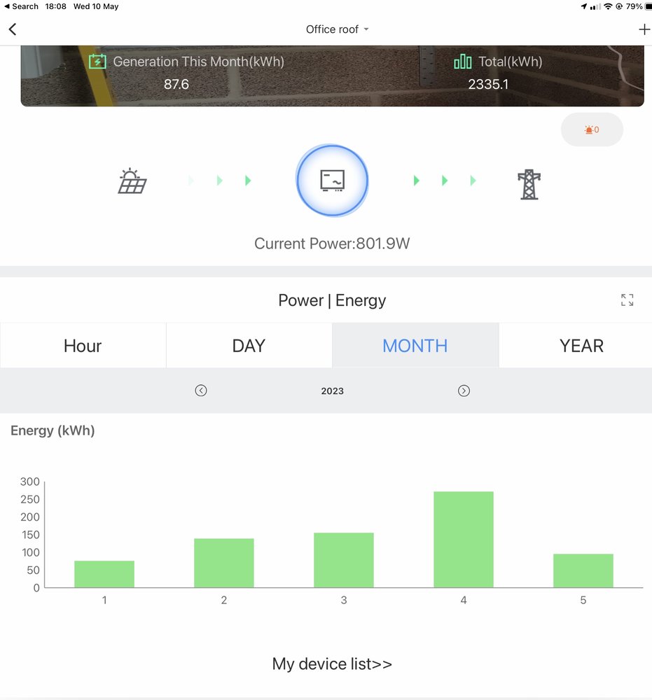

thankyou for posting as that will provide the numbers for north ( aberdeen ) for solar usageGaz1, not sure if this will be of any use to you but see below my figures since my system went in.
Garage is 3.87KWp (50 degree angle) and caravan port is 10.24kWp (8 degree angle), bit further north than you are looking for so anything comparative is likely to give higher outputs.

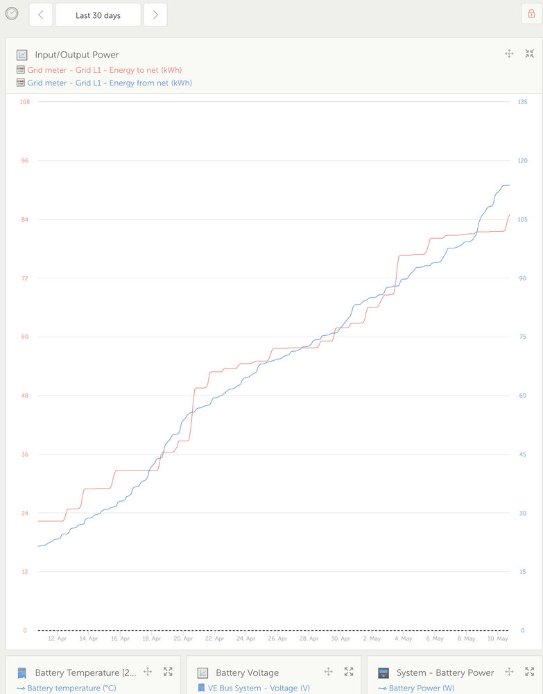

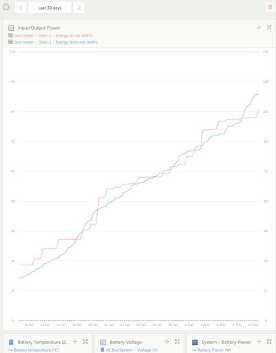

Average daylight in UK latitude is I believe a little under 11-hrs-a-day. However, in winter the "daylight" as MM says ain't up to much - but you might be lucky and do maybe 5%?I did do a fag packet calculation on payback and assumed 80% for 6 months (optimistic) and 0% for 6 months. Whilst 80% may be optimistic for 3 of those 6 I have no real data to go on, however the 80% above includes last Friday which was on solar, so actual savings last week were above that and at current cost of 28p/kWh.
I think I will struggle to get any FIT due to no MCS, but I will try just in case when I renew contract (staying on price cap is better than FIT at 7.5p anyway).

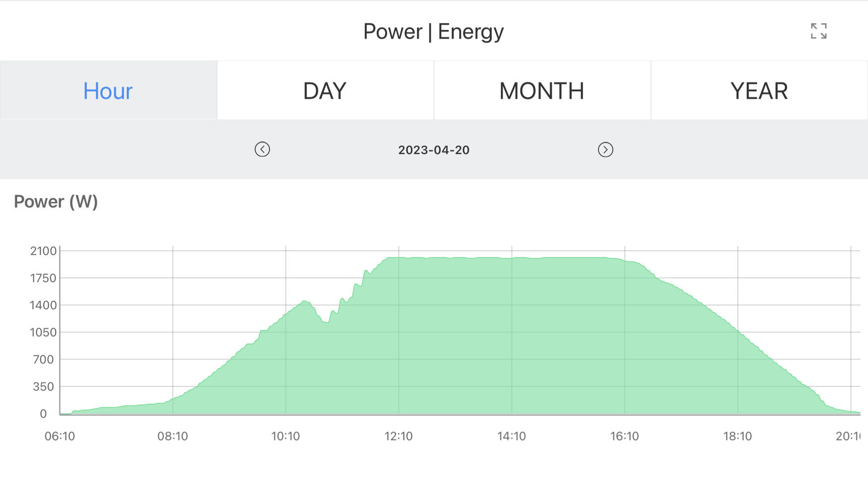

The last line graph I posted shows current consumption/generation, as you can see we are now achieving almost 100% and as I have data from last June onwards we should easily now continue that through to September.Average daylight in UK latitude is I believe a little under 11-hrs-a-day. However, in winter the "daylight" as MM says ain't up to much - but you might be lucky and do maybe 5%?
