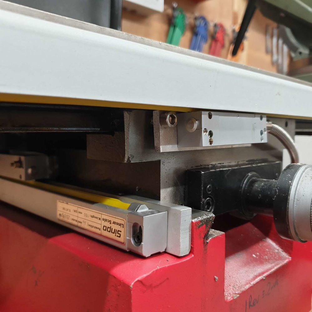

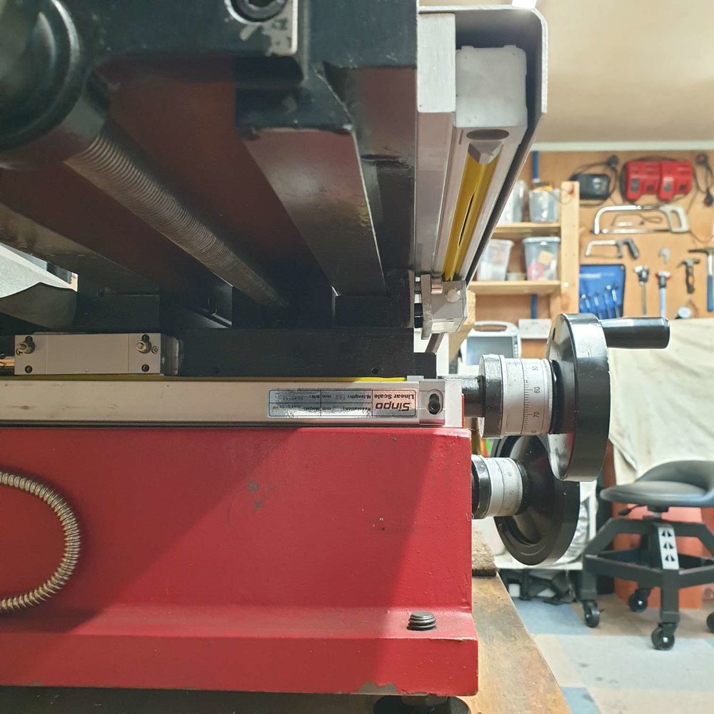

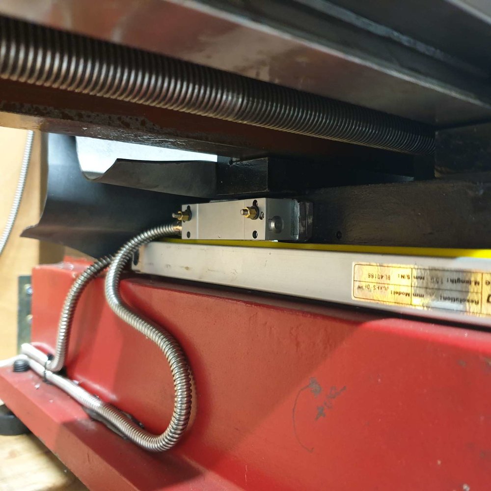

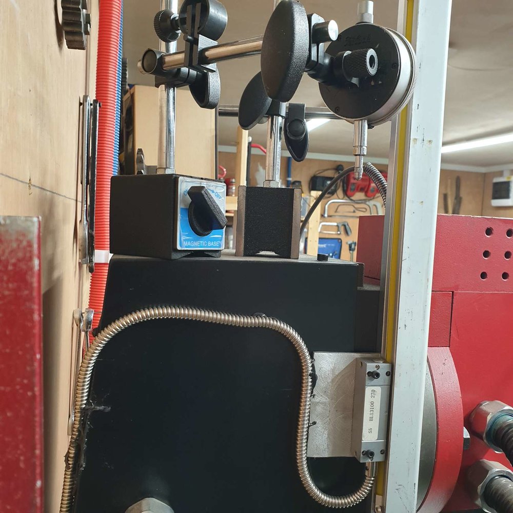

That'd be great - thanks Robert.I fitted a 3 axis dro to my sx3 last year. If you want pics of the install, routing and scale lengths, I can sort info tomorrow morning.

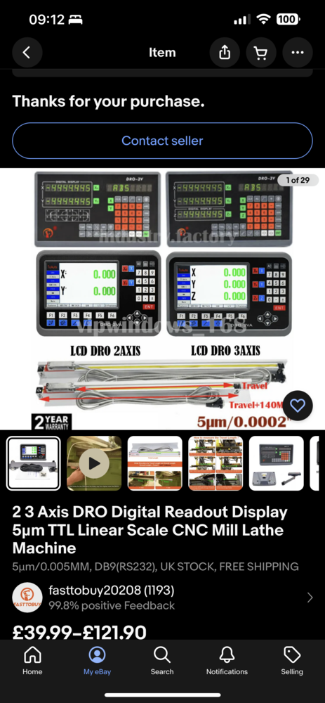

I would buy one of these but it says that it can't be shipped to my address. I'm near Preston Lancashire.I've recently ordered this one from Aliexpress. I'm expecting delivery in a day or three. Seems very cheap. Will let you know how I get on.
I paid £33.13 plus VAT so £39.76 in total with free five day delivery.
SNS-3V SNS-2V Dro 2 3 Axis Digital Readout Display TTL Signal 80V to 250V for Lathe Milling CNC Boring Machines - AliExpress 1420
Smarter Shopping, Better Living! Aliexpress.comwww.aliexpress.com

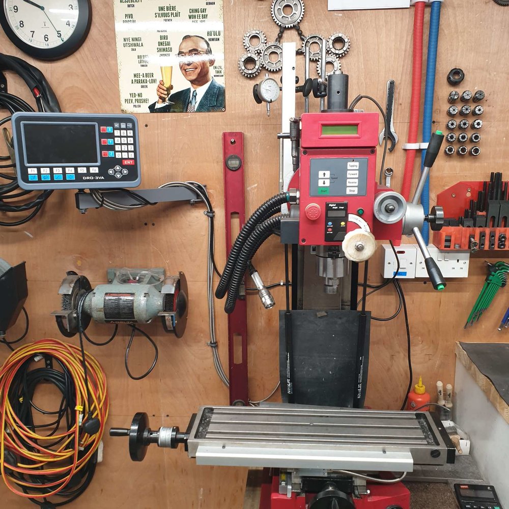

You don't have the link to that one do you, Kim? There seem to be so many it's mind-boggling!I fitted a dro to mine lately. I bought the more expensive unit. It is really good. It works out pcd and all sorts on it. Gives you step milling functions and hole pattern functions which came in handy already. I’m glad I spent the £20 more for it.
320mm, 150mm and 270mm slim scales.That'd be great - thanks Robert.
That's great - thanks Robert.320mm, 150mm and 270mm slim scales.
View attachment 444768View attachment 444769View attachment 444770View attachment 444771View attachment 444772

I bought this same unit from the same seller a while back for my lathe and its been spot onI fitted a dro to mine lately. I bought the more expensive unit. It is really good. It works out pcd and all sorts on it. Gives you step milling functions and hole pattern functions which came in handy already. I’m glad I spent the £20 more for it.
