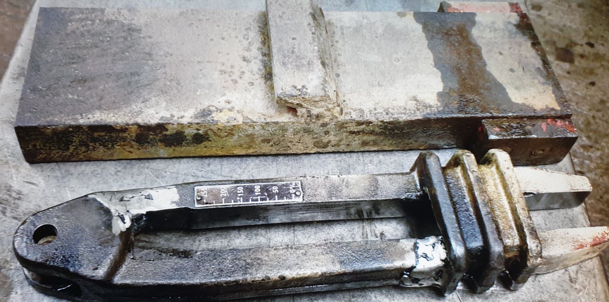

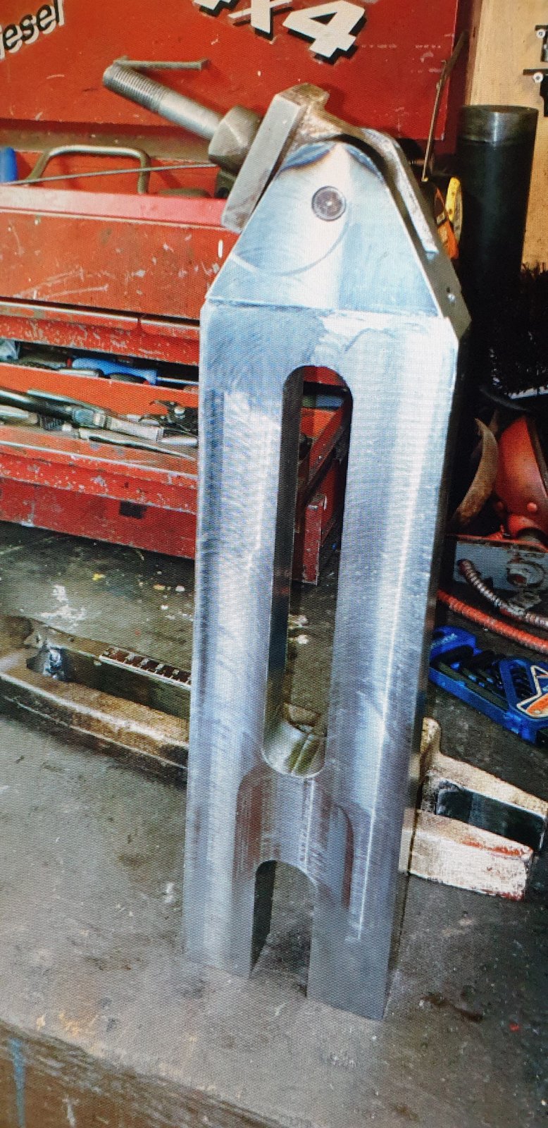

If the bush is a bearing material then no reason not to use steel
Yes, a simple block of bronze with a hole to sit on the pin.

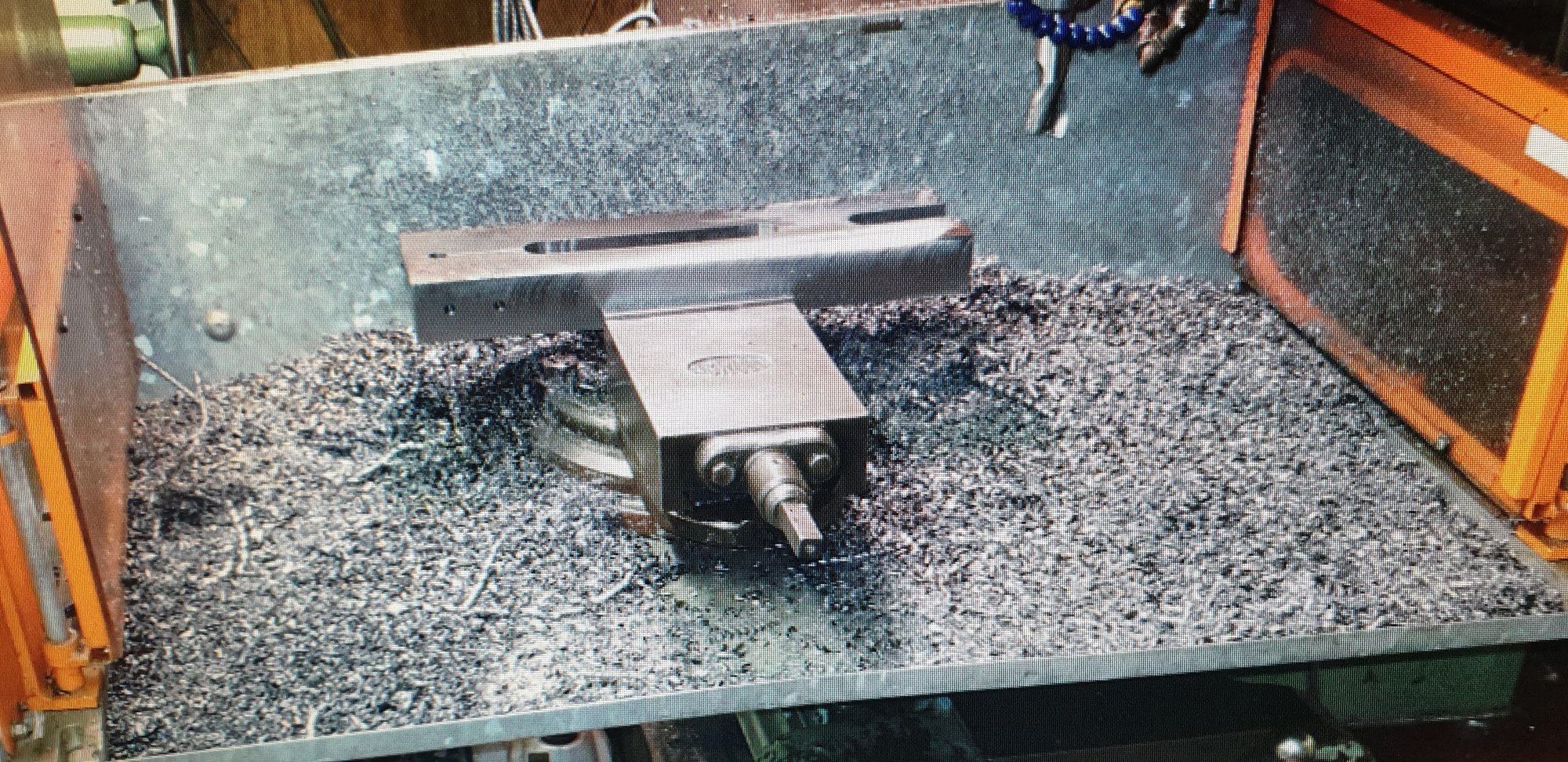

Ive seen a shaper that had a smash up and it punched up the ram through the topI would re-fabricate that from steel I think. If it breaks again it could smash stuff up in the cabinet.

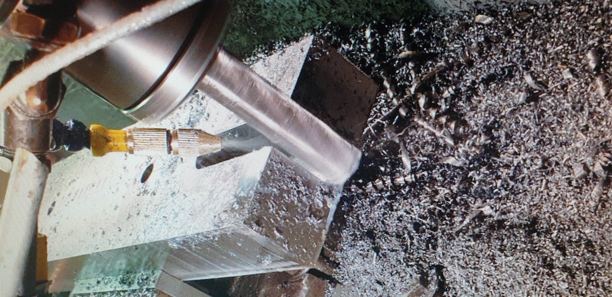

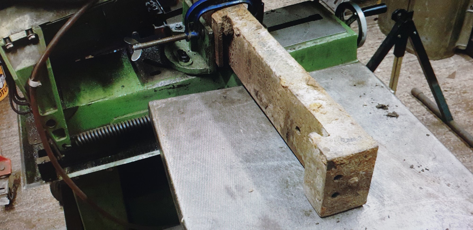

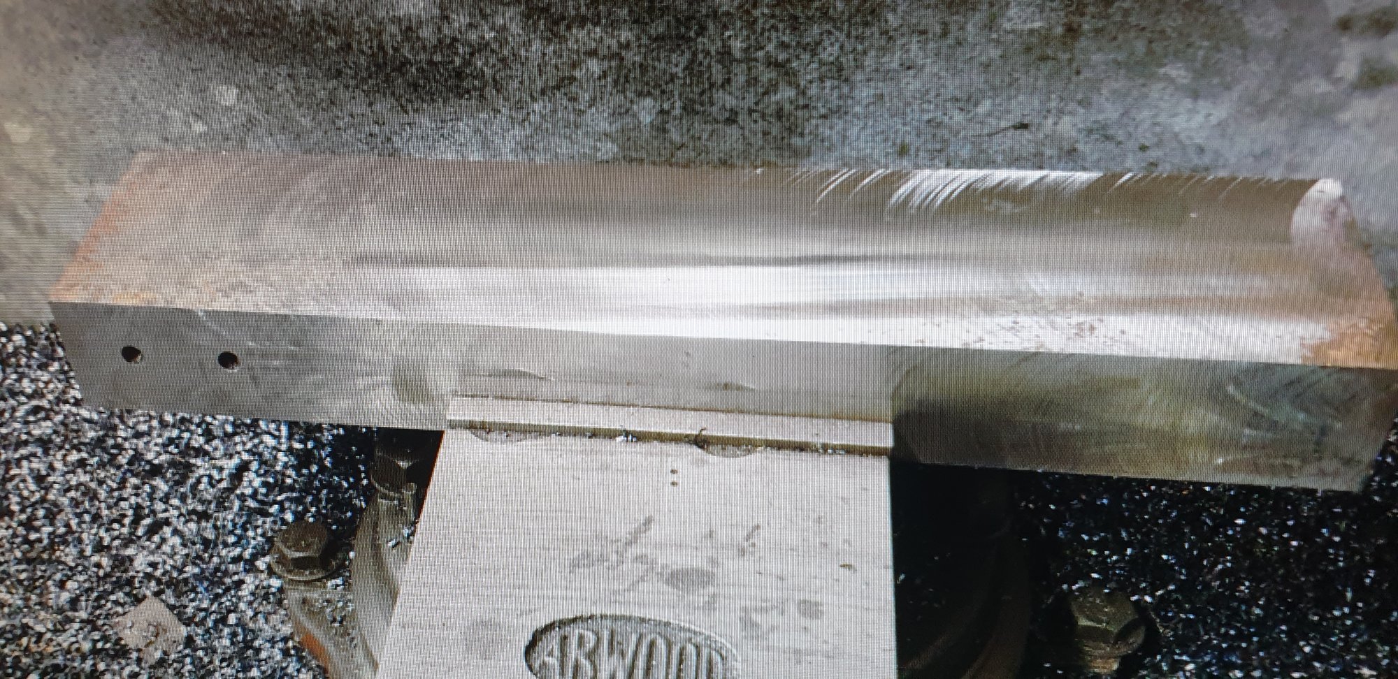

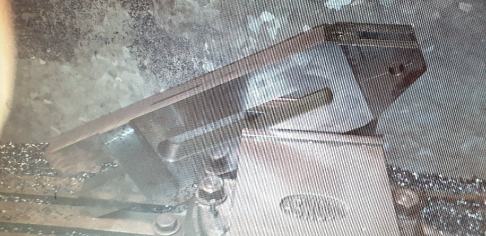

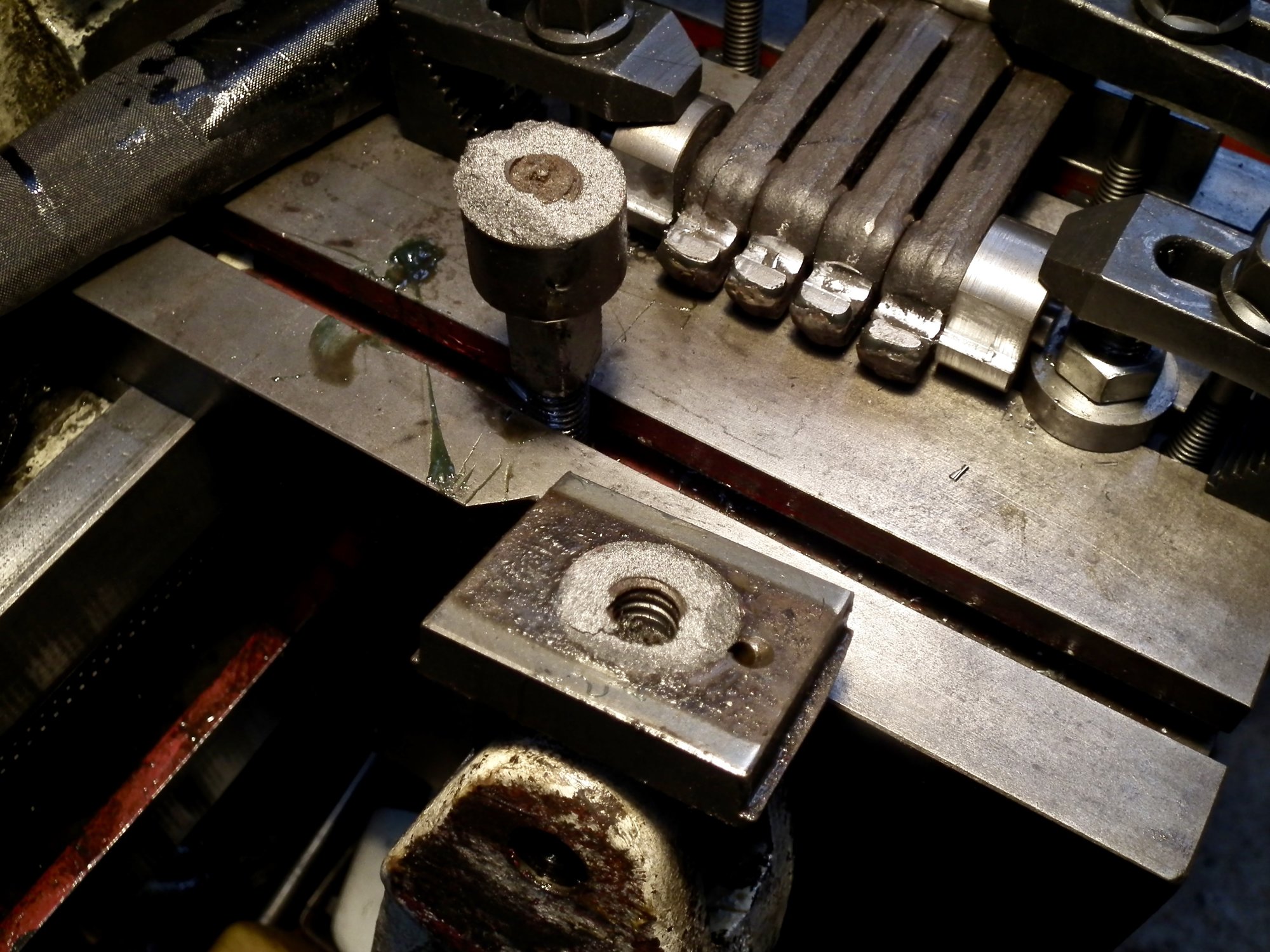

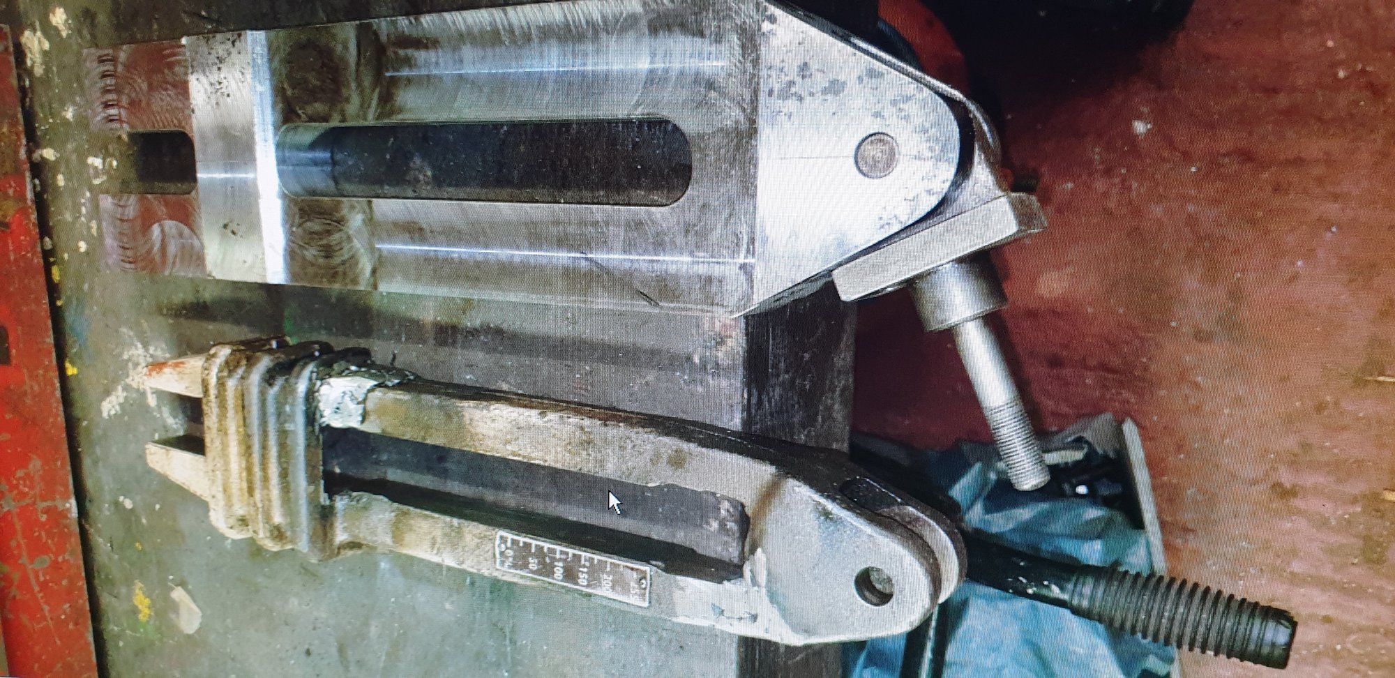

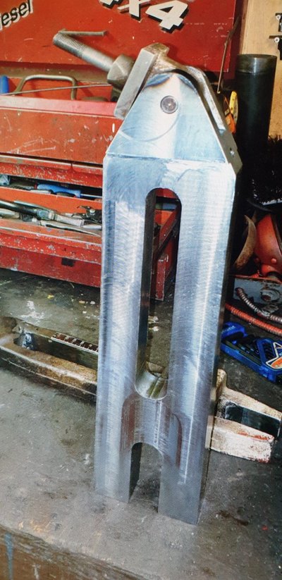

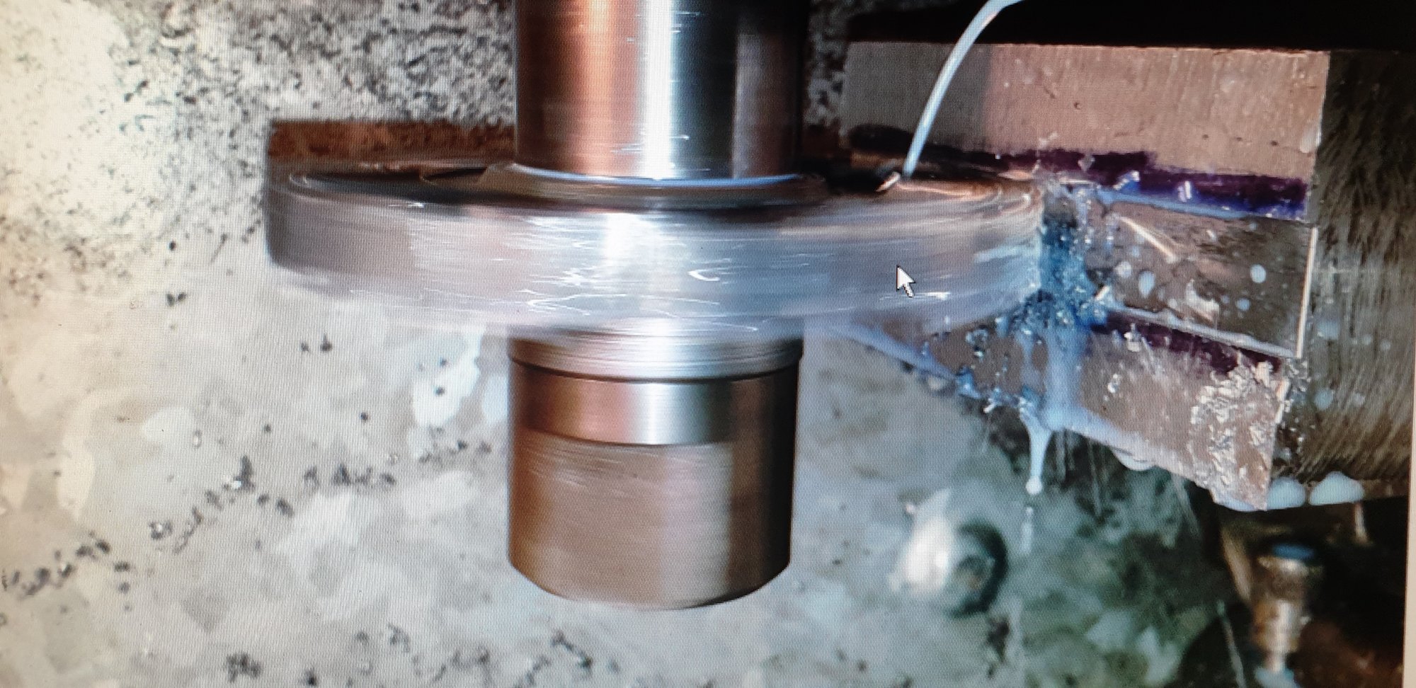

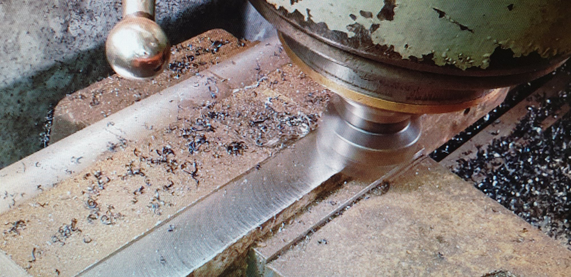

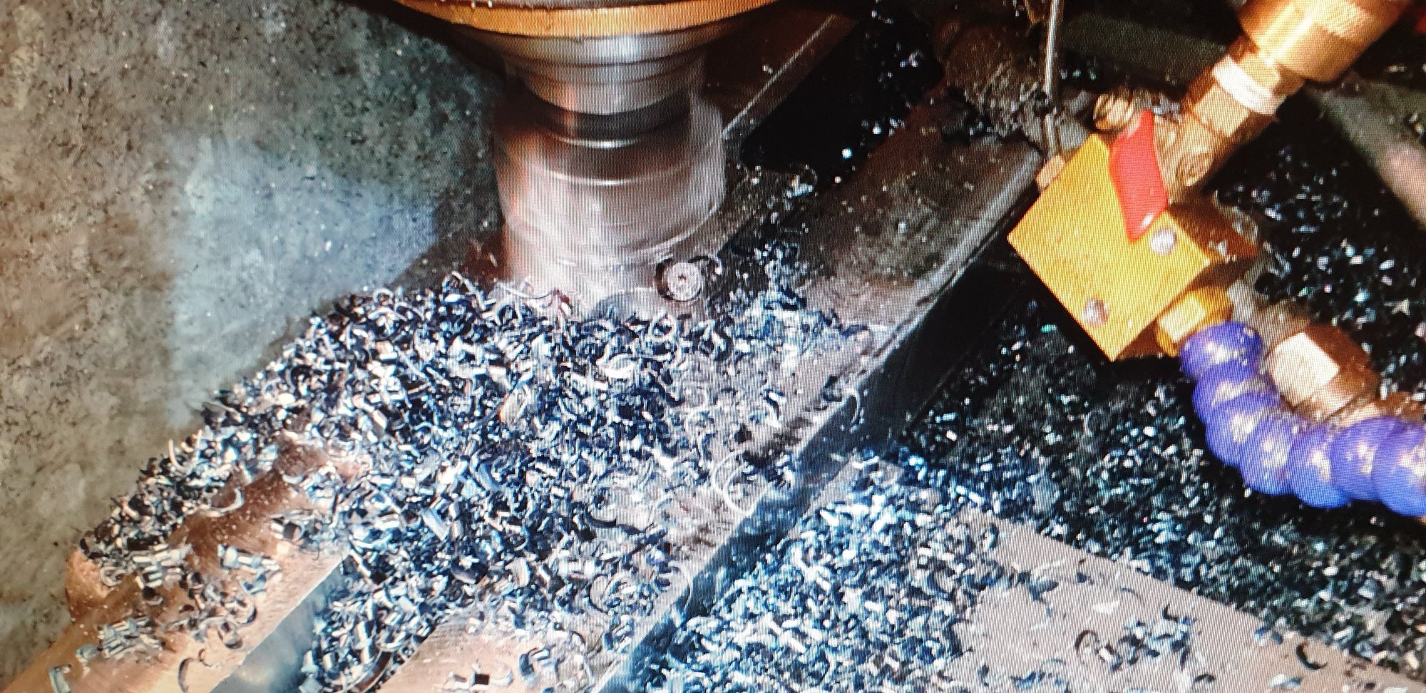

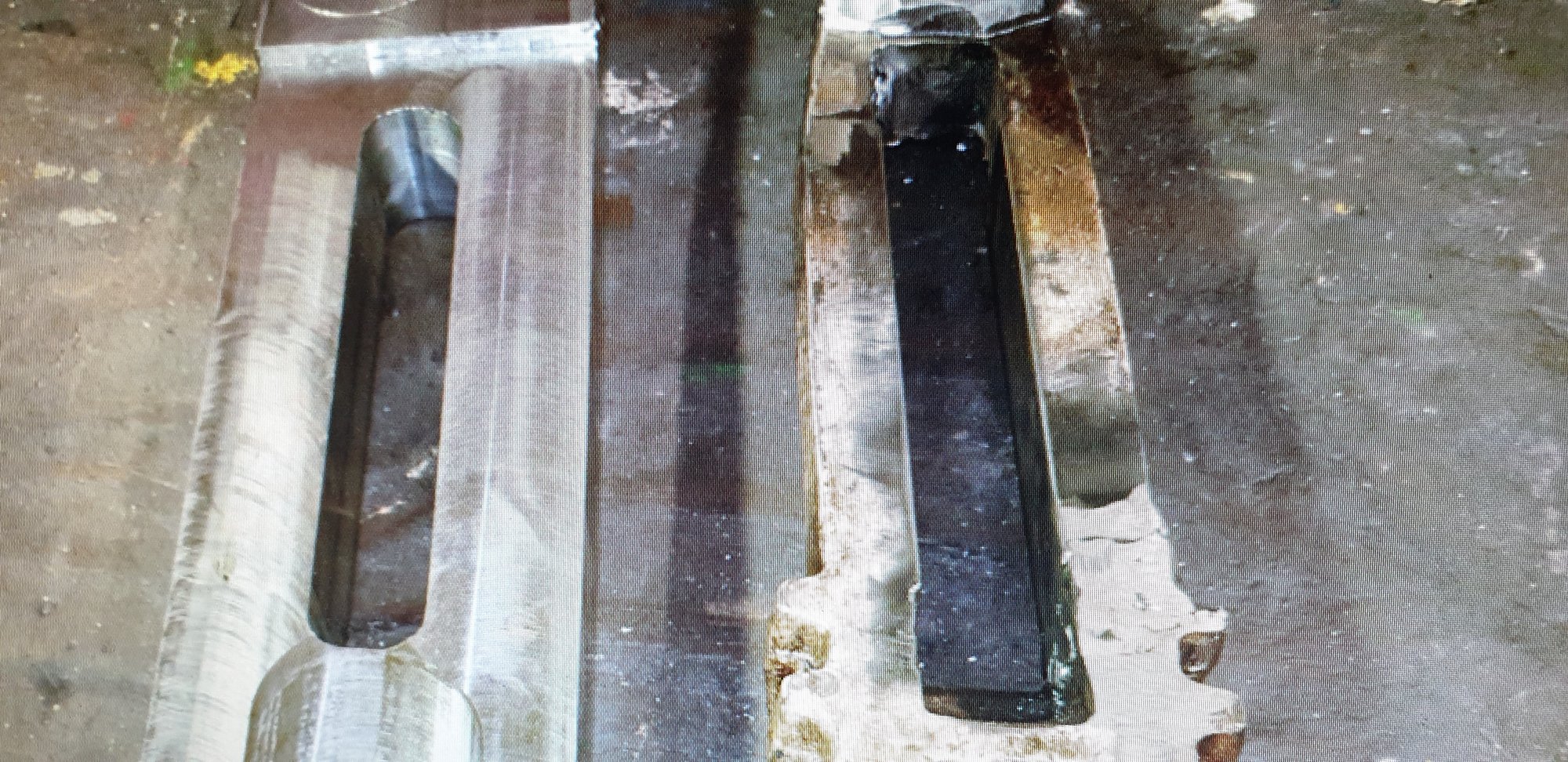

Kearney and muncher!Hi all a quick update while having a bite to eat I made a good start on this repair I have welded it but not happy with so chopped off a pallet fork I salvage from the scrappy, I thought it might come in handy, They are b****y heavy any way I got the basic shape milled the Kearny is brill can take 6mm in one swipe, and I reckon it could take more but don't like pushing the old machine to the limit, ha ha says he that's broke the shaper. That's it till later cant stay long as wont to get back to it so let the photo do the talking hopefully have it back working tonight fingers crossed will update later.
View attachment 198770 View attachment 198771 View attachment 198772 View attachment 198773 View attachment 198774 View attachment 198775 View attachment 198776 View attachment 198777
Cheers
Jord
Tough to machine ?
Excellent days work, should outlast everything else!

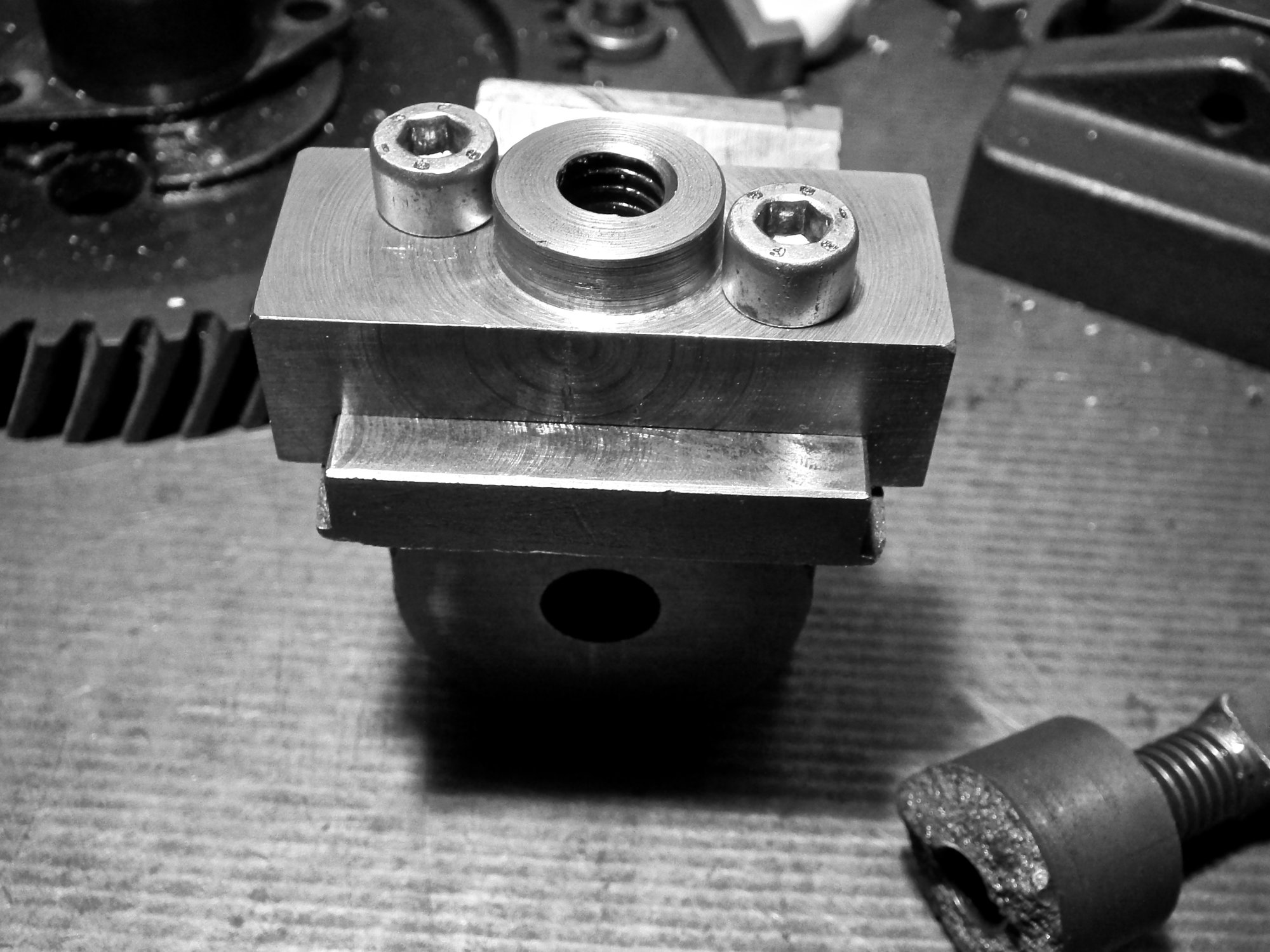

This is what happened to my top link, looks like it had been on the way for a while.
My repair, the bolt goes down into the old tread as well.
The gears were noisier afterwards, they've settled down now though.
Yeh you were right and to think I was disappointed when father got it for meKearney and muncher!
Told you they could chomp!
Me being me I did have some forks checked, closest match was en19 in a heat treated condition.
I reckon some are made from odd knob bob
Be careful Jordan, you have now lost the overload fuse, as I said Ive seen a shaper behead itself.
