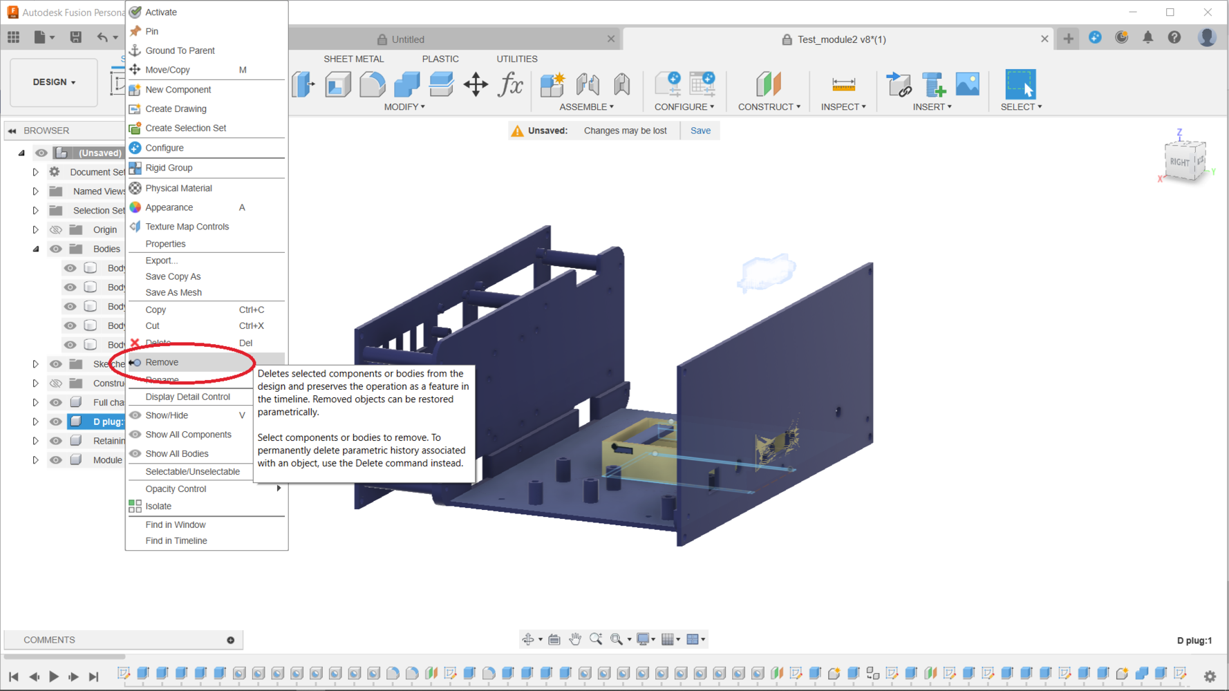

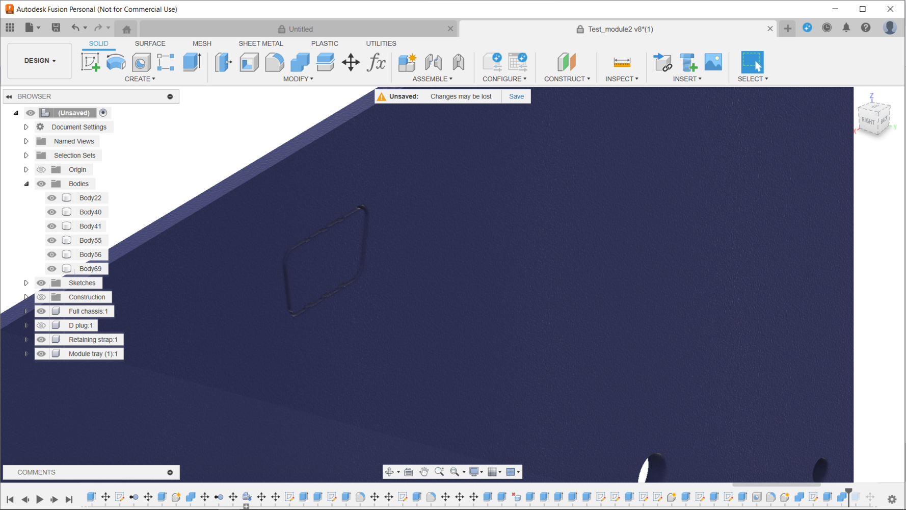

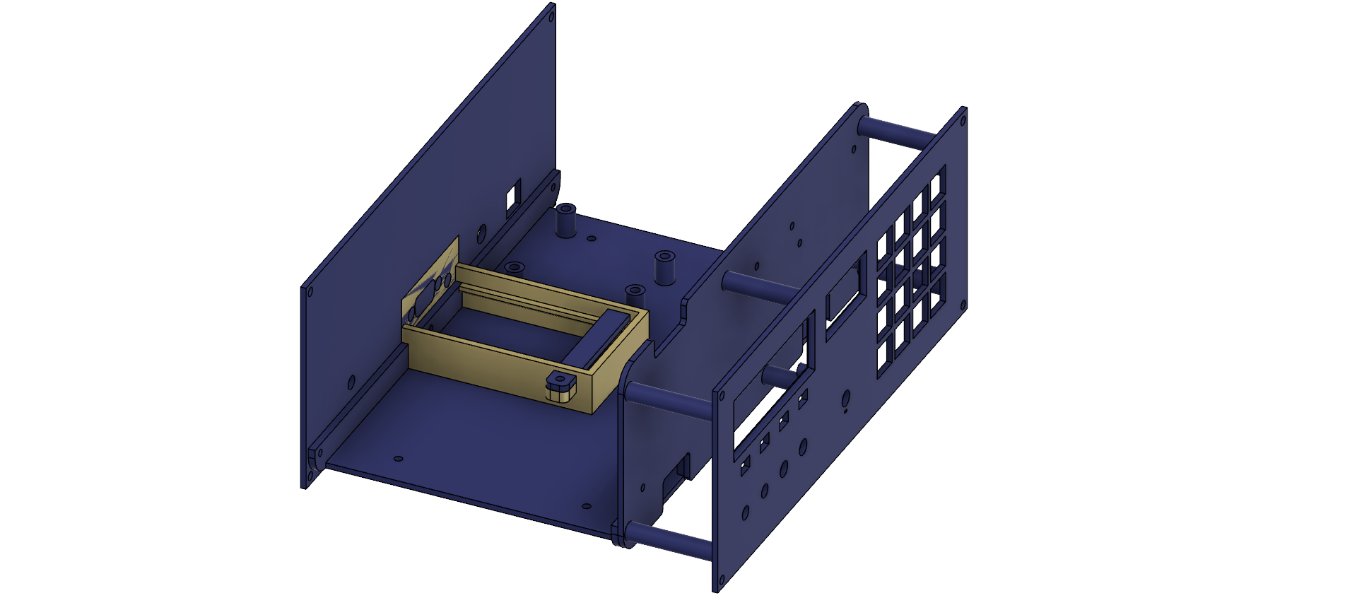

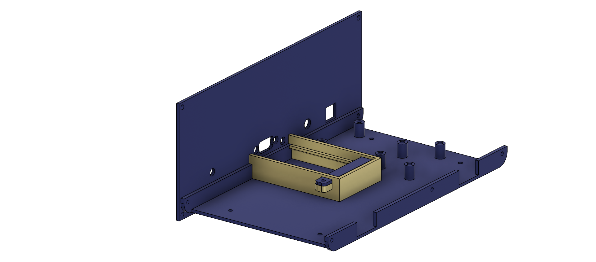

So my questions are, how to get the rear panel cutout and linked to the module case's lateral position?

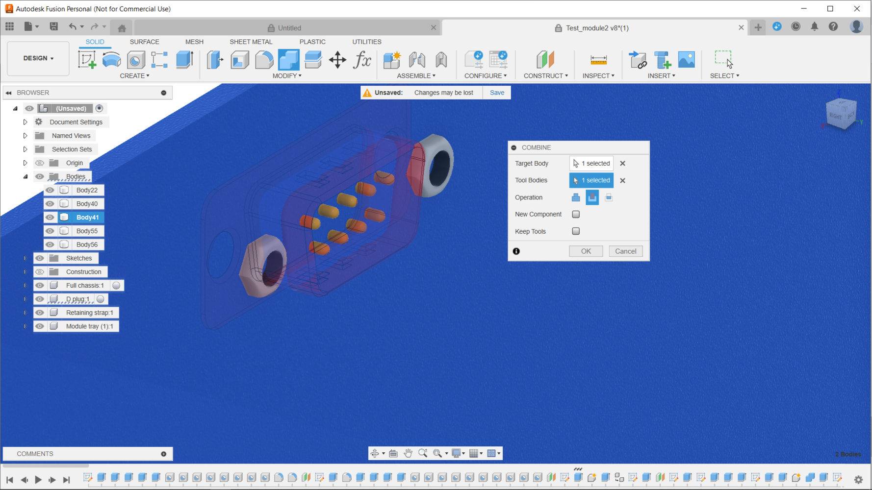

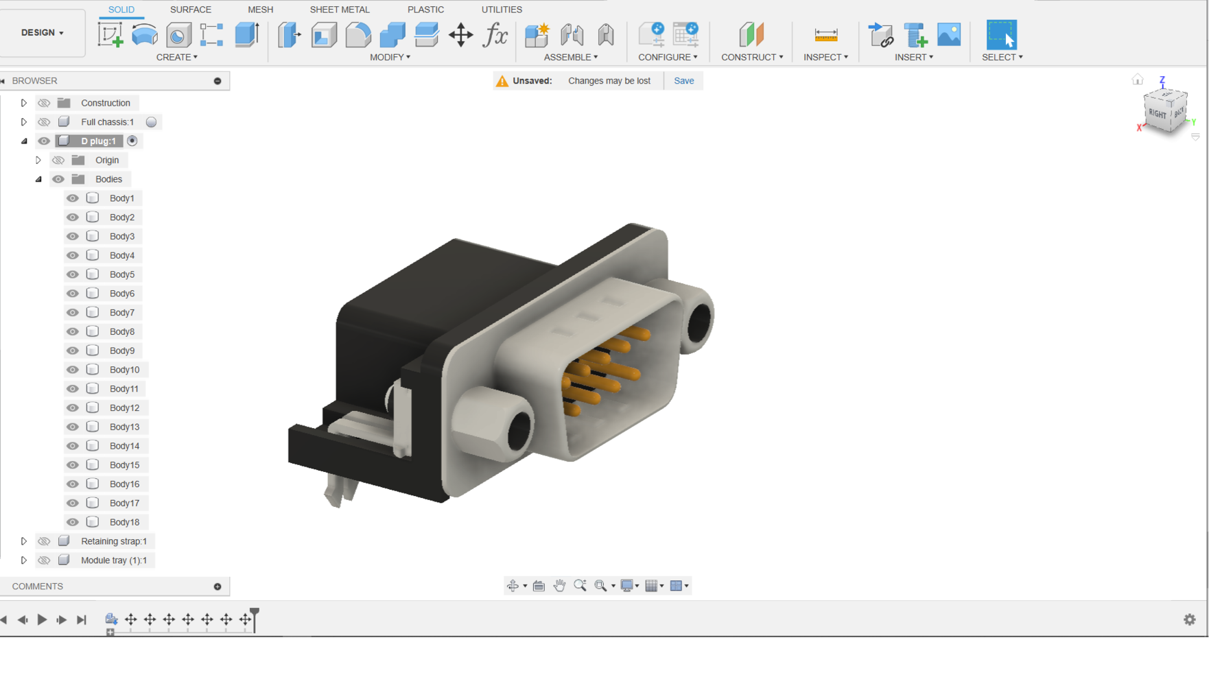

The D type component I tried to use as a cutting tool, but whatever I did, the component became embedded?
Could you elucidate on the D plug please? I thought that I could use it as a "punch" but I could only merge it with the panel, rather than cut it away using the shell of the D plug which I though that I could do.
Keep your head about you, to just exactly where your working (the base model, not the assembly).

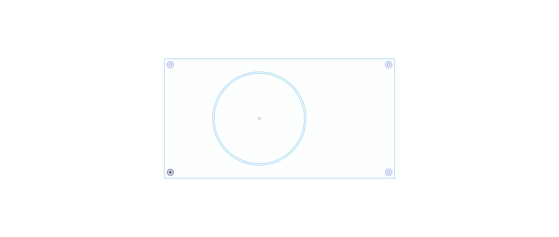

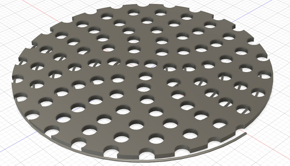

Like this - you can see the spiral path that generated the pattern...I would probably use a spiral and pattern the holes along that.
Use the coil tool - in will create a solid helix/coil using the optionshow do you draw a spiral in 360 ?
easy when you know howUse the coil tool - in will create a solid helix/coil using the options
