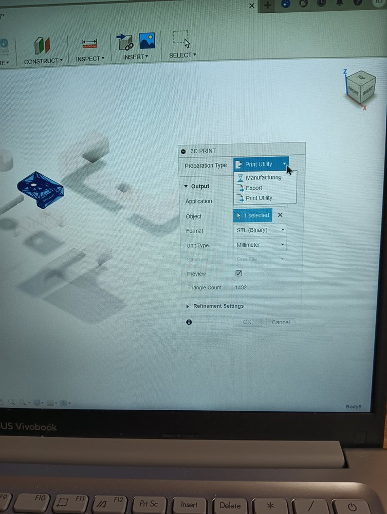

Always been two ways as far as I know but I keep going to the wrong place and there are fewer options to choose from including No STL option.exporting is how i have always done it... didnt know there was another way ?
Right click on body, select export mesh...confirm settings hit OK

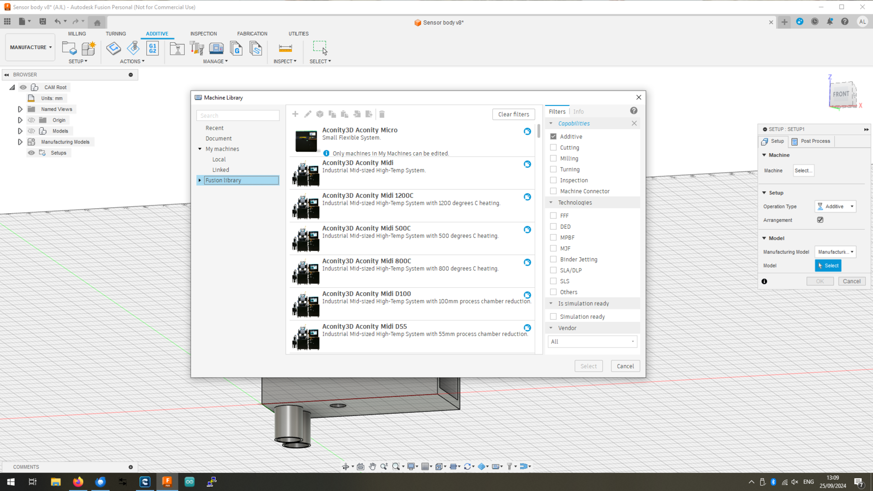

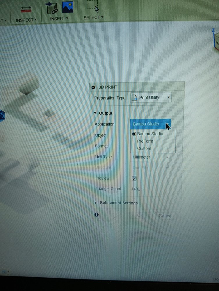

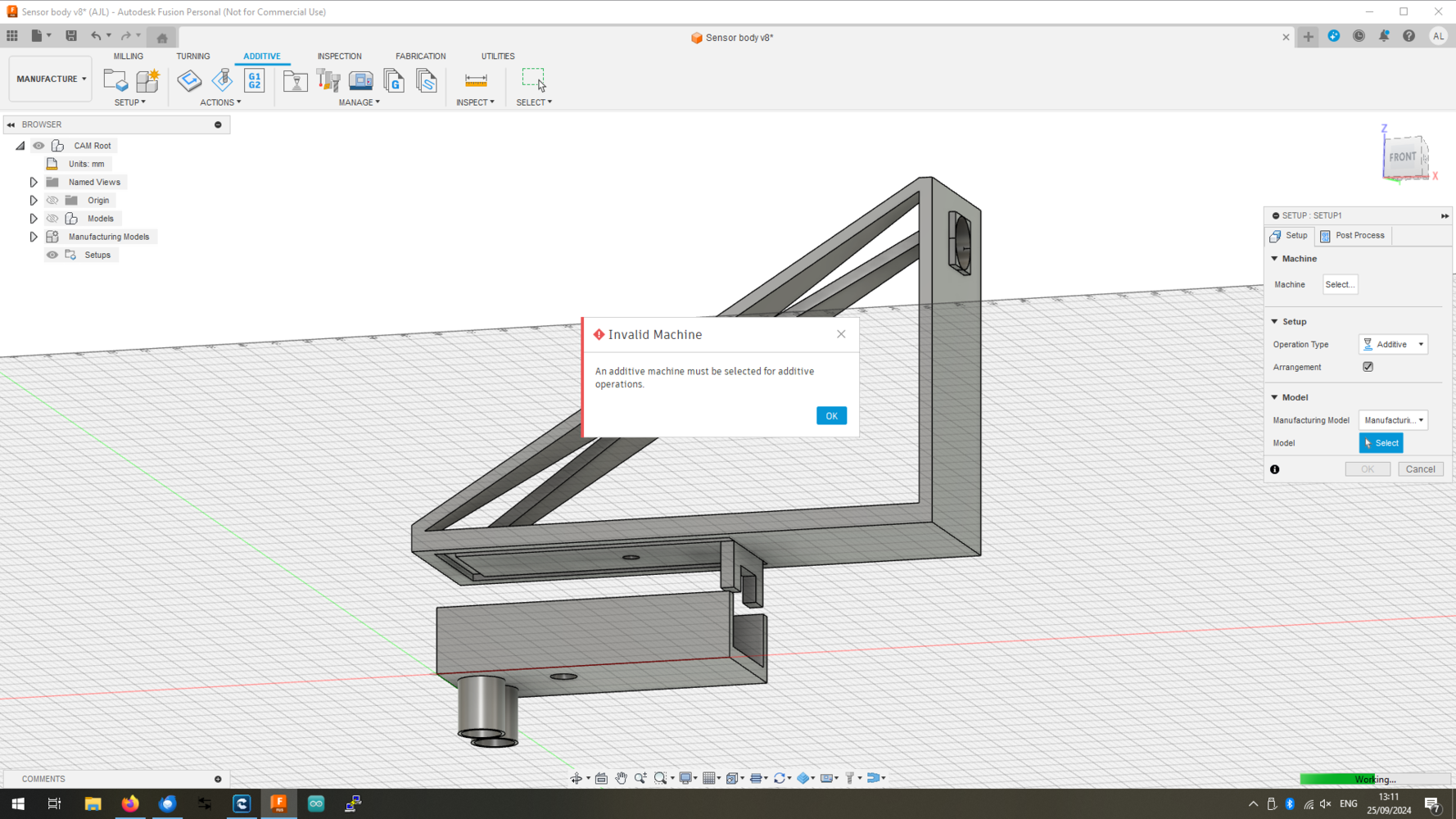

I just tried mine as it would open the slicer last week. Now it doesn't even have support for Bambu. Seriously thinking of dropping it.
Yes and fusion would open it from the manufacturing tab. Not anymore.Doesn't Bambu have it's own slicer?
Edit, yes it does, they have moved it so it's in a different place!Doesn't Bambu have it's own slicer?
Panic over![]()
