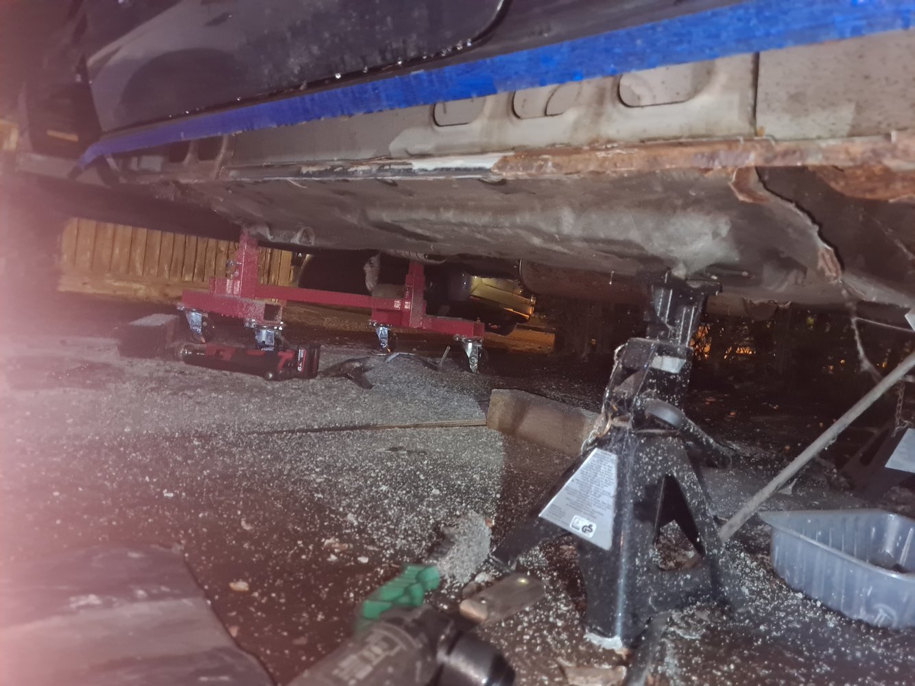

i was thinking that myself. i acquired a bucket full of scissor jacks over the years for doing that, so it's not something i would rush out to go and get. but they do look like handy things for pushing plates up.Those caravan stand look handy, how high do they go?
i've got this habit of when the wheel comes off it goes straight underneath squeeze a wooden block on top, just incase the car does go,Nice to be able to wind them up snug as I never get under a car without at least 2 different sets of supports under it.
a bit of extra backup protection. also serves as bit of a pillow to rest my head against the tyre.

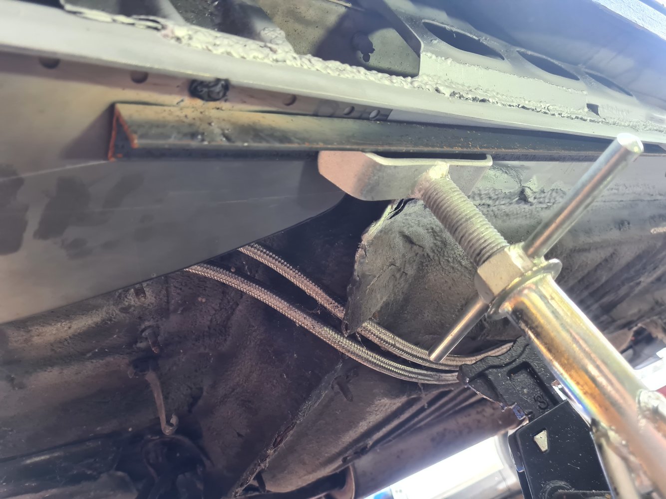

not seam welding that then?
Are you going to lapweld it?

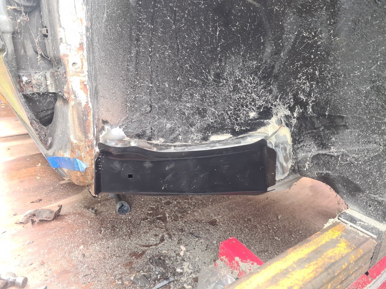

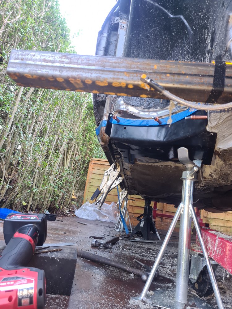

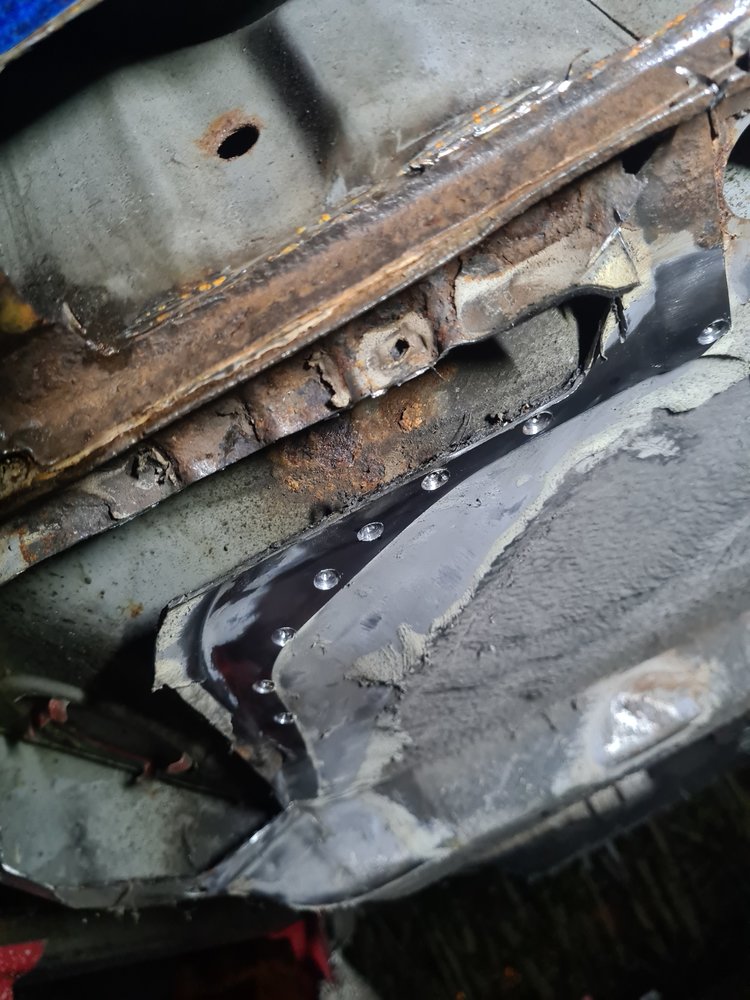

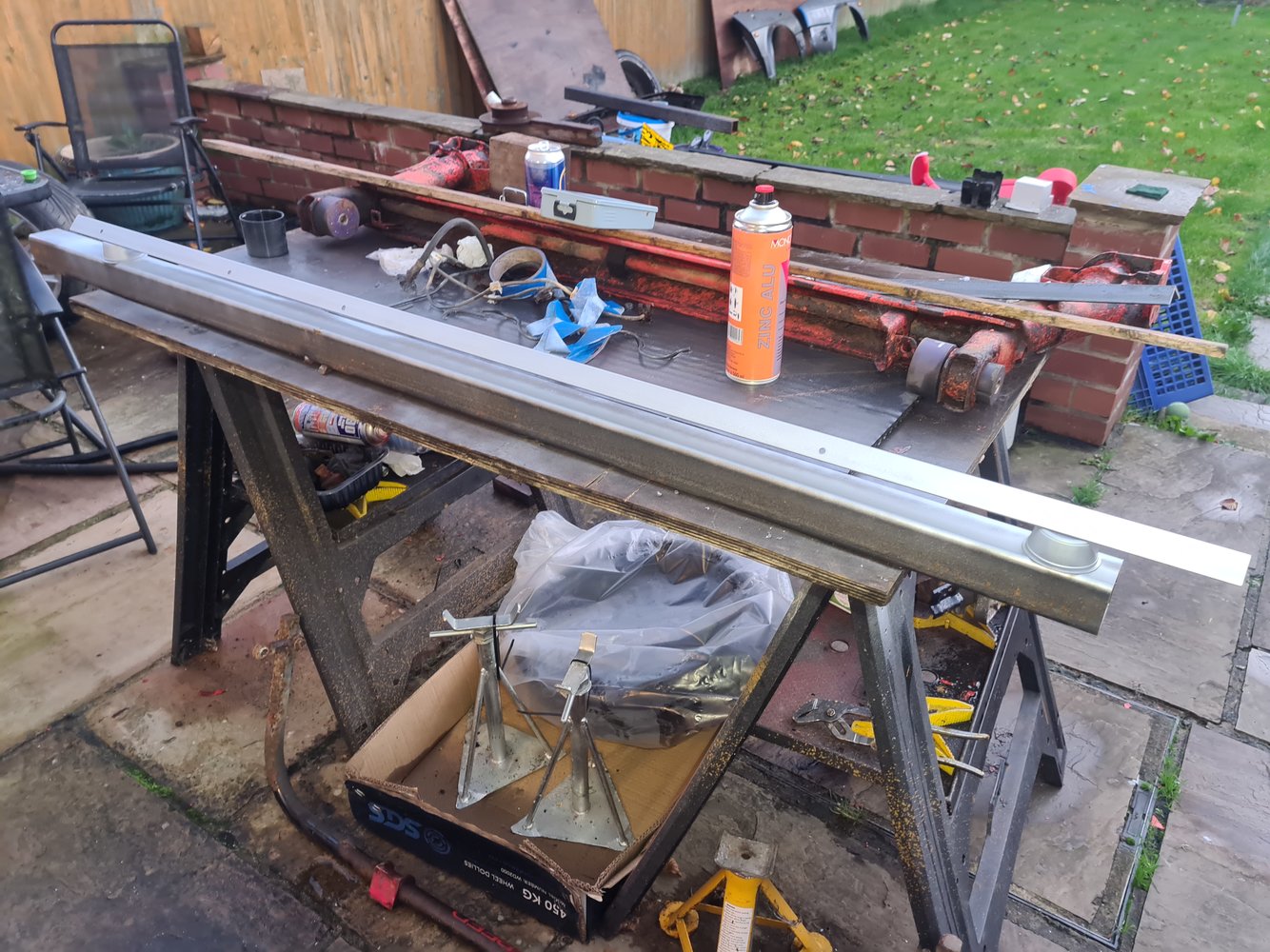

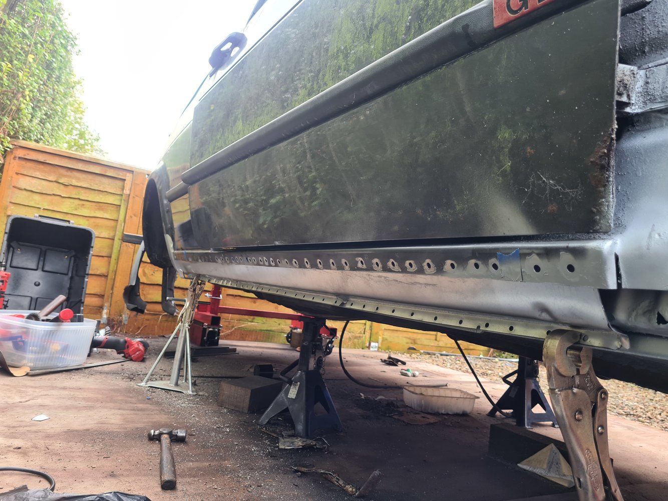

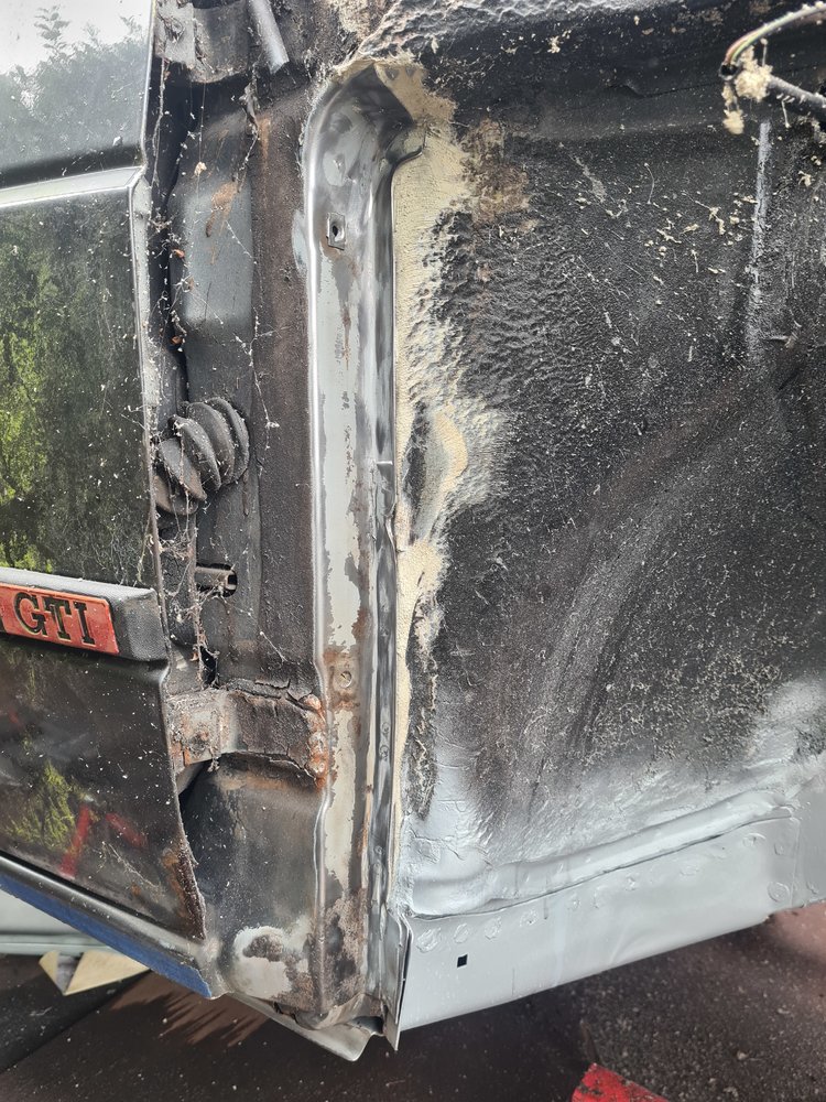

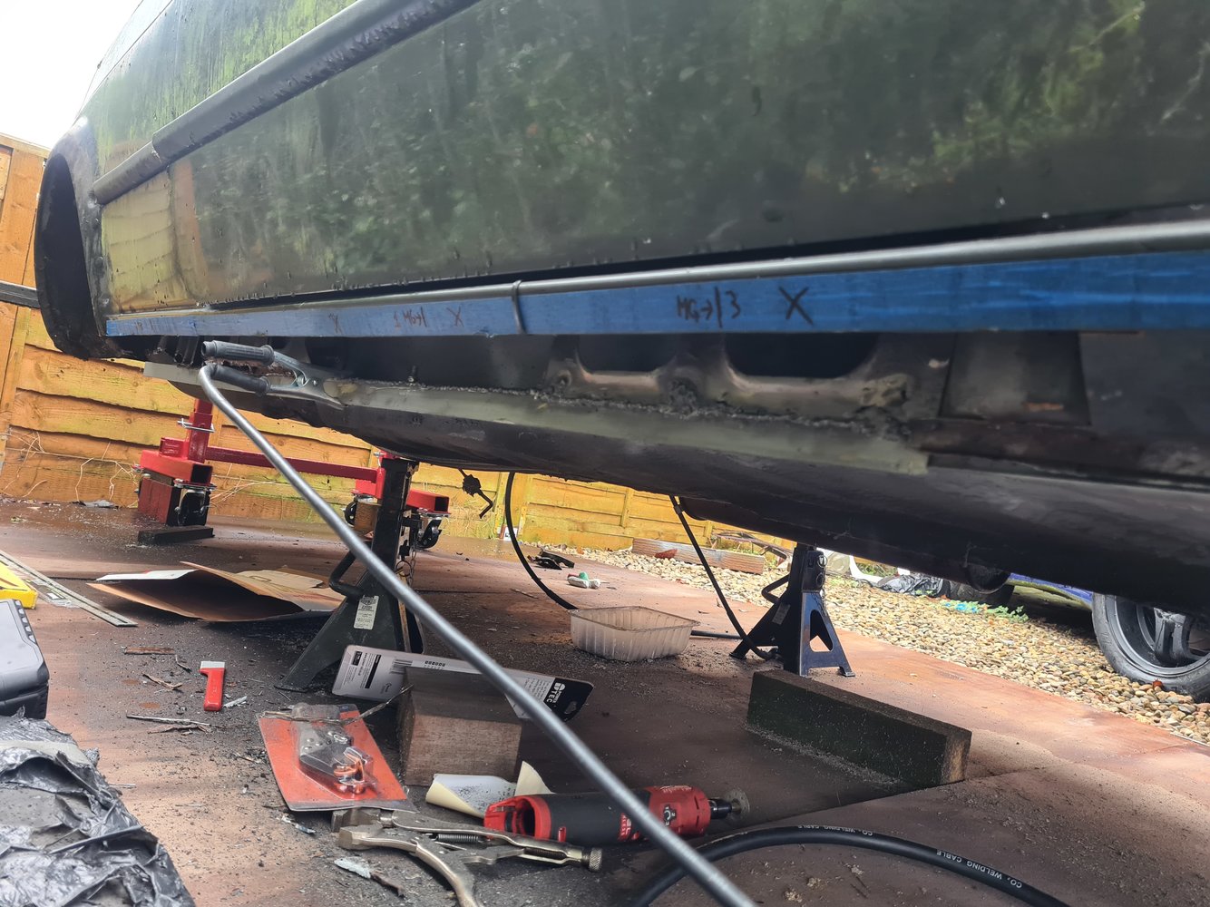

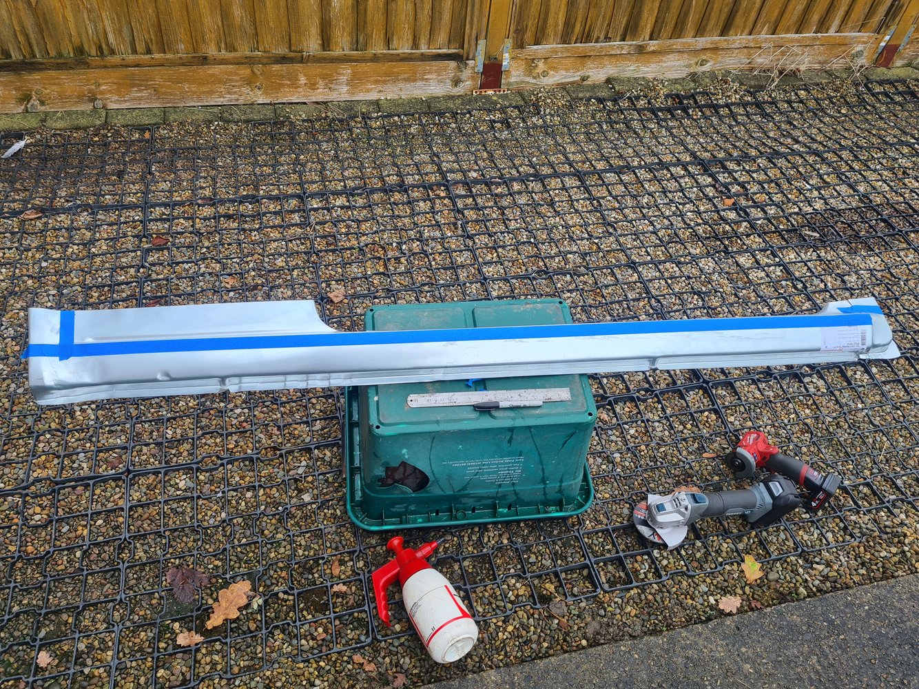

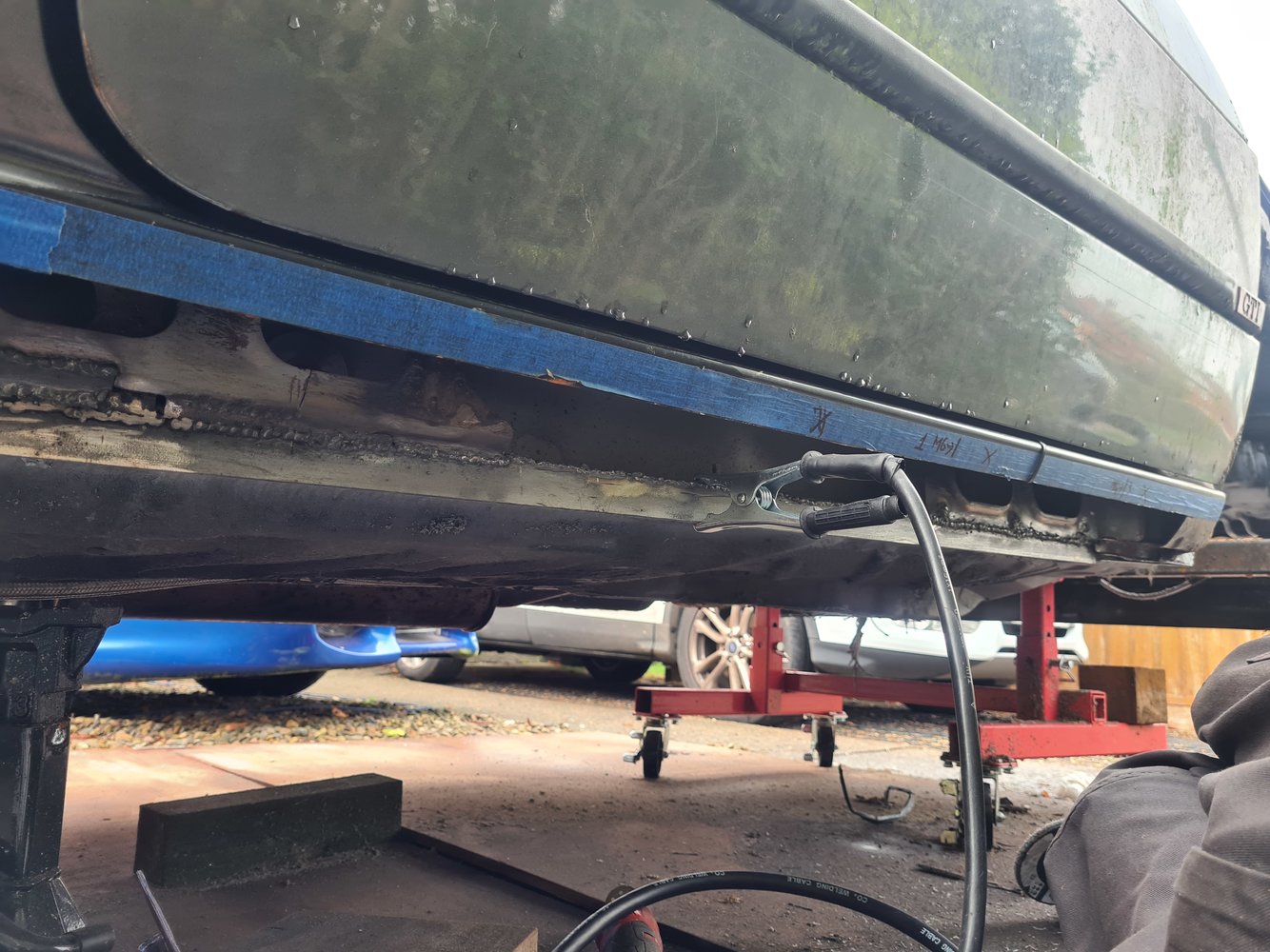

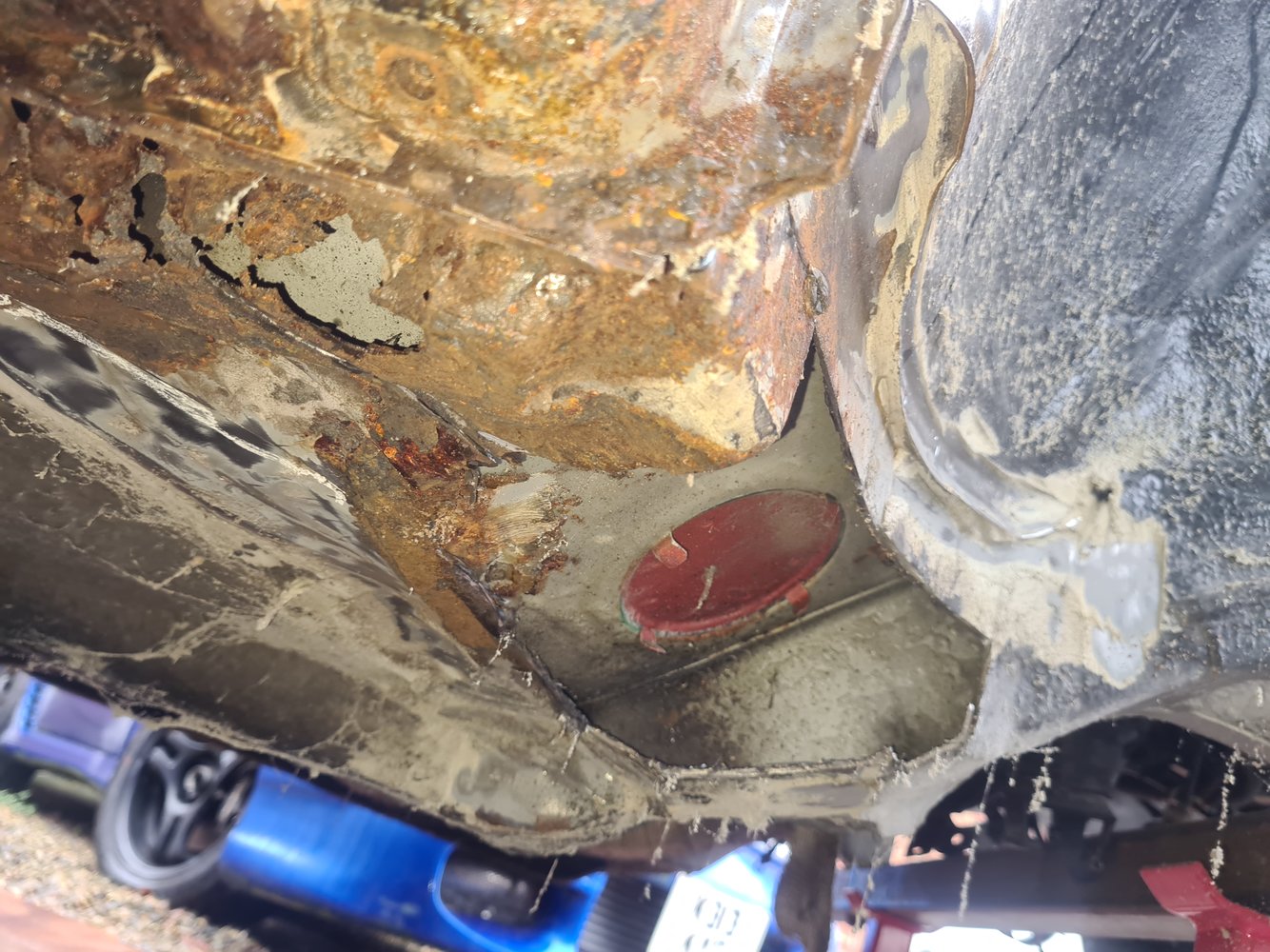

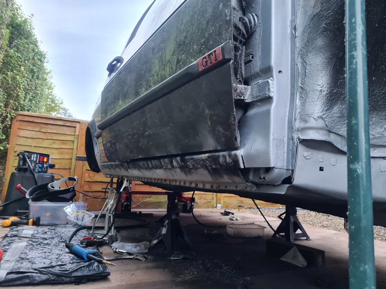

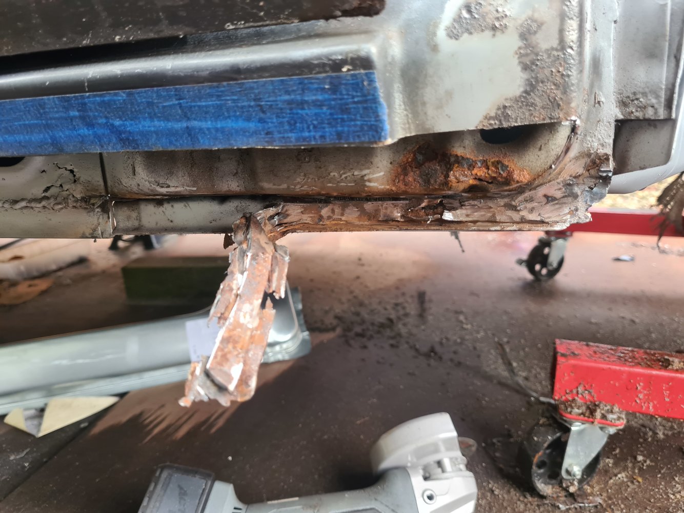

Well done for tackling this outside in the winter!Weighed up my options and seeing as all the rest of the sill is solid and rust free I went for a partial sill replacement.

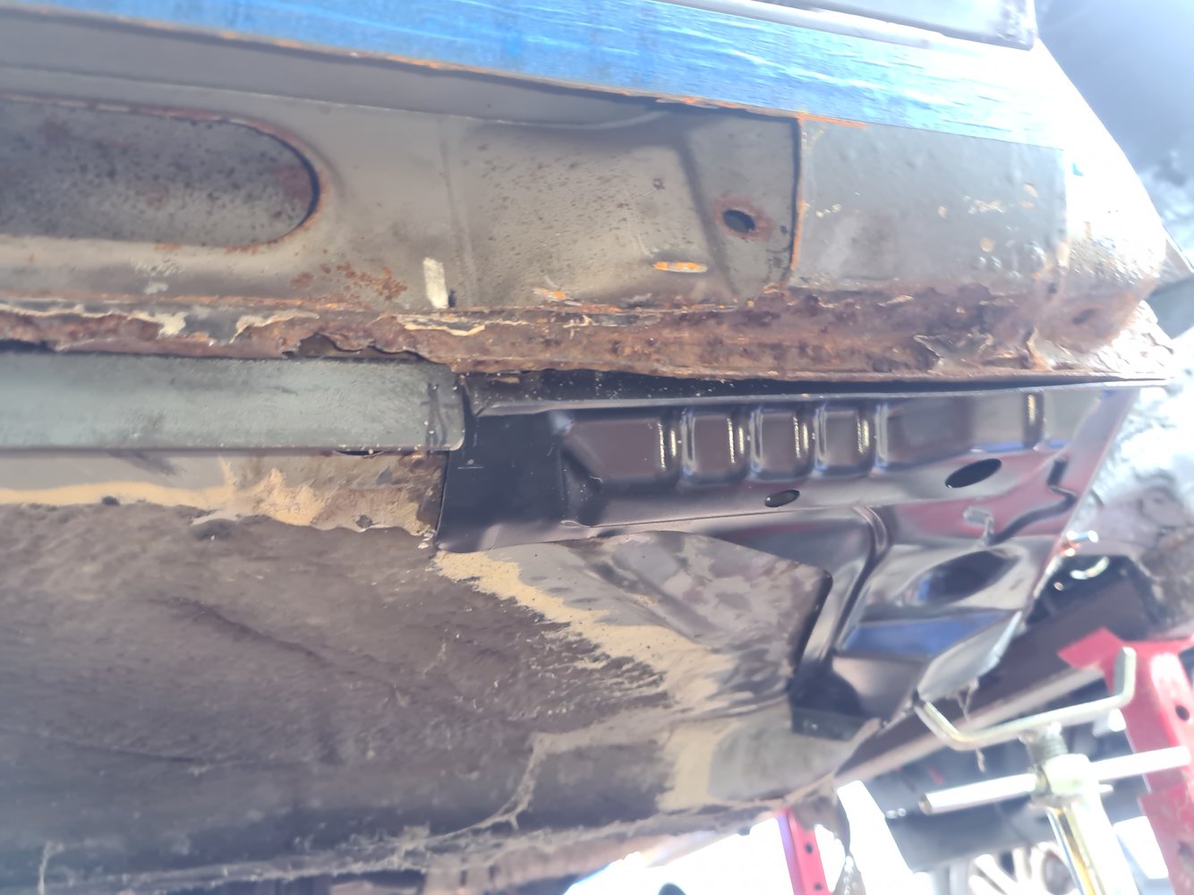

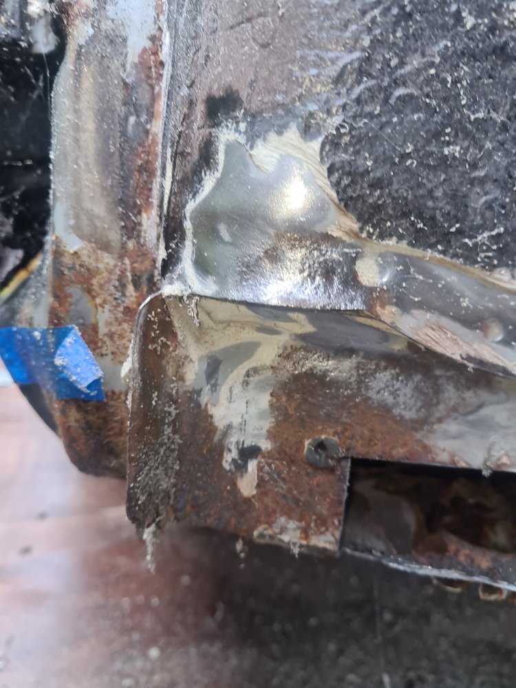

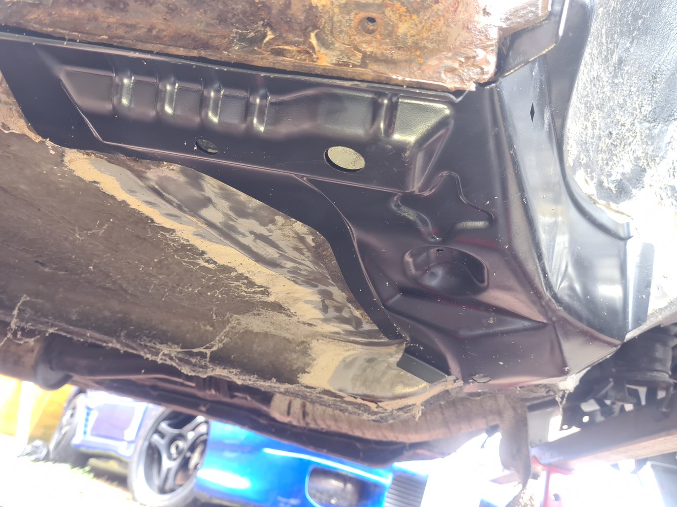

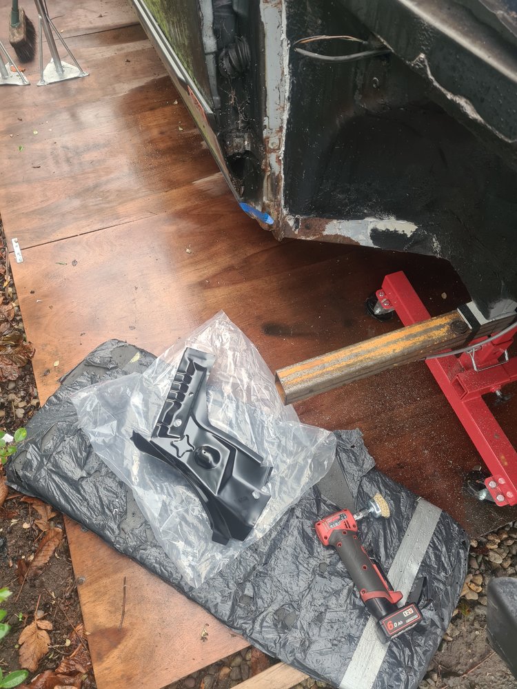

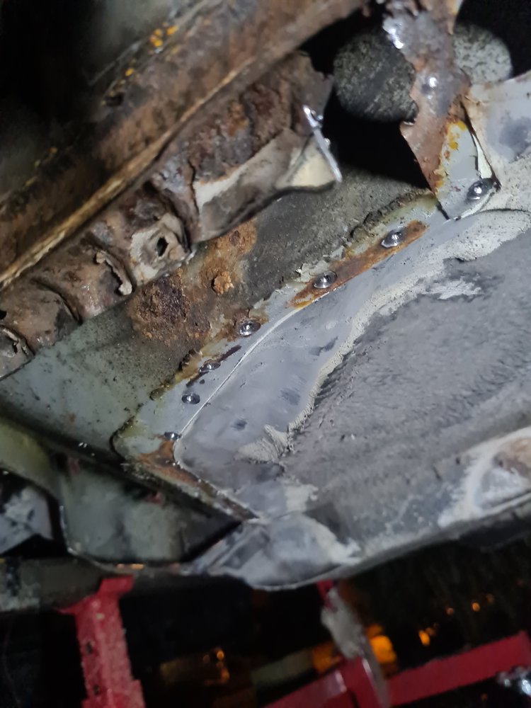

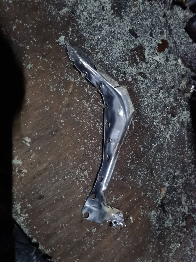

Spent an hour taking front corner to bits removing remains of old sill bottom and taking half inch thick underseal off to check for rust then started on new sill panel.

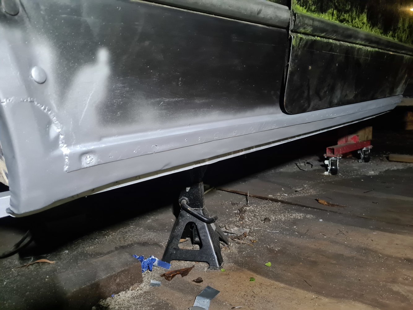

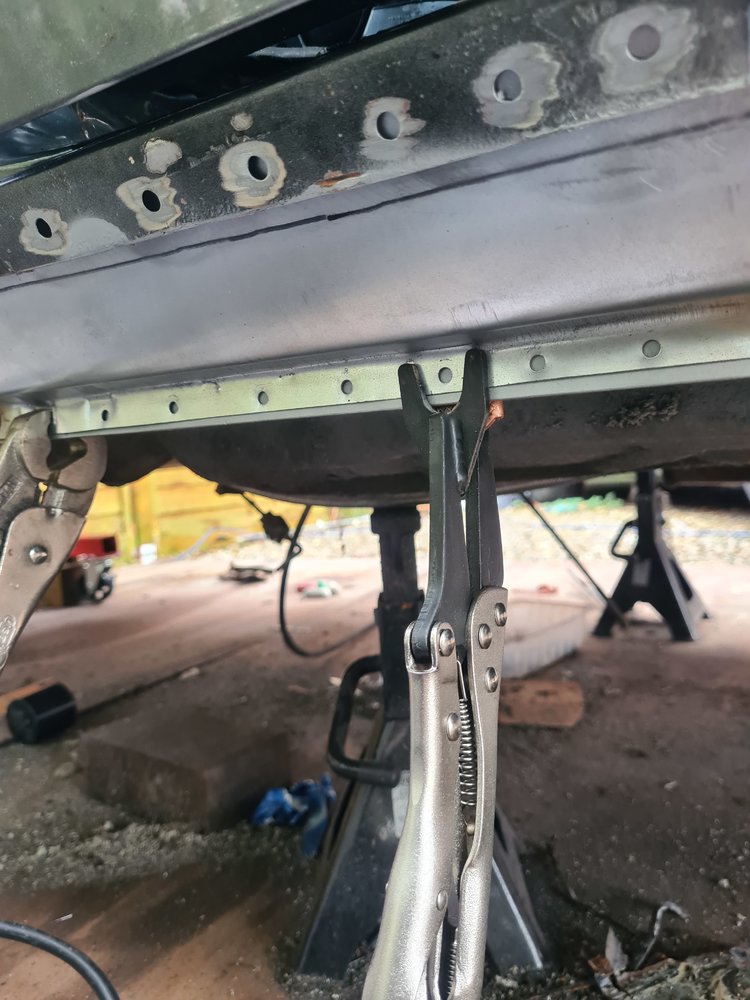

When it's done all the welding will be covered by the "big bumper" sill and arch trims.
Happy one side is done bar some filler and paint, half way there just other side to do now!.

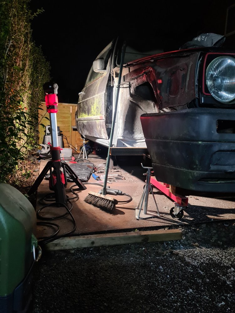

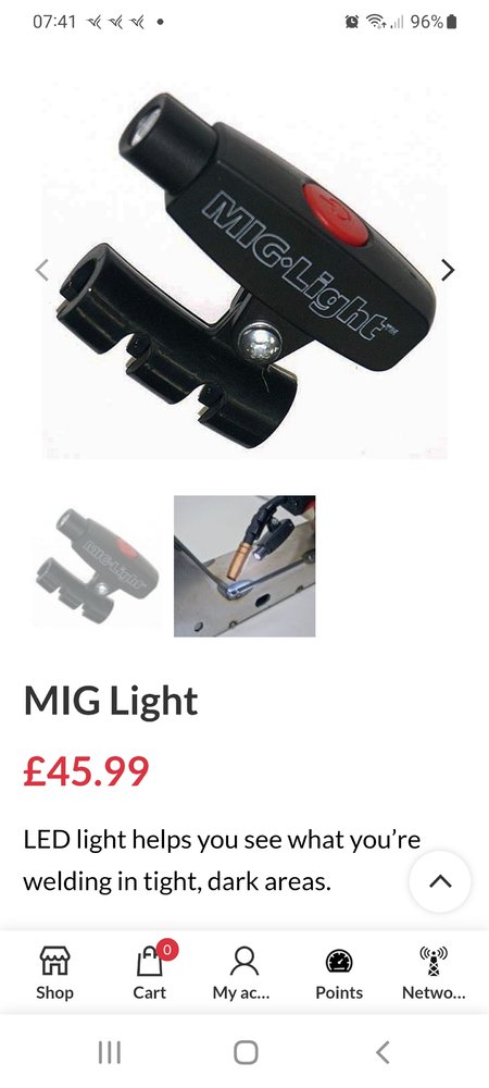

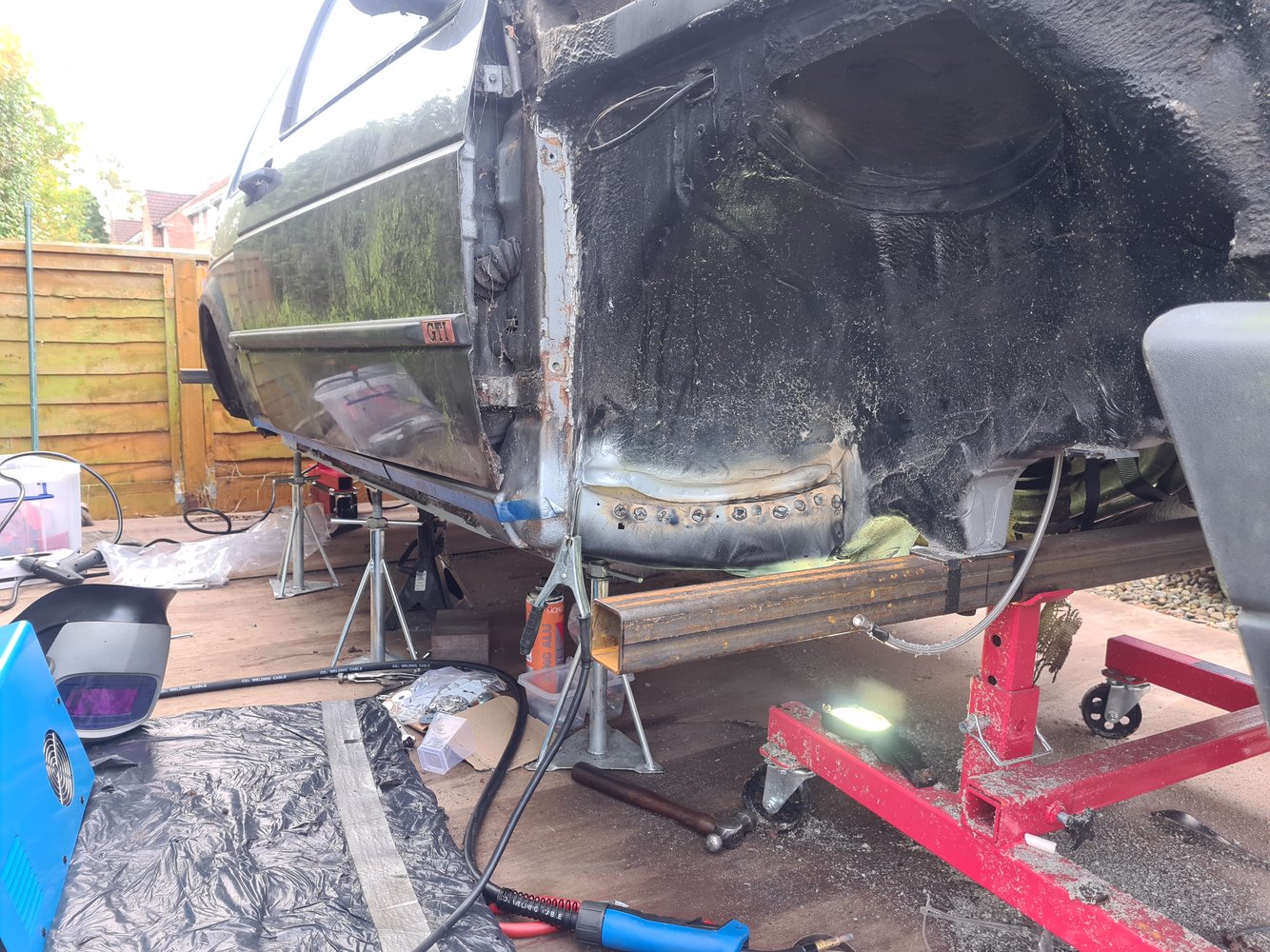

Cracked the Milwaulkee M12 floodlight out, getting dark at 4 now.
Need a torch for my Mig torch really, was struggling to see!.

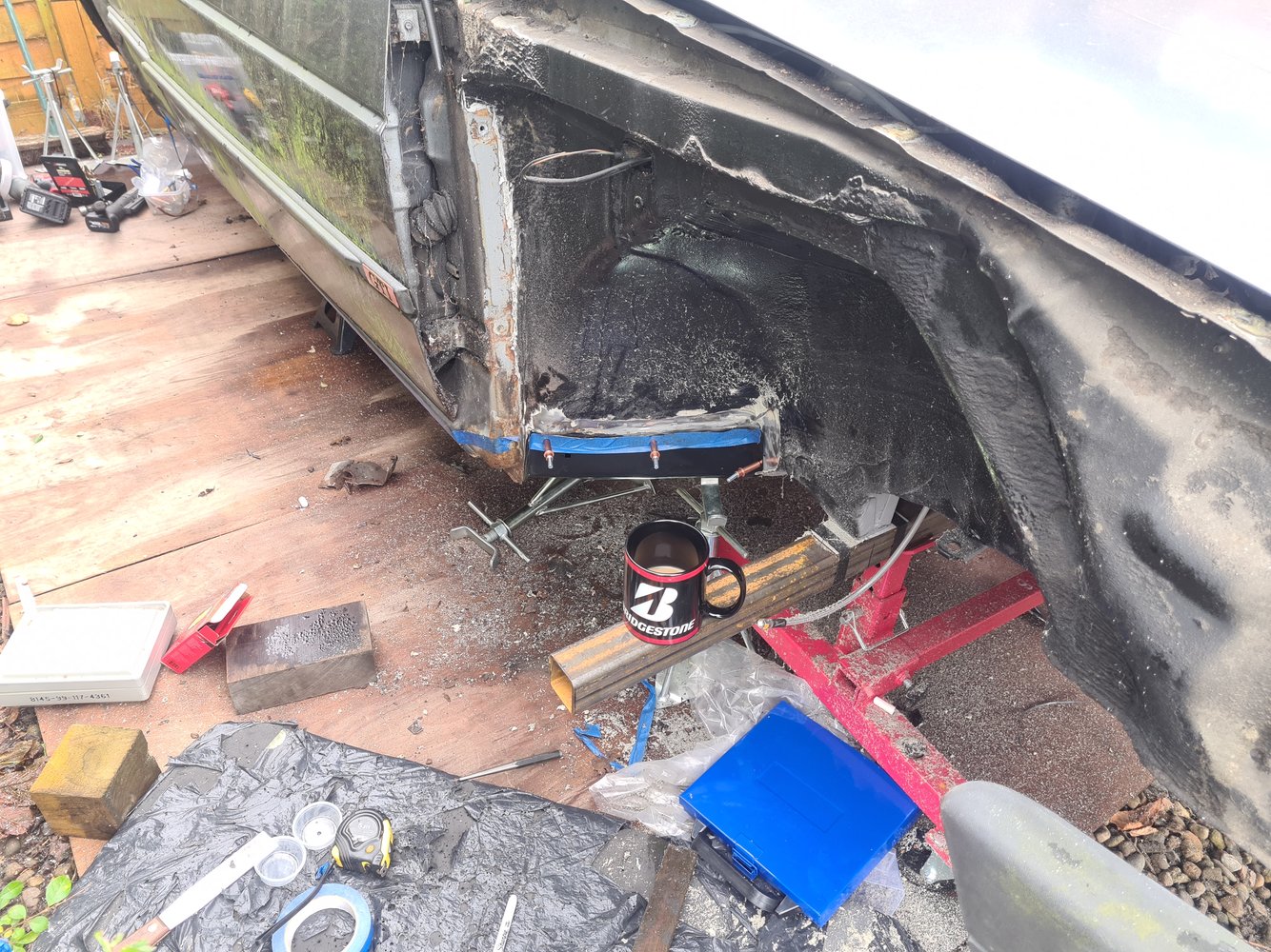

Welder on 38amp 15v and Lincoln wire did great plug welding panels. Didn't blow any holes through but got some decent heat into it.

Re the rear wheel well being a walk in the park - good luck, never in my experience was it one.
