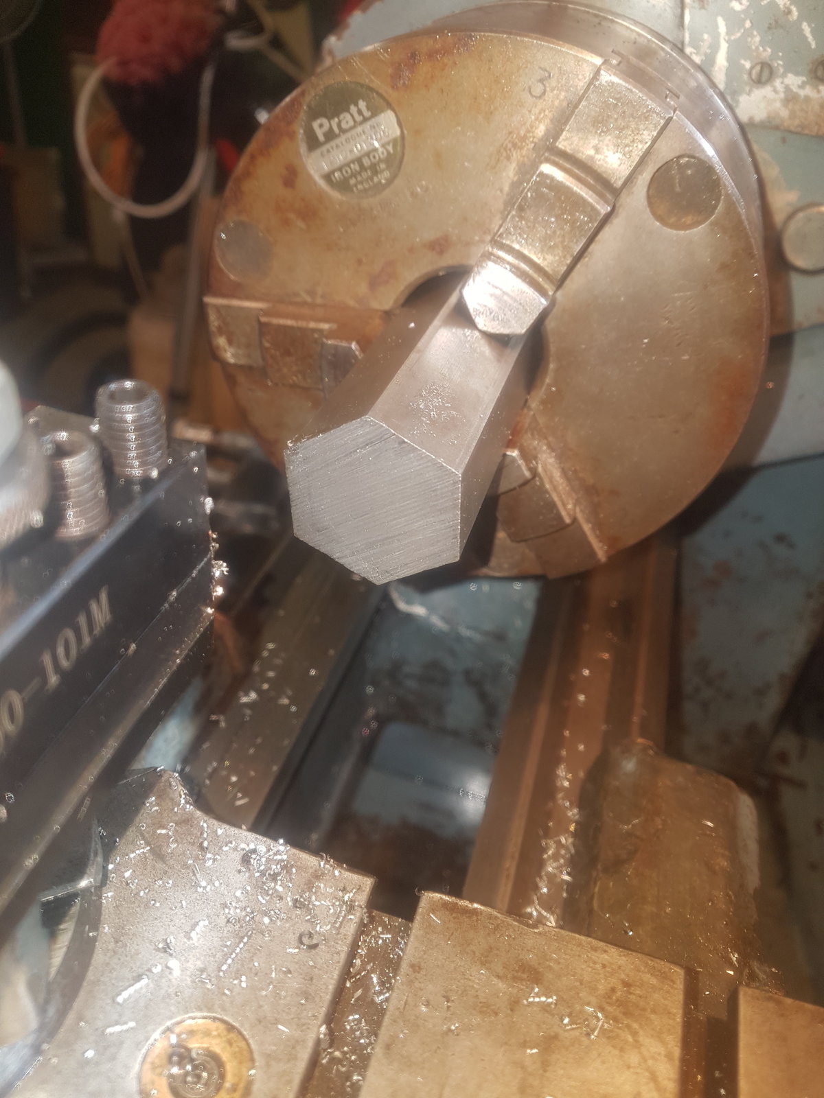

Ok so the stock does not have to stick inside the chuck then that's okDepends what you mean by bigger stock. As long as enough of the jaw threads are engaging the scroll it shouldn't be an issue.
What happens with long stock that's not supported at the tailstock end is it walks.
Each rotation under pressure it will move a fraction out of each Jaw until it flys out.
Much like wiggling a shaft to ease it out.
