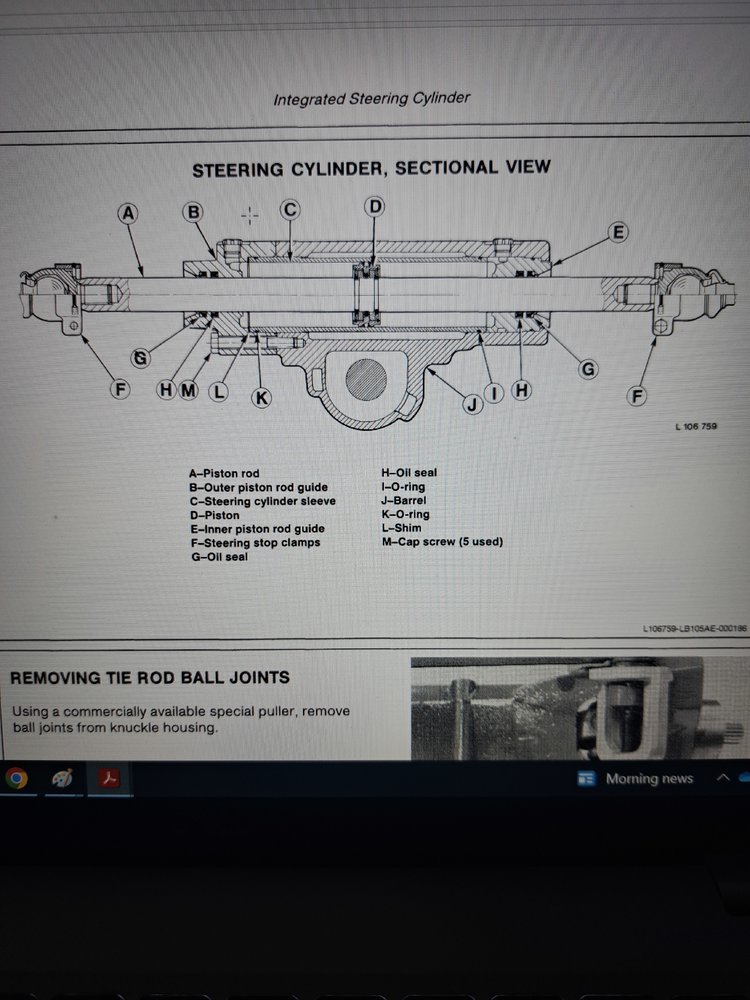

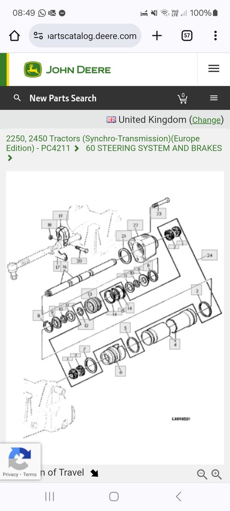

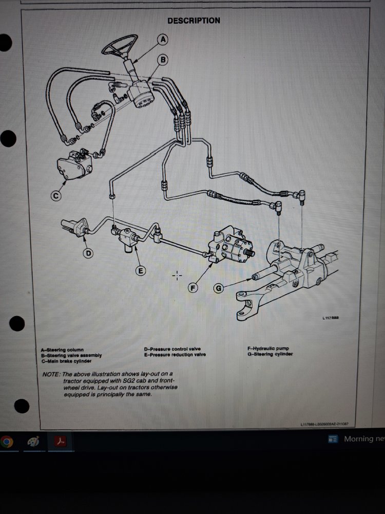

Thanks! I appreciate all the advice. All the experts I need to be near to are always at the other end/side of the country!!Unfortunately with an internal leakage issue, pressure gauges are of limited help. With the front of the ground you will need far less pressure to steer, so fault will be less noticeable. Wider or twin tyres that increase steering pressure would show it more. Perhaps just try a hand pump on the steering cylinder and see if there is leakage out the opposite port, would be best done locking the steering in the central position, as that is where wear would be most likely. Sorry, wish I was near you and I would come and help.
