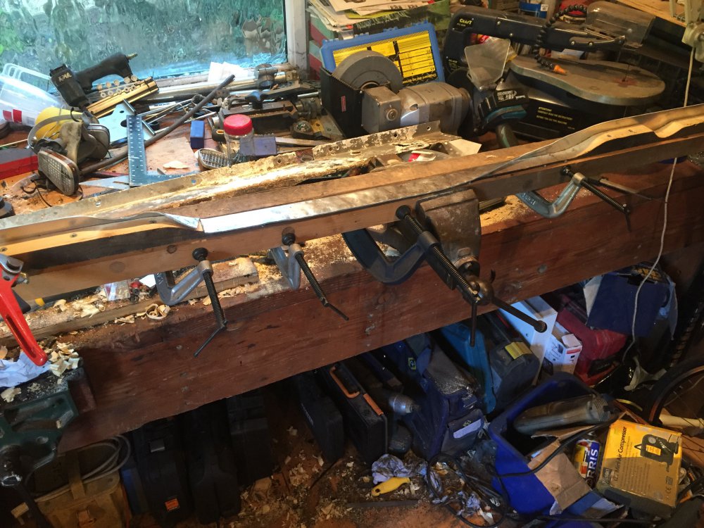

I could probably do it just not sure I can get it got enoughWell, you say you can't weld Ali, but I got stuck with a bit of Stainless last week, so I bought a disposable bottle, and a small spool of stainless wire and had a crack and it turned out not bad.
Of course, Ali for the MIG is more involved and expensive because you need to buy a teflon liner and you need pure argon, I reckon it would cost about 50 quid for dispo bottle of Argon, regulator for dispo bottle and liner from weldeqip, plus the wire and some 1mm or 1.2mm tips so maybe 70 quid, but I have never done Ali with MIG and don't know how it performs on thin stuff, needs someone else to advise if its practical.Might have to change the rollers as well -not sure.
If its workable, you have a set up for small Ali jobs that may crop up later?.

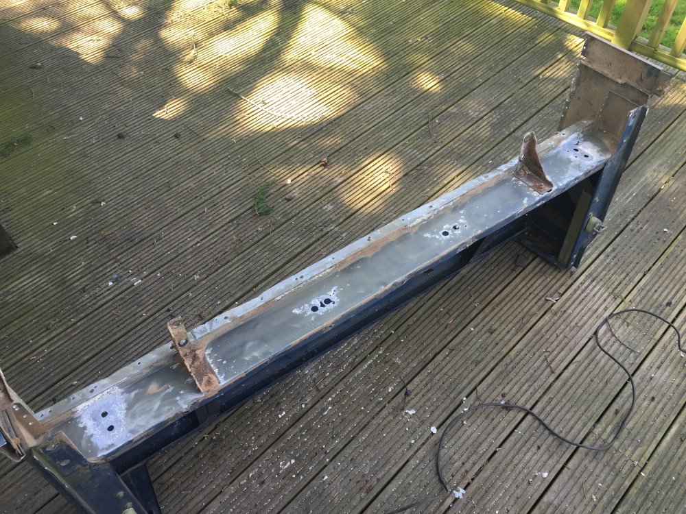

and like you say it's an expense. I wish I kept the Ali kit I had for my old welder. I just want it done yesterday, it's been one thing after another with this rear bulkhead now. And I don't know what to do about it. If I drill out the welds I'll need to have it re welded. No way around it.Do you have access to a spot welder? I have had limited success with spot welding aluminium using a bog standard Sealey spot welder.I could probably do it just not sure I can get it got enoughand like you say it's an expense. I wish I kept the Ali kit I had for my old welder. I just want it done yesterday, it's been one thing after another with this rear bulkhead now. And I don't know what to do about it. If I drill out the welds I'll need to have it re welded. No way around it.
I'm waiting to see if my friend has access to one. Hopefully he does, will save allot of messing about. I'd rather do it properlyjf I'm going to replace it. No point cutting corners.Do you have access to a spot welder? I have had limited success with spot welding aluminium using a bog standard Sealey spot welder.
Otherwise cut out the offending pieces and repair with Joggled patches and pop rivets.
Shame I am not closer as I could TIG in some patches, might be worth putting out a new post of AC TIG Welding Required Near X, with your location to see if anyone on the forum can help.
Omg thank you, I think I'll be sending you a message later in the week when I get my Ali sortedIm in Watford Kim , if you need it tigged I may be able to help , if you prep it I will stick it together !
thanks so much.Im in Watford Kim , if you need it tigged I may be able to help , if you prep it I will stick it together !

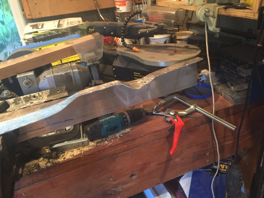

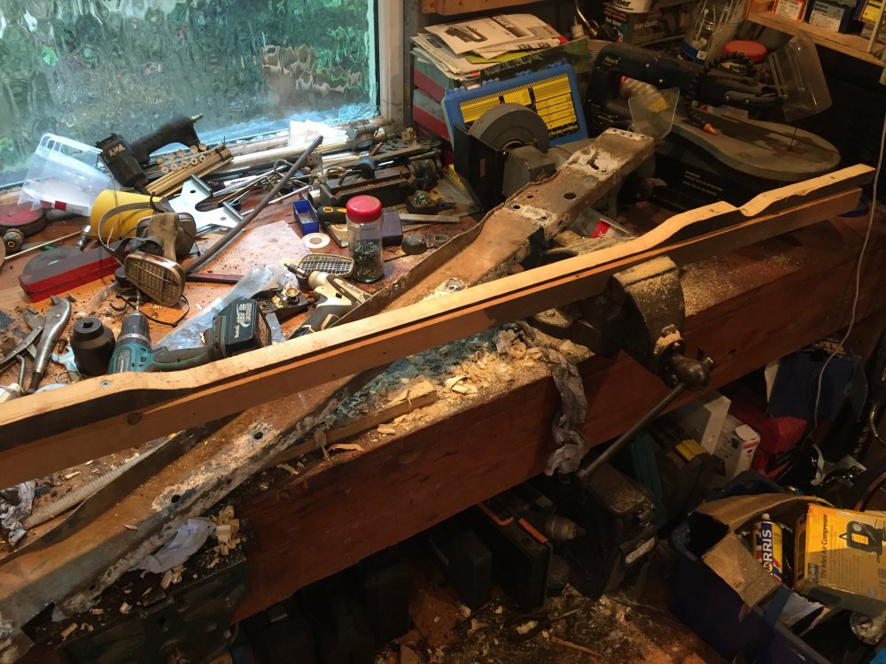

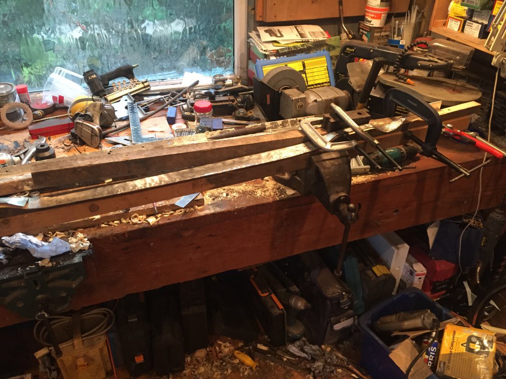

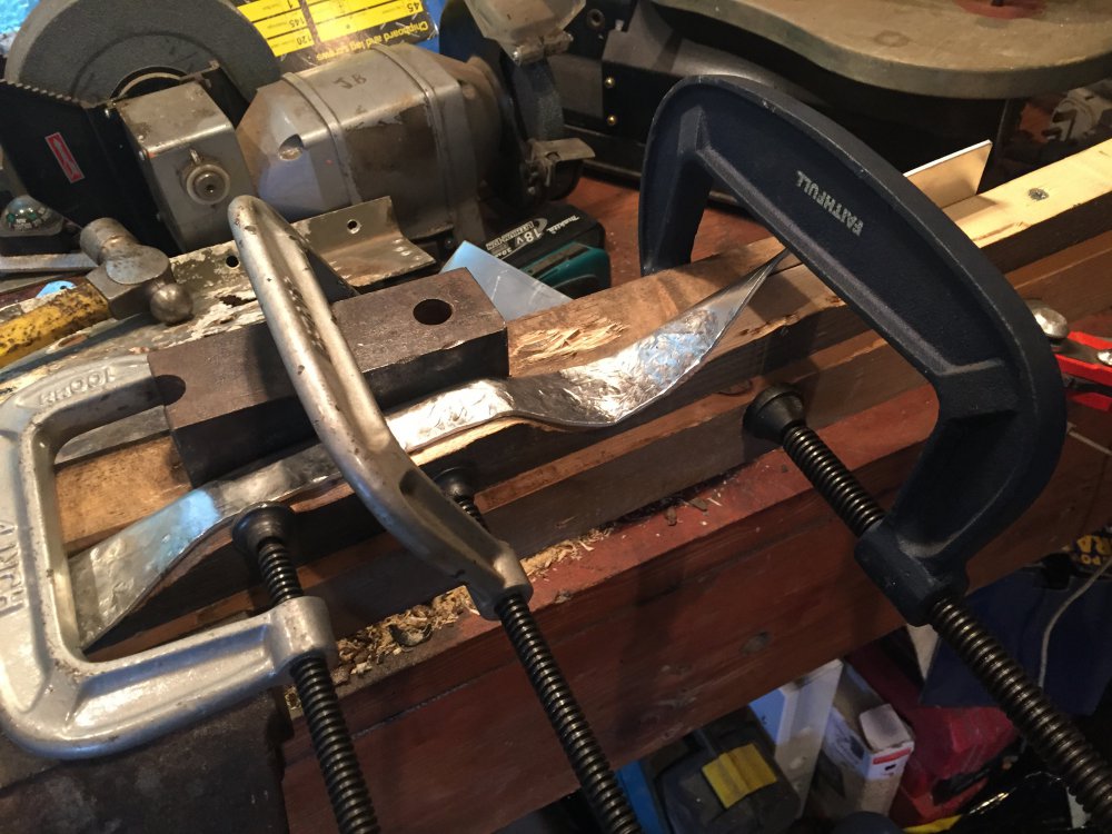

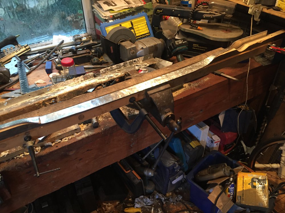

I didn't and regret itDid you try annealing the ally first. Depending how you get it it can hard, half hard or soft. Your looks to have been difficult to work so may benefit from being annealed. Coat the ally in soap and heat until the soap blackens, leave to cool. May need to repeat if you are working it a lot.
I did originally plan to do that but somewhere along the lines I either was told or just had the opinion that a hammer would sort it. I'll do that when I next attack it, literally. I may do it tomorrow I'll see. Plan now is to clean the weld edges. Screw it to my template with the peices butted together. Then form the rest and take it back down to have it welded again. I'll do it before anymore hammering.Kim bad luck
Are you annealing the aluminium between bashing sessions? If not it'll make quite a difference to the ease of forming. Wipe some hard soap on the aluminium, and heat with blowlamp until the soap goes black.
This has been a job like the bulkhead, me thinking its simple and turns into a huge job. My arm hurts so much from hammering. I don't think I'll do any more on it this week, well not the rear bulkhead anyway. I'll decide it's not been my week so may just get on with other stuff.
P.s sorry I've got nothing good to show
