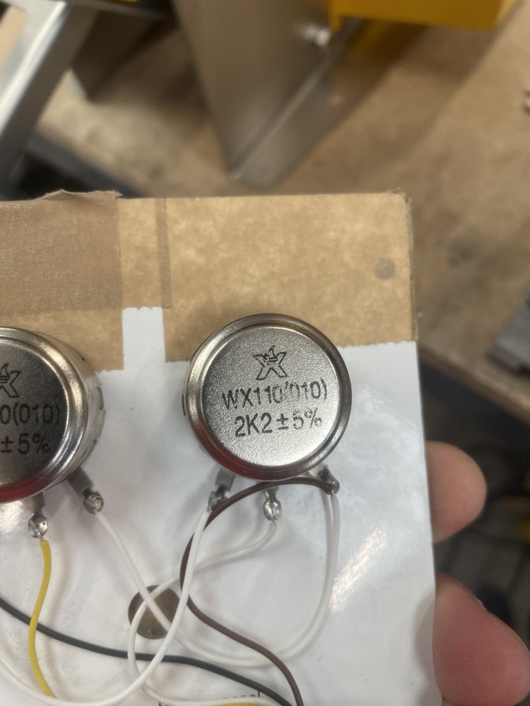

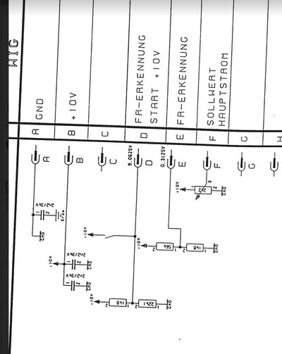

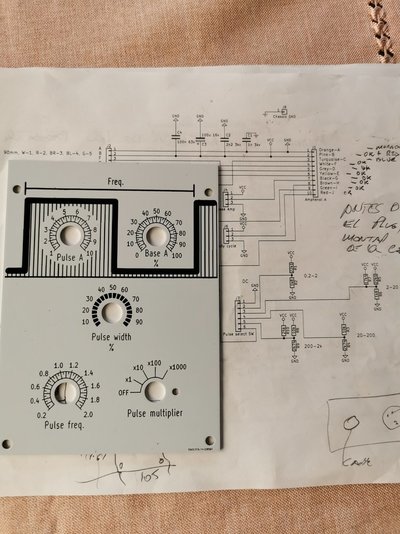

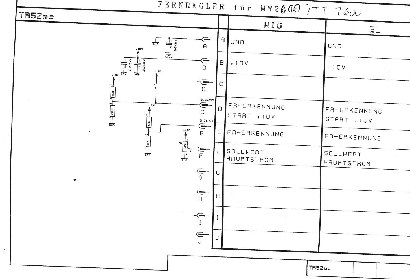

I cant see the pot value in the pdf that you attached, can you please confirm that they are 2.2k?
thank you very much
Mariano

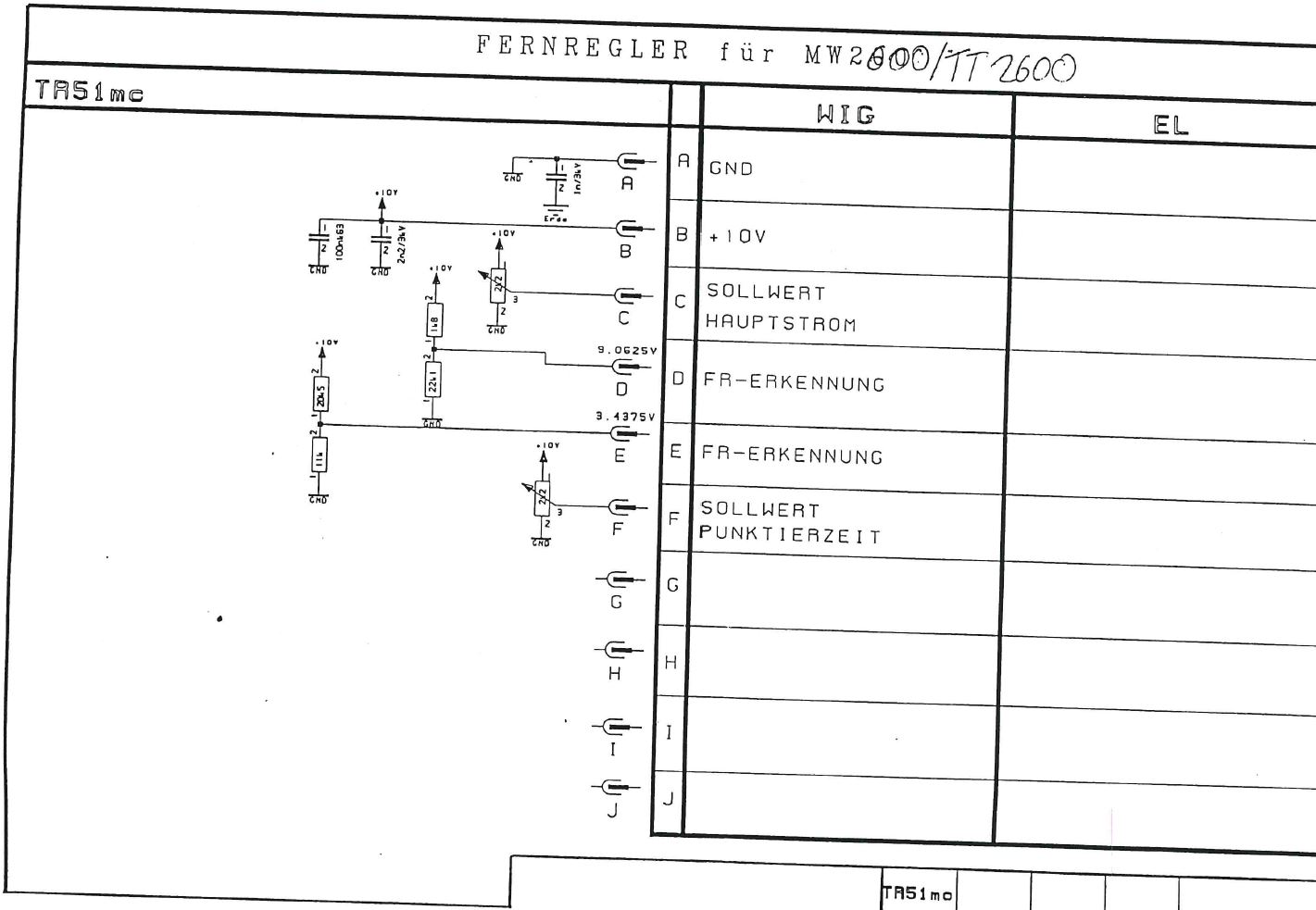

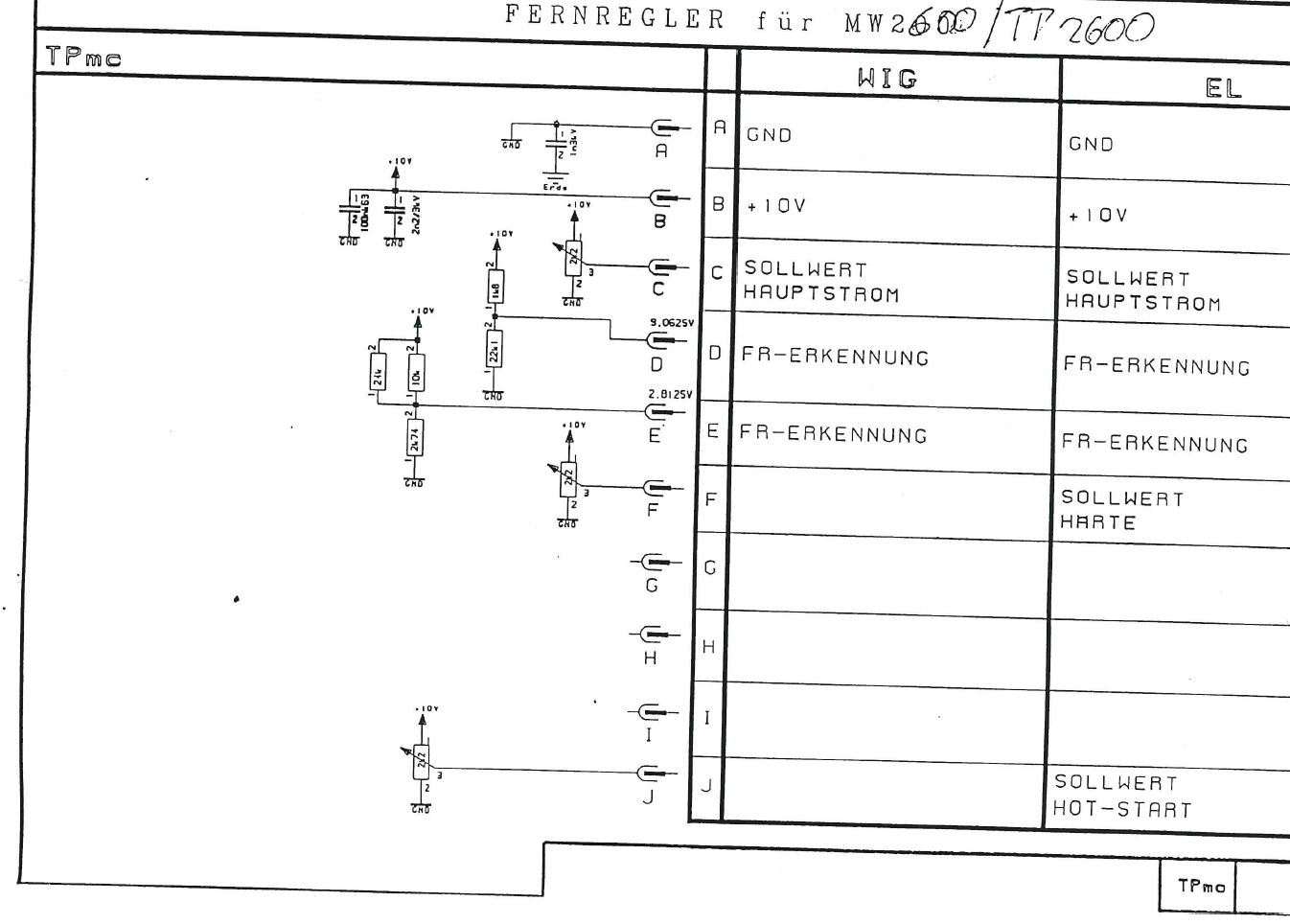

Hi Jan, I'm making my own using the design from Hugh. One thing that I will like to add is a pedal , I believe that you have made one in the past, but I can't find the link to itSorry for my late reply. Was traveling in the north the whole day.

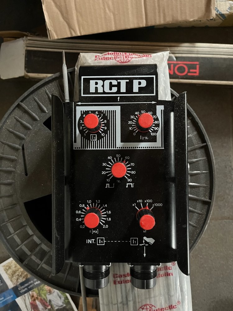

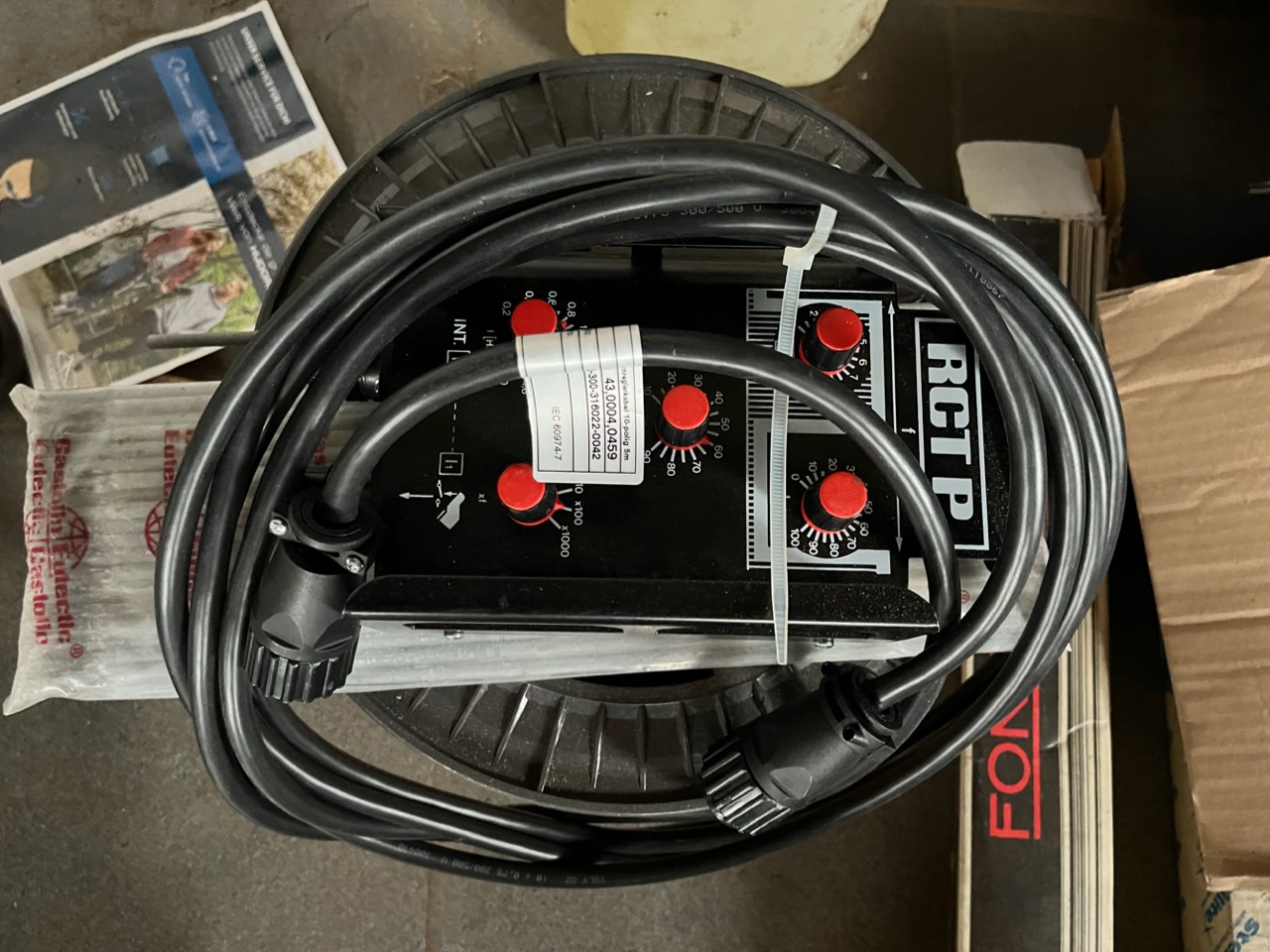

The remote is NOS and Castolin labeled.
5m extension also.
Paid 280€ for that and that’s what I want for that because I did not have a machine yet.

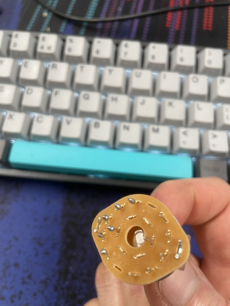

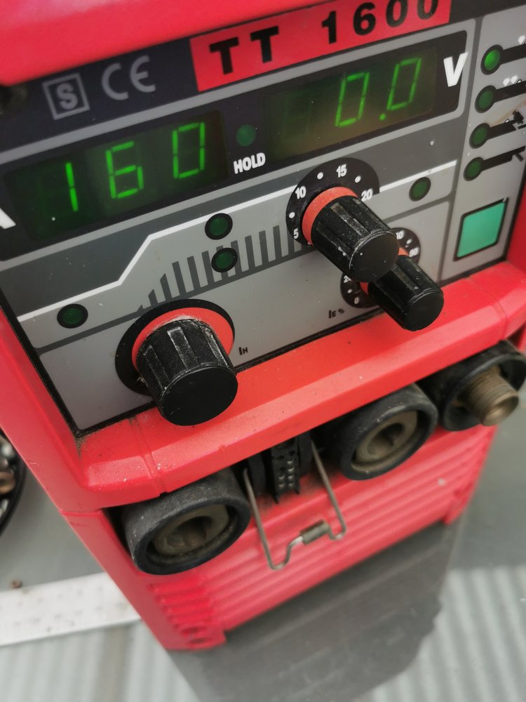

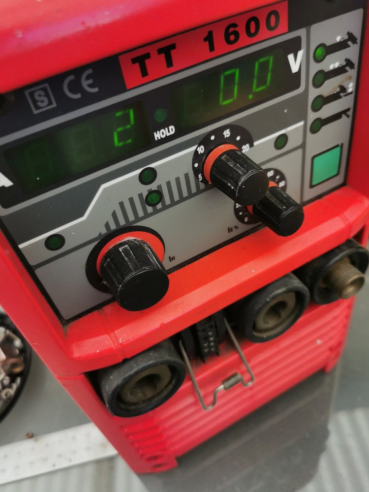

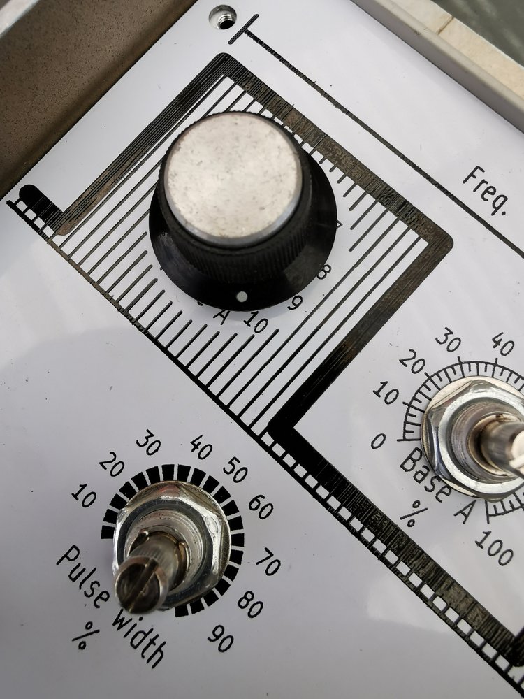

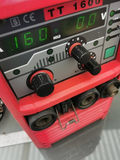

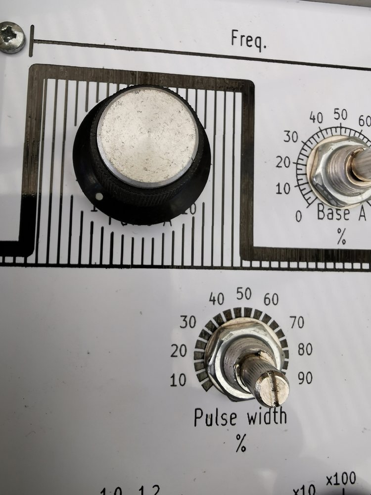

Hi Hugh, I finished the remote, and everything seems to work , ( no weld yet) however I think that I have the potentiometers wired the wrong way , because in the pulse A fully unticlockwise the power unit panel shows max amps (160) and fully clockwise it shows minimum amps (2) , can you please confirm if the pot is wired the wrong way? I'd so I will have to rewire all the pots.The pulse select switch has one common wire, and 5 wires to each of the switch positions, hence the 6 pin connector.
