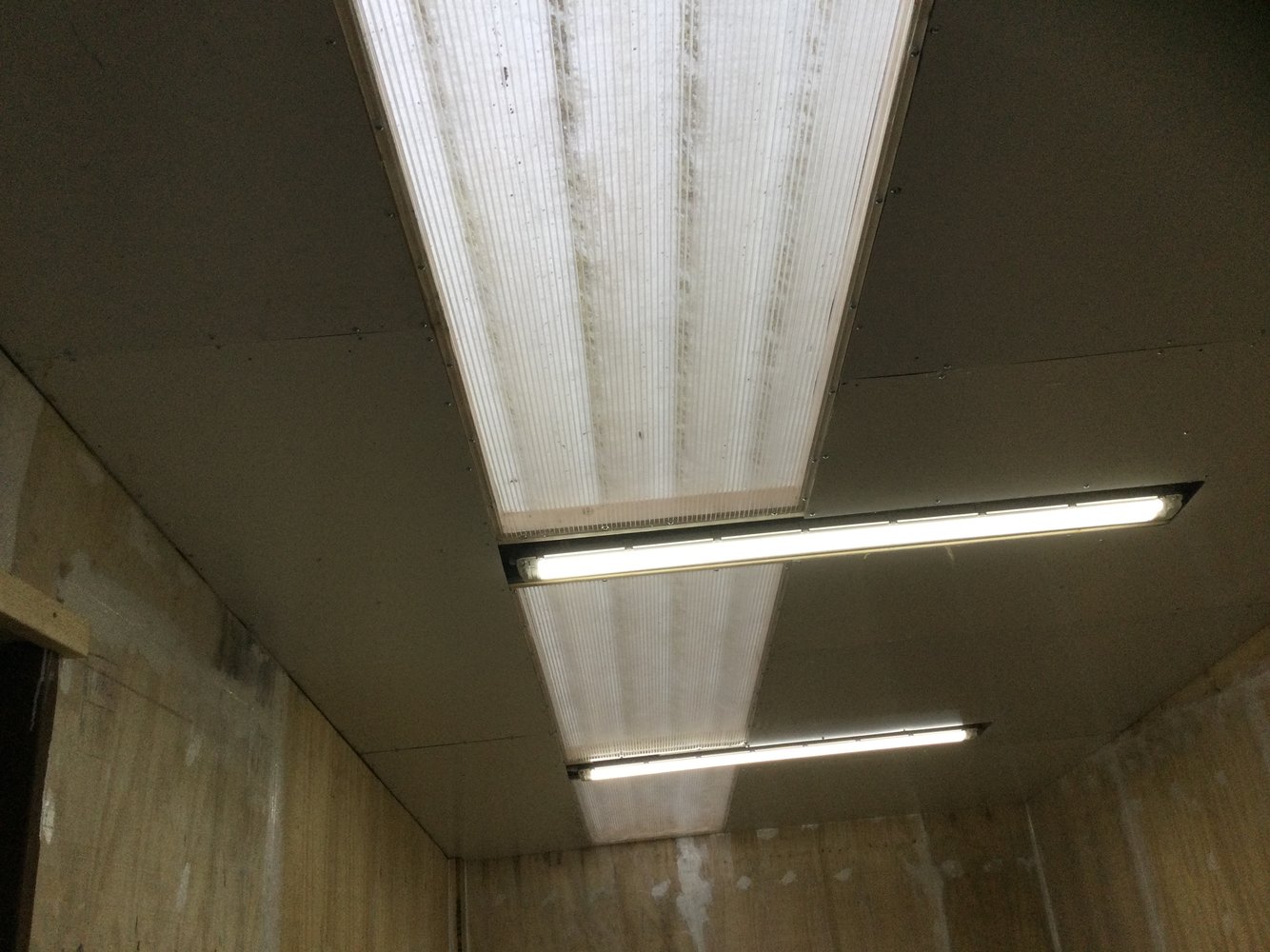

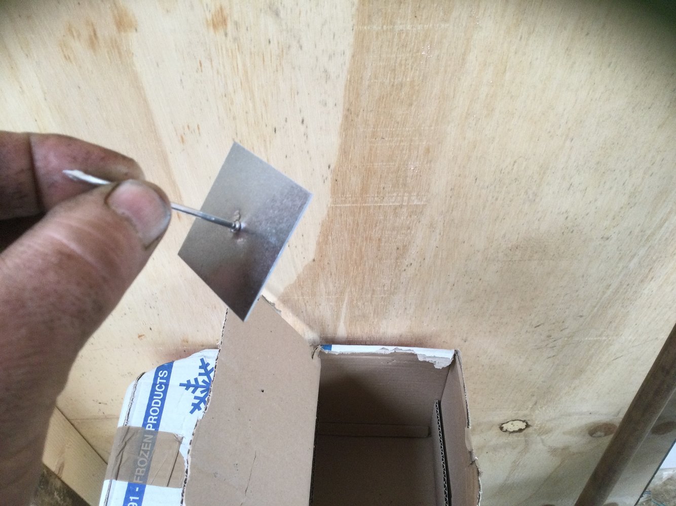

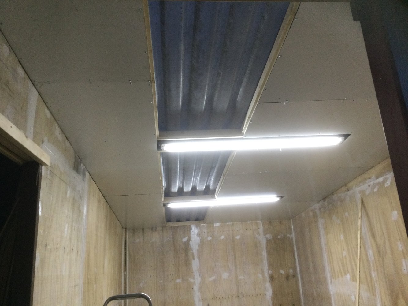

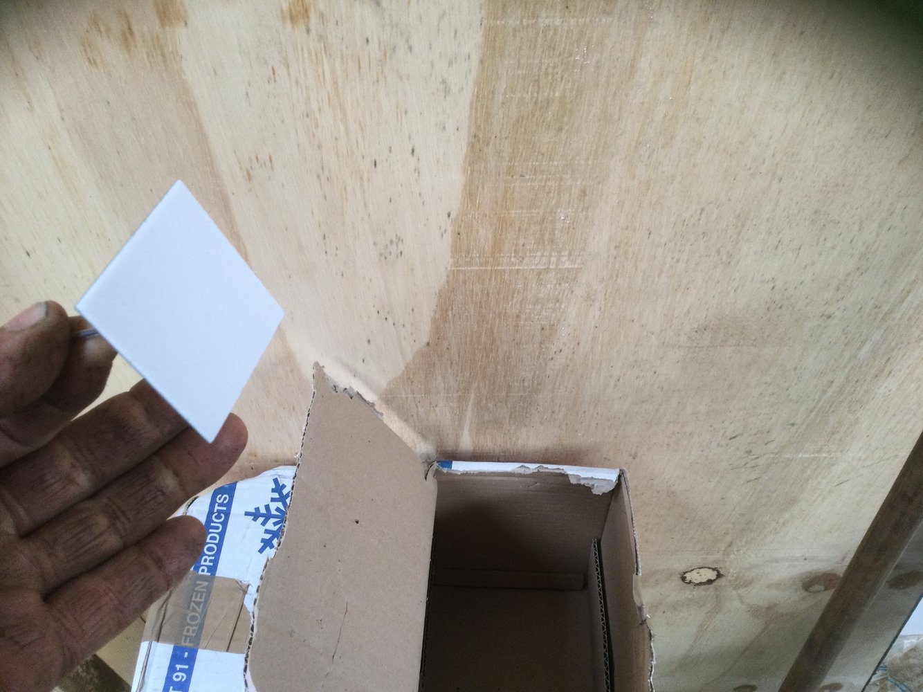

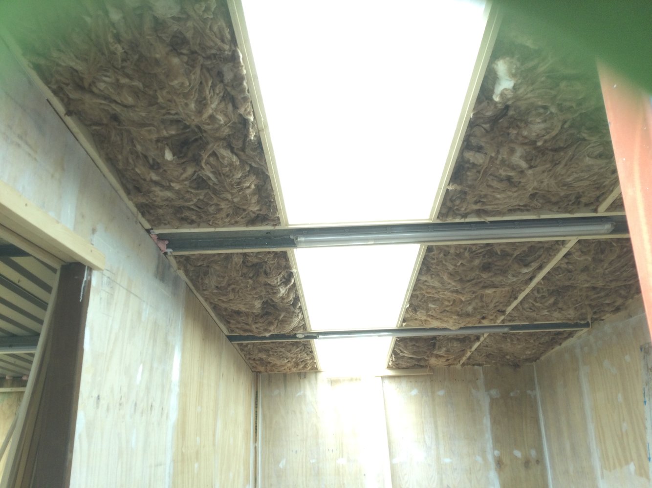

That looks good is the insulation directly on the roof or do you have sheeting & an air space above it ?I have managed a few more hours on the mancave and got the insulation up in the stores. Found these ali sticky back fixings for holding the insulation back, wish I knew about them earlier
Makes easy work of this
But you can have too much so that the insulation sweats rather than lets moist air percolate out upwards through it . Found that out because over my bathroom there was 18 inches or more of rock wool roll and the underneath was quite sodden . I made a few enquiries and found out the the excess depth & unfoiled backs on the boards was the cause.You cant beat plenty of insulation. You only have to pay for it once
There is about an inch of air space. All the walls were done when I built it but I thought I would get away without doing the roof ( no chance ) That bit of insulation has already made a huge difference, the sun has been showing on/off all day and the difference in temperature between that store room and the rest of the shed is very noticeable, nice and cool. Just need to get on with the rest of it.That looks good is the insulation directly on the roof or do you have sheeting & an air space above it ?

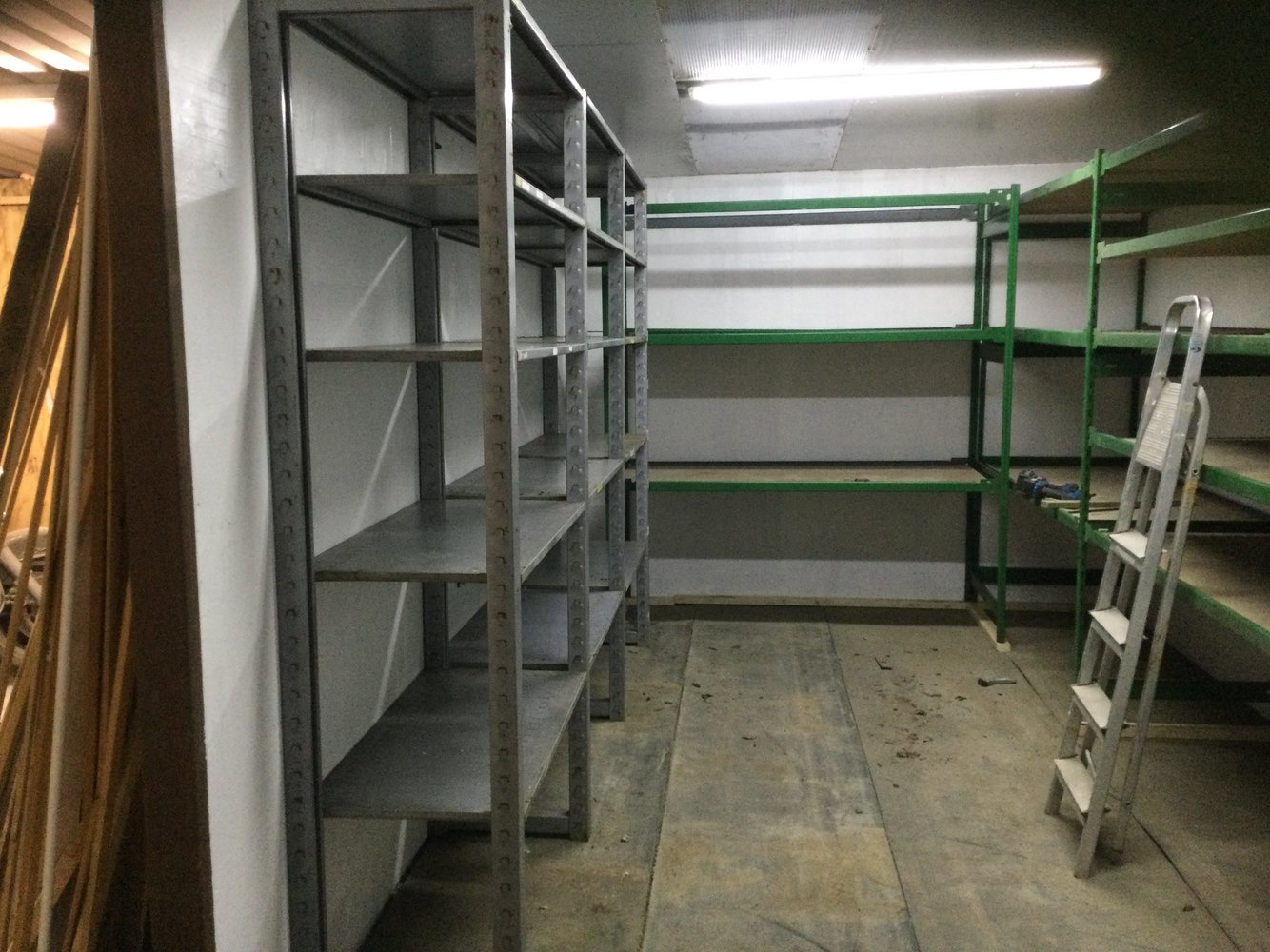

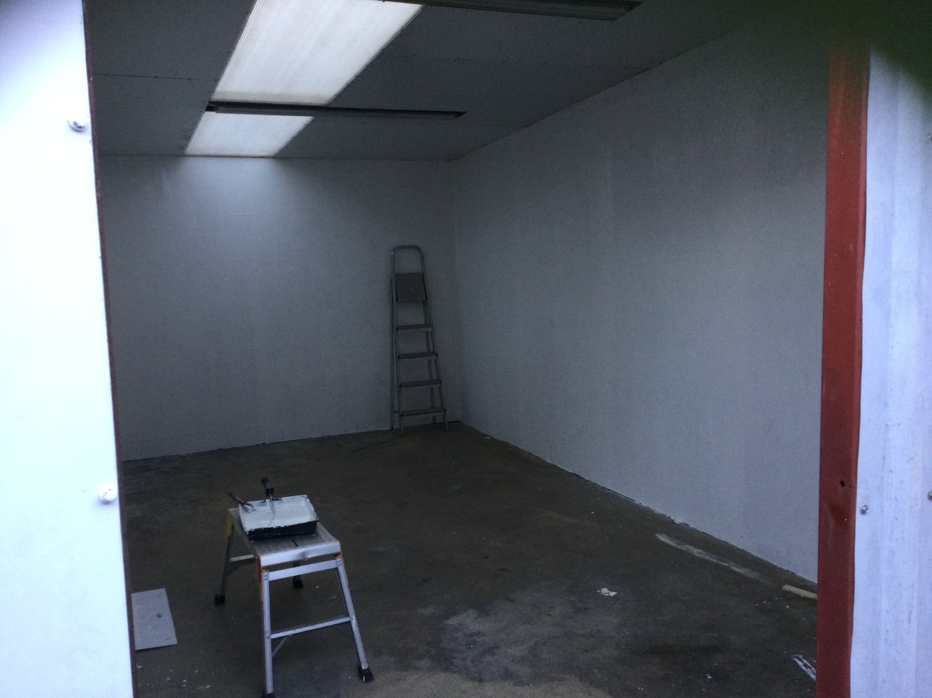

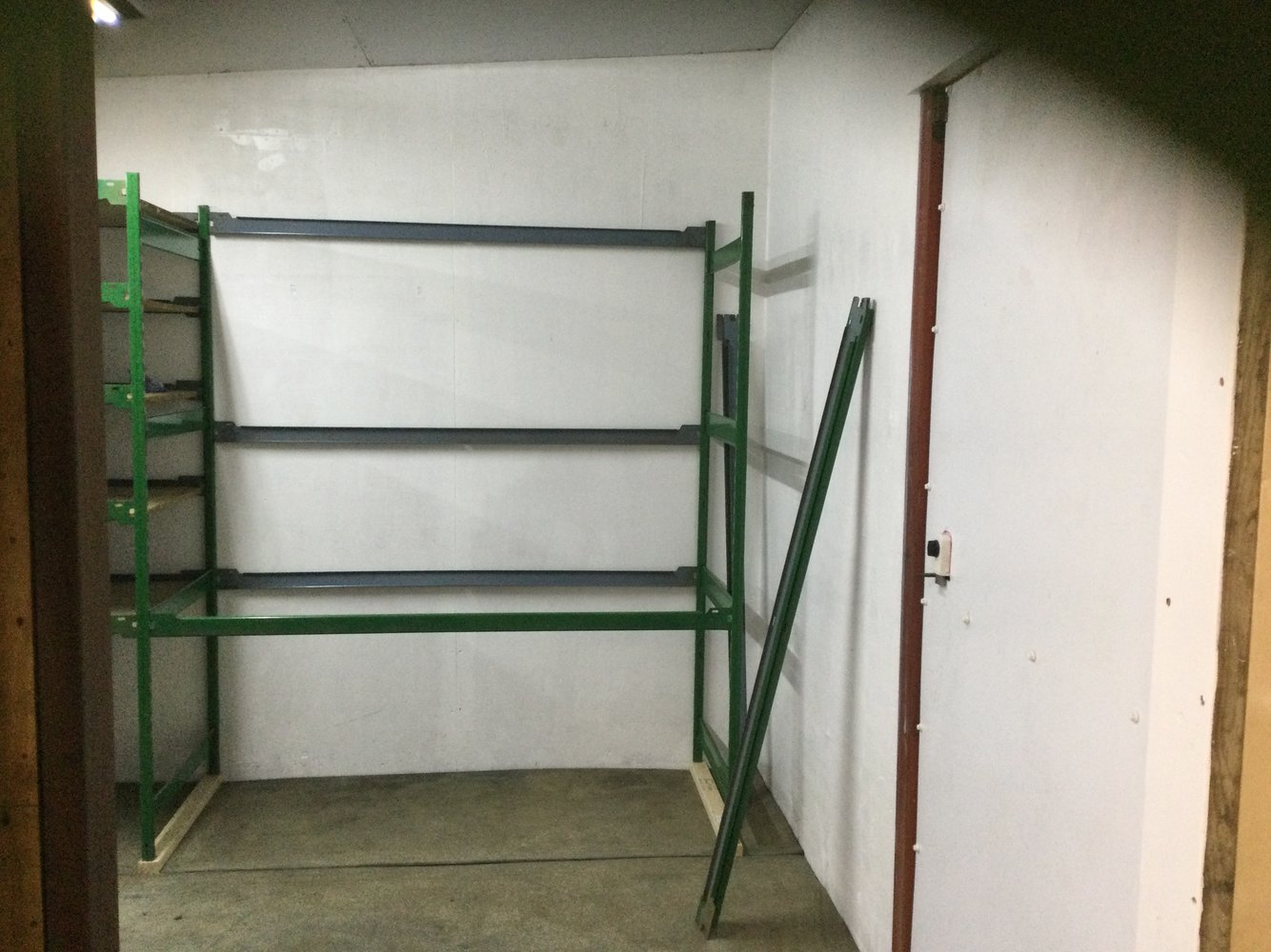

spot on mateLet there be white three cans of eggshell later, that's the store room done. Floor and racking for tomorrow
My garage/workshop is the cooler place to be in the heat of the summer.There is about an inch of air space. All the walls were done when I built it but I thought I would get away without doing the roof ( no chance ) That bit of insulation has already made a huge difference, the sun has been showing on/off all day and the difference in temperature between that store room and the rest of the shed is very noticeable, nice and cool. Just need to get on with the rest of it.
Bob
looking great what u going be storing in it
Silly car bits, I will take some snaps
Bob

When we made the roof trusses, we fixed battens to the bottom edge, for the plasterboard to sit on, lay 100mm rockwool, and metal sheeting screwed down.it aint full already is it!
my new one is also, great how that works!
I have a twin sheet wriggly tin roof with 150 mm of insulation foam between them for the garage roof & an inner 3 inch insulated block wall tied to the outer wall ( done 10 yrs ago at property refurbishment time ) . Once the insulated roller door is down , it's heated by two 7 watt CFL's ... I've never ben cold in it .
Even today when it's 26 oC plus out & about with it closed up and the CFL's off if is a mere 20 oC inside.
Nice one ...you might need to put a louvered vent in if the floor sweats ... I found I had to cut a 110 mm dia core drilled hole through both skins slip in some unused spare soil pipe and add a downwards facing soil pipe right angle to get some gentle air movement warmed by the two 7 watt CFL's ( wired in parallel so if one dies, the other might still be on till I've noticed & renewed the dead lamp ) that are on 24 /& through the year because of it sweating .Already noticed a huge difference in the bit where the roof is insulated, nice and cool even with the sun beating down on it

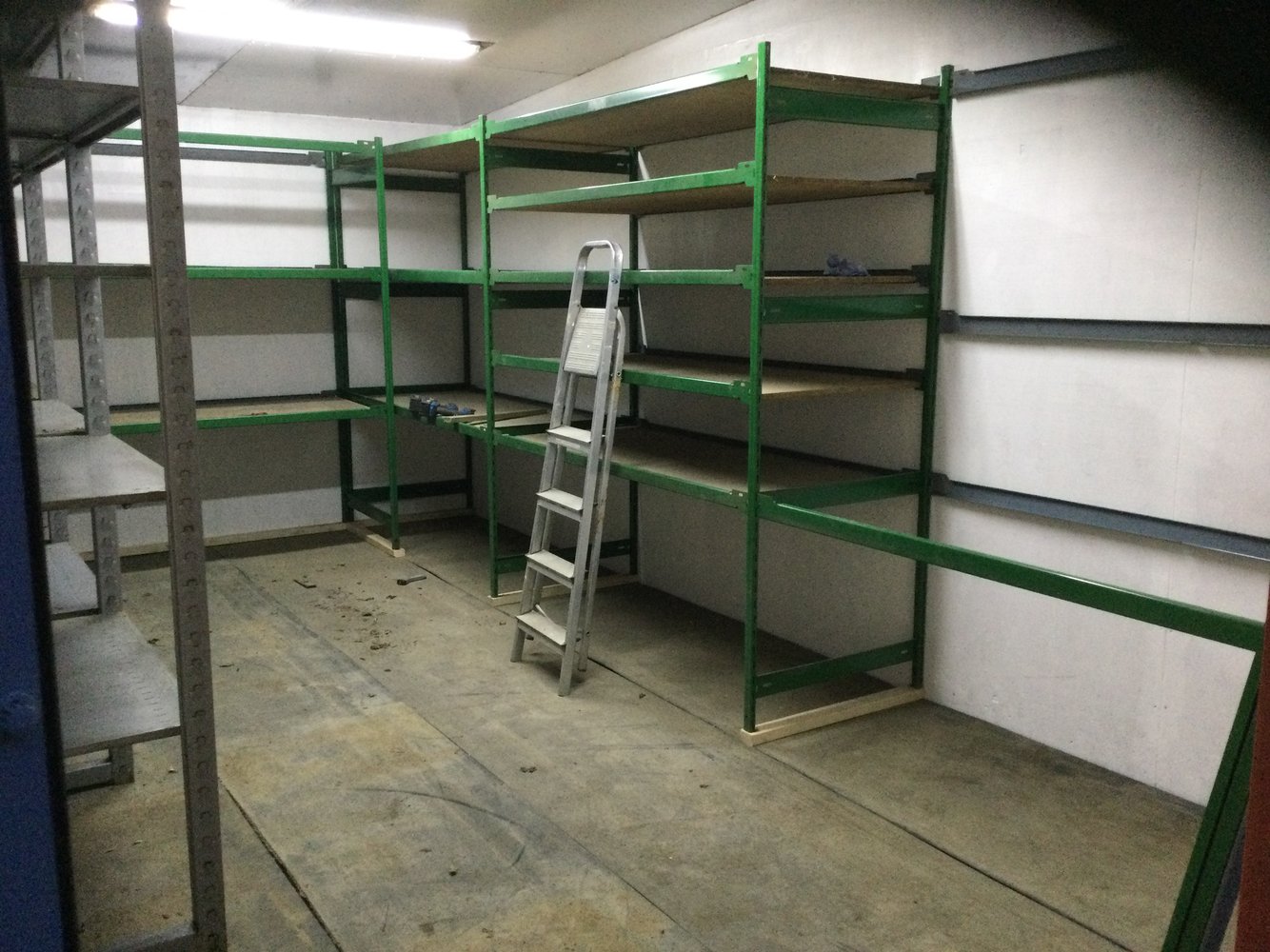

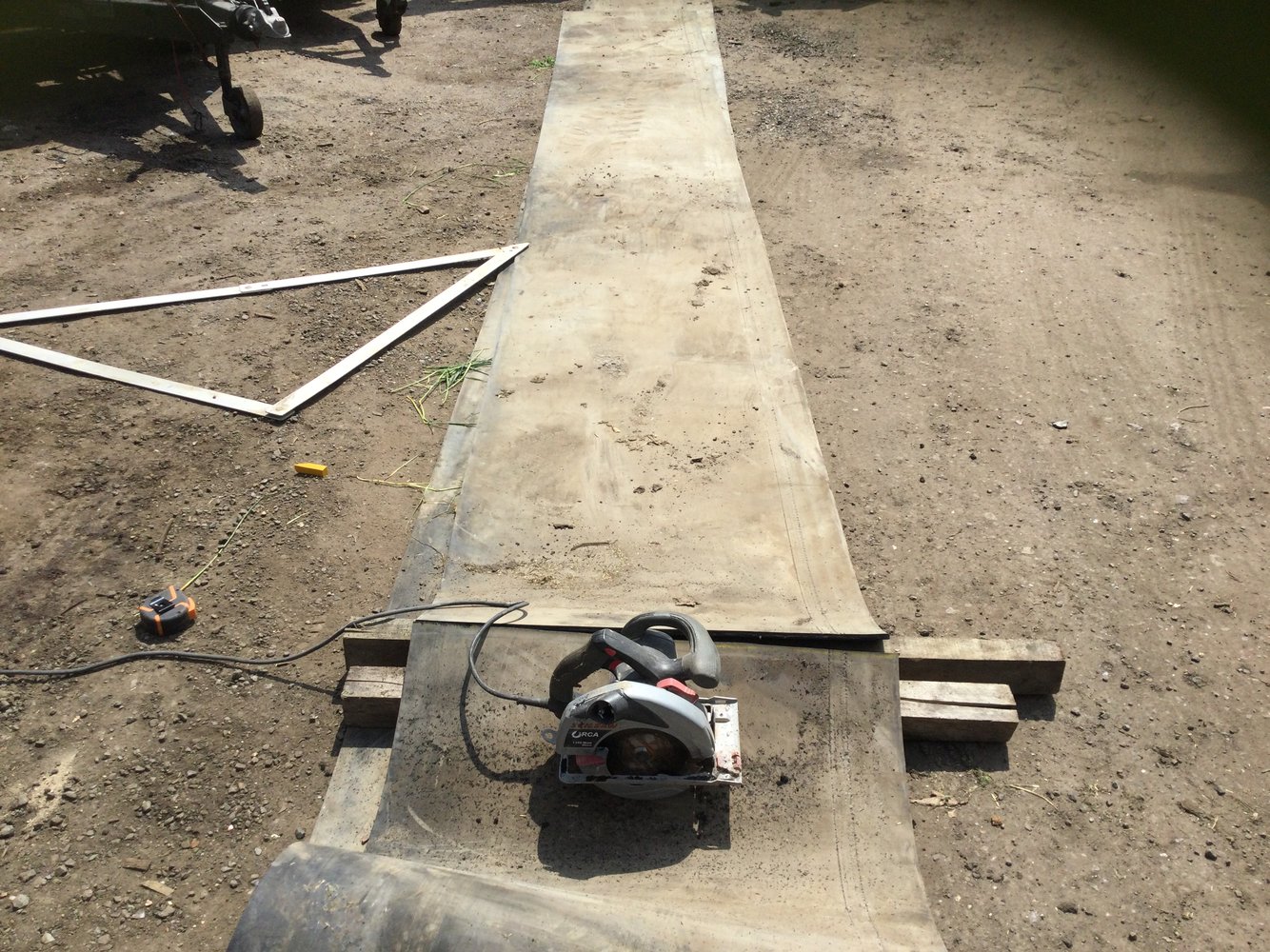

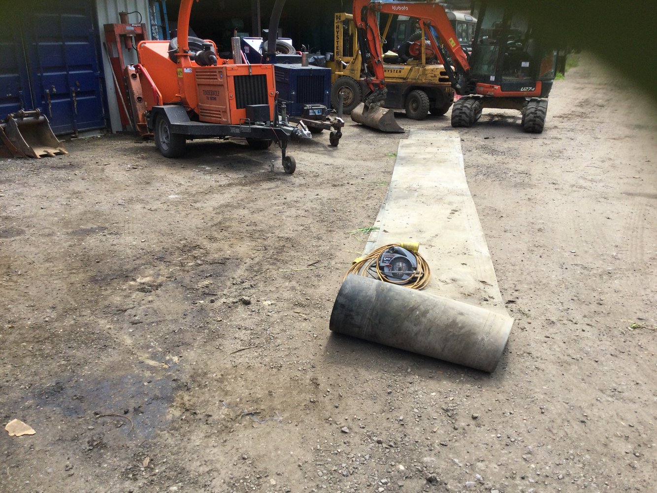

Dragged a couple of rolls of conveyor belt rubber out of there hiding place with the excavator, kin heavy stuff, four strips wide exactly.
Layed it out to give it a chance to uncurl and started to put up the shelving.
