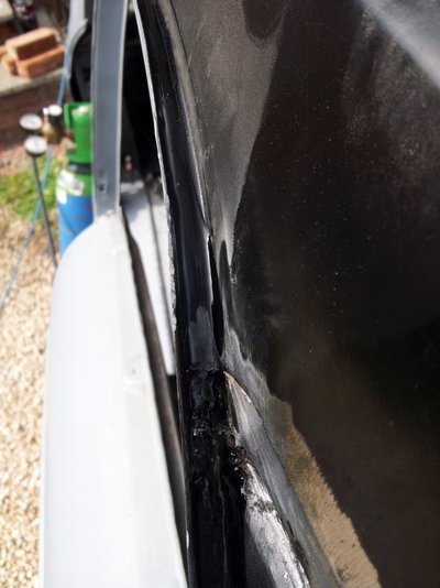

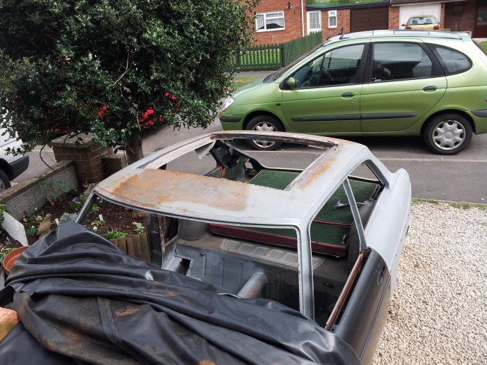

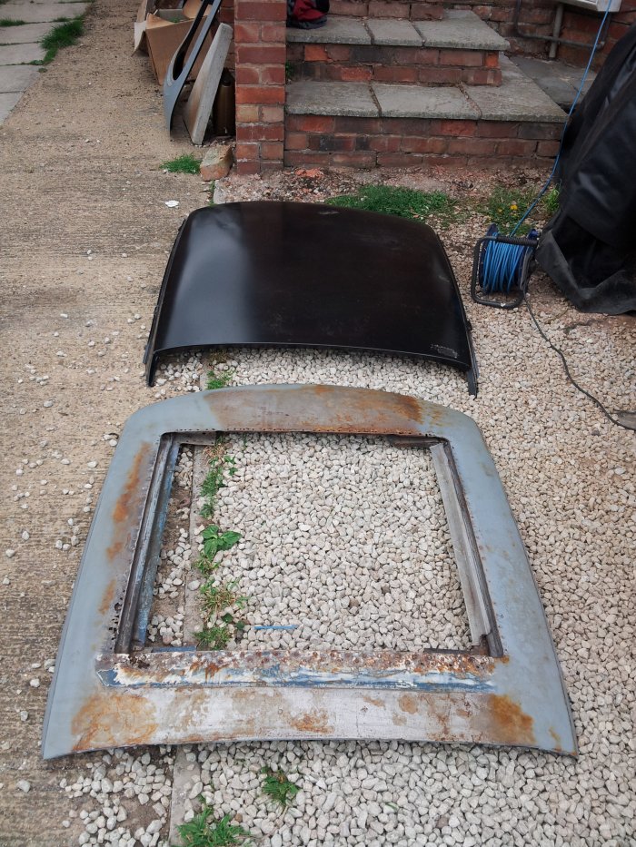

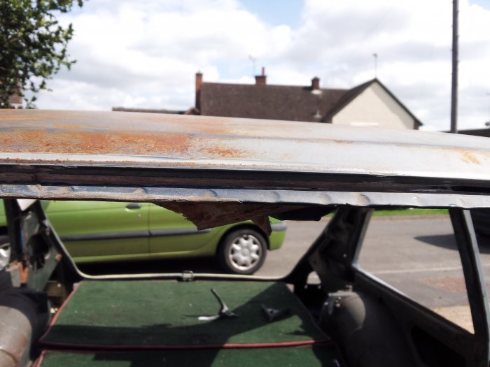

So I decided to break out the grinder for an hour or two today and start taking that rusty old roof off

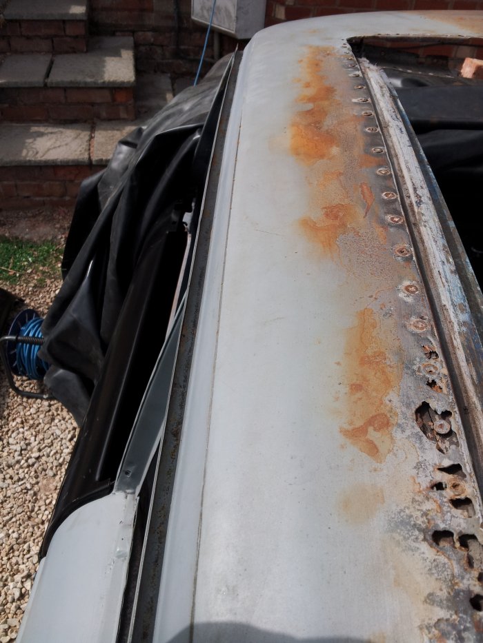

The flange from the skin sits in the gutter rail - I can't easily find the spot welds so rather than damage the gutter I am going run the grinder along gently to just cause the skin to crack away for now then I will grind of the remaining metal
You can see by gently skimming the grinder along the gutter and the the top of the windscreen flange it gently causes a split to appear.
I am hoping this will help keep the gutter shape - May grind off the spot welds rather than drill them
You can tell when your almost through the skin because the thin metal remaining turns blue. Its because it gets hotter than the surrounding thicker material - when you see the blue appear take it steady so you don't damage the frame beneath.

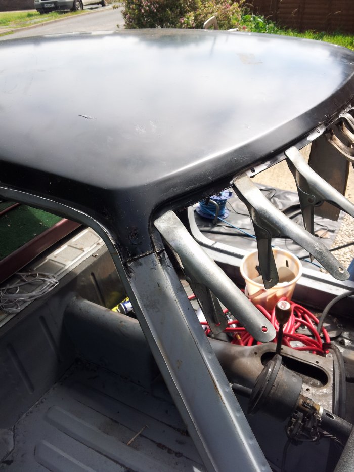

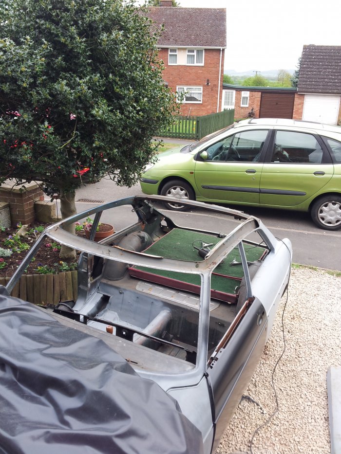

So the main skin came off faster than I thought it would and the frame beneath looks nice and solid which is great news
there is still some material to remove around the windscreen pillars and the rear quarter but as they say you can take more material off easier than putting it back.
Did a similar cut around the boot section right where the skin folds down so that I missed the frame.
A quick test fit shows me how much work remains getting this to fit nicely

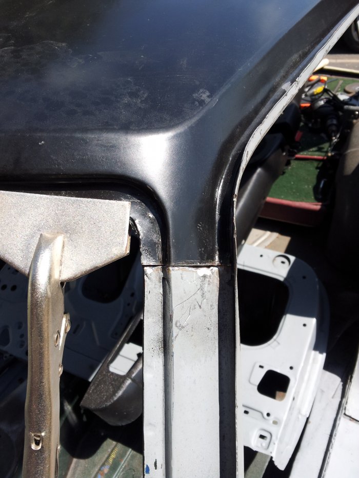

To aid clamping the pillars were tack welded in a few places and will be seem welded over the next few days.

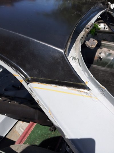

First few pics just show test fits on the windscreen and rear quarter pillars
a slow process but time spent at this point pays off when the clocks ticking on the gluing
So the process was to clean up the areas to be bonded and drill the skin where any plug welds will be. They say don't get the glue where the plugs will be if you plan to spot or plug while the glue is curing.

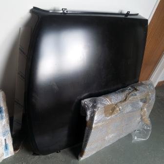

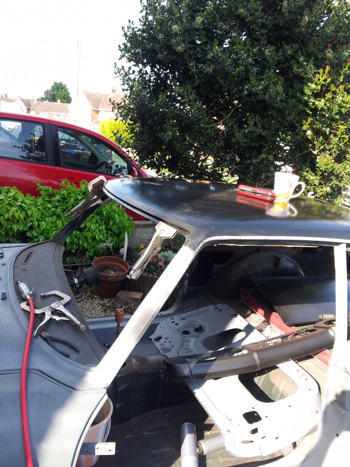

the MGB GT is not a big roof, although the undercut part of the panel at the back of the car is a good size area.

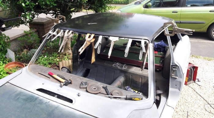

Once the glue is going on you have 45 to 60 minutes so make sure you practised lining up and clamping before you do the real thing as this stuff does not clean of easily. Wear gloves as well because it stains your hands don't ask how I know that - I said don't ask. can't clap anymore from scrubbing my fingers so much.

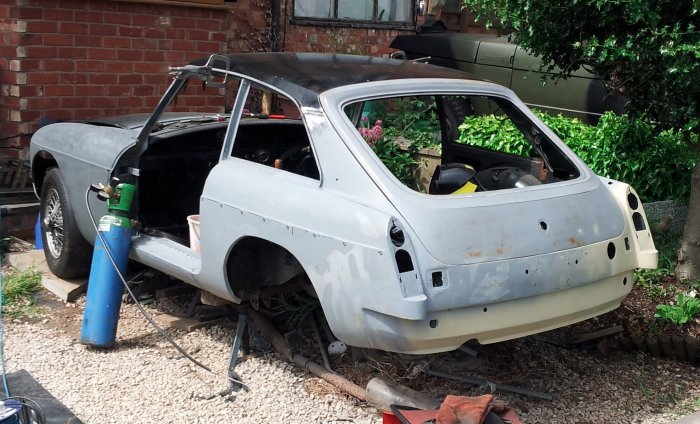

So here's a few picks of the clamping - how many clamps - many clamps.
I tack welded the back down and a couple of plug welds where you can't clamp.

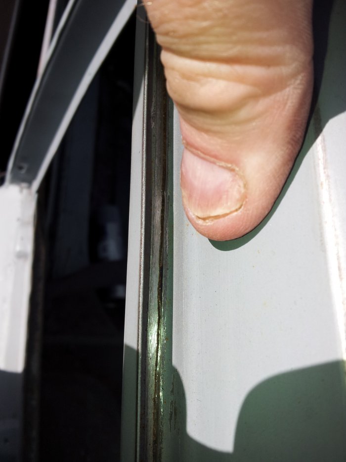

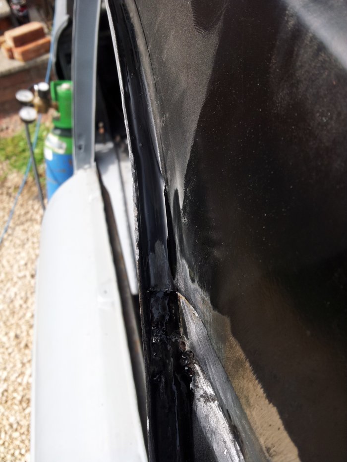

Not sure how clear this picture is of the gutter. you may be able to see the adhesive sealing the seam up.
Once everything is clamped down you wipe off the excess which helps seal ends and seams
Total curing time is about 8 hours at 20 degrees and about 4 hours at 60 degrees. once its set it can be ground or sanded.

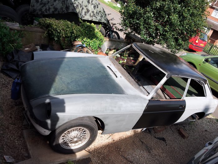

A pic of the car - the bit when you stand back and either cry or breath a sigh of relief.
This was the first time I have glued a panel and the MGB GT is a good tester as the roof is not really structural. As the vehicle strength is in the floor and sills.
The tailgate lines are good and everything lines up with the body shape and windscreen rubber.
So a bit more welding to do but nearly there.
The car is starting to look like a body shell again.

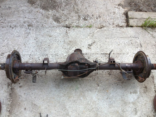

Earlier in the thread I cleaned up the rear axle - well that axle always troubled me as it was intended for disk wheels (not hub, spokes and spinners)
This means it was a wider tube axle and that meant with spoke wheels they fowl the wheel arches or the car has to sit higher
So a few months watching an auction site and hey presto
a narrower rear axle - in need of a clean up but looks like it was refirbed to some degree. Not used much and left to go rusty.
What it means now is the rear wheels will sit inside the arches and the car can be a bit lower than it was. - If you watch fast and loud - it really can come down another 1/8".
