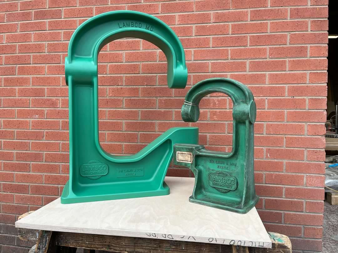

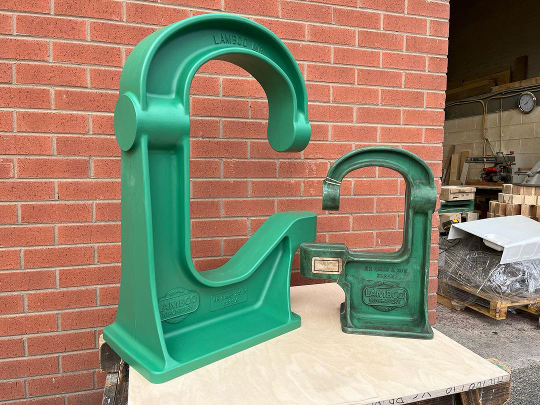

Mini wheels aren’t as there’s more machining than my full size and the price rises on a low margin item .I thought you was not doing anymore wheels as not viable to the wallet.

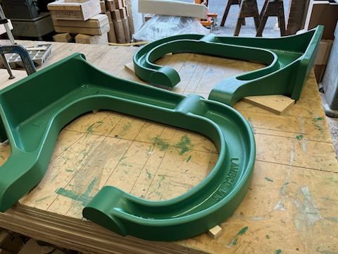

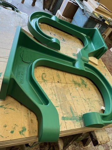

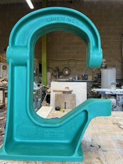

They’re patterns to form moulds in sandDo you then use these moulds to have someone cast them for you in metal?

Big wheels are viable and these are for a American order

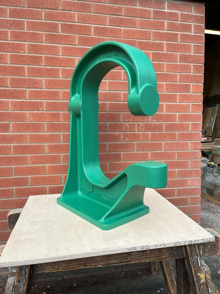

One brick two bricks, thre...could you occasionally include a coke can , or the likes in the pictures for scale ,,, sometimes its easy to loose track ,

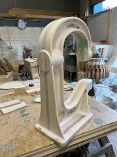

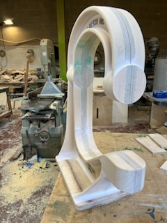

loverly job . a lot of work goes in to pattern making ive made a few. they have to be spot on or the pattern wont come out of the mold boxes clean and the finished article will be roughLast pattern picture! Next to mini

Put it this way it’s too big to machine on my little 7 ton Devlieg due to the bores needing quartering to get alignment.Nice. Given this is a "making things" forum, do you think it might work to cast some without your name on it, to be sold for completion by forummers "in their own time"?
Might mean the casting costs come down substantially for yours, and one or two of us have been known to pay for a project..
