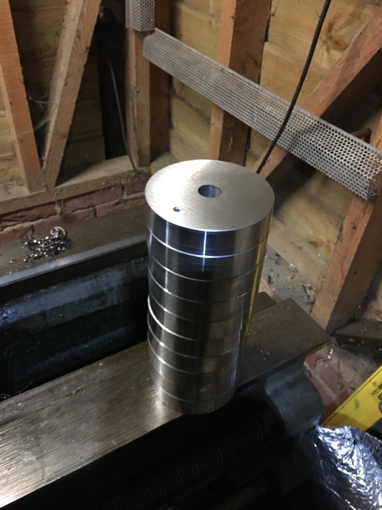

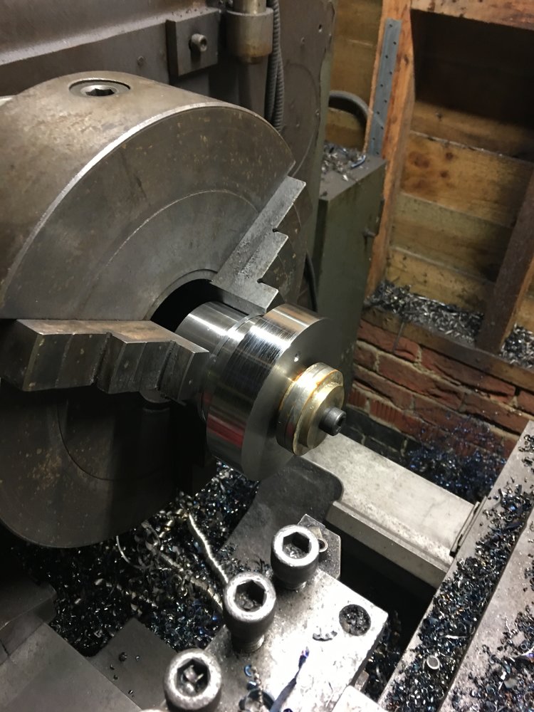

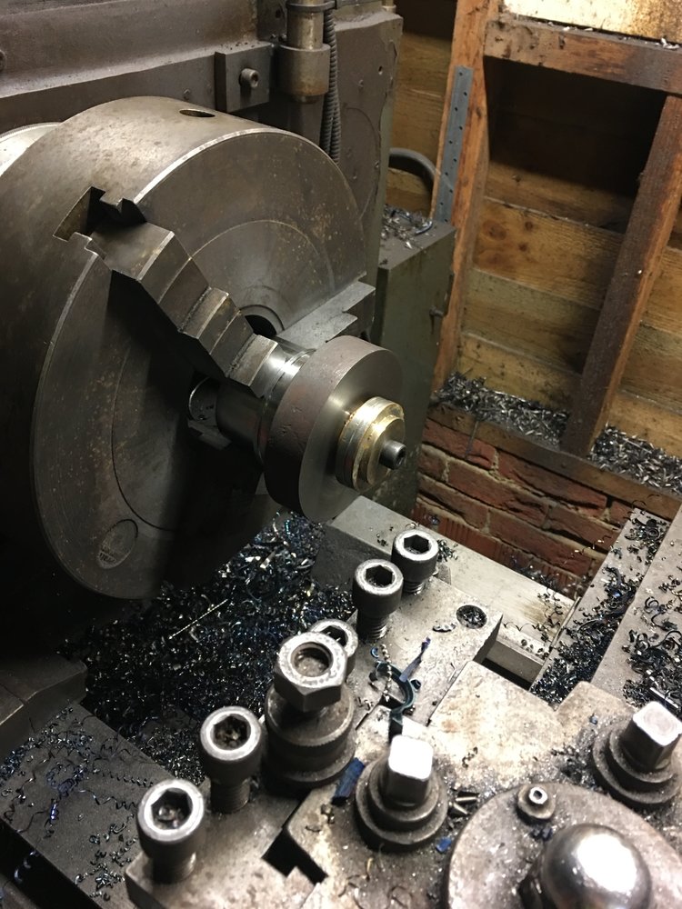

Made rookie error by only holding mandrel in chuck 80mm or so which on a worn chuck is recipe for failure but I didn’t want to waste valuable material
It moved .25 mm on last three which I didn’t notice with the material being out of round hot rolled
Luckily I noticed on chamfer operation.
Re skimmed as I don’t want too much grinding
Top wheel is 110mm diameter
View attachment 375574 View attachment 375575 View attachment 375576 View attachment 375577

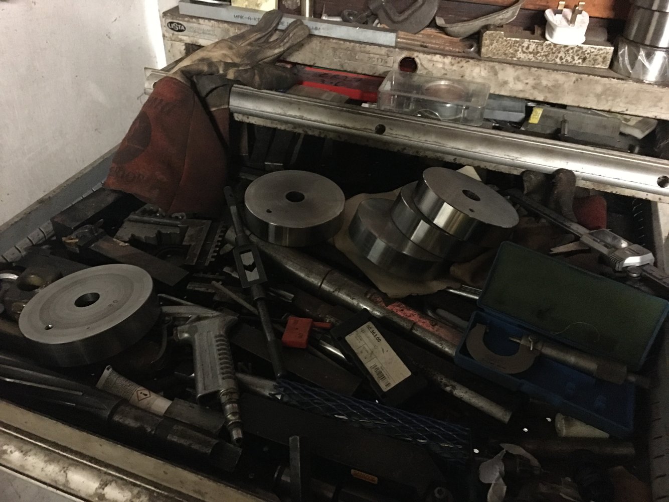

It’s a draw shelf…Who doesn't love a nicely organised toolbox?![]()
ThanksThose wheels look great, Clive.
What is the small hole in the face for, pse? One of the earlier machining operations?
