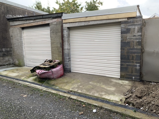

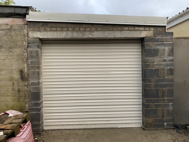

The manual roller shutter on the front of the garage (pedestrian door) has been a really heavy door since I first bought it, but since fitting it across both doors it is a real get yourself under it to get it up affair. So, when the electric roller was fitted the door fitter advised that the best way to increase tension on the door without the roller spinning out of control while it tries to unwind itself if you lose hold, is to remove the side guides with the door fully up then add turns to the curtain, so effectively increasing the spring tension by two or three full turns. I tried this today but it pretty much made little difference so today I rung a local door firm and they sent one of their fitters up on his way home to quote for a new assister spring.
He told me first thing is to scrape out the old grease and reapply as people make the mistake of putting new grease on top of old stuff. He then scraped it out with a narrow blade scraper and I applied new grease.
Perfect. I can’t believe that’s all it was, so if anyone suffers with a stiff roller door (ooer!) there’s the answer.

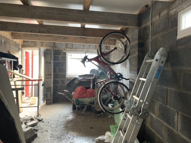

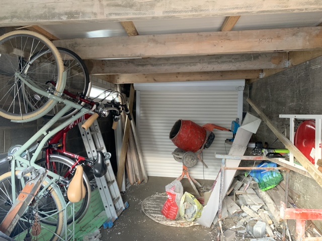

I painted inside my garage with Sandtex masonary white and it made a big difference to the lighting, The floor is on my to do list as it was part of the drive before i extended so it slopes down so plenty to do.Cheers @Olderisbetter, I'm actually looking forward to being able to do work in there without stressing about covering the bikes up.
Still plenty to do just yet, I'm not gonna render the outside, I'm going to get some cream Sandtex weatherproof smooth paint after I've finished re-pointing a few bits I'm not happy with (I've bought a 115mm raking disc to clean the first 4 courses so I can do it all properly) then I'll paint the inside with white Sandtex as I want it bright in there. Next will be grey polyurethane floor paint to do the floor and probably 3 x 5ft LED batten fittings. It'll be like an operating theatre by the time I've finished.![]()
