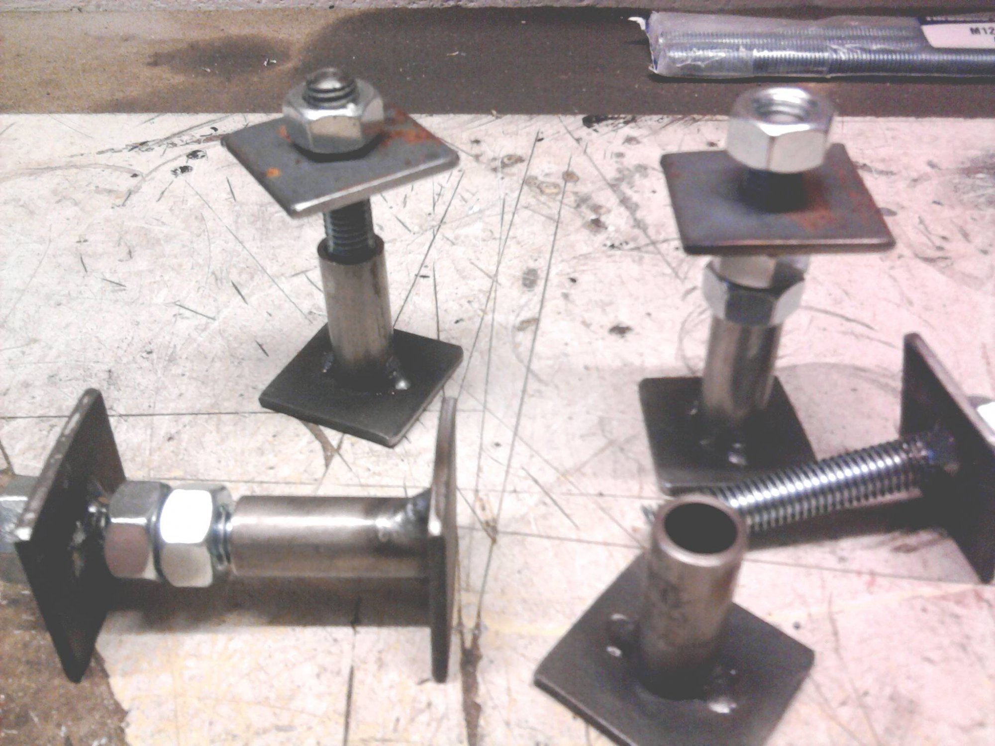

It is tucked up under it's ex bed sheet same as my welders and other machinery, it makes a big difference to stop condensation forming on the surface.The stand is looking good but I would add a few short welds at the joints to steady things. I would also add an emergency stop on the apron alongside the dewhurst switch!
