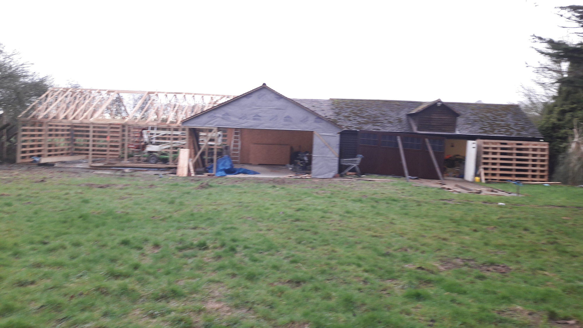

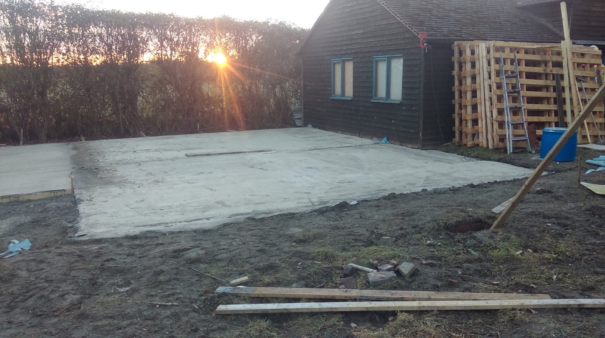

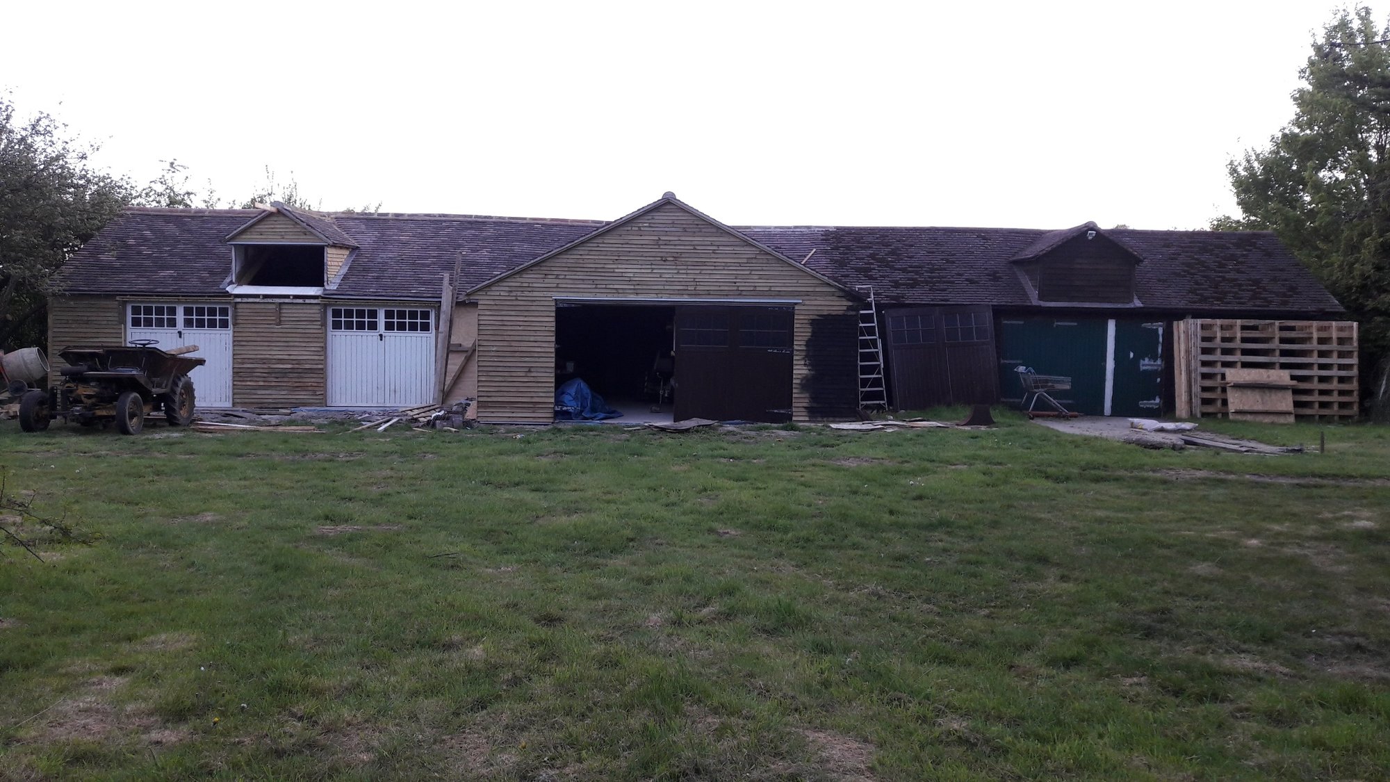

I built mine from free 2 mtr x 3 mtr pallets, available from most plastic sheet wholesalers and maybe sign makers, they are around 4-5" wide, I used tannalised fence post material around the base and top and as uprights between pallets, slipped 75mm rockwool down the gap, broke some pallets up for extra timber as one side tends to have far fewer slats, I bought trusses from ebay, left over, built to wrong dimensions or design changes, paid very little, broke some up for extra construction timber, used site hording shuttering ply to line the inside or sterling board when I had to buy new, feather edge on the outside, had to buy that new!
you will not regret buying a Paslode lm350 as a cheap first fix gun, 50mm to 90mm mails, the pallets saved money but also made initial construction very quick and that helped keep the project going through the winter of 2017-2018, I had a massive time deadline as my workshop building had been sold and I needed to get all my toys home double quick or throw them away!!!!!! was also very short of cash until completion, a double edged sword, original prefab shed (modified) to the right, dormers open up for easy access to roof space storage,
