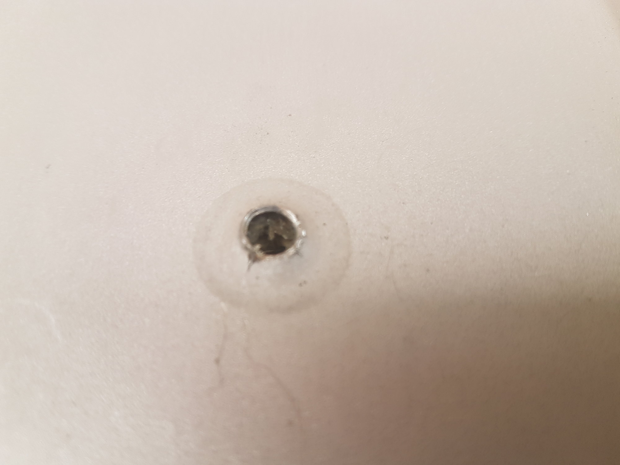

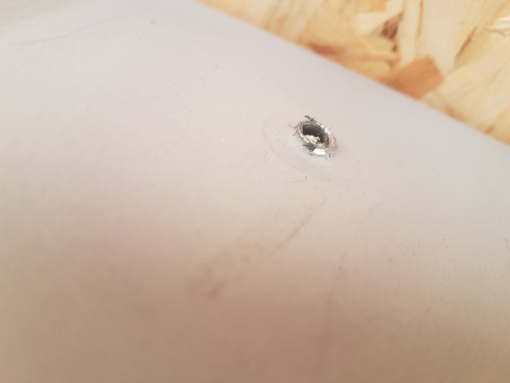

Hey I took a few pics for you of.what these fixings doLooks good, but I don’t think you are supposed to put screws in the bottom of the valley, as that’s where water congregates.![]()
oh and plan the rafters and studs right you dont need to cut and waste boards! thats why i have a odd spacing in the middle ;-)
I may end up screwing them too these are only 2nd fix pinsLooking good , I fixed the bottom board on my cave with ss screws and cups to make it easy to replace if they rotted , I'm hoping not as there is a decent overhang , but they still get a bit of rain bounce ,

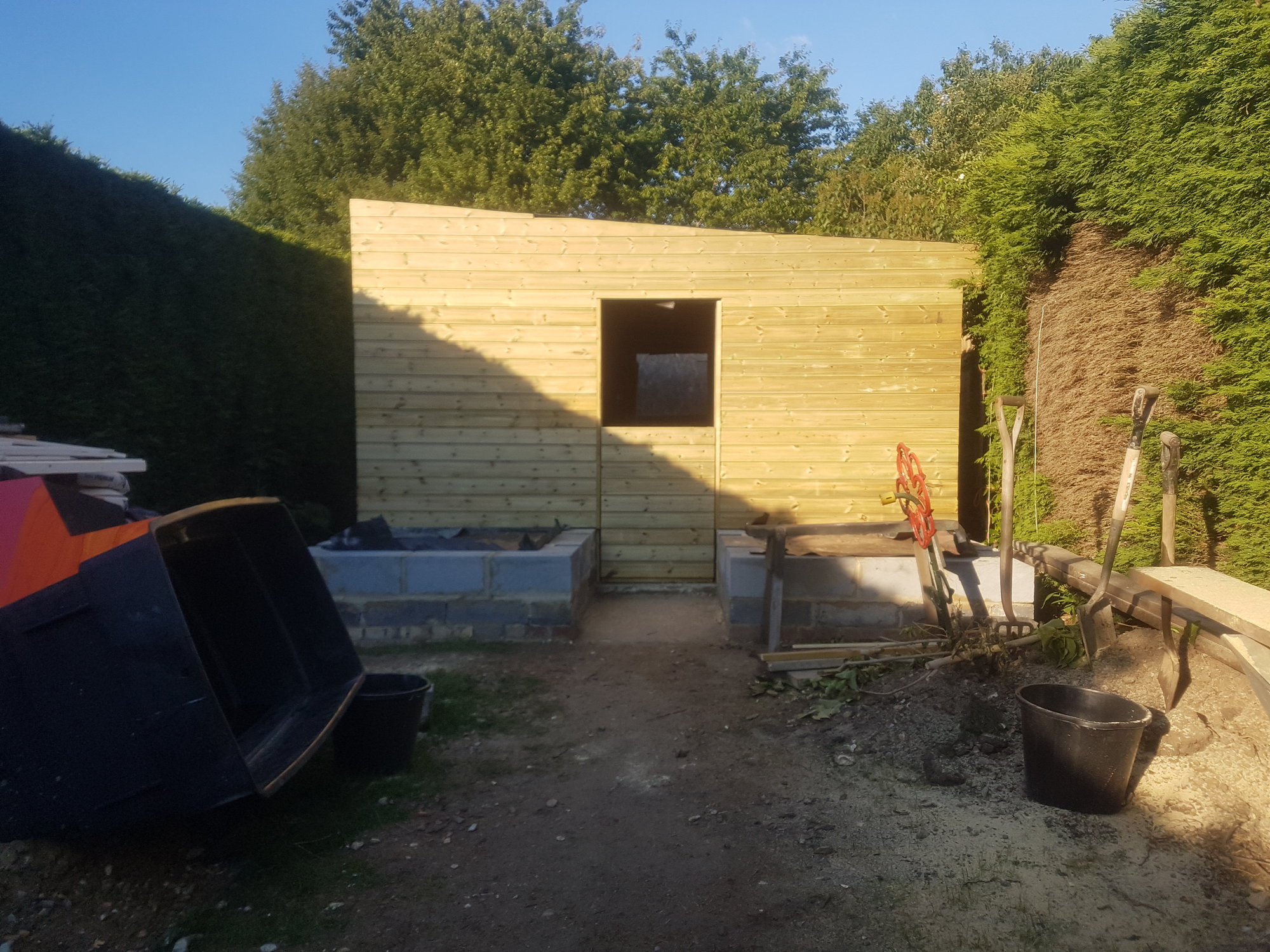

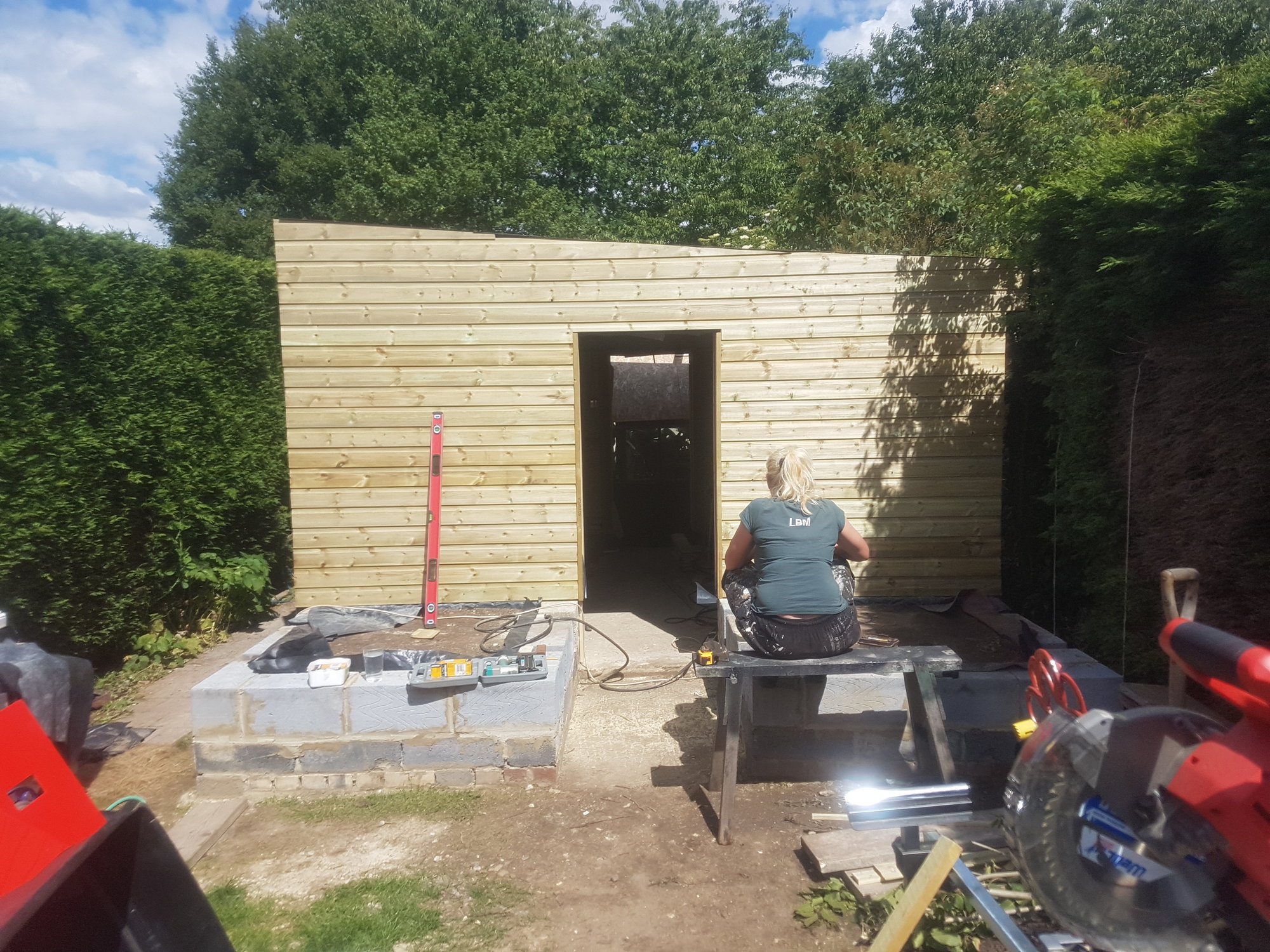

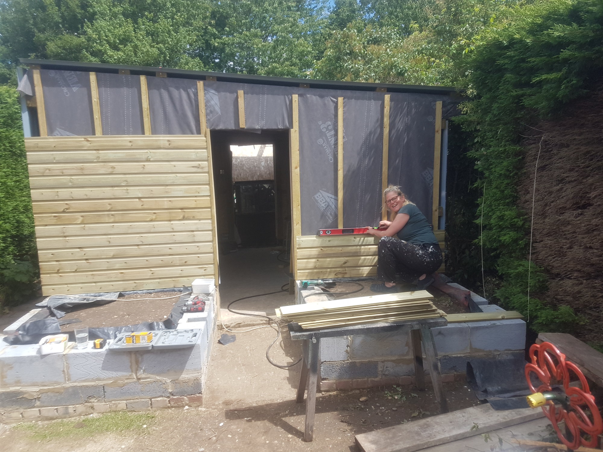

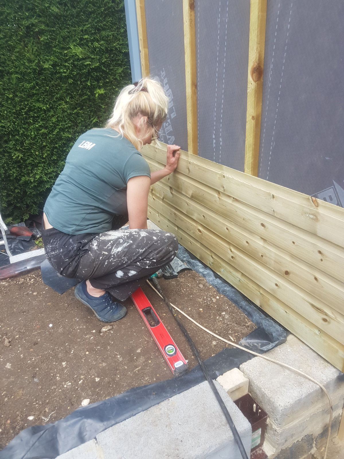

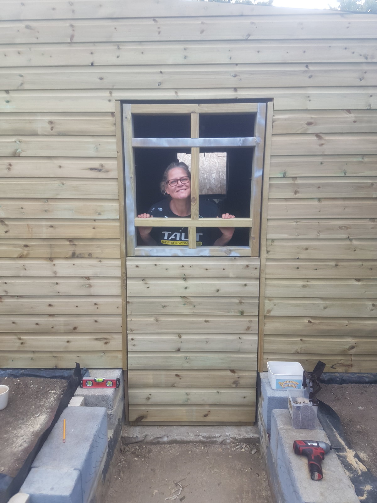

She has to learn mate. She gets bored watching. Now she has used the small gun I'll try and get her using the 1st fixLee, who’s building the shed?
Looks like mostly your good lady
I like your style!She has to learn mate. She gets bored watching. Now she has used the small gun I'll try and get her using the 1st fix

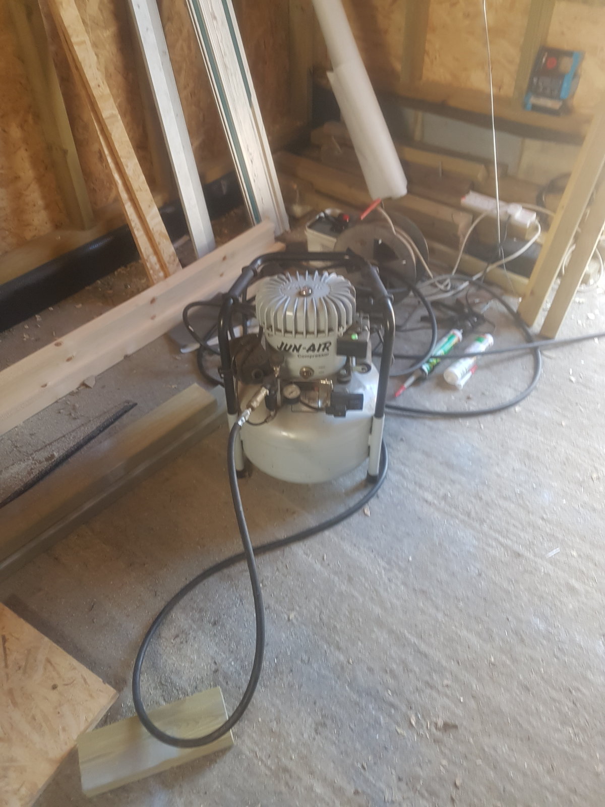

Those compressors are perfect for nail guns u can't even hear it runningI've a Silverline brad nailer and a small Bambi compressor. They work very well together. Could do with a decent nailer for final fixing.
That's every night mateLooking good mate, celebratory beers tonight?
