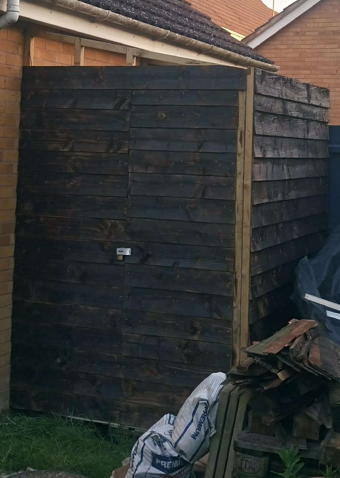

Japanese wood burn't cladding (Shou sugi ban) that I did on a previous shed build:oh but it is

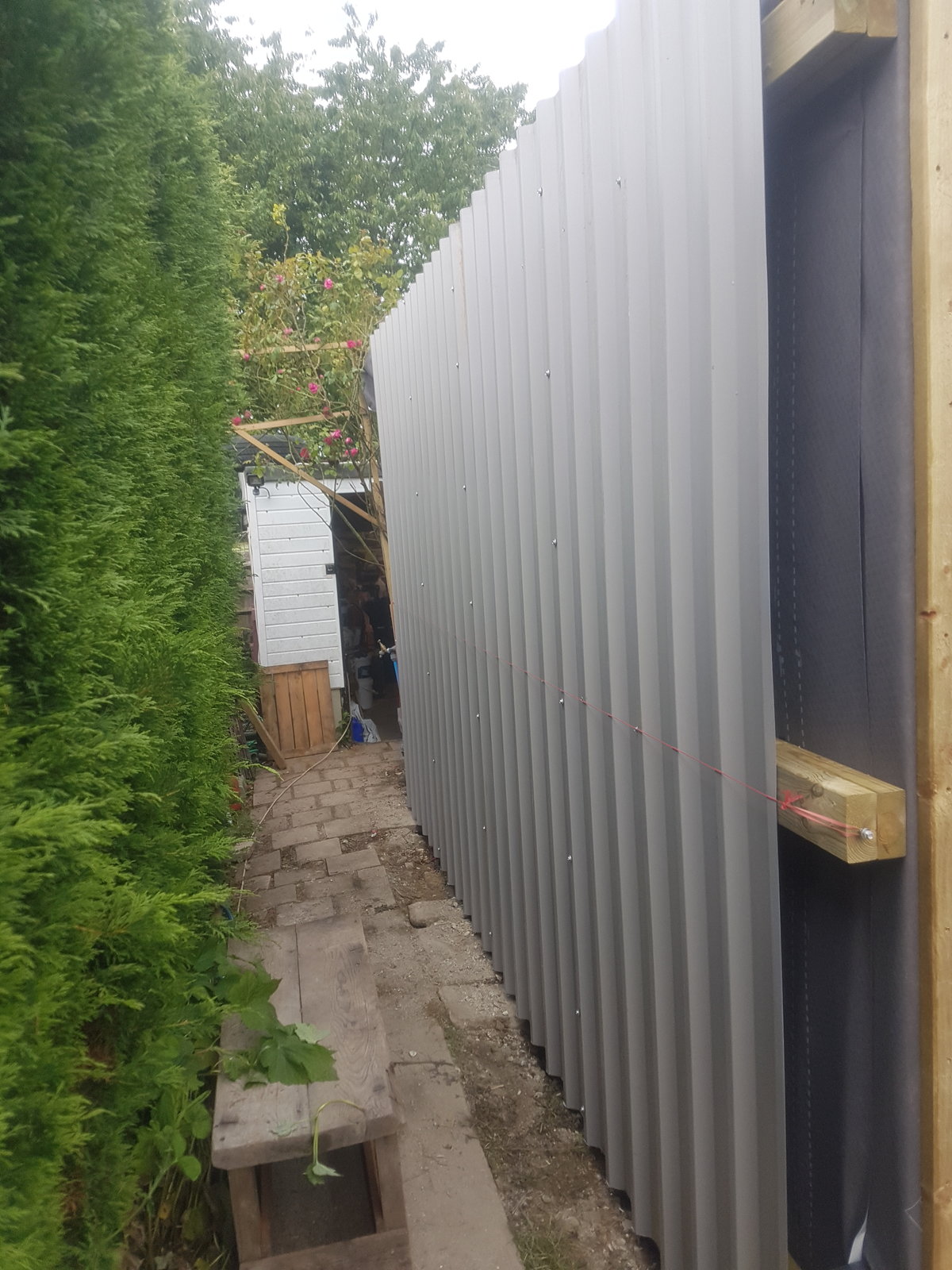

All the batton is now up and one side is clad. The Mrs taped the joints I suppose now sealant is needed on vertical laps anyway. But we did.

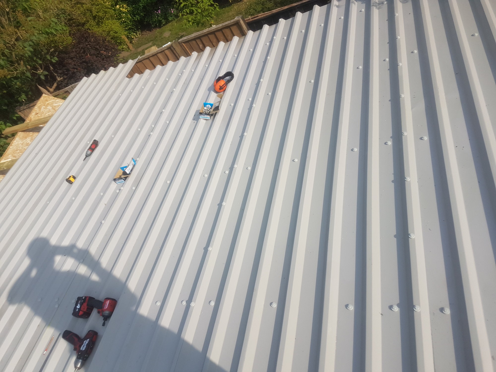

The roof the roof the roof is on fire

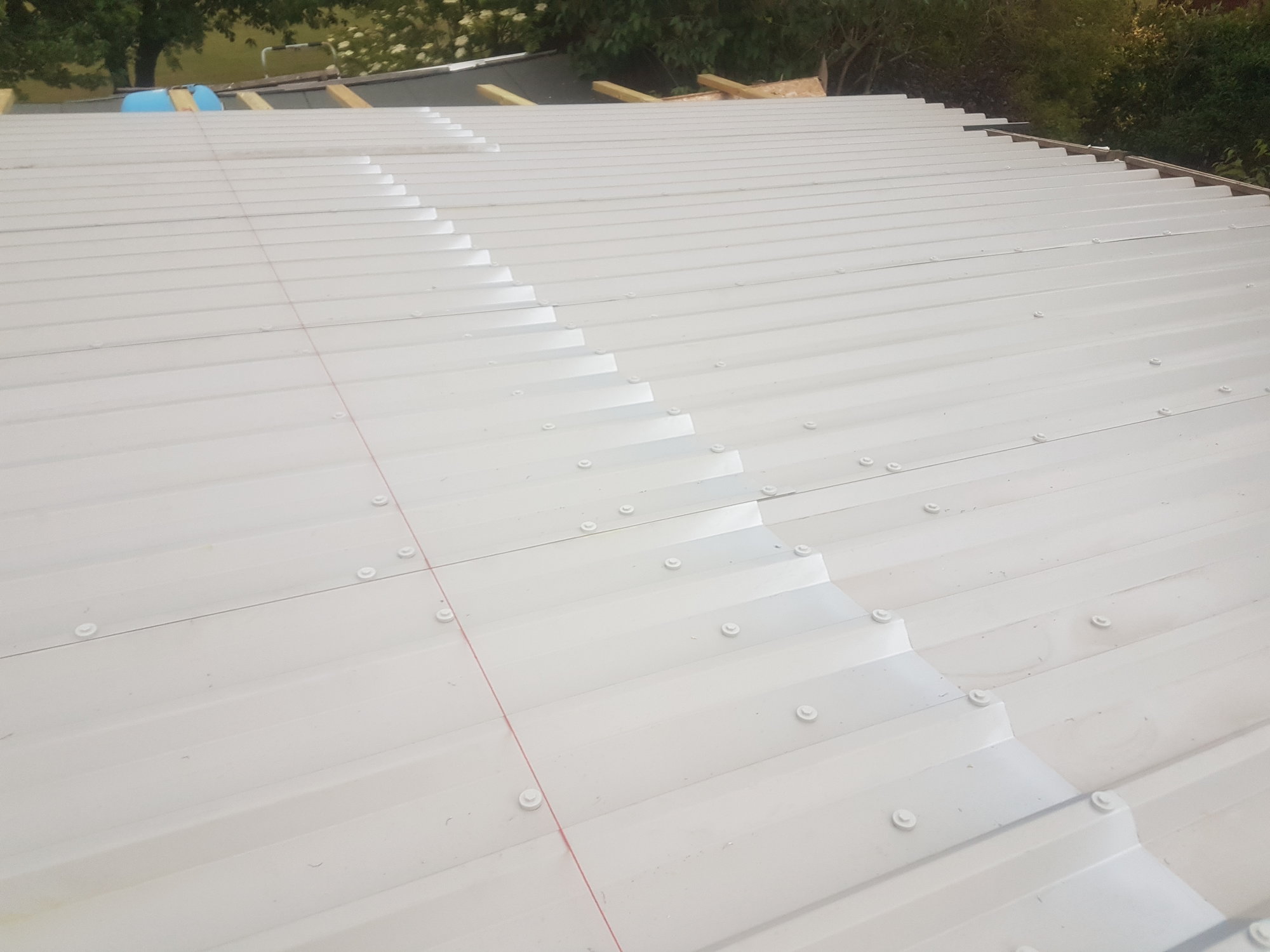

That is what the rubber washer is forLooks good, but I don’t think you are supposed to put screws in the bottom of the valley, as that’s where water congregates.![]()
