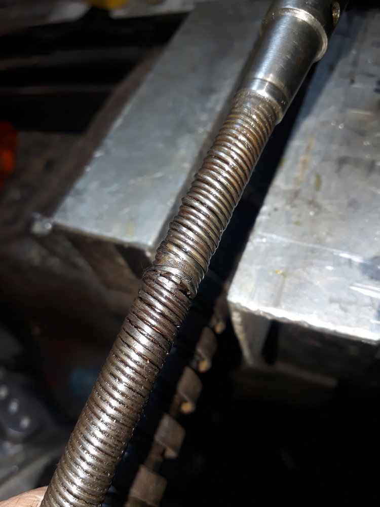

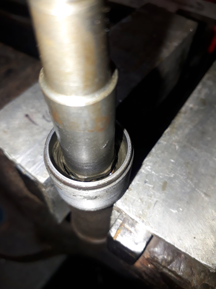

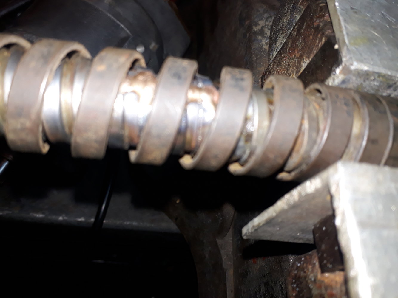

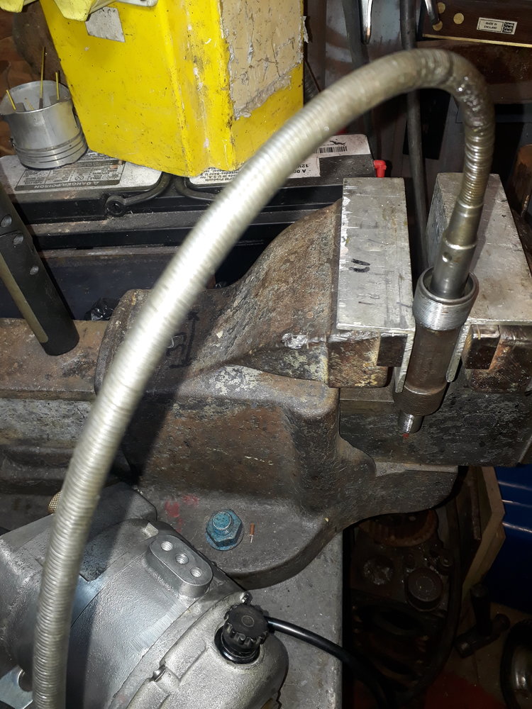

I've got it all back together filled the flex shaft with new grease, she runs and sounds sweet the grease has done the world of good ,I just got one problem it runs backwards on the 900rpm end I've tried switching the live and neutral in the plug but it don't make a blind bit of difference,whether it will run the opposite way on the high speed end I will have to try it, any idear on how to change direction as I won't be able to run a rotory burr,o well I guess every day is a school day lol

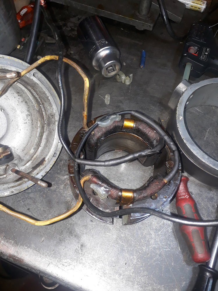

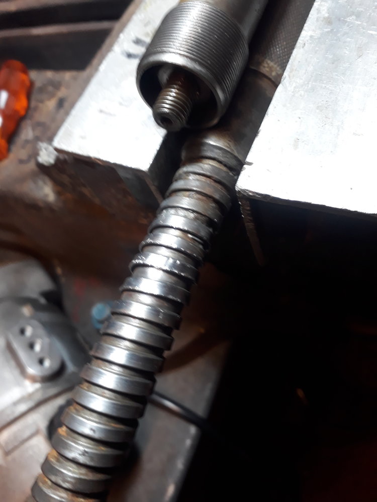

The knurled knob unserws and that's what the shaft connects to to change the speed and the you put the knurled cap on the other end of the motor ,they both run backwards,I'm guessing it might of been running a polishing head so it throws the crap away from the operator,I've worked out that I can strip the motor and spin the winding around and 're solder the wires and the should change the direction I hope

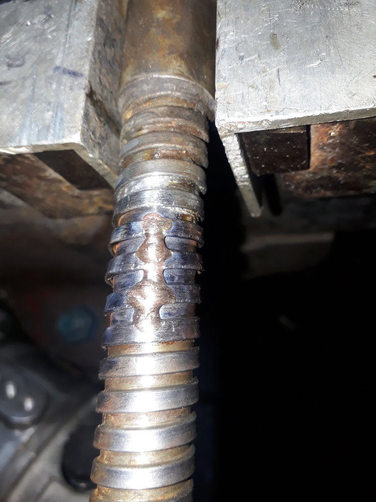

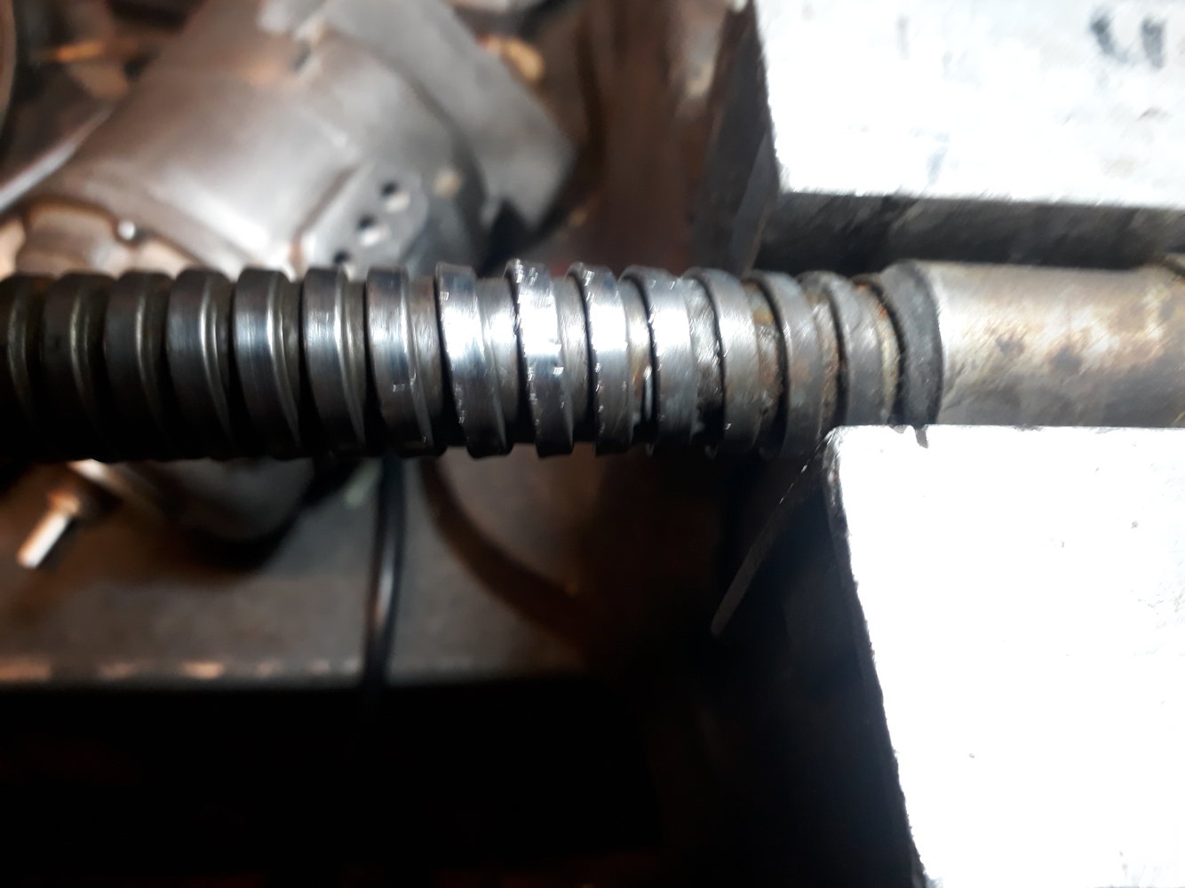

Inner screw was rh thred also the inner flex looked like it was designed to run clockwise not antiDid the inner screw on with lh thread, good job brazing on the outer
No need to Fill a good glob is Ok

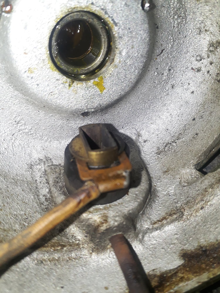

No it won't on an AC motor, bit more complicated.

Hello Eddie it is a a.c./dc motor,I understand swooping the wires to the brushes,I could try that I did switch the feed wires live and nutrual but it didn't make a blind bit difference, is that the same as switching the field wires,thanks for your input I'm at a lost end I might not be needing it the way all this Russia stuff is going,
