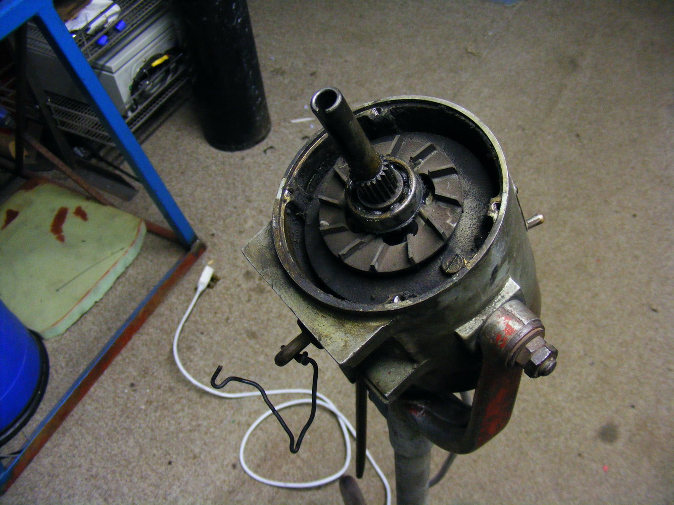

That's changed nothing. Think of a funnel, liquid flows through it in one direction. Your field coil is essentially a magnetic funnel, with lines of magnetic flux flowing through the central hole in one direction (for a given polarity). If you turn it end for end, you've altered nothing. All you've done is turn the "funnel" around its centre line. I hope that makes some sense.The magnet thing is the bit in the middle that gets fixed is it called a field winding, I pulled it out of the casing and reversed it and she still runs backwards

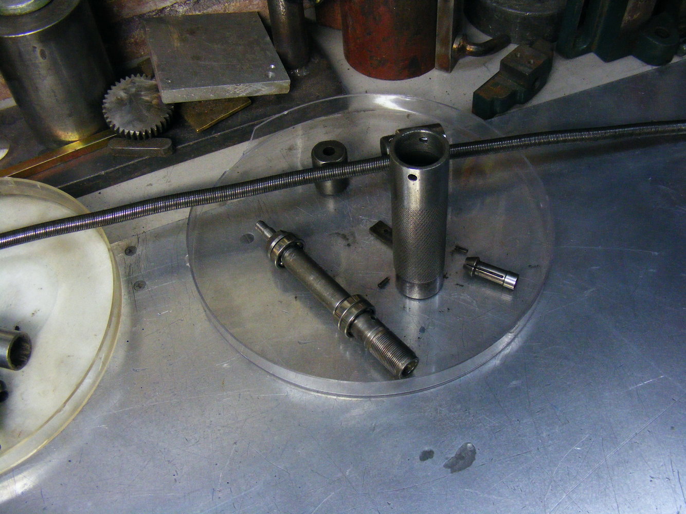

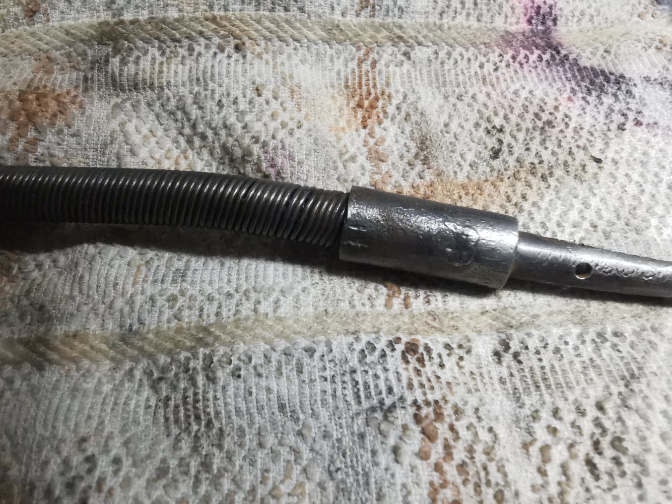

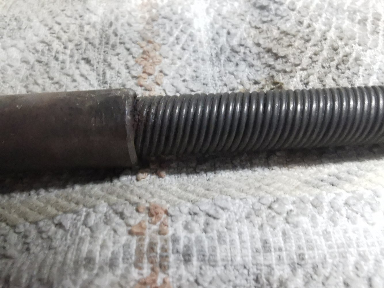

Are you saying that if the motor is not rotating anti-clockwise, the spiral wrap around the inner steel wire of the flexible core will unwrap, jam in the outer, and destroy itself?Handle end motor end anti clockwise rotation
Could be "Left Rotation" - the motor only goes one way?Wonder what the L,R is left right?
