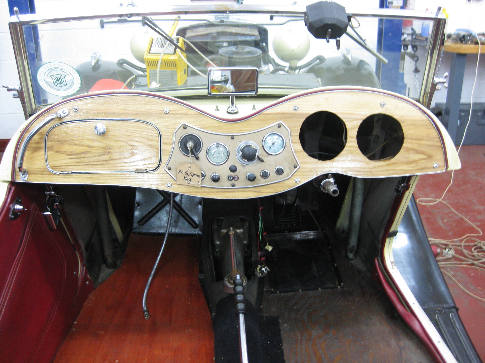

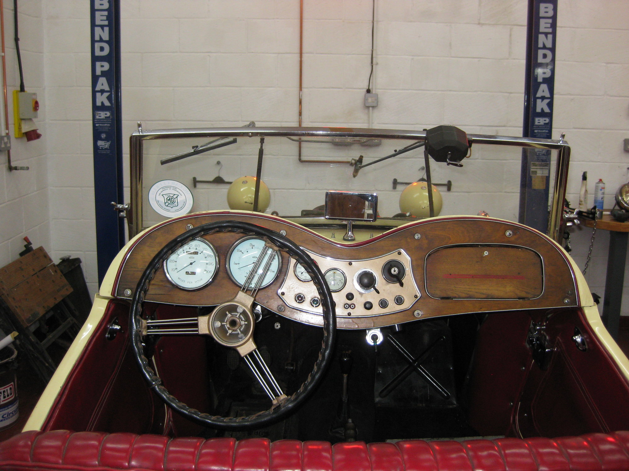

Here's one that I worked on for my eldest brother, who bought it from my next brother up, who in turn bought this early MG TD at a car show in the US when we were on holiday there in 2016. Being a US import, it was of course LHD. Eldest brother had owned one in his youf, and couldn't get on with the steering wheel being on the "wrong side" As Ian isn't as fighting fit as he used to be, I got the job of changing it over.
What I hadn't realised is that these cars were entirely built as LHD. No "mirror imaging" of the bulkhead pressing. The welded on pedal box hardware is on the LHS of the chassis only etc. RHD rack required obviously, now available new from Moss at a not outrageous price -Most T type stuff seems to fetch silly prices to me.

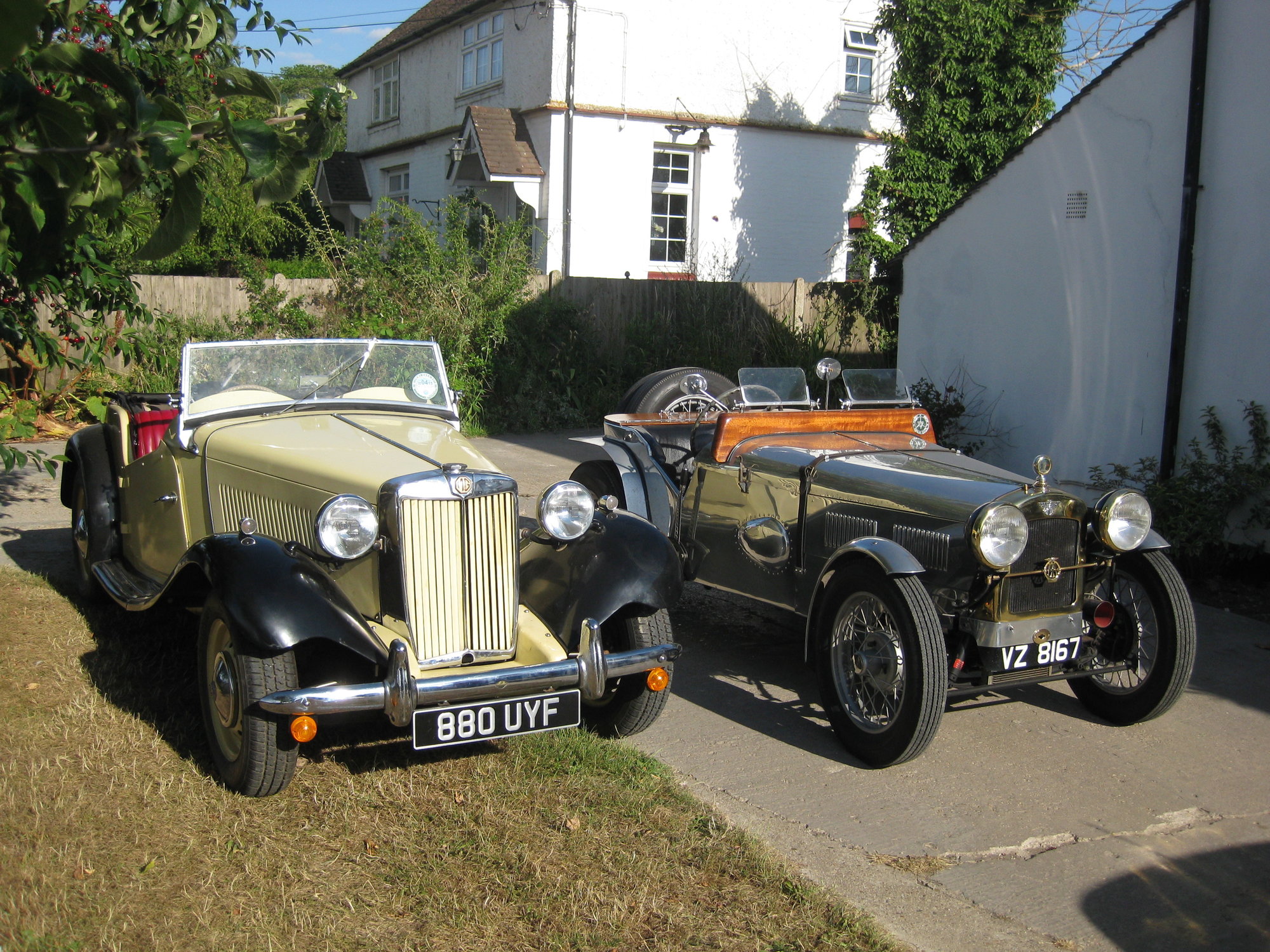

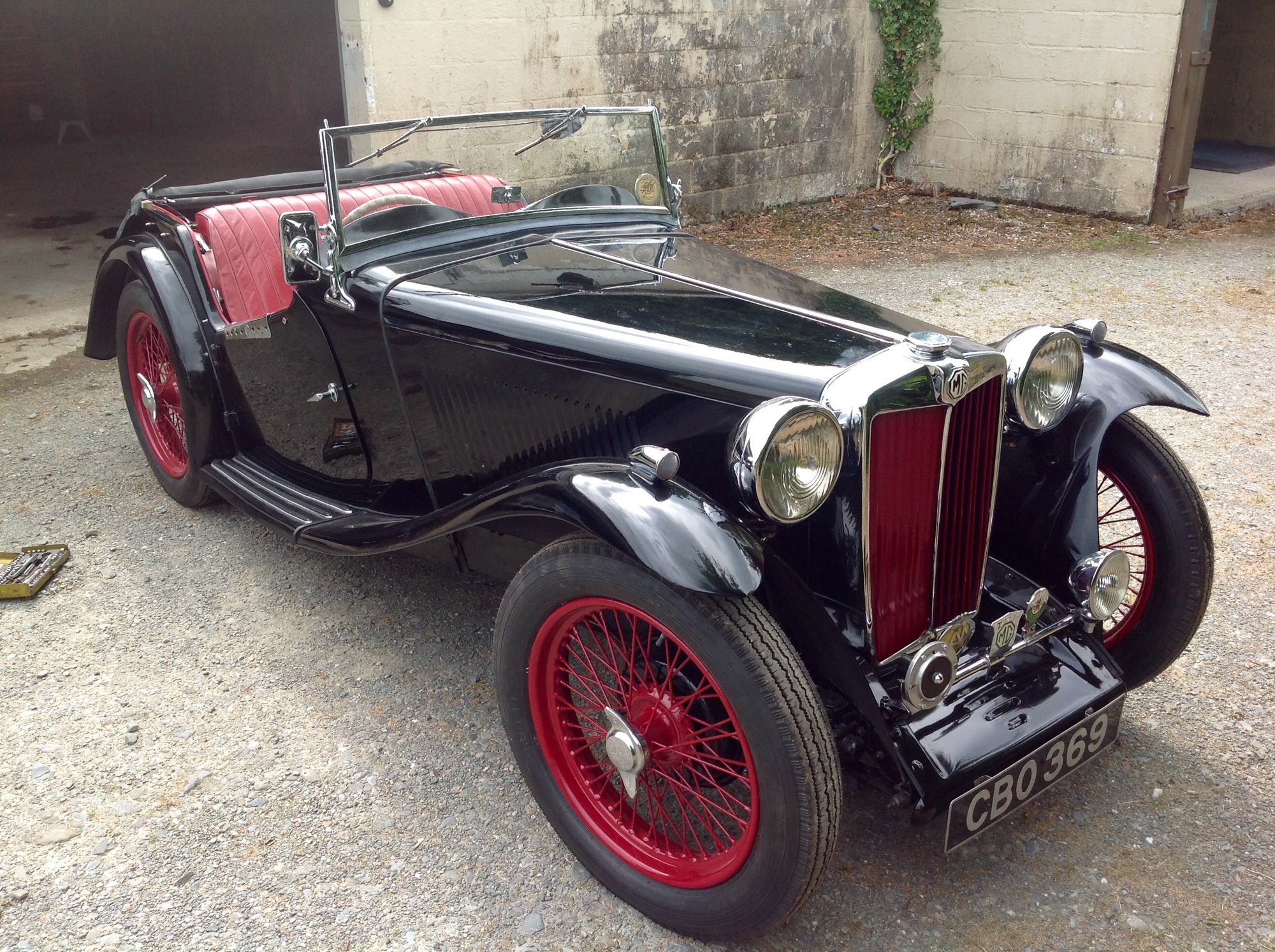

And the car nearly finished; the wiper motor turned out to be suffering from Joseph Lucasitis when I took the MG for a test drive, so needed fixing. That's my 1932 A7 special parked alongside.
