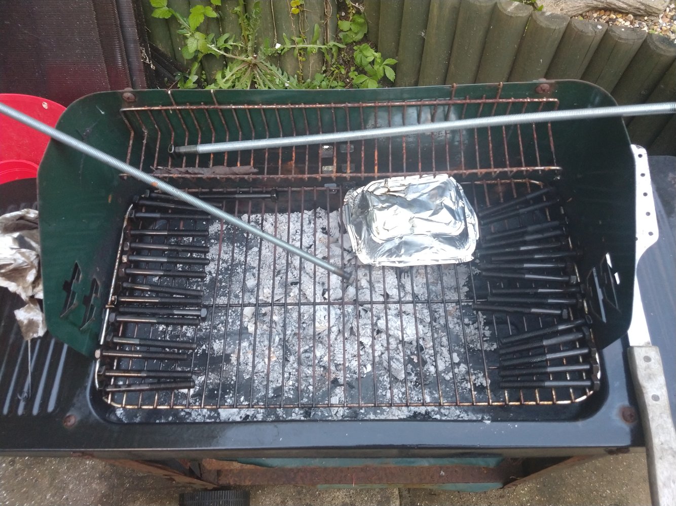

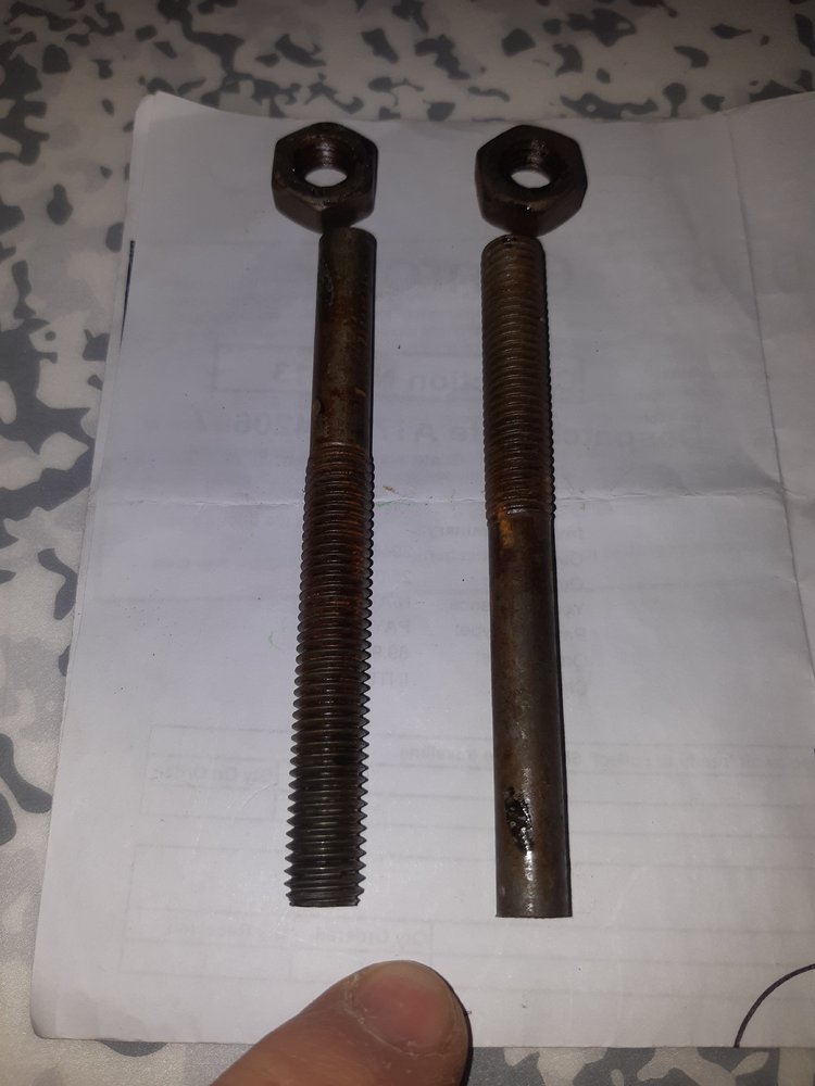

To blacken my free bolts, I've decided to heat them to cherry red over charcoal! Fitting as a bloke up the pub makes his own and gave me a bag. Good stuff it is too.
Then I'll dip them in, again free, waste engine oil.

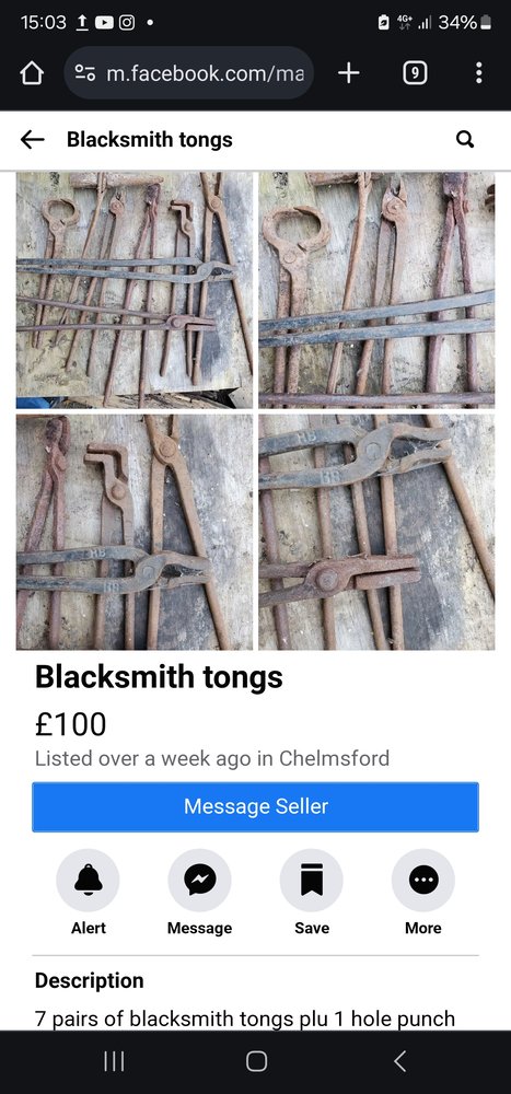

On the lookout for a set of blacksmith's tongs.

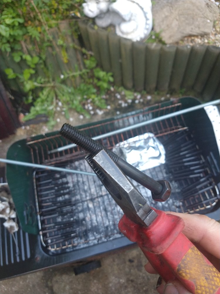

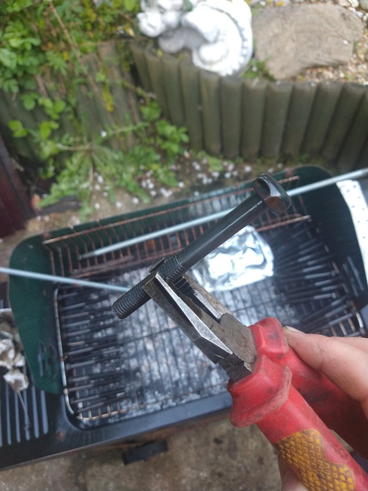

Water pump pliers they have longer armsLong nose pliers it is then!
Draper Waterpump Pliers (240mm)
Carbon steel hardened, tempered with black phosphate finish for corrosion protection. Five position slip joint and serrated gripping jaws. PVC dipped handles. Display packed.gsworkwear.com

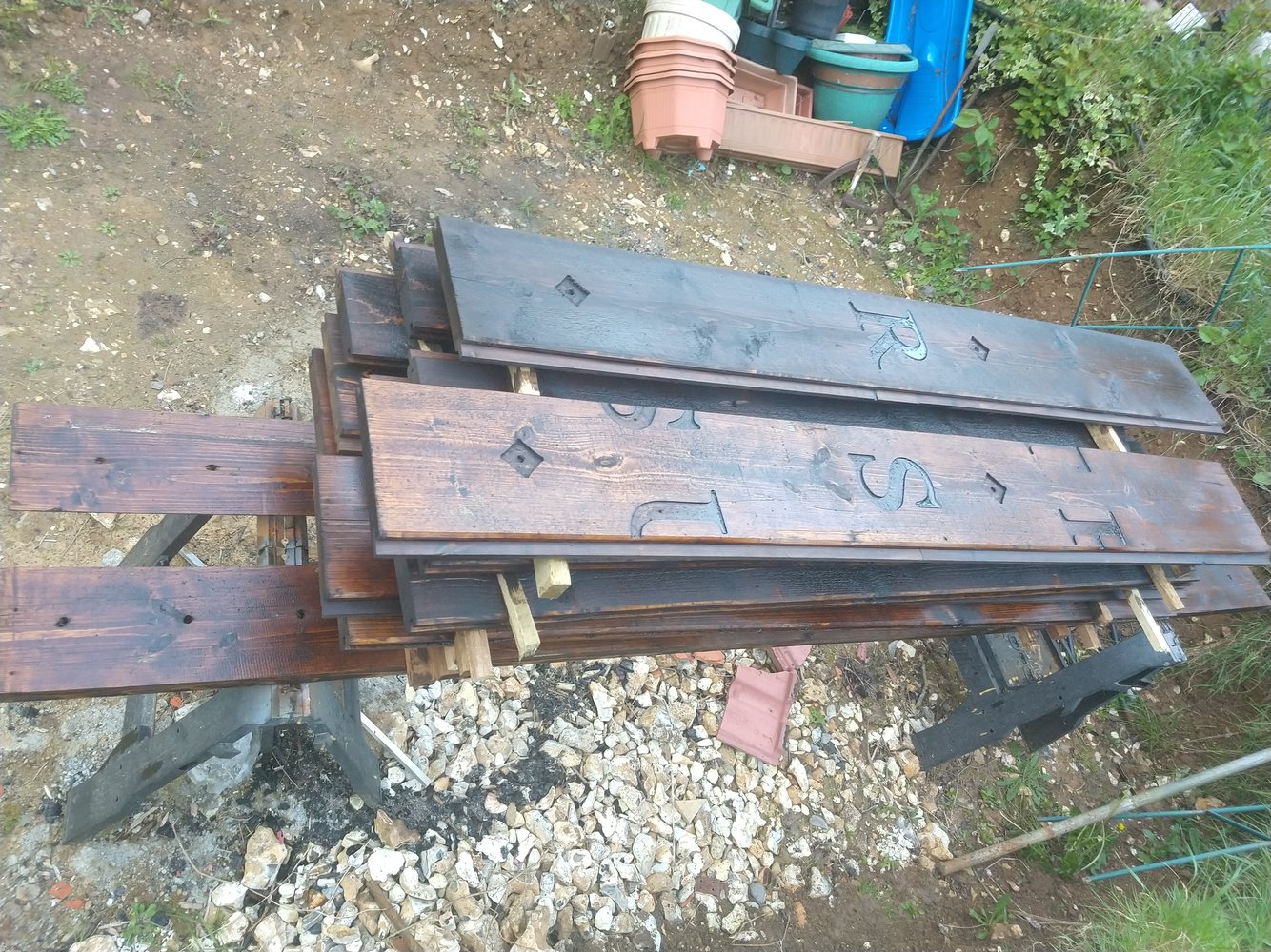

....Need to drill / slot the sign so the slats can expand & contract.
(Stainless sign was free too).
Just fix the sign on one side?
