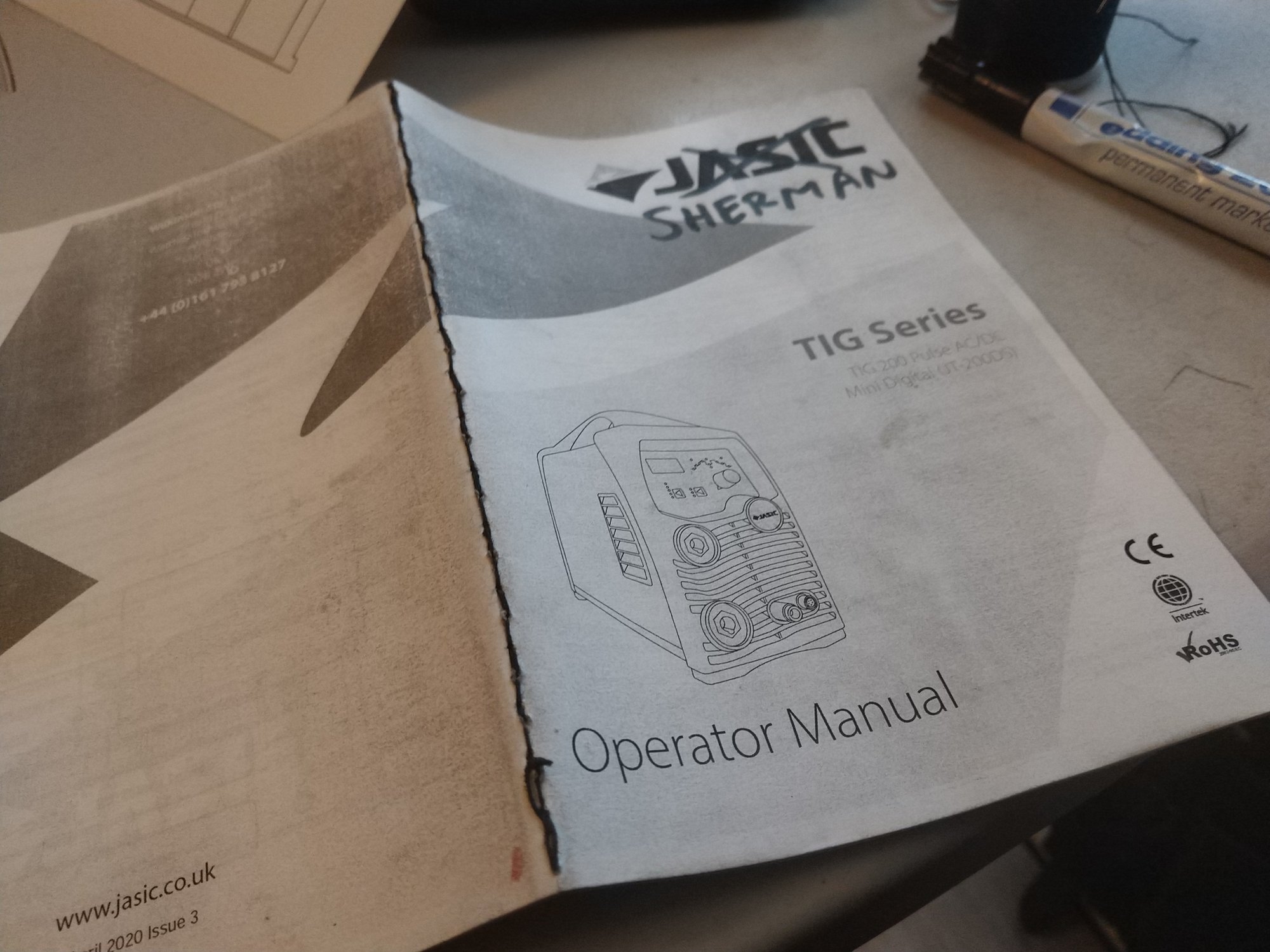

What manual is that from? Can't see it in the jasic manual
As above, also the manual I got with the Sherman was all Polish so no idea if it is there or not.

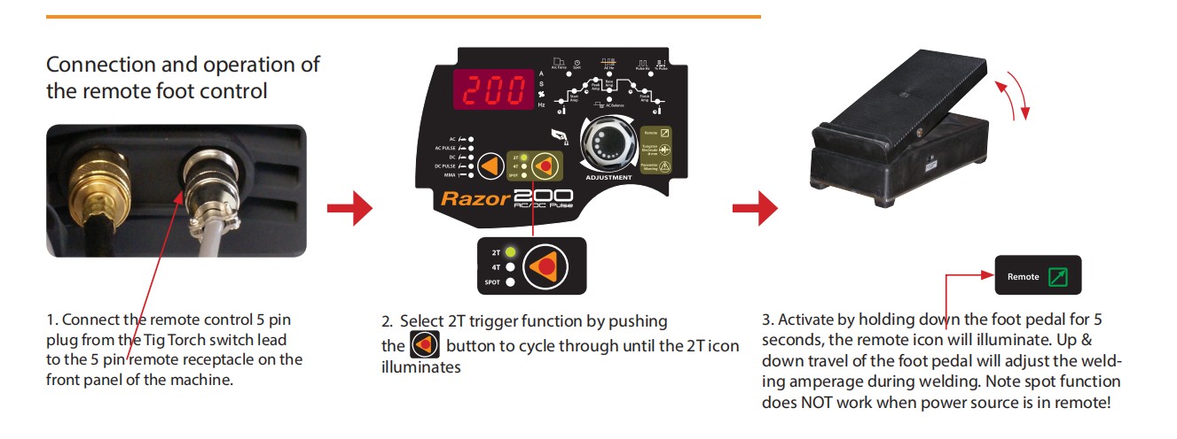

The RazorWeld manual is actually more comprehensive than the Jasic for a lot of things and it says as per pic below but whether the Sherman is the same or for that matter the original Jasic, I have no idea.
I suppose it is just a case of try and see.
. Are most people just sitting tight, or have people cancelled (and how did that go)?Just wired up a torch with a pot on it and I think I have it correct, will have to double check but the pot function is not working for me. Why I have no idea but the buttons didn't work for me either so possibly mine has an issue with remotes. Not that I am really that bothered but would still be good to have that capability.
BTW I tried activating the remote in both 2T and 4T so it is not that.

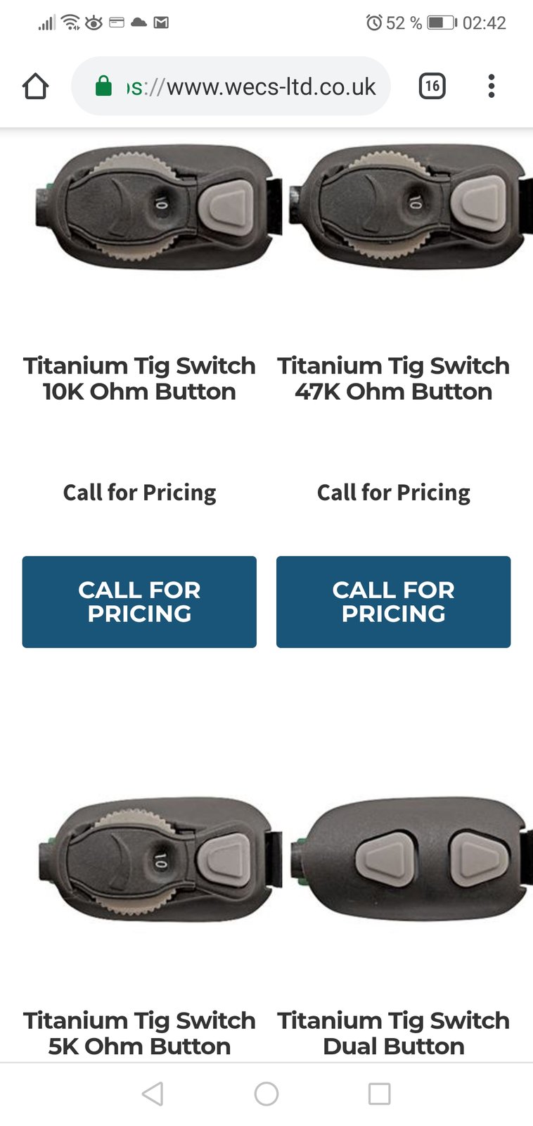

No idea, the one I have tried is a Parweld, 5K pot, also tried with the 3 button insert and couldn't get that to work either.which buttons do we need, 5k , 10k, 48k?
Ah ok, maybe the display doesn't change but current does, if that is the case then not much use for a torch pot as you have no real idea where it is set at first but I will try and see if I get a chance.Did the remote light come on at all or are you just getting nothing?
My pedal definitely worked on straight ac, 2T. Don't know if the display altered with the pedal but when welding could certainly bump the current up and down
Ok, well not sure what is normal with a pedal as I never use one. With the pot on the torch which should basically be the same as a foot pedal, as far as the machine is concerned,my Stealth and the previous few Tigs I have had the current changes on the display as you turn the pot. You set a max current on the display before welding via the dial then as you adjust the pot it changes the display.can still change the max current on the display before welding while in remote mode, say 100A, just mean as I'm welding I have no idea where it is between 0 -100A just guess by pedal position and how melty it is. Assumed that was normal?
