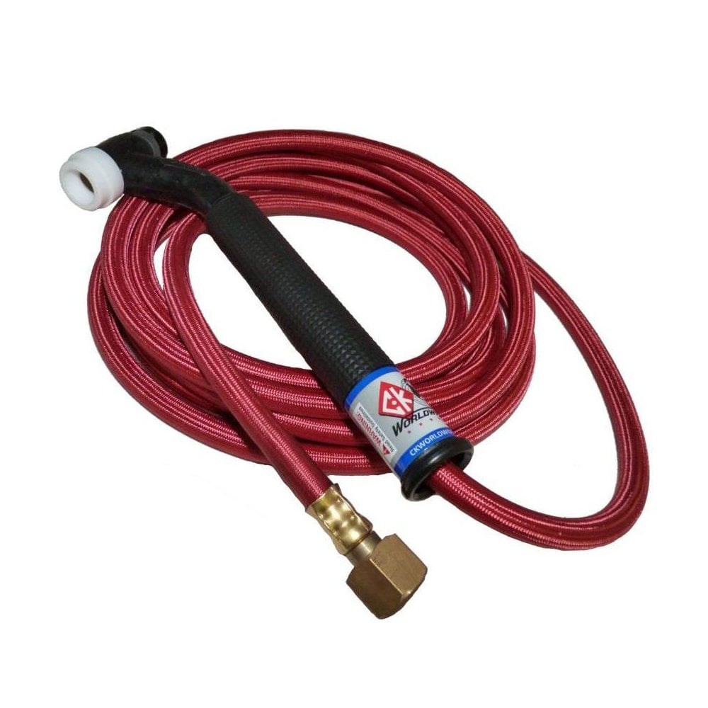

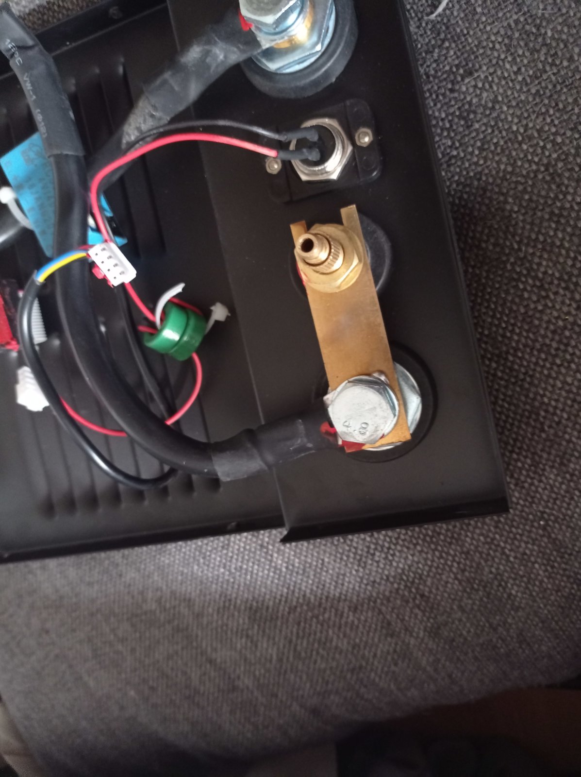

So technically I could order any aftermarket torch (Looking at CK) + 35/50 dinse connector, decapitate the original torch to get the 10 mm gas fitting (Or look for a new one) and put it on the adaptor?
This might be a real stupid question, but is there a way to know what connection does this torch has? (Cannot find it mentioned and from what I've found, there are two standards for these dinse connectors)
https://www.r-techwelding.co.uk/ck-...rch-flexi-head-with-sheath-and-switch-3-8bsp/
If it's the 35/50 one, then the gas fitting + plug for the button would be all I assume
I'm not the sharpest tool in the shed and the amount of different variables does not help.![]()
It's a 35/50, I'd be tempted to swap the M10 gas to a rectus.
