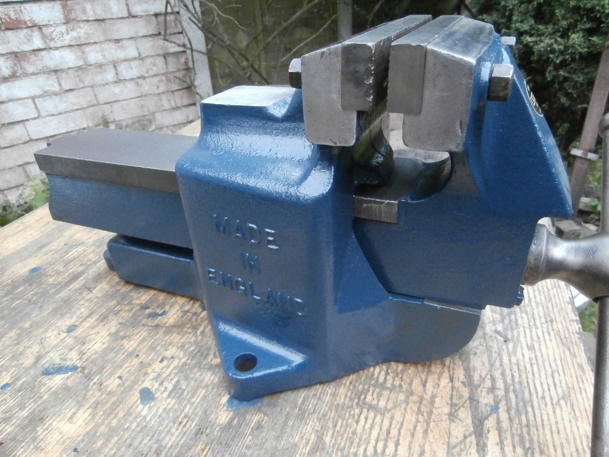

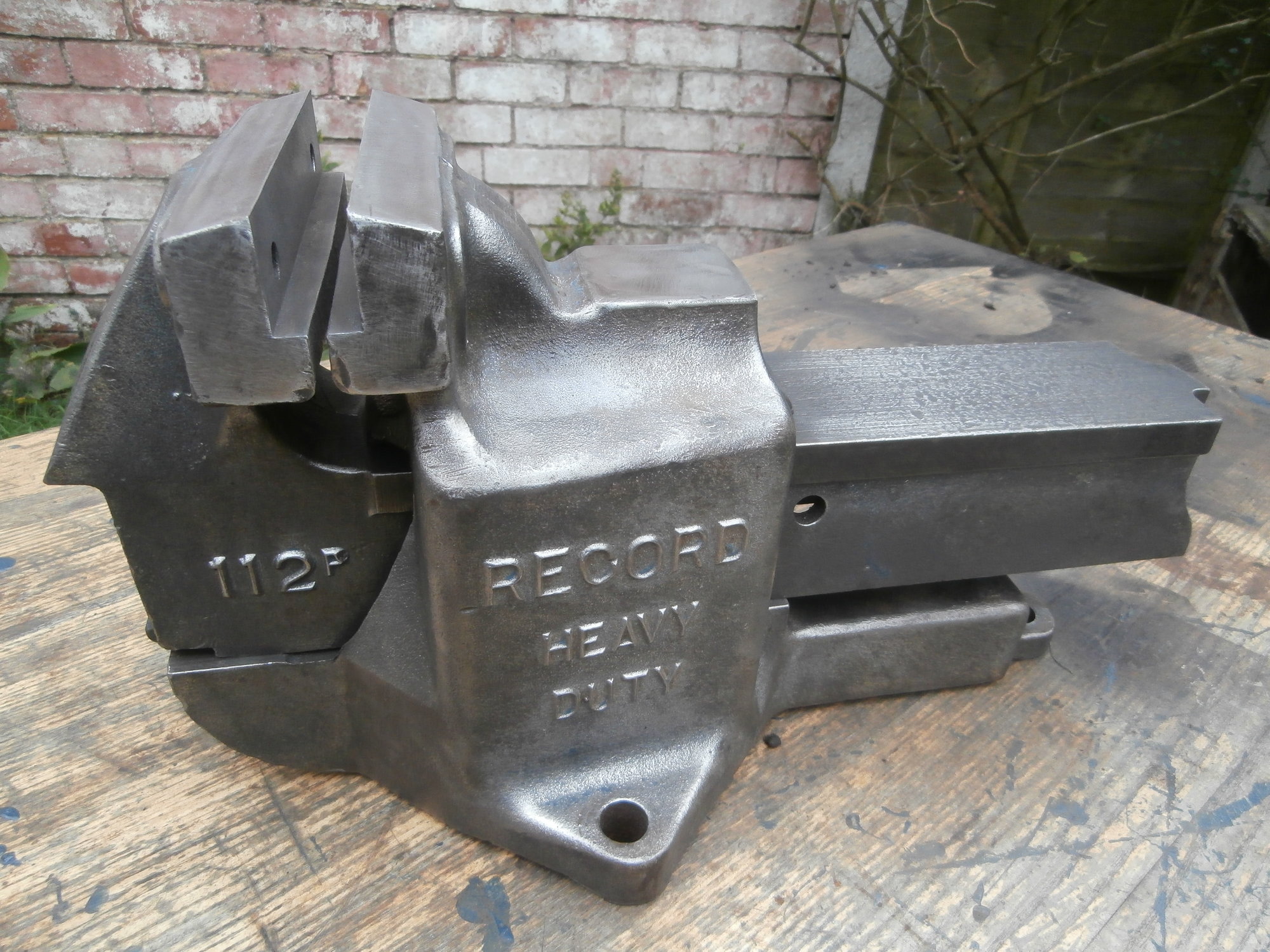

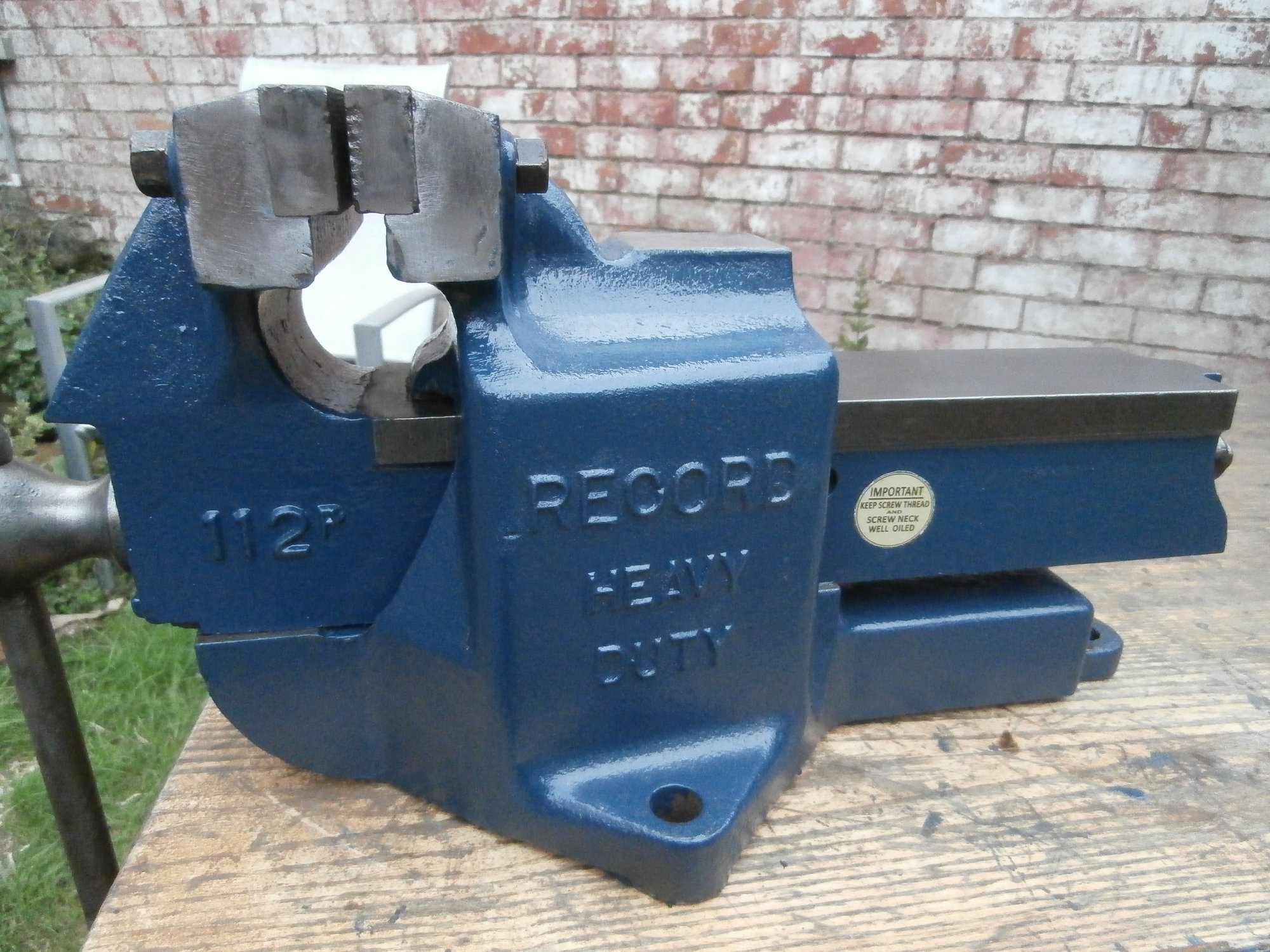

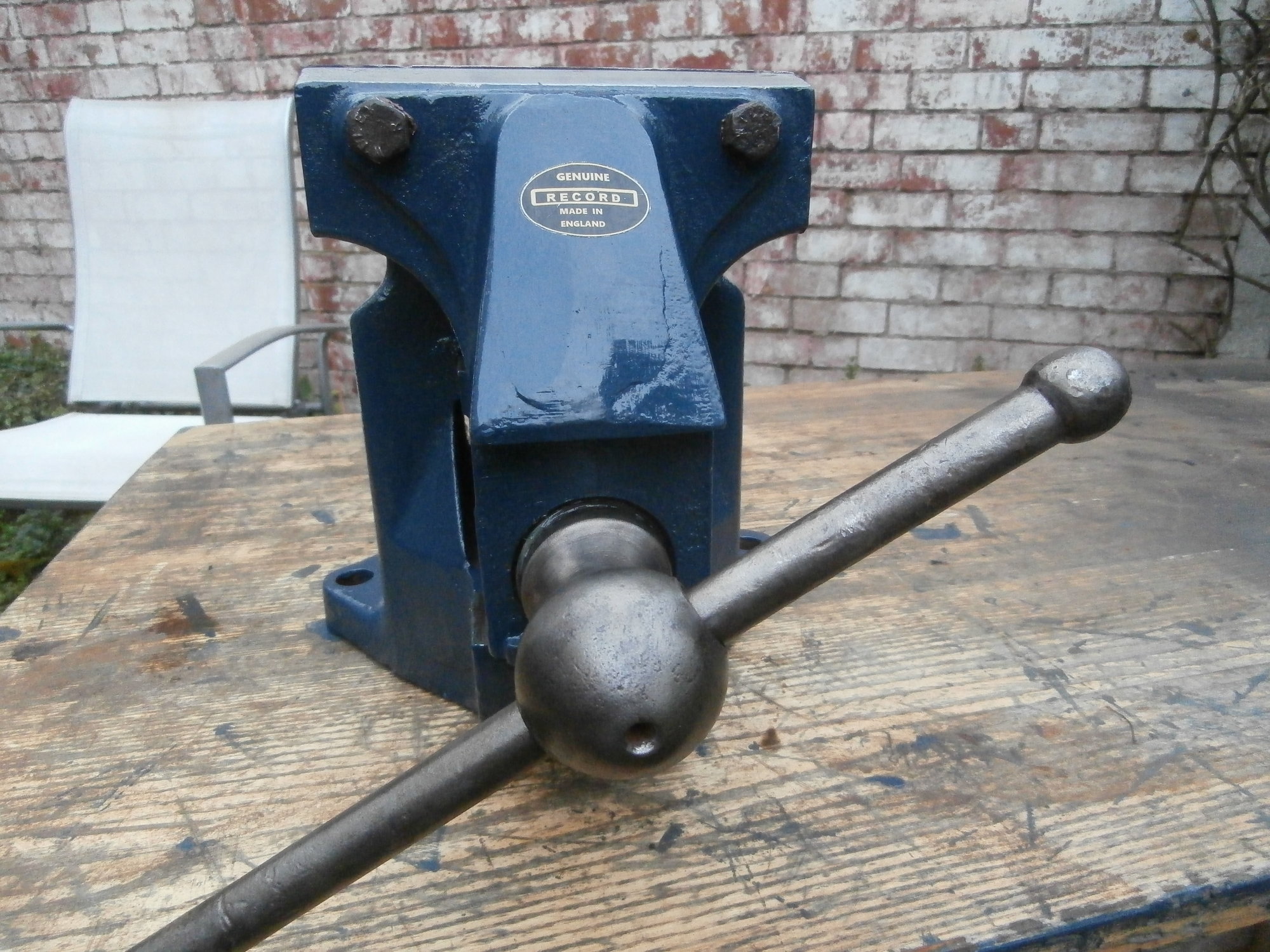

Nearly ready for painting

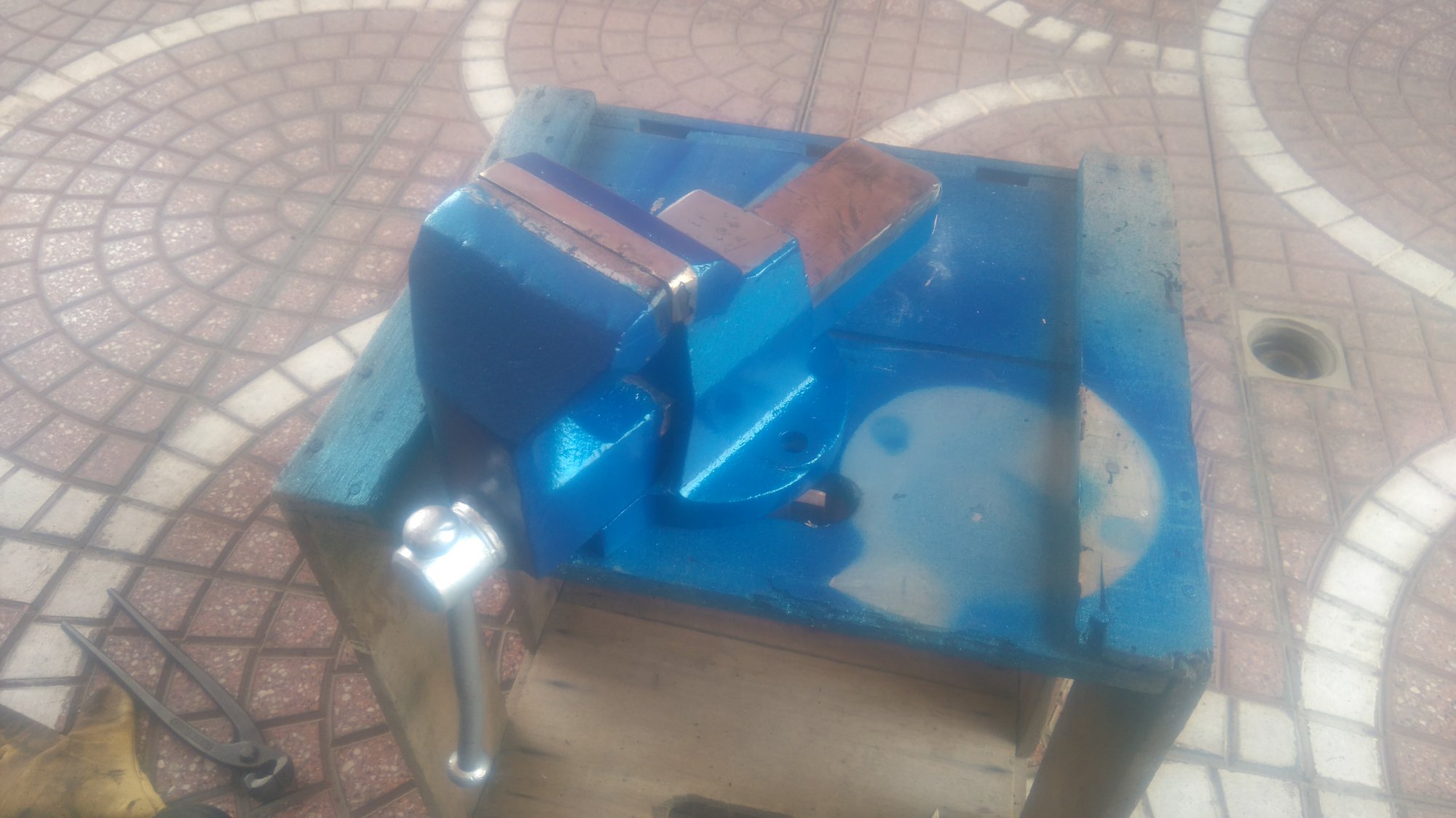

Twenty quid on ebay... I have broken more than a few, why put a hammering section on them when they crack when hammered? ,,, so I'm going to make one from box section and threaded rod when this one goes.

I'm afraid cheap vices are just that, a second hand quality one would be a better option but even then they aren't suppose to be a substitute for an anvil! A nice lump of scrap metal saves battering your vice.
and apes can destroy the best of equipment.
Few vices were ever steel. Malleable/ductile or cast iron, yes, but steel was almost always a specific range within a brand. All of the older English vices were sturdy & good quality metal, regardless of which metal they were composed of. Record only started going to pot towards the end of English manufacture.

However, there's a difference between light to medium pounding on a vice table/anvil, and just plain abuse. No matter how good the metal, you can't expect a hollow structure to supply the same benefits as a solid block of metal, and apes can destroy the best of equipment.
