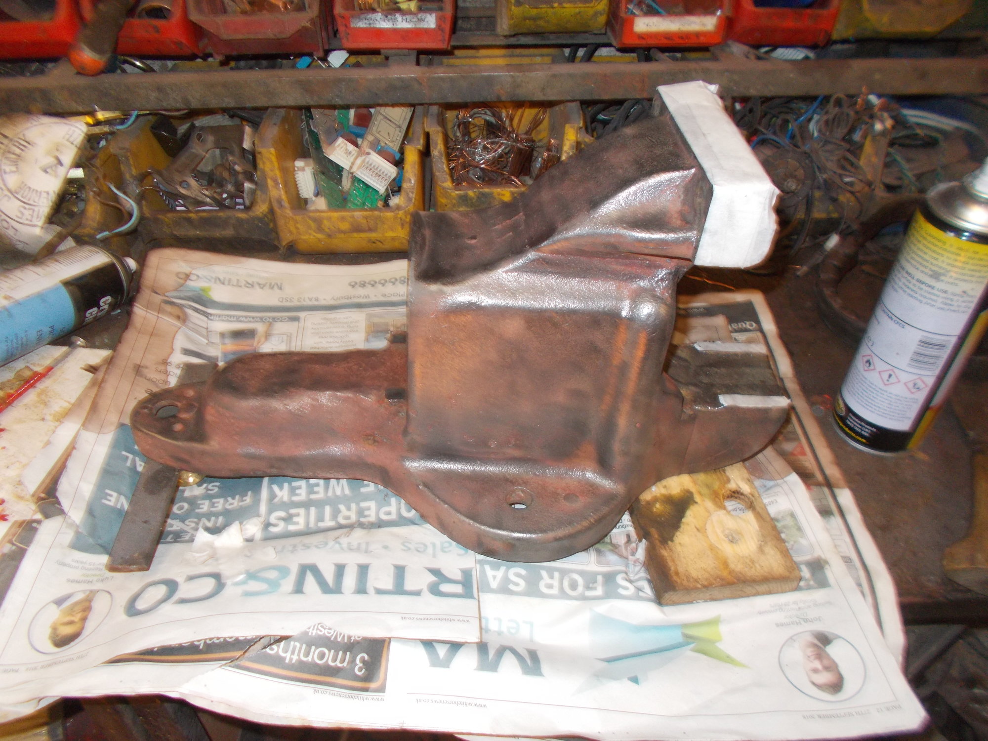

Knocked up a rotating base today rather rough and ready but should do the job. All the materials salvaged from work skip
Main spindle is 80mm, rotates on a ball bearing to raise us the weld slightly and aid turning. Couple of m16 bolts to lock it off and can insert a m10 bolt in front to completely lock it if I need to do anything heavy
