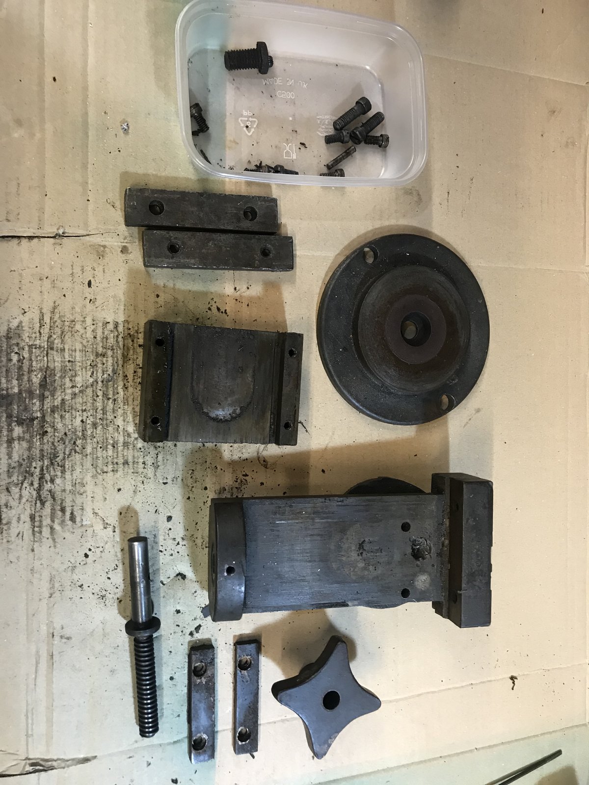

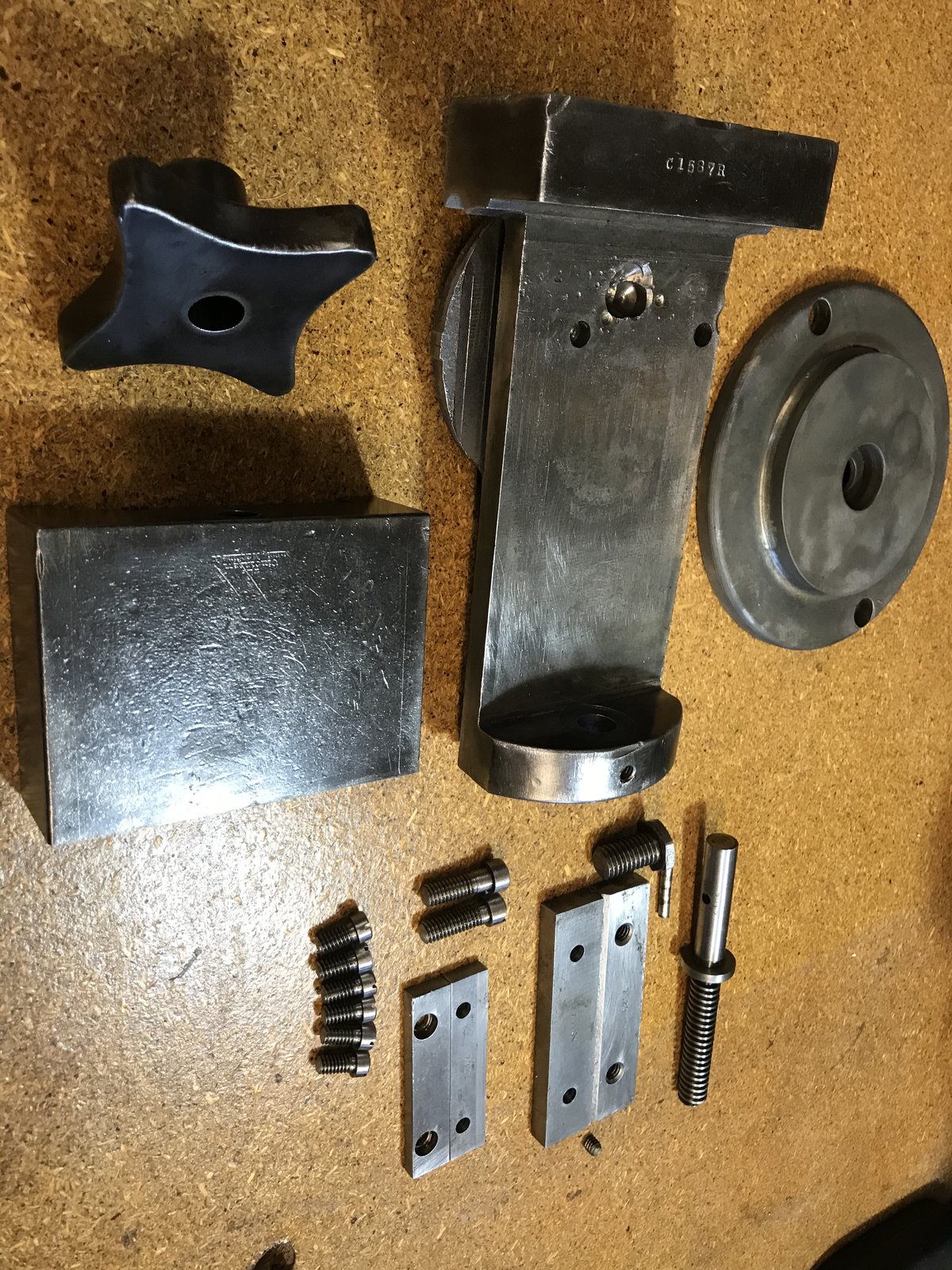

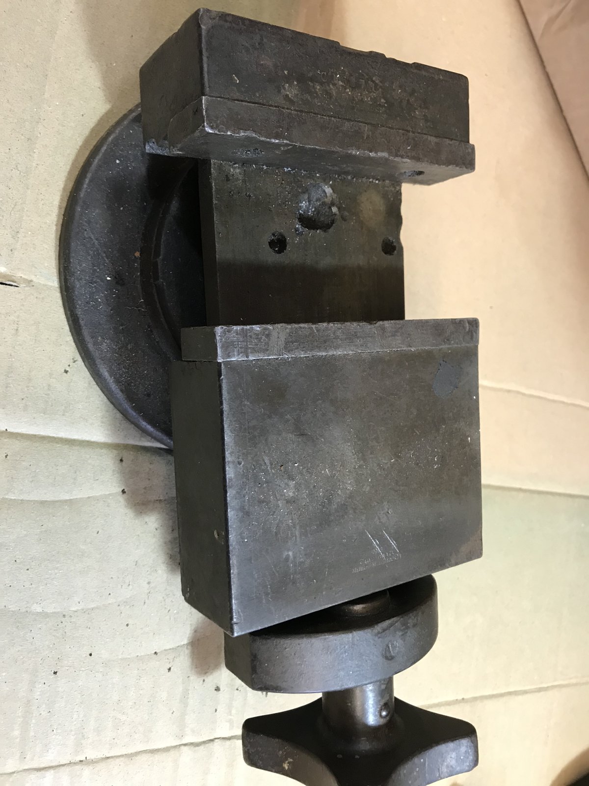

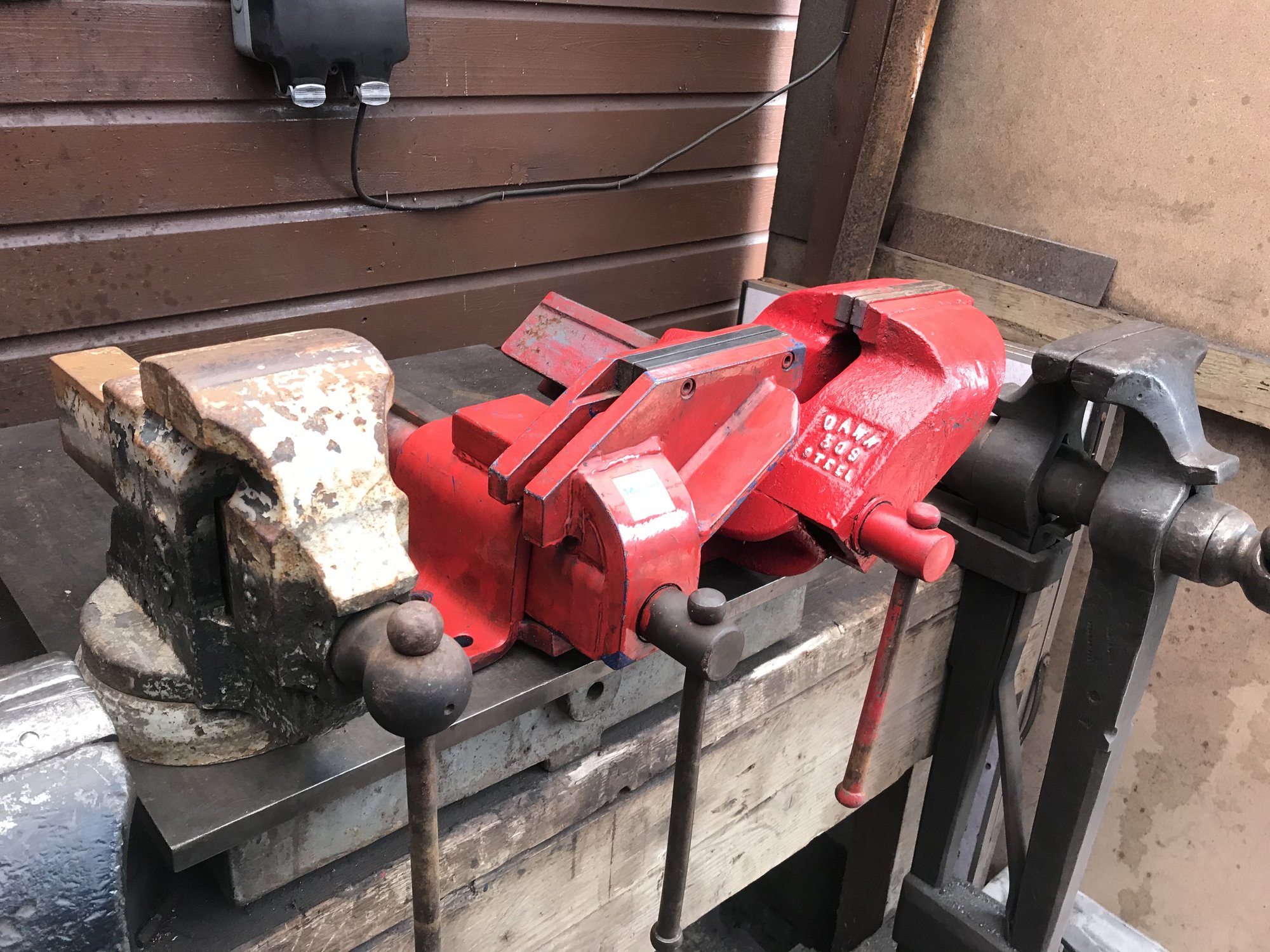

I got this little mill vice from @eLuSiVeMiTe, stripped and cleaned with a nylon wheel not too aggressive, base plate is a different steel, not cast, so put that in citric for 24 hours as I want an etch and may paint it, will heat & oil the main castings. It's a lovely little thing & really nicely made, even the screws are really nice. Apart from the fasteners there is a number stamp on every part.
The makers stamp "The Cincinnati Milling Machine Co" Never heard of them on vices?

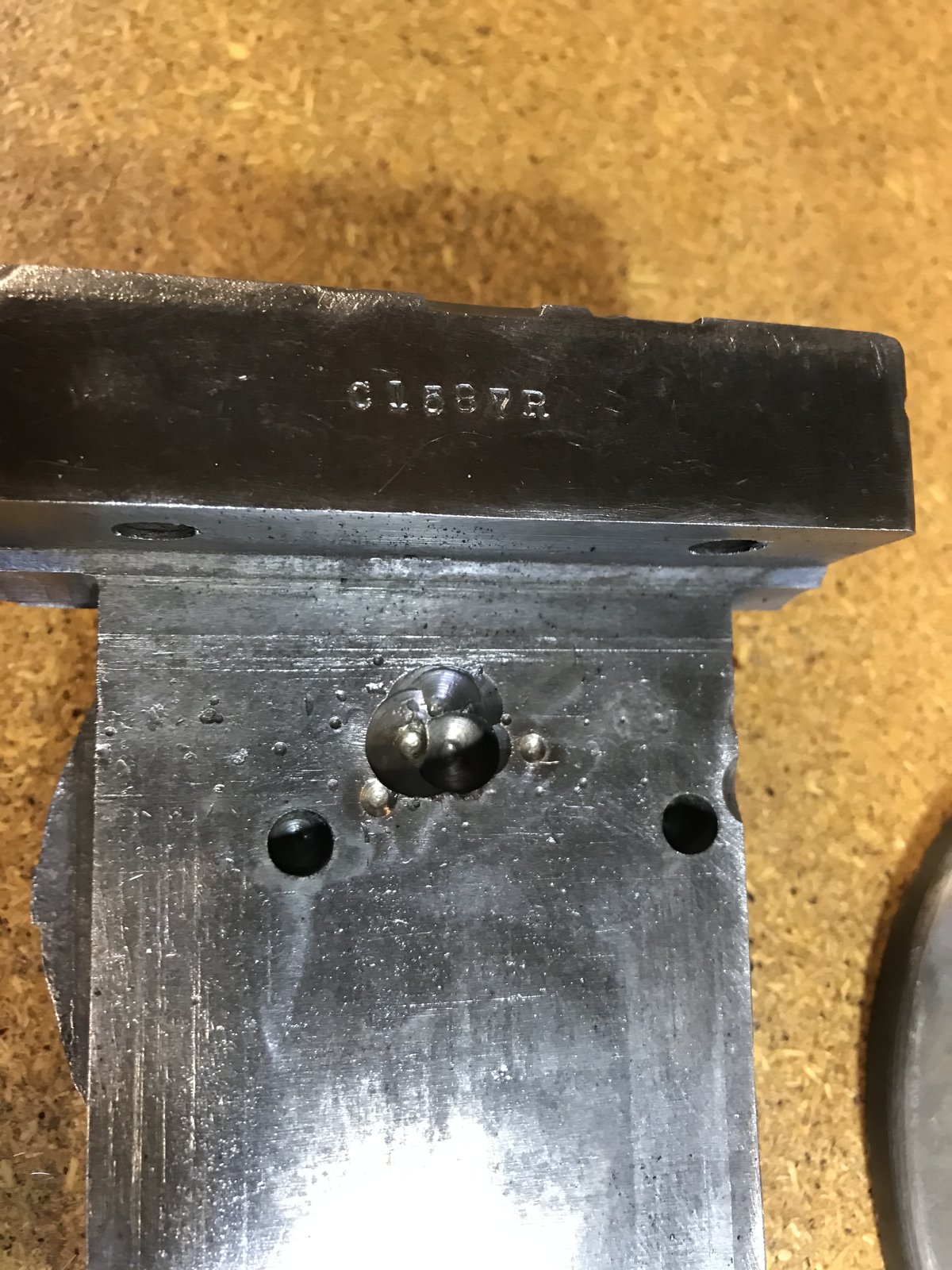

Don't think I can live with the holes, beggers belief how depth can be so misjudged, but my welding and the wee 151EN probably wouldn't cut it, what's more grinding accurately flat without damaging the rest
Ideas?
