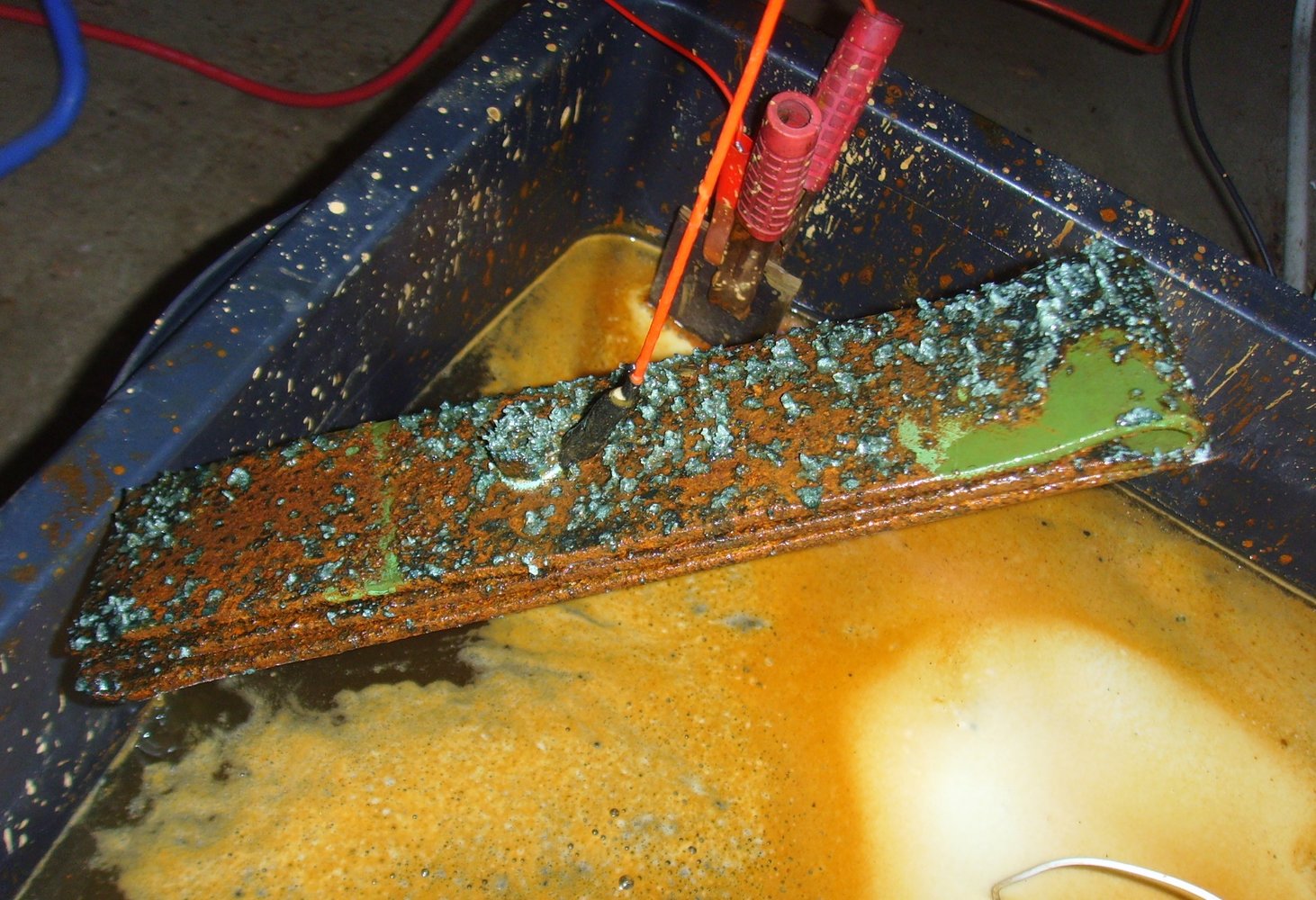

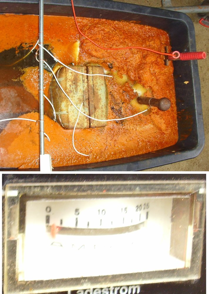

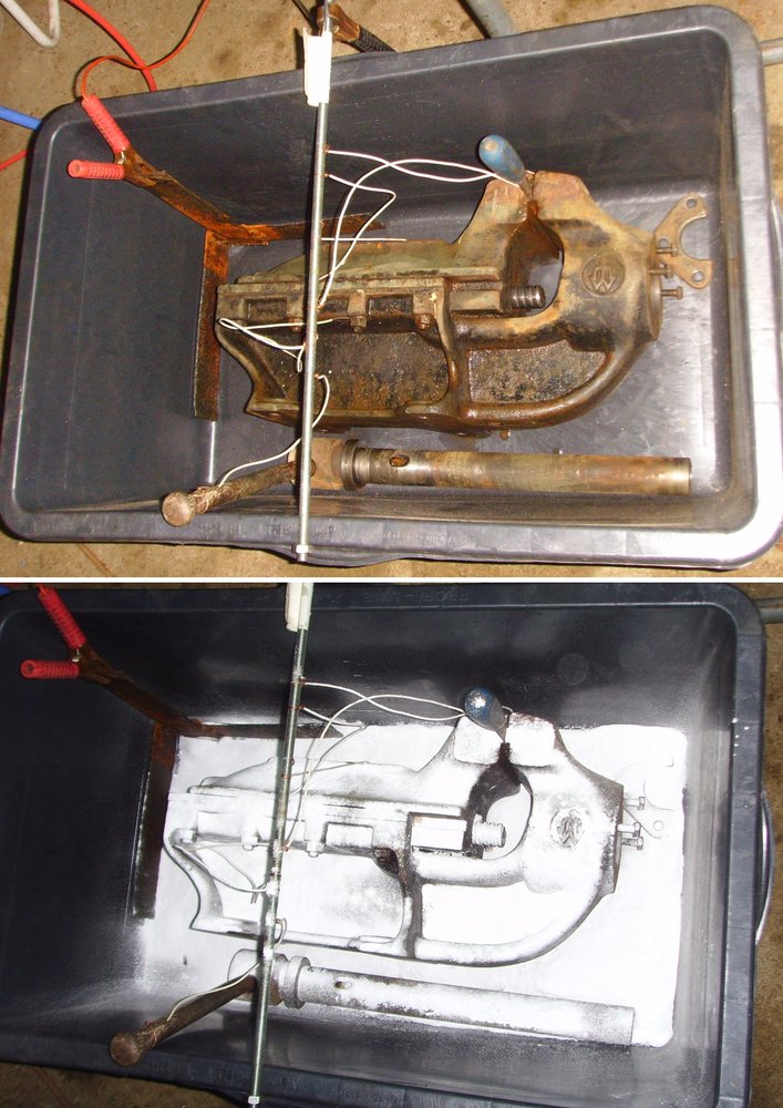

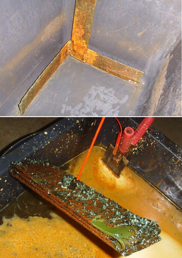

Hopefully I won't spoil anyone's appetite for breakfast ... in any case, electrolysis is progressing:
The initial current has halved after 20 hours, significantly more rusty nasty foam has formed, the level of the caustic has gone down by about 8-10mm.
Have a nice Sunday anyway!
