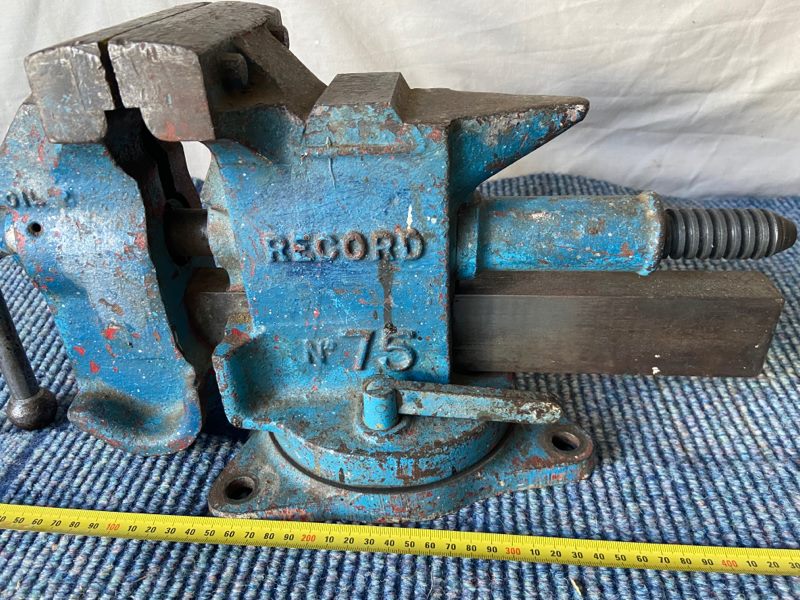

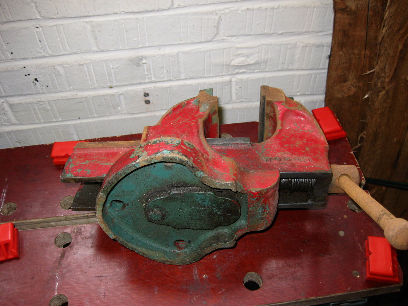

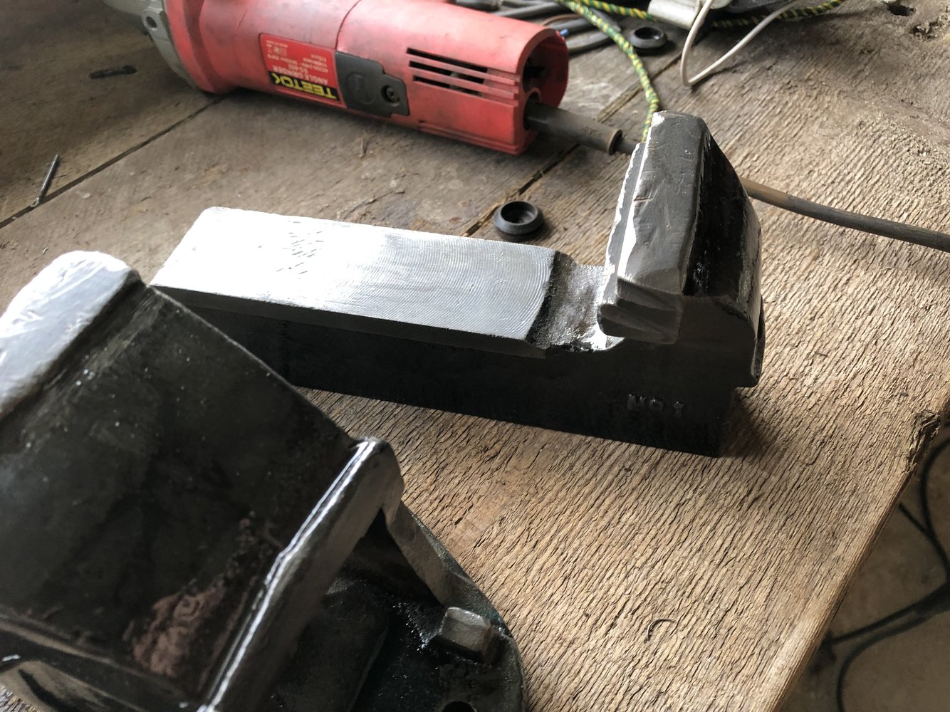

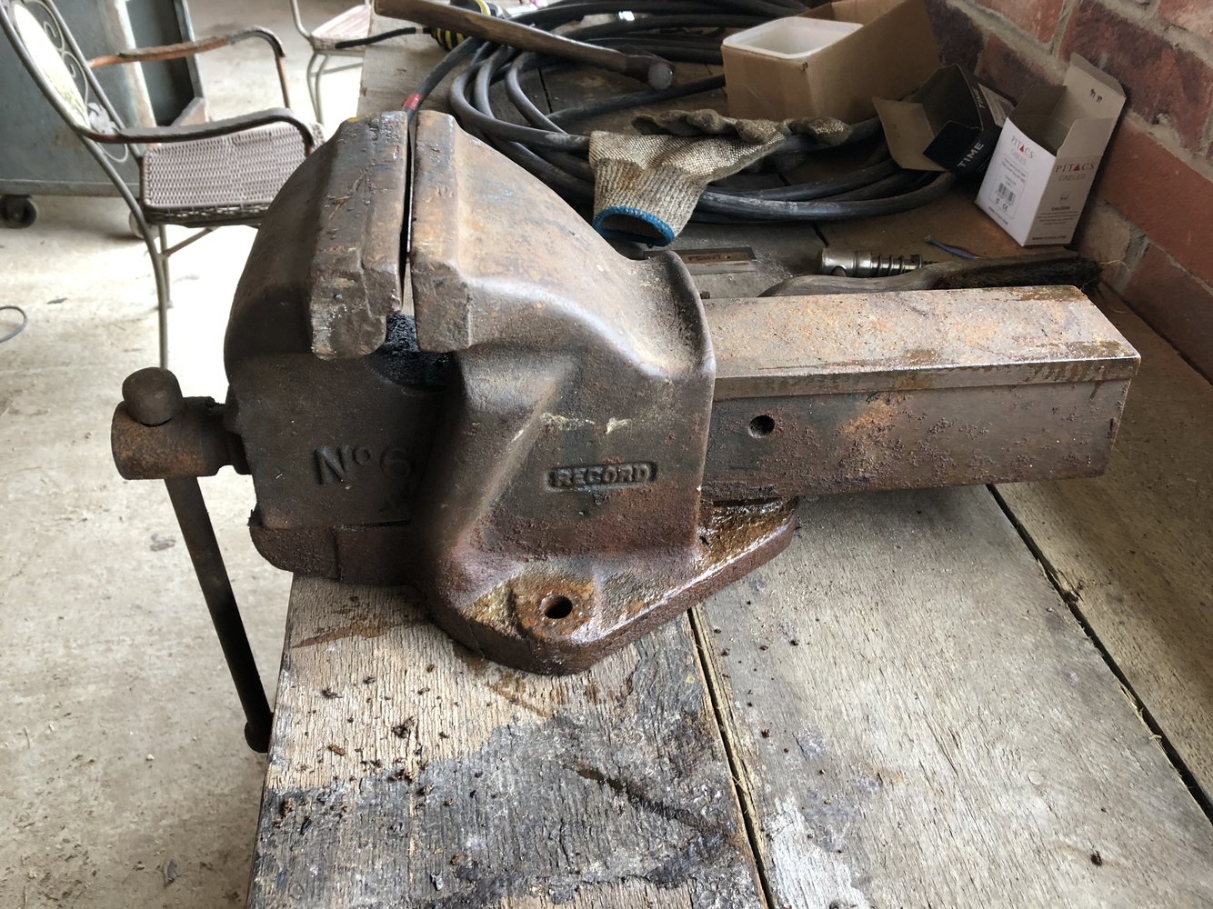

thats the best bent handle ive ever seen, score 10/10 for styleNew no 6, I'm keeping this one. A monkey has sliced the lip? off under the jaw. Presumably the jaw came off/loose and rather than repair the threads they thought the casting would be just as good. I'm going to weld on a new lip hopefully and then fit a new jaw. But for £40 (including he old workmate it was mounted to) and ten minutes up the road I can't complain too much.

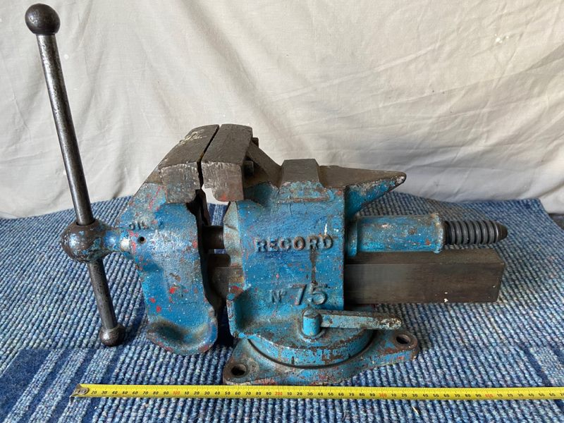

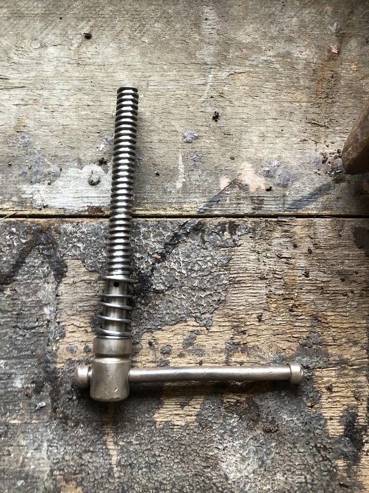

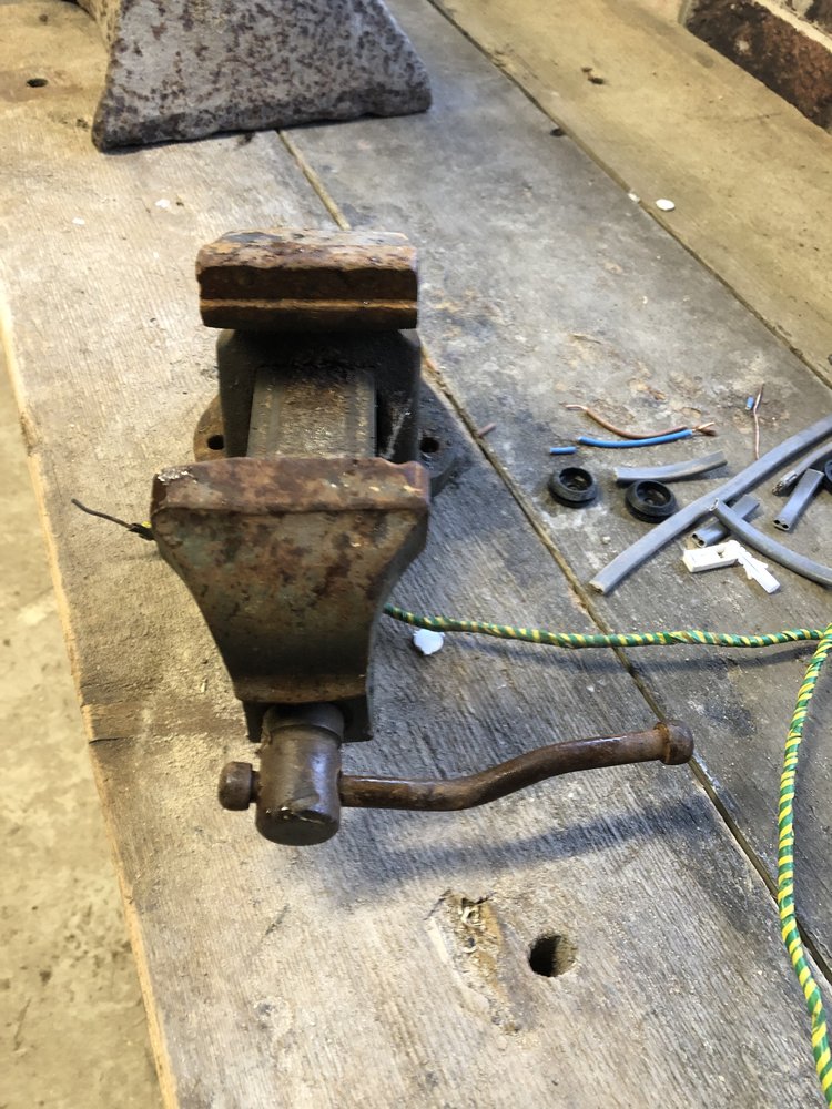

And a little paramo no 1.

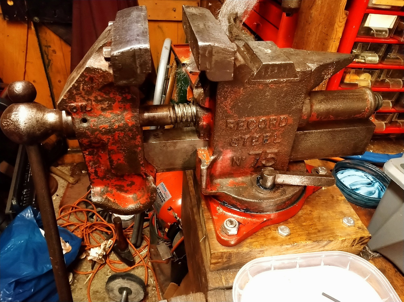

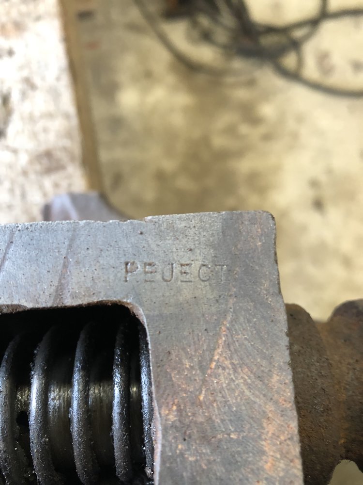

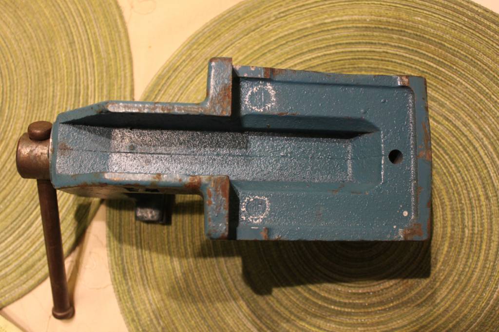

As found

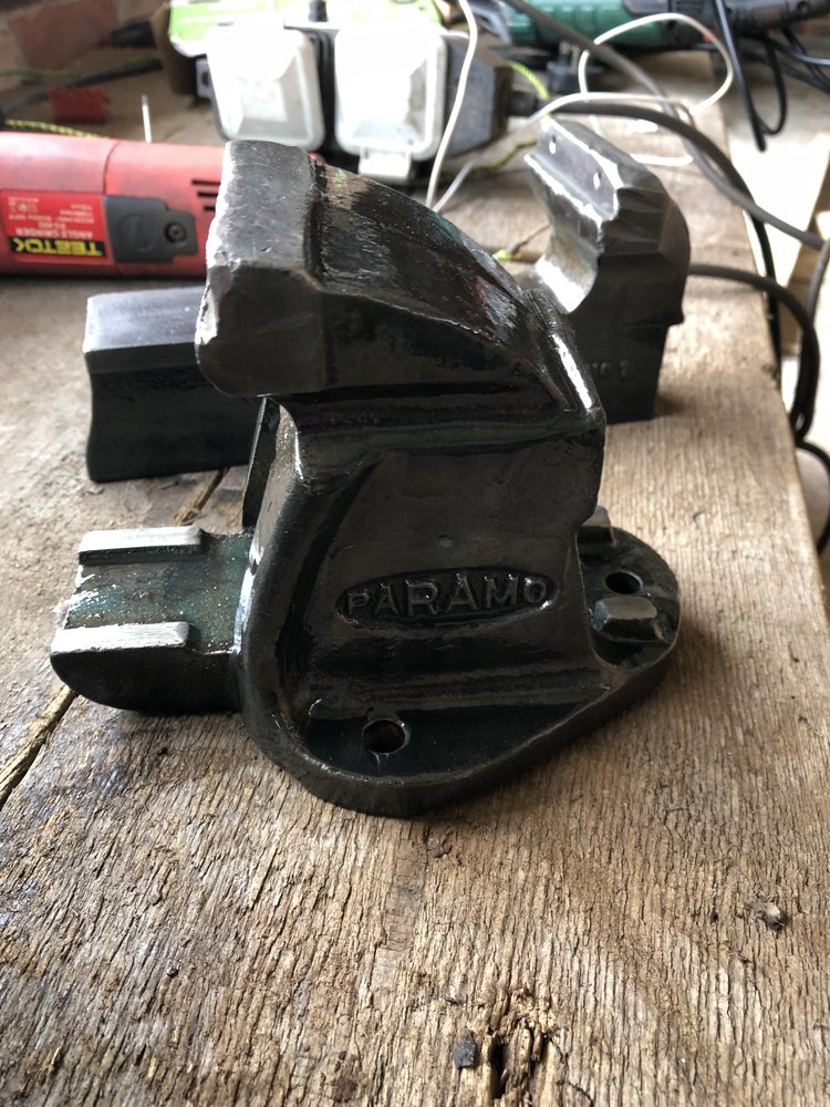

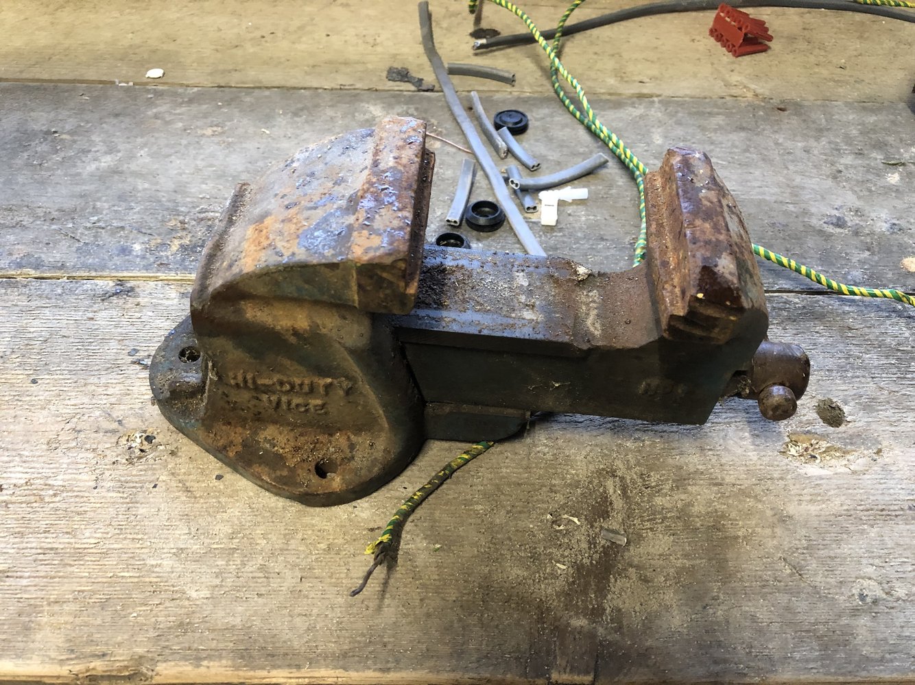

Drilled and re tapped the holes to m5. Made new jaws up, straightened the handle and stripped and painted.
