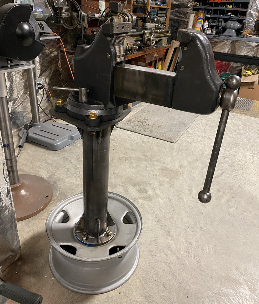

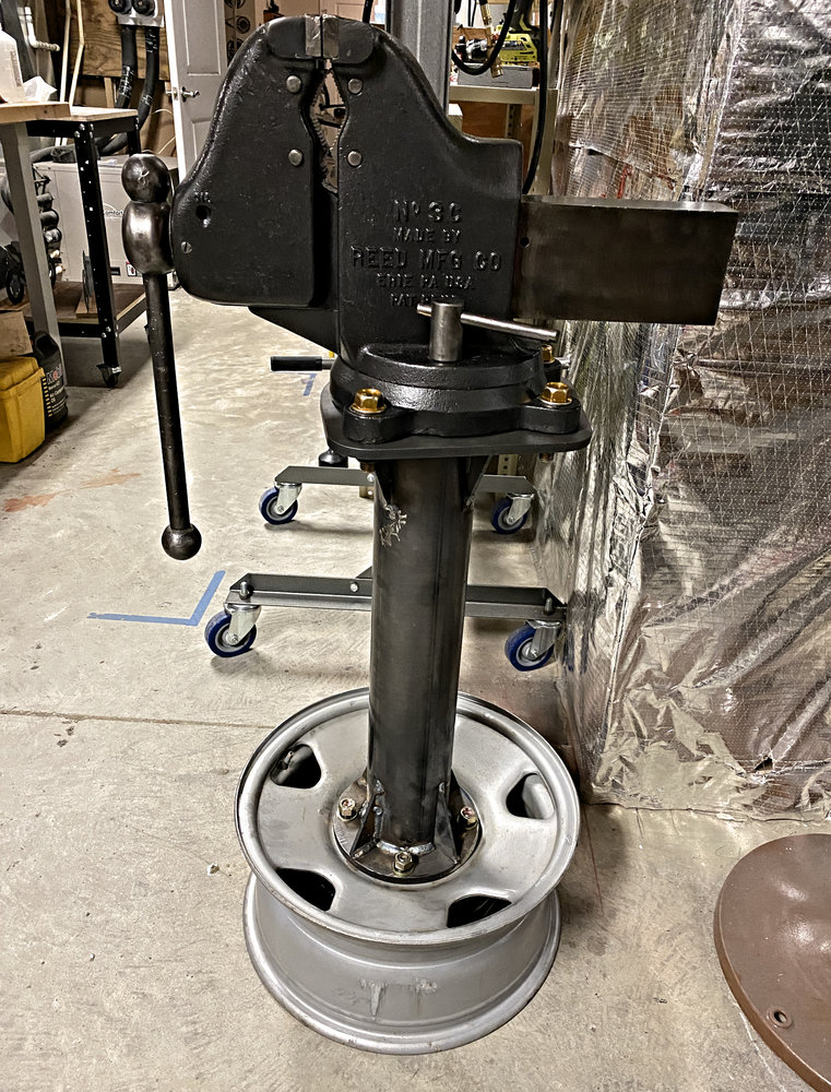

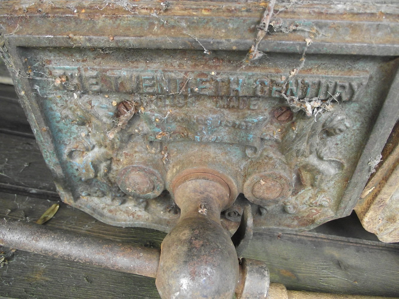

Finished the stand for my Reed C3. It has 75 lbs. of barbell plates inside the wheel rim. I was able to put all my body weight on the extended jaw without any sign of it tipping. I can scoot it a little on the smooth concrete surface with considerable effort. It would take someone with more sand than me to try to tip it and roll it on the rim edge.
