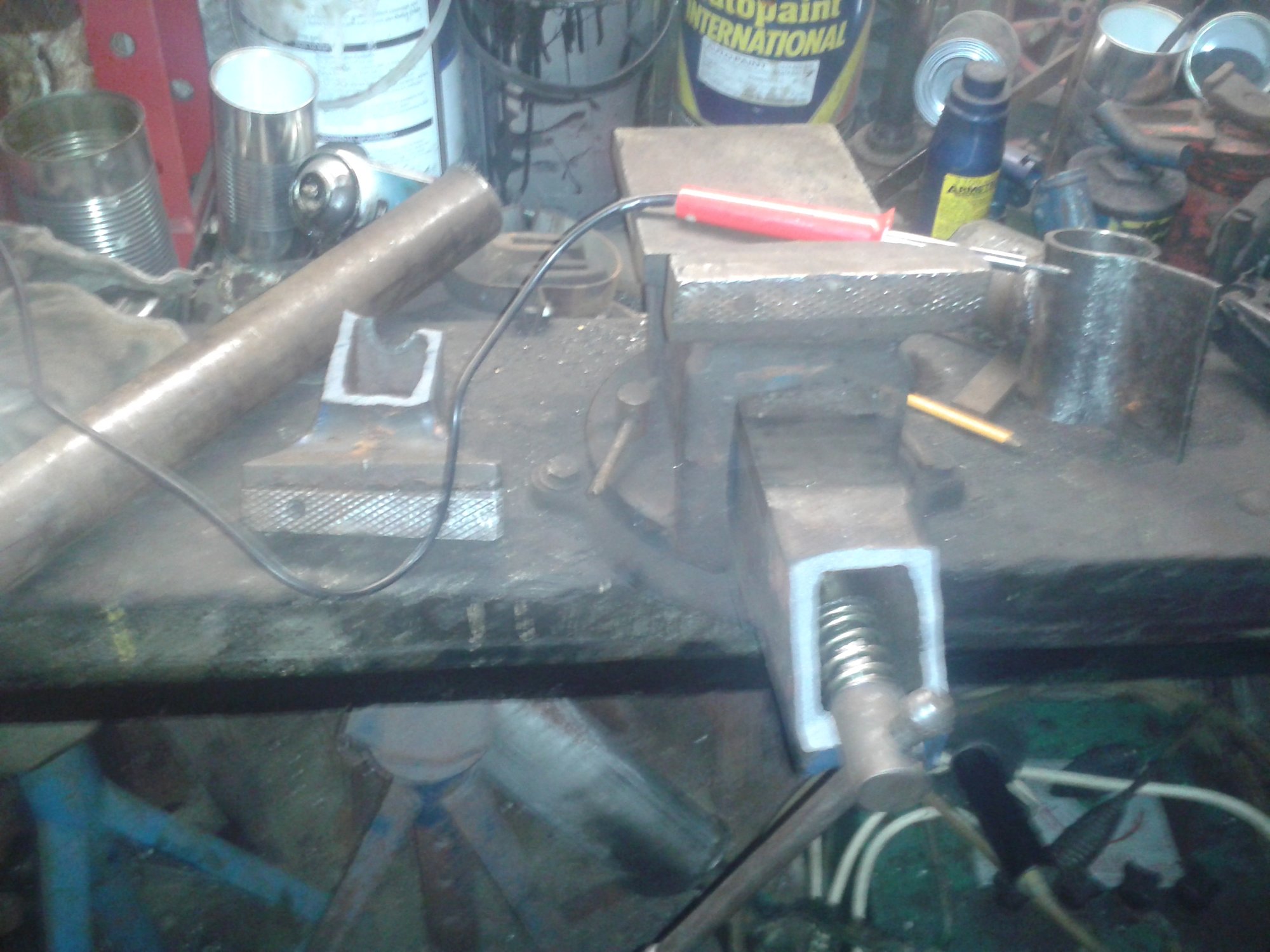

this is what i did to a vice recently though i still think it was cheap crap vice kept the rear and also the spindle and also the jaws as come in handy for something else

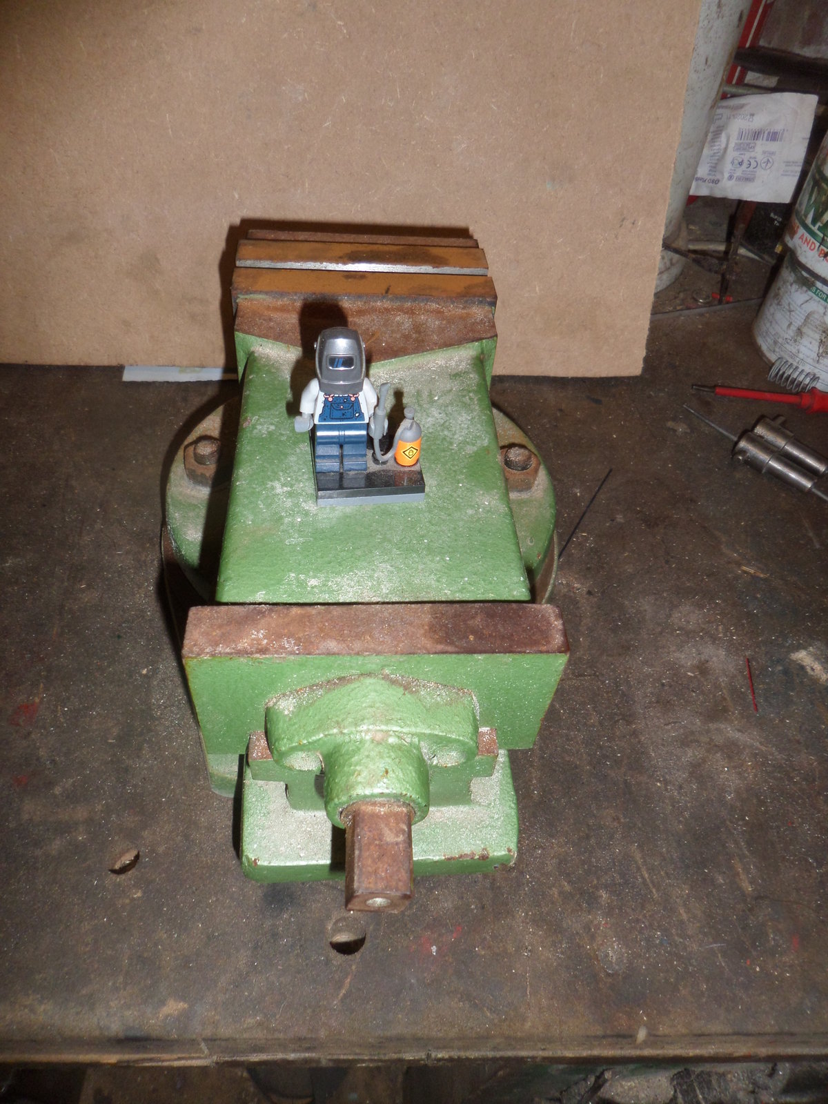

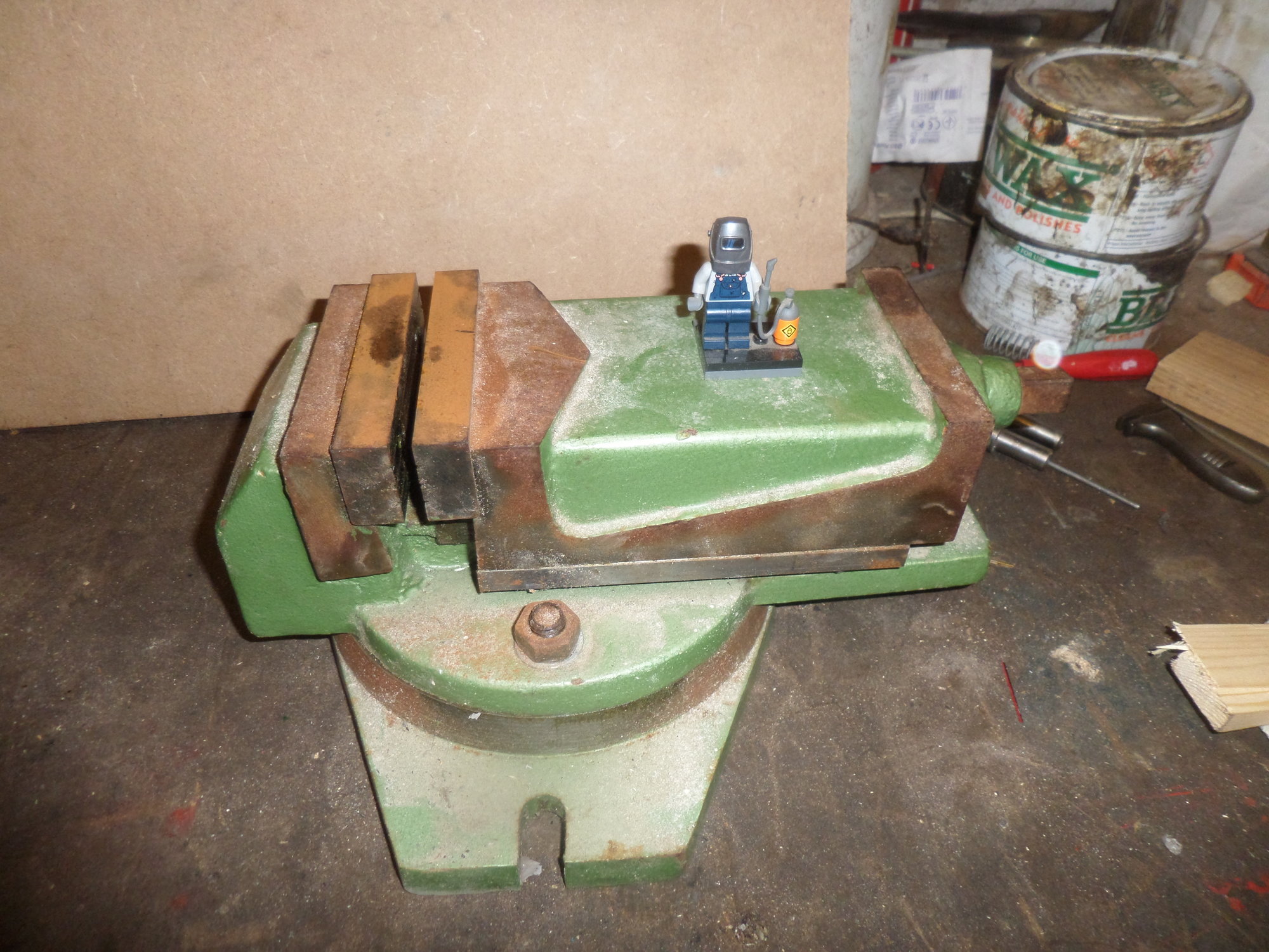

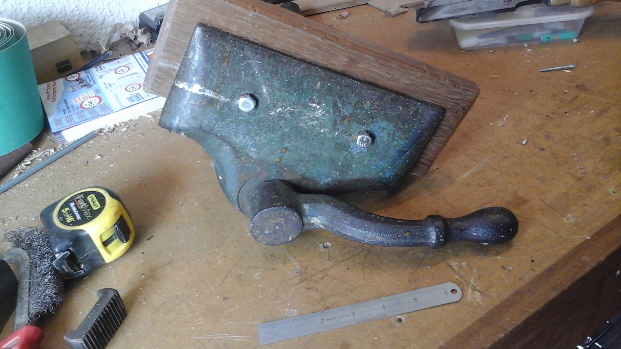

Got it for £30 in the end & started cleaning it up this evening. Very happy with it.
I used a course wire brush on a grinder. It had been painted grey over the original green colour so trying to take it back to repaint hopefully.
I like it 'as is', I wouldn't hide that under paint.

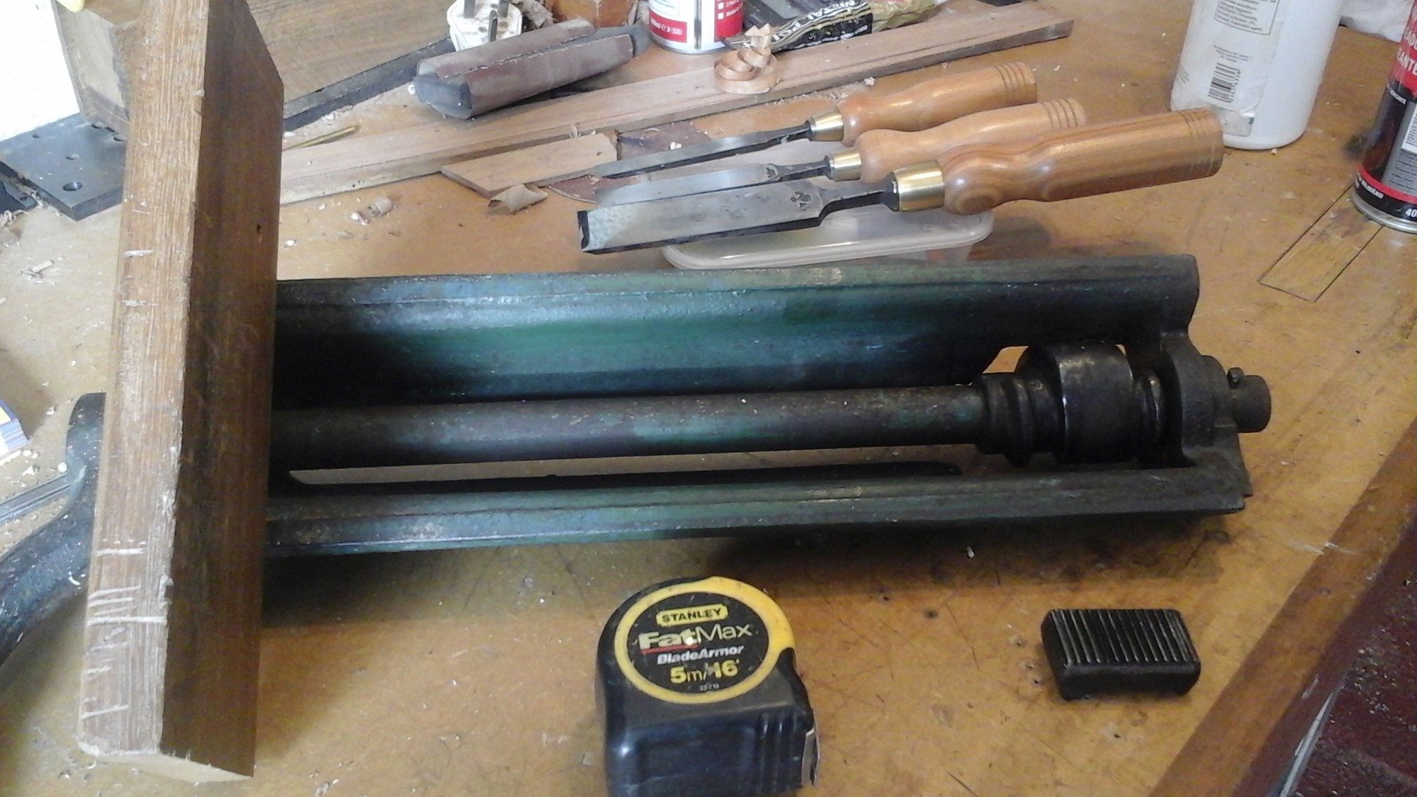

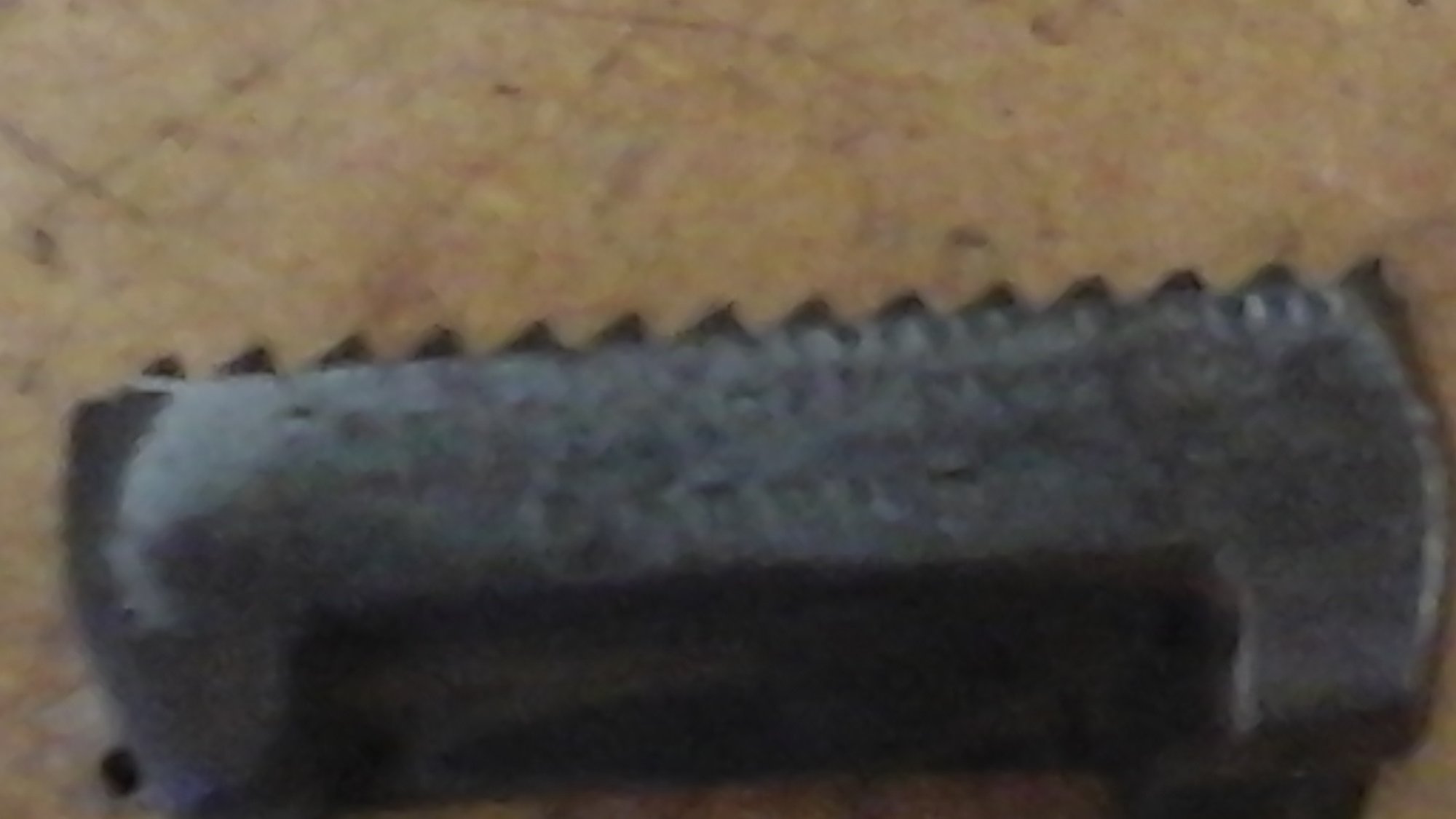

Here's some pics of the internals, the toothed bit is cam operated to engage on the main rack, stamped 9 one sde and entwistle and kenyon the other
Shouldn't be too difficult to make one, it isn't hardened, it may be possible to remove the rack from the fixed part as a pattern it is a fairly simple shape, rough it out with a grinder finish with file and hacksaw etc,let me know if you want more picsI have a Woden in that pattern minus that camlock tooth bit, I need to find one. I have never seen another Woden one but its in the catalogue. The later style of Woden we are much more common
