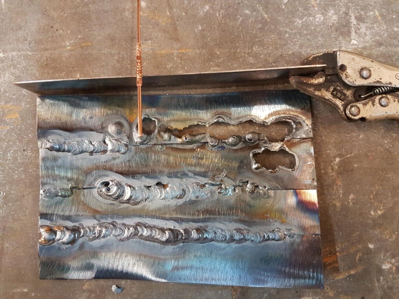

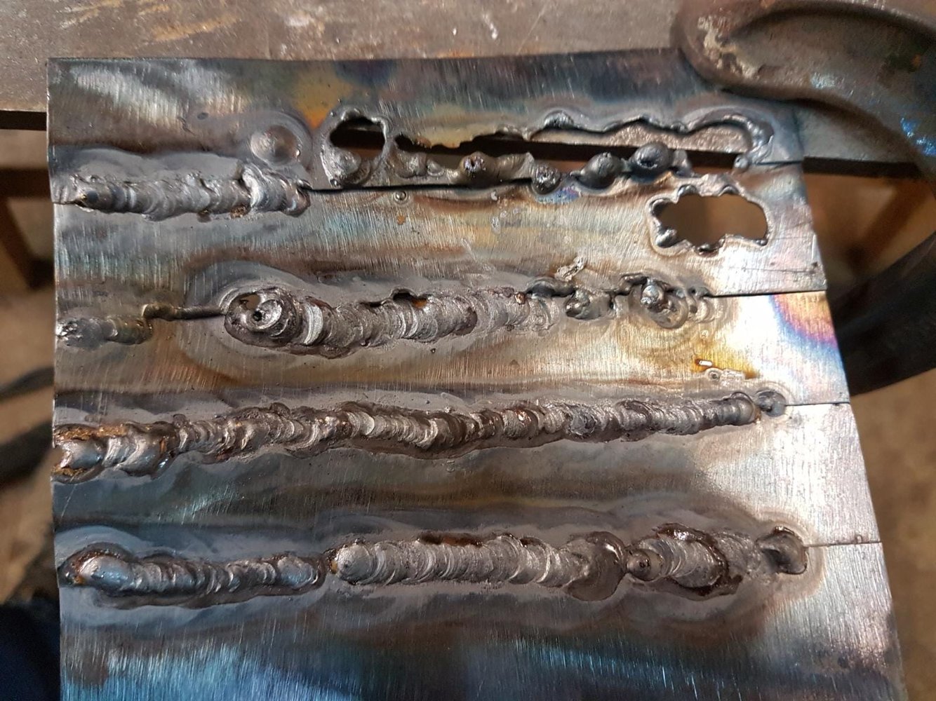

He, hey, we all have to start somewhere !The first Tig Welds I have done.
Butt weld 0.75mm mild steel.
The first weld at the top, just holes
All I can say is,
There is plenty of room for improvement
View attachment 272175 View attachment 272176

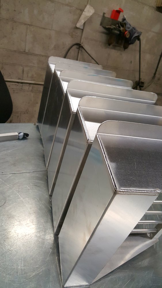

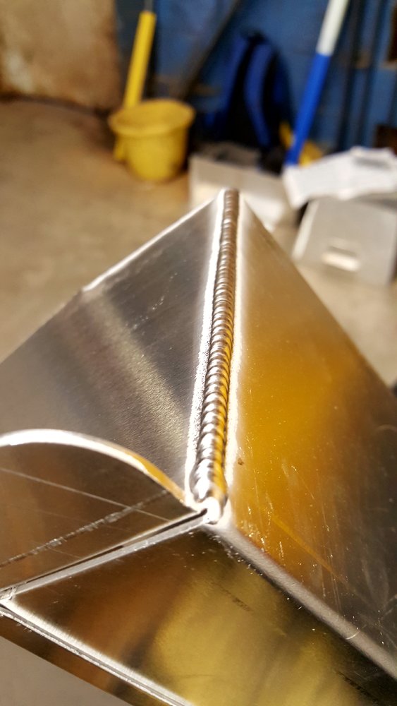

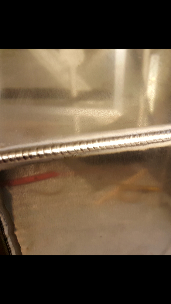

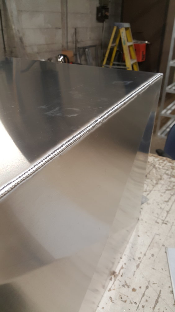

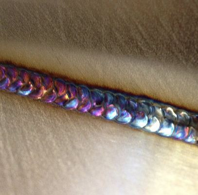

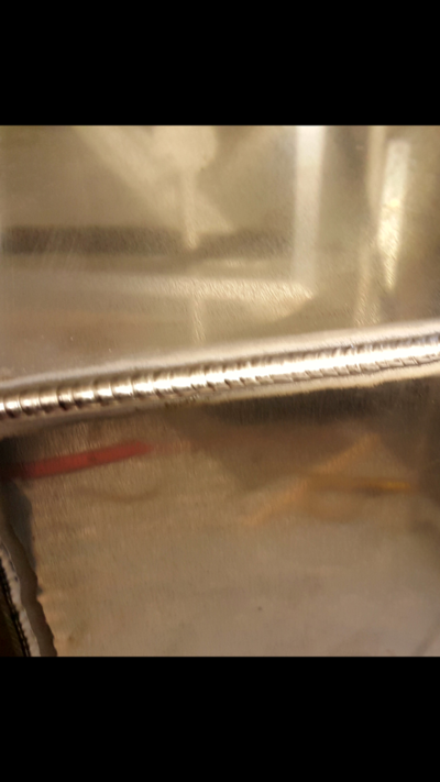

Done this today on the parweld xt202 in work today no7 cup standard collet 3mm plate 2.4 5356 rod 120 amps 150 Hz balance set at 31 going to try the same at home with a few different things tomorrow with my Lorch I struggle with consistency

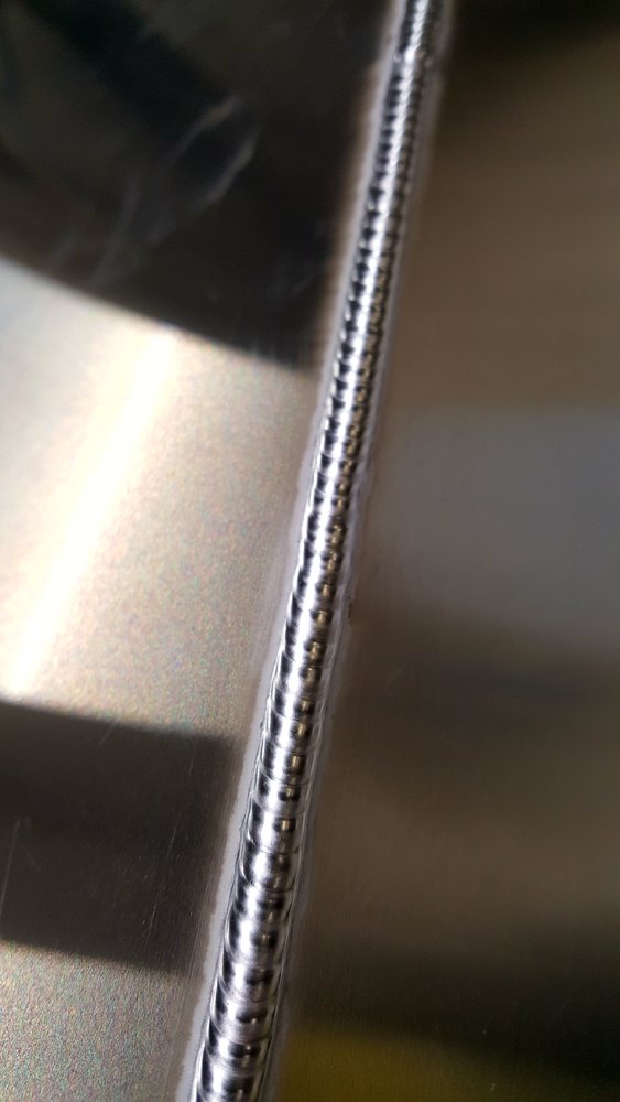

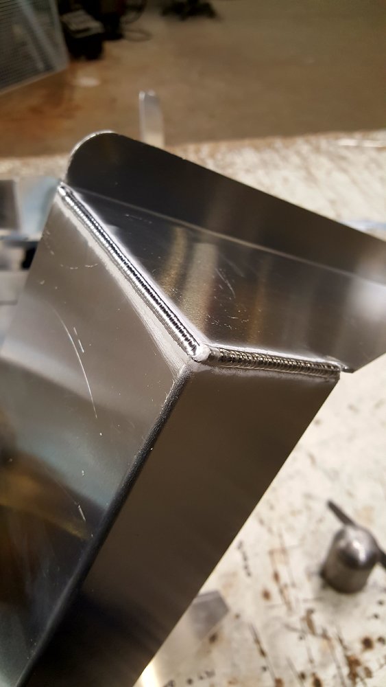

No I just struggle with consistency in general I'm going to try the same thing with my Lorch at home is All, latest pictures taken today in work using the parweld 1.5 aluminium 1.6 5356 rod cheap no5 stubby cup and Lenz from Amazon 2.4 zirconiated tungsten settings today where 77amps hrz 120 balance set at 21
.3 pre gas 5 seconds post traveling at a fair old lick I wire brushed some of the joints pre welding with a tiny brush and left some others as is to compare, and yes I did touch down once or twice on them

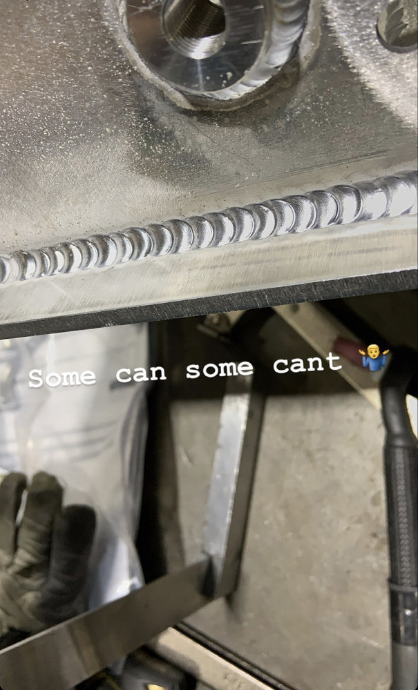

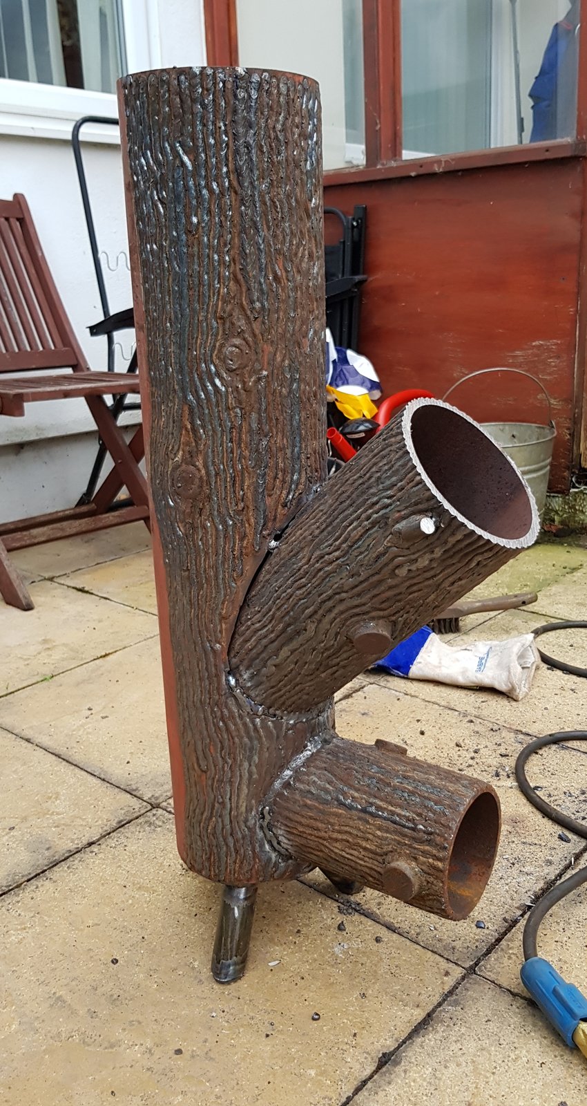

That is amazing.One pic i have got of something i was mucking about with a while ago though was this one. Cant remember if i posted it on here, might have done? Had a go at making a wood burner for the back garden out of some offcuts at work. Never got around to finishing it off though. Might do at some point though.
Forgive the whopping big gaps around the two branches though, marking out and cutting angled branches in pipes isnt my strong suit as can be seen lolView attachment 165128
Work only buys 2.4 tungsten I work with what they have everything is as cheap as can be boughtTry a 1.6mm tungsten. I use 1.6mm on anything up to 2mm material thickness on aluminium. Works loads better for me. Arc is a lot more controllable and stable.
Where i used to work used to be like that. In the end I was bringing in my own zirconiated tungsten (I was running a syncrowave).Work only buys 2.4 tungsten I work with what they have everything is as cheap as can be bought

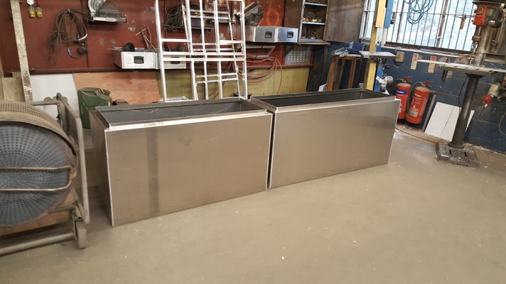

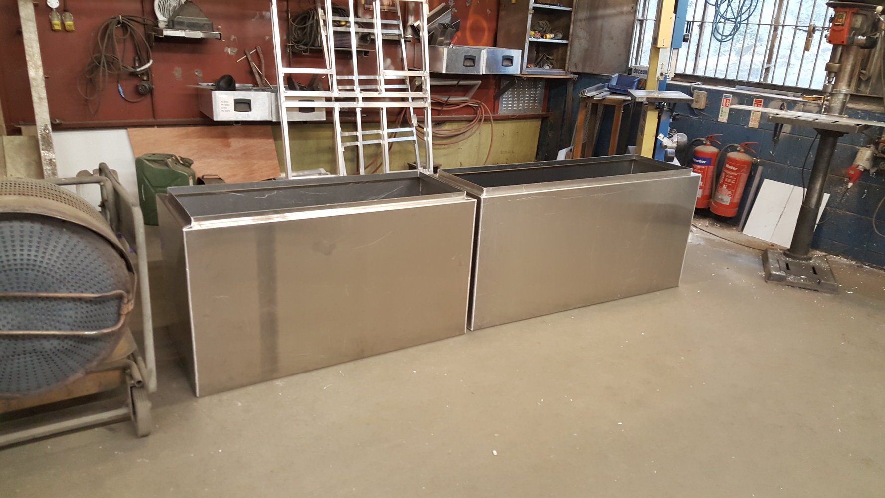

Learning what I can about it while I'm there some day I hope to be on my own atm I'm using an old Miller in work that the hf doesn't work on, scratch start only. I refused to weld the drinkers yesterday on it so came in today to weld them on the parweld xt202Where i used to work used to be like that. In the end I was bringing in my own zirconiated tungsten (I was running a syncrowave).
