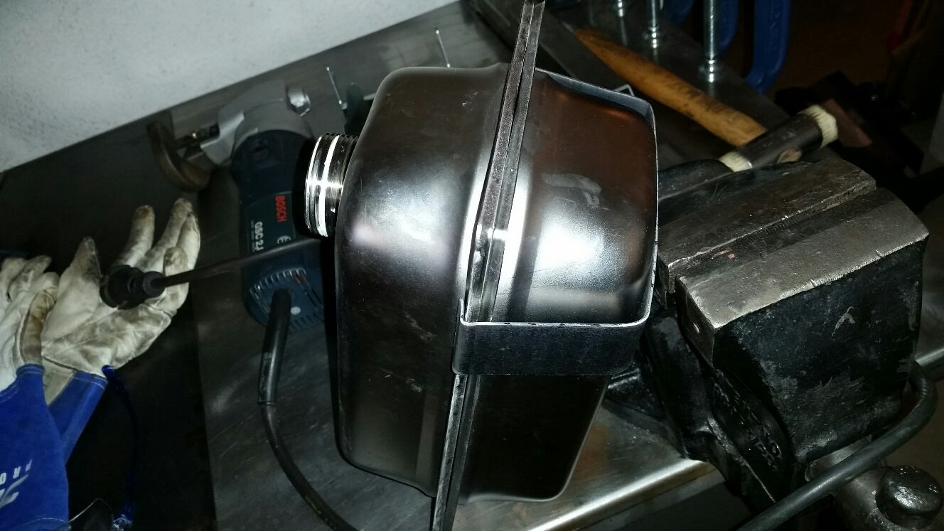

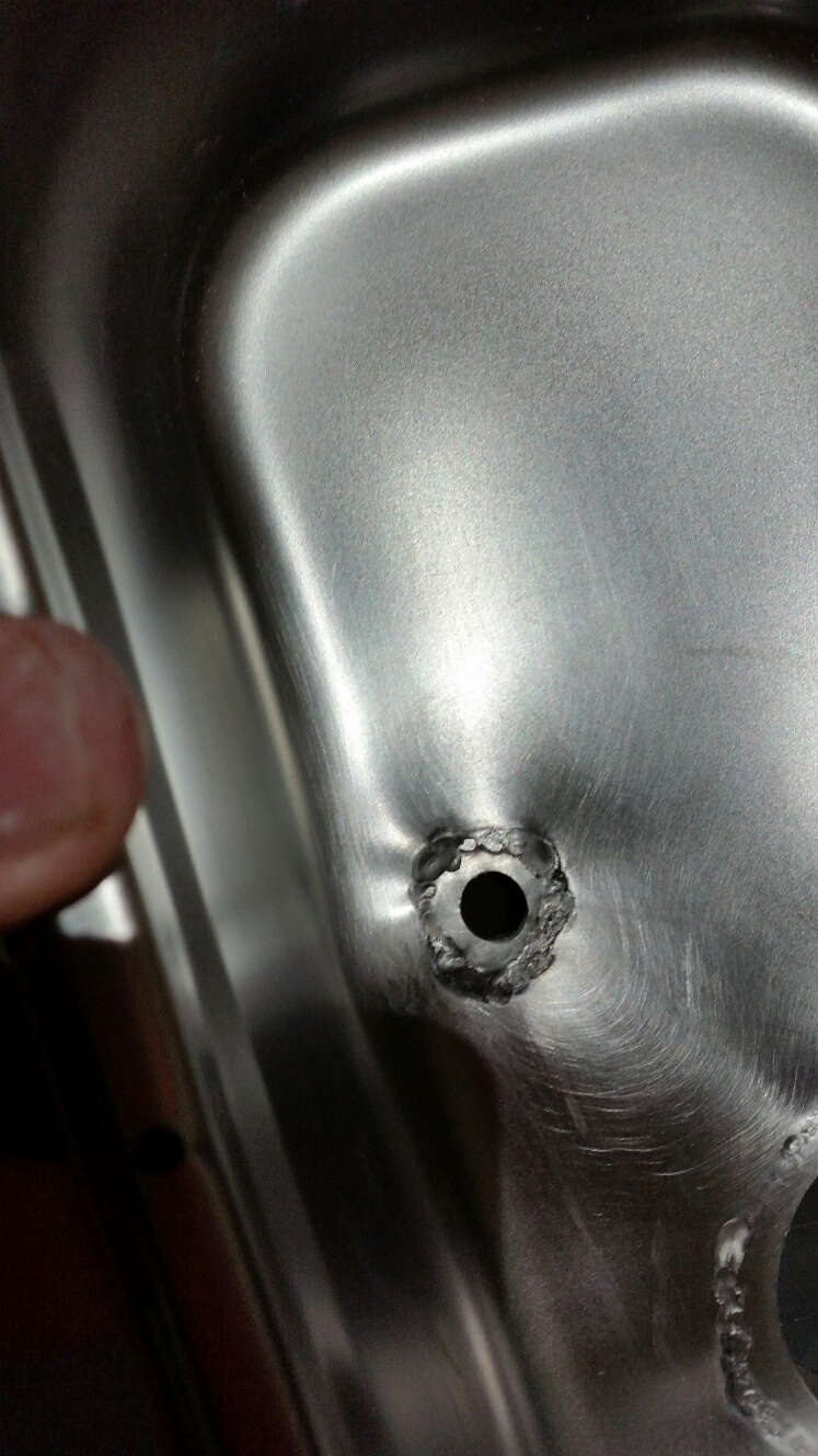

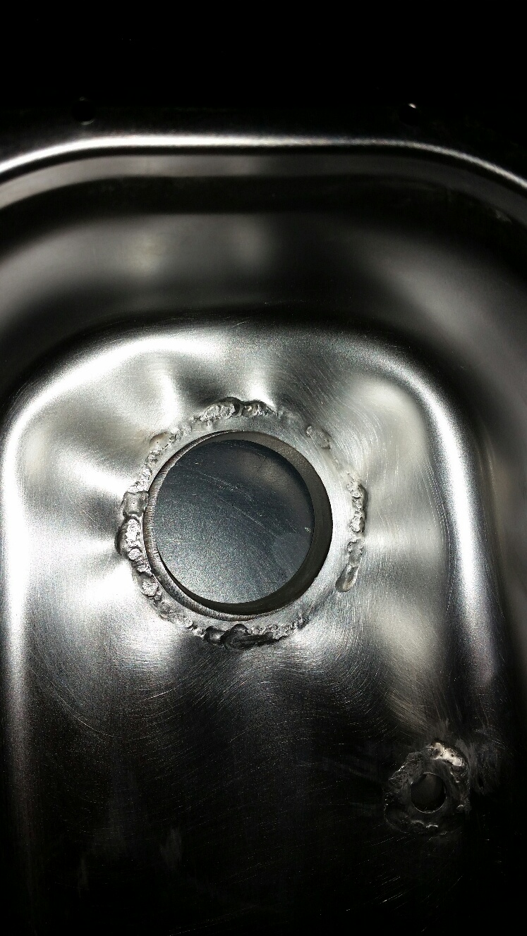

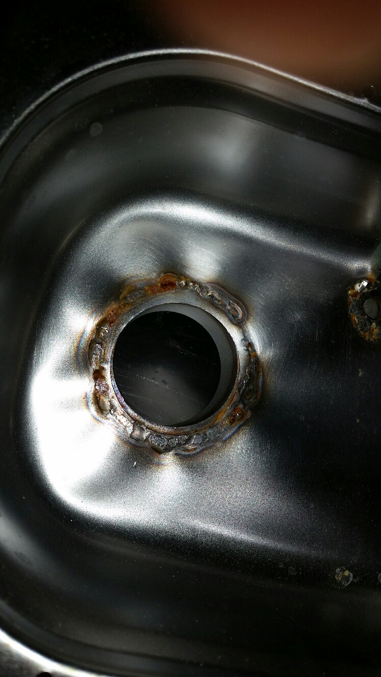

Thought you ordered some pickling paste. It will corrode again. There are still oxides present.Had a a go at cleaning the tank welds with scotchbrite and bar keepers friend. There is still a bit of black here and there may get hold of a stainless brush to sort them out, rather than using the pickling paste.

Yep i did thought i would give this a try first.Thought you ordered some pickling paste. It will corrode again. There are still oxides present.

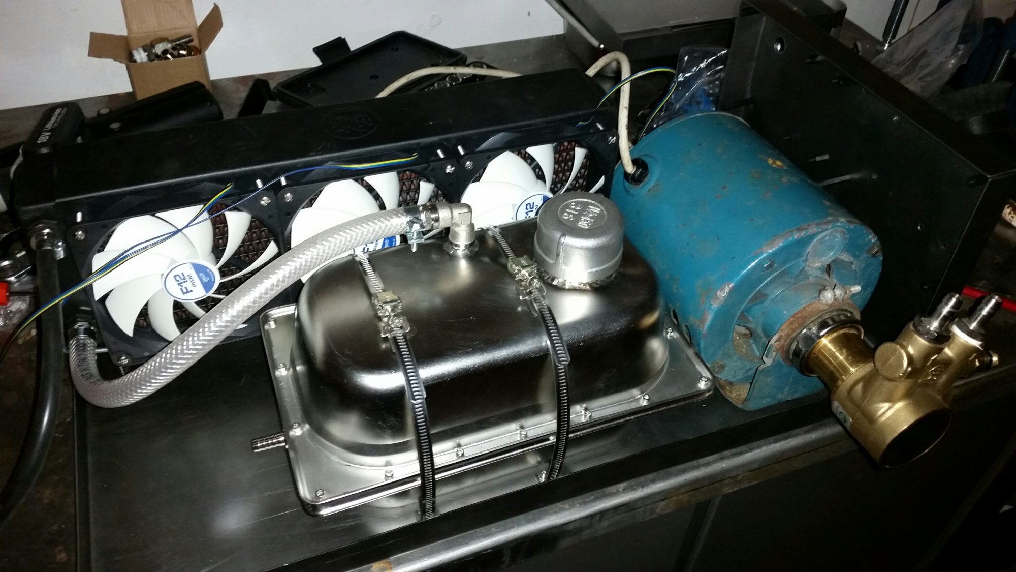

Don't see any reason why you can't turn the motor.
Do you have the makers name/model for the motor?
Yes no question.It may have been painted over will have a look tomorrow.
I had to do away with the plastic box for the electrical bits so the power supply and relay will be secured to the sheet at the back. The motor is earthed should i add another where the power enters the case?
You must wash it off after use and scotch brite will sort it out nicely. Don't worry about it as it's designed to be on the metal.Oh and i used the pickling paste today . Made a right mess with that slapped it on the welds went for a vape break it cleaned the welds up but ran down a stained other parts of the metal.
