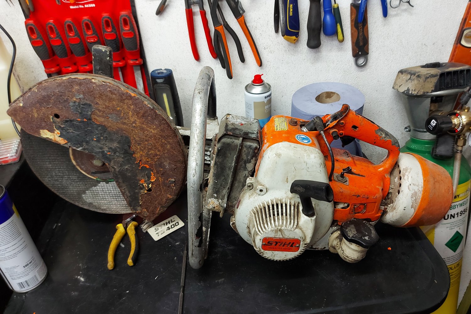

My working 400 looks worse than that, you already have a bit off the other one that went to @brightsparkI hope you all are happy
It's a bit cosmetically challenged but all there at least. Too late to try starting it but seller said it won't start so there is that.
The throttle is also stuck, spray oil won't do it so I'll see what's up there. It fails the hold on its cord compression test but at 44 mins drive away and for £40 I was for taking it home regardless! I did a quick bore inspection with endoscope and I don't see any signs of damage or scoring so that's good.
It says Made in West Germany on the recoil cover which is pretty cool must date sometime in 70s or 80s then.

It has compression, but not enough to run I dont think, my money would be in crank seals, its in better physical nick-than my working one, which when it dies with be replaced with new probably battery as Im an occasional userthe one you gave me seems to have more compression than the one i havehavent had time to sort mine yet but it has the bits on i need thanks

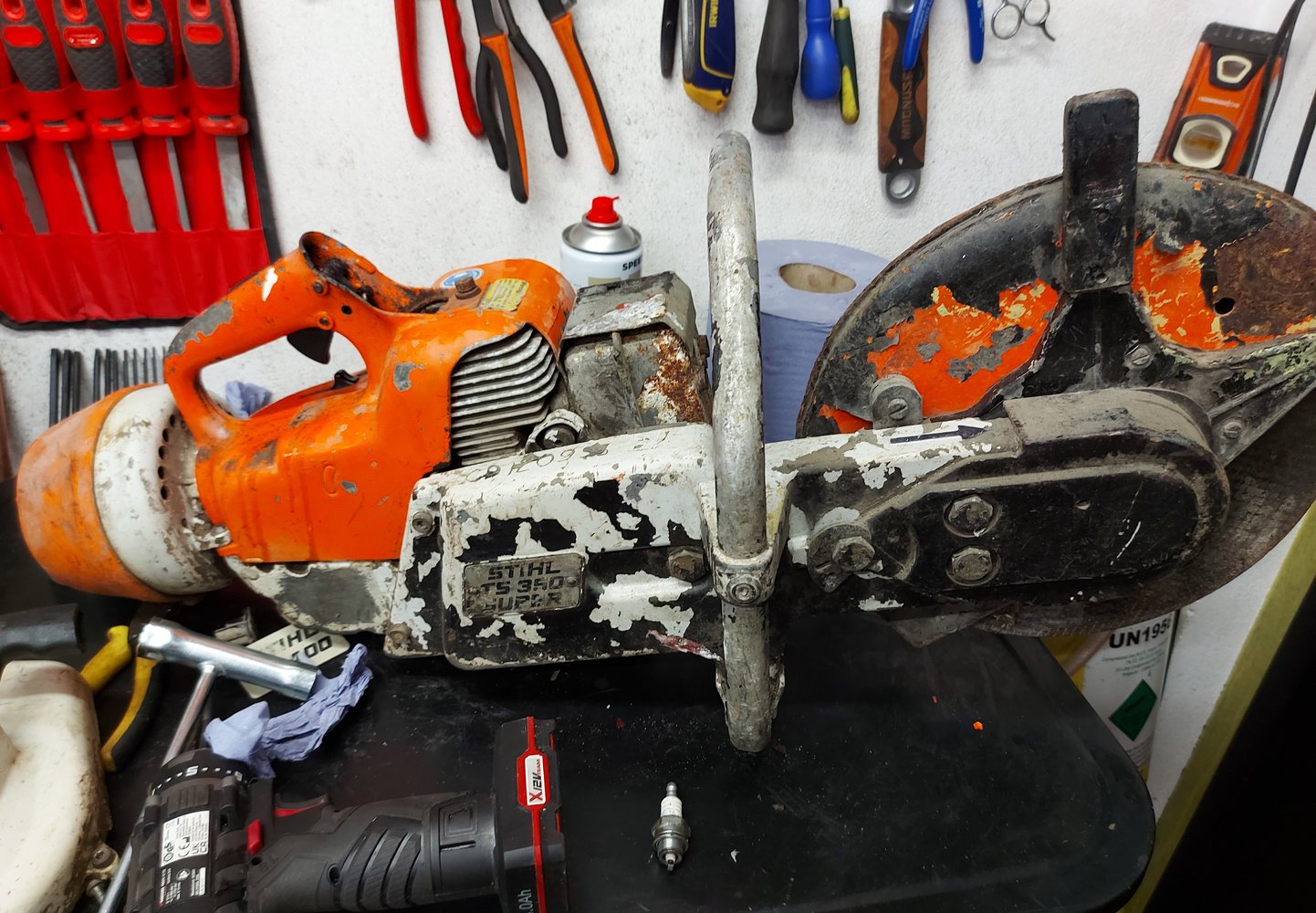

The throttle is also stuck, spray oil won't do it so I'll see what's up there. It fails the hold on its cord compression test but at 45 mins drive away and for £40 I was for taking it home regardless! I did a quick bore inspection with my endoscope and I don't see any signs of damage or scoring so that's good.
It says Made in West Germany on the recoil cover which is pretty cool, must date sometime in 70s or 80s then.

Looks like a Super, they have different pull starts and a few other bits slightly upgraded from the standard 350.I hope you all are happy
I think they had a bigger bore cylinder. Worth checking before ordering parts.

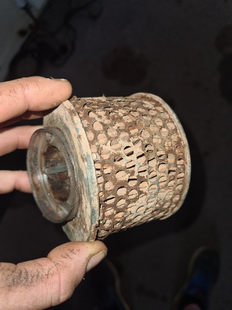

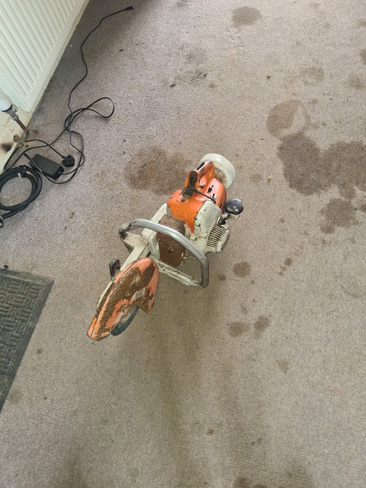

I've got one
View attachment 442721View attachment 442722

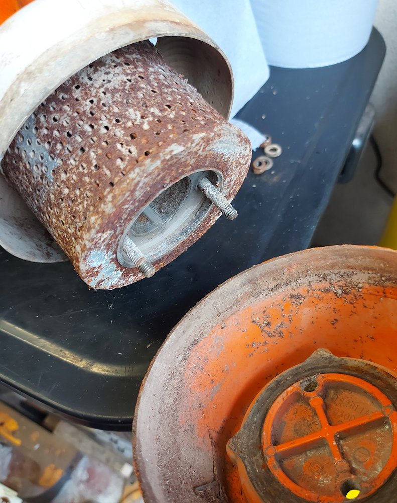

As you can see the filter is a bit rough

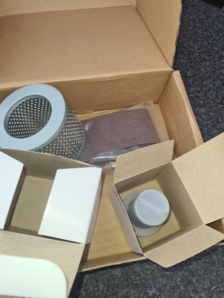

But you can buy a full copy set of the bay of thives for 11 quid

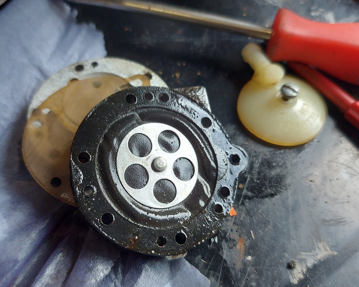

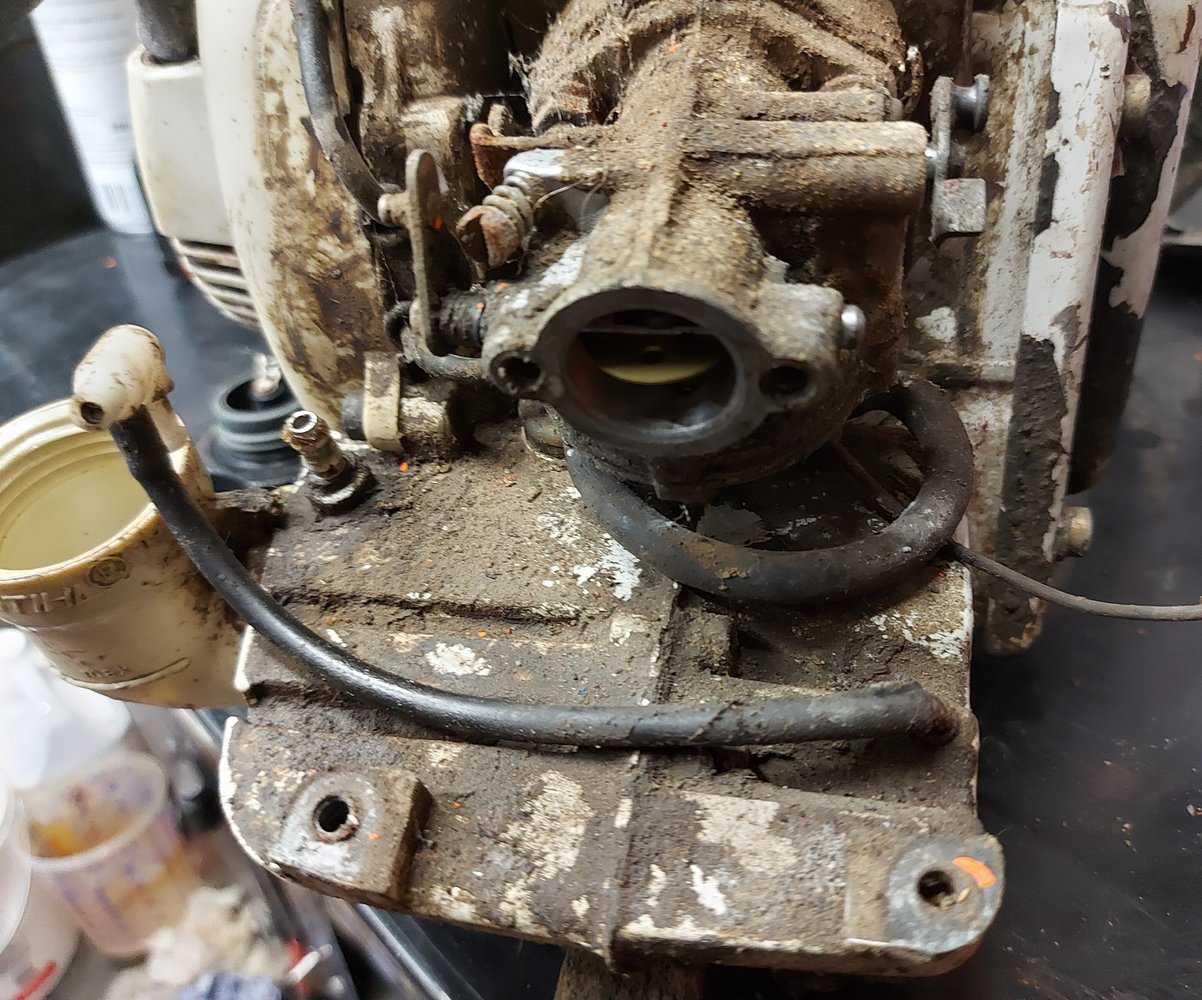

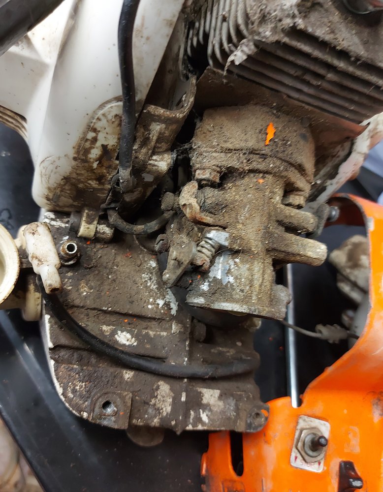

With luck hope you have zama carb on yours they easy to get carb kits for as I've go the what seams to be rare Tillitson one 212 I think and there are only a couple copy sets on ebay

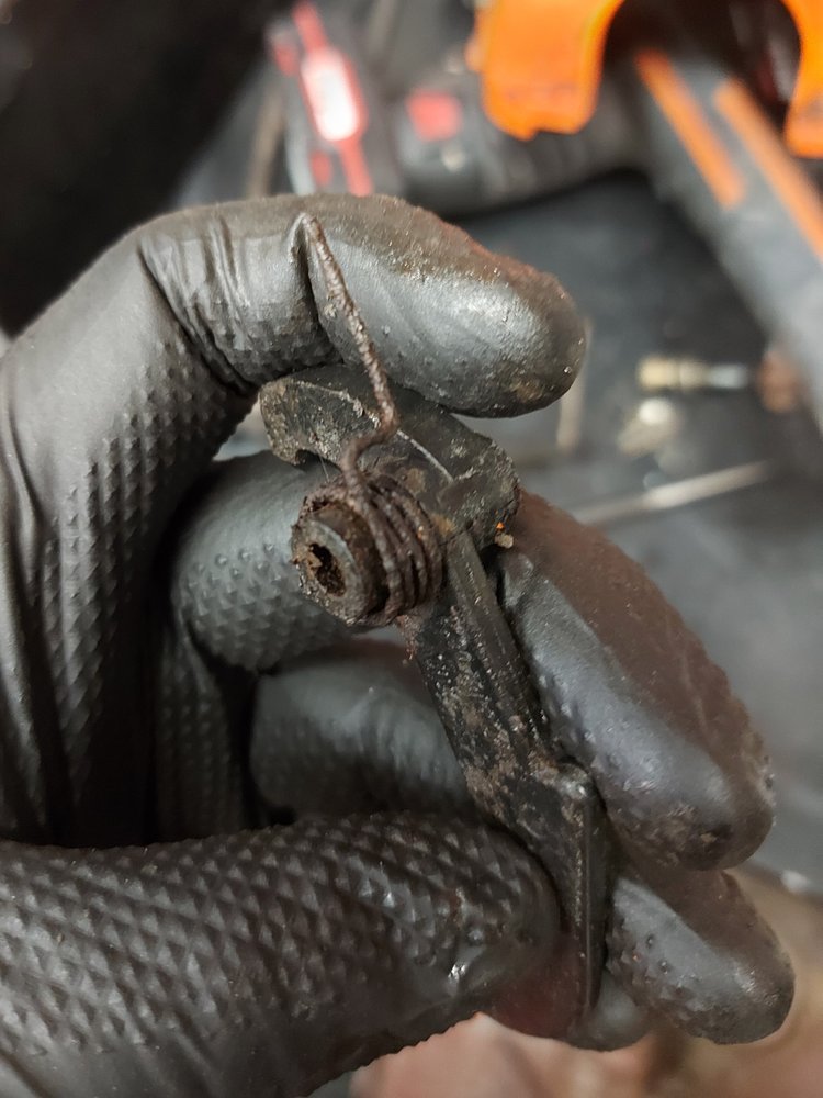

Oh and the carb is all levers so very easy only hard bit is getting the air filter housing back on with out droping the gasket inside as you have to put the handle cover on before the air filter

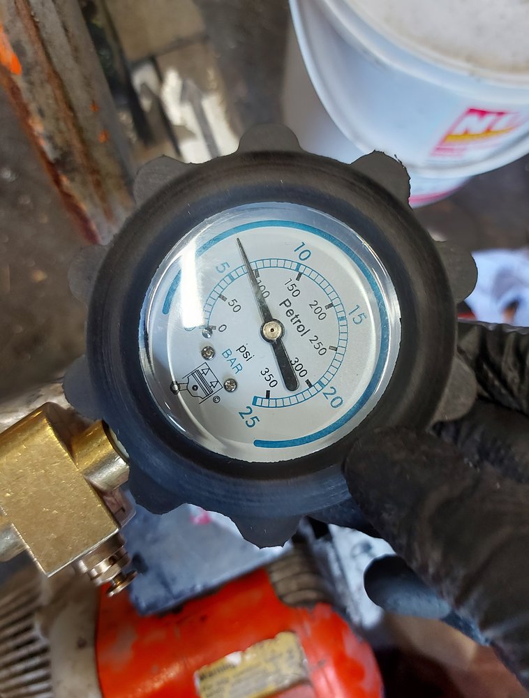

I'm going to fire up my 350 tomorrow to check it's ok as I need to cut out two doorways next weekend, I'll do a compression reading on it to see what it gives on a lightly used piston and cylinder.
