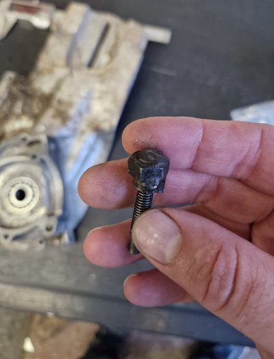

I have been using my 350 Super the last few days and it wasn't running well so I had a fettle with the carb adjusters, that's when I noticed the sticker with H & L on it and X 1 with an anti clockwise arrow...
I reset both screws to 1 turn out and it was better but wouldn't pick up off idle so I turned the slow screw out another 1/4 turn and it's way better that before
I also noticed it's really easy to under fuel it, by that I mean it looks like it's full up but if I tipped it sideways bubbles came out, I could then get a lot more fuel in!
