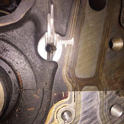

Left hand drill bit, left hand m5 tap, you’ll get it out leaving the thread intact.View attachment 411768View attachment 411769the bolt for the timing chain guide rail snapped, now i cant it out.
can get at it with a drill, just, me own stupid fault at the end of the day, wasnt using a torque wrench, mine dont go down to 8nm, tried to guess itLooks like the same type of situation which prompted @Pete.? to get a right angle drill

Strong in the arm, weak in the head...can get at it with a drill, just, me own stupid fault at the end of the day, wasnt using a torque wrench, mine dont go down to 8nm, tried to guess it

If it snapped by tightening it will come out easy - blob of weld, easy out or lh drill should do it easy.

i cant weld, and i dont have one, never had to drill a broken bolt out before, no taps, never did anything like that before,

got it out, big relief
Spill the beans as to how, it might help someone else.
I got one out the other day drilling and sacrificing a torqs bit…….By cutting a slot in the end with an angle grinder, by the looks of it.
me brother works for gsf car parts, a lad who works in one of the garages he delivers too, lent us a small milwaukee grinderSpill the beans as to how, it might help someone else.
