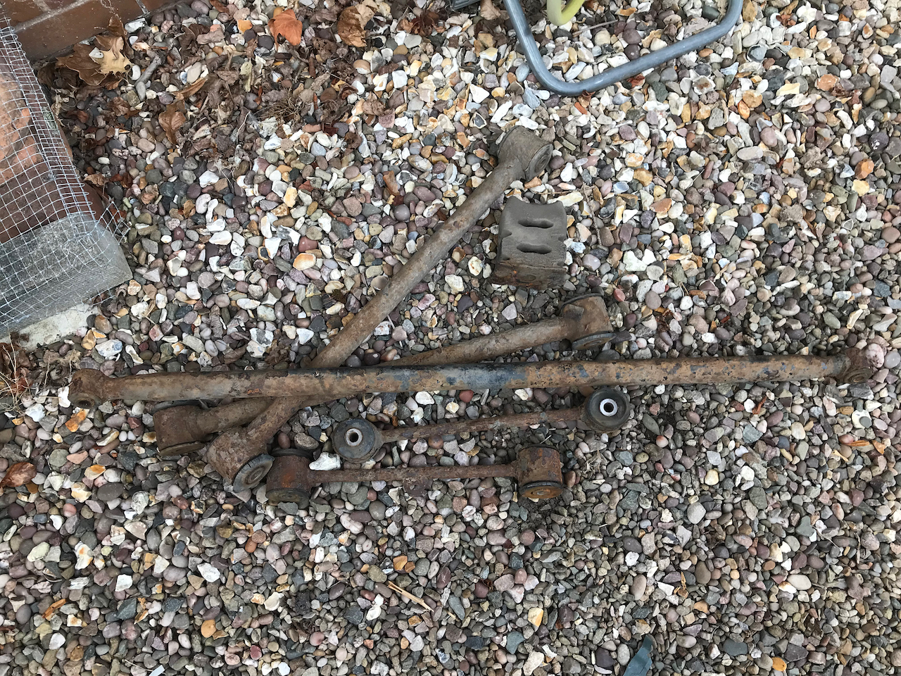

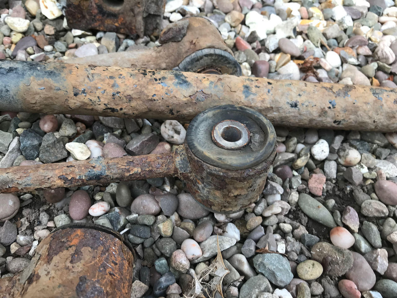

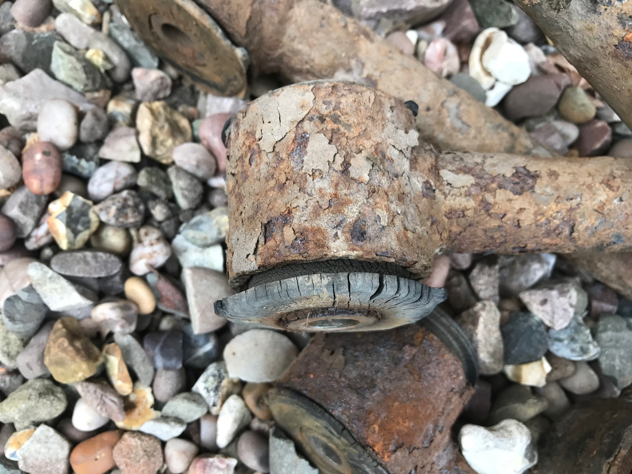

Blimey you had your wear out of those!!Yesterday and today I spent replacing both upper and lower rear control arms plus the panhard rod and bump stops on the Surf. Not having a proper workshop and vehicle lift any more, I'd forgotten what a ball ache it is working outside with only axle stands!
The 26 year old originals were well past their best, so glad I got them sorted. Stiff as a crutch now, though!

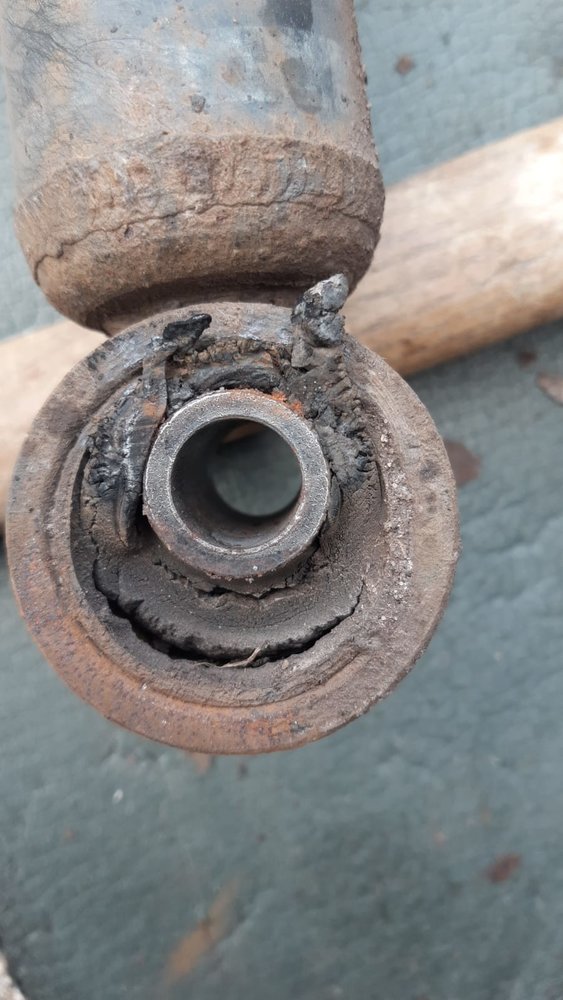

This is one of the front shock bushes on mine before I replaced them!Blimey you had your wear out of those!!
Just yesterday I was under the Surf looking at the rods!
I have a bit of a knock over small sharp bumps and as I've replaced the shocks and springs without it making a difference I'm thinking it could be them.
The axle is pretty rusty to so I'm thinking once the rods are out I can drop it out, what else holds it in?
What parts did you buy to replace them with?

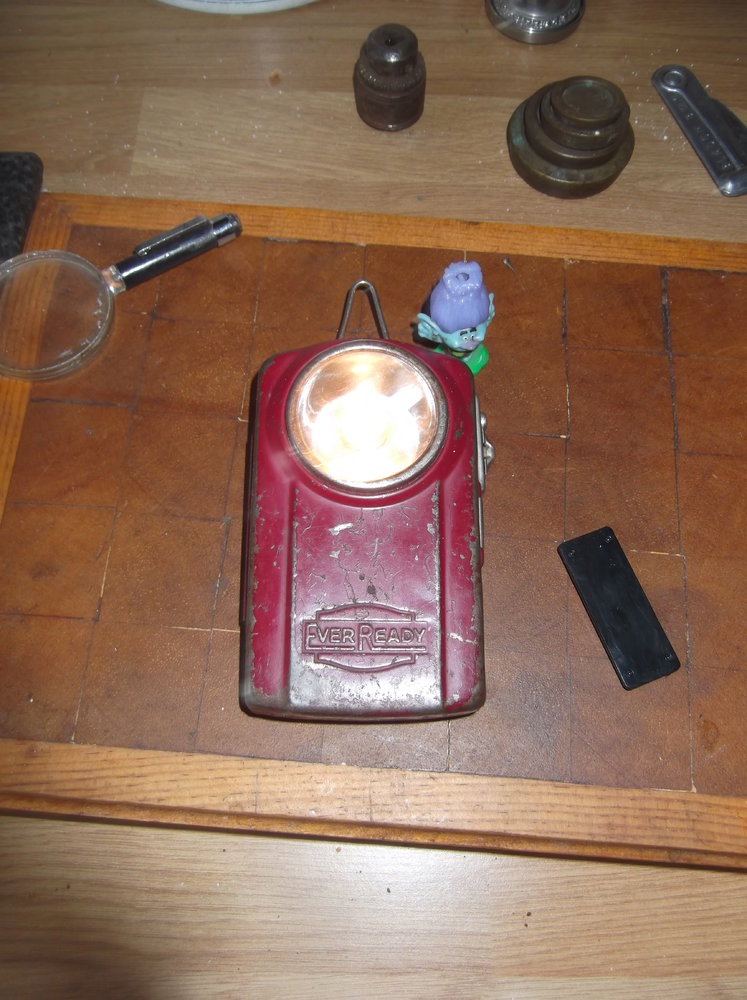

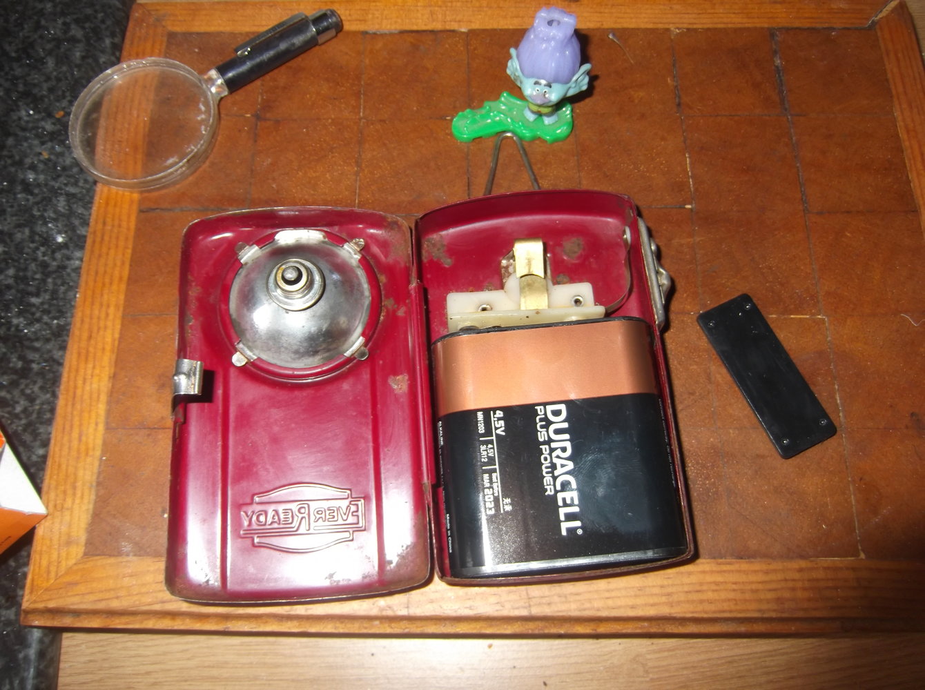

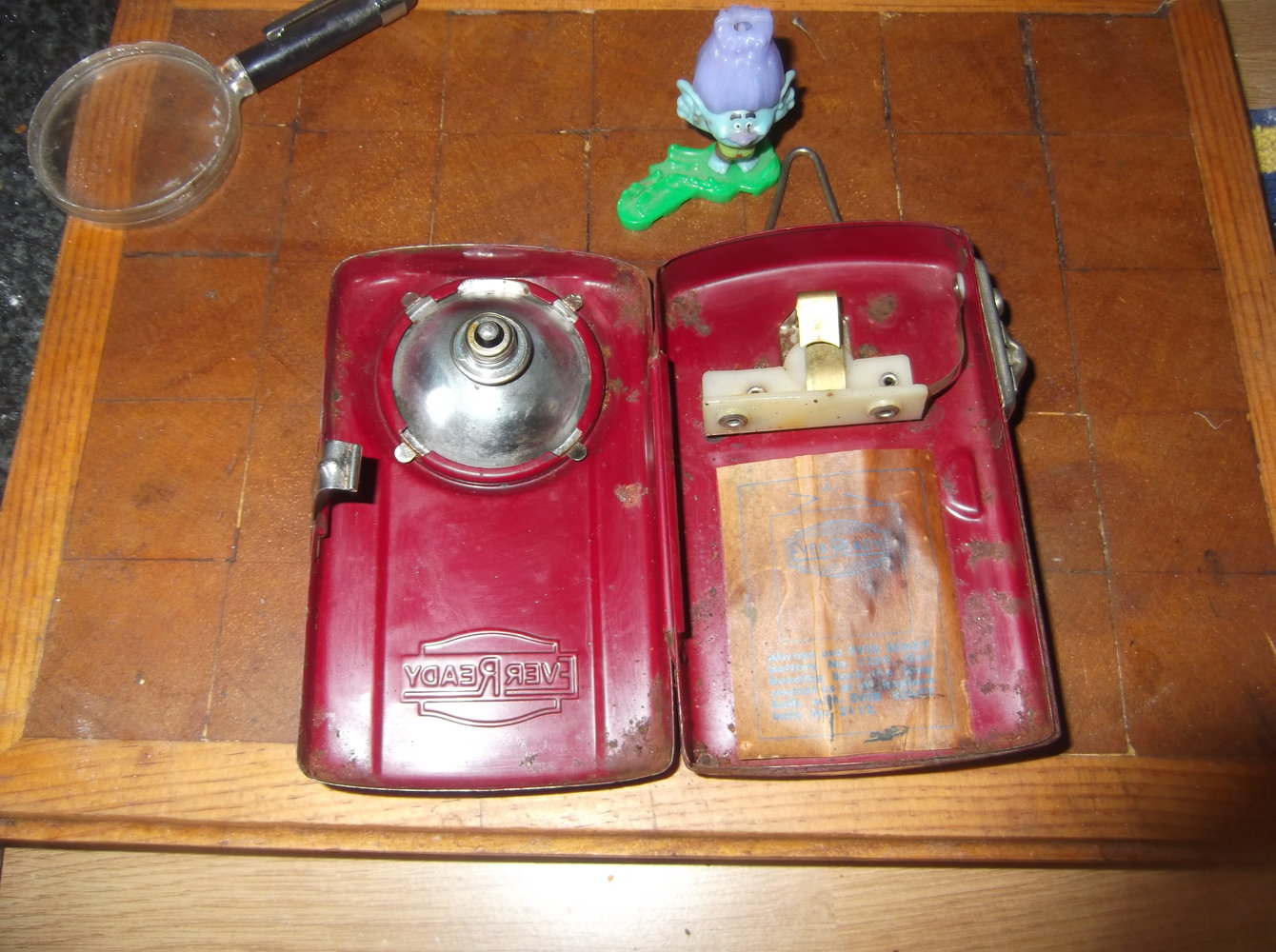

Wow.... !!! I remember those as a kid.View attachment 362050
I got this Ever Ready Torch Today.
It is a nice item, has a hanging clip and does not work.
A designe fault. The remove te bulb, youi have to bend the four tabs up. They are very thin metal.
But heat from a soldering iron makes it a bit safer to bend and remove the bulb. This one was corroded and blown.
The switch was good, so I treated it to a few drops of switch cleaning fluid.
New batttery, bit of a clean and tidy up.
We have a a working item.

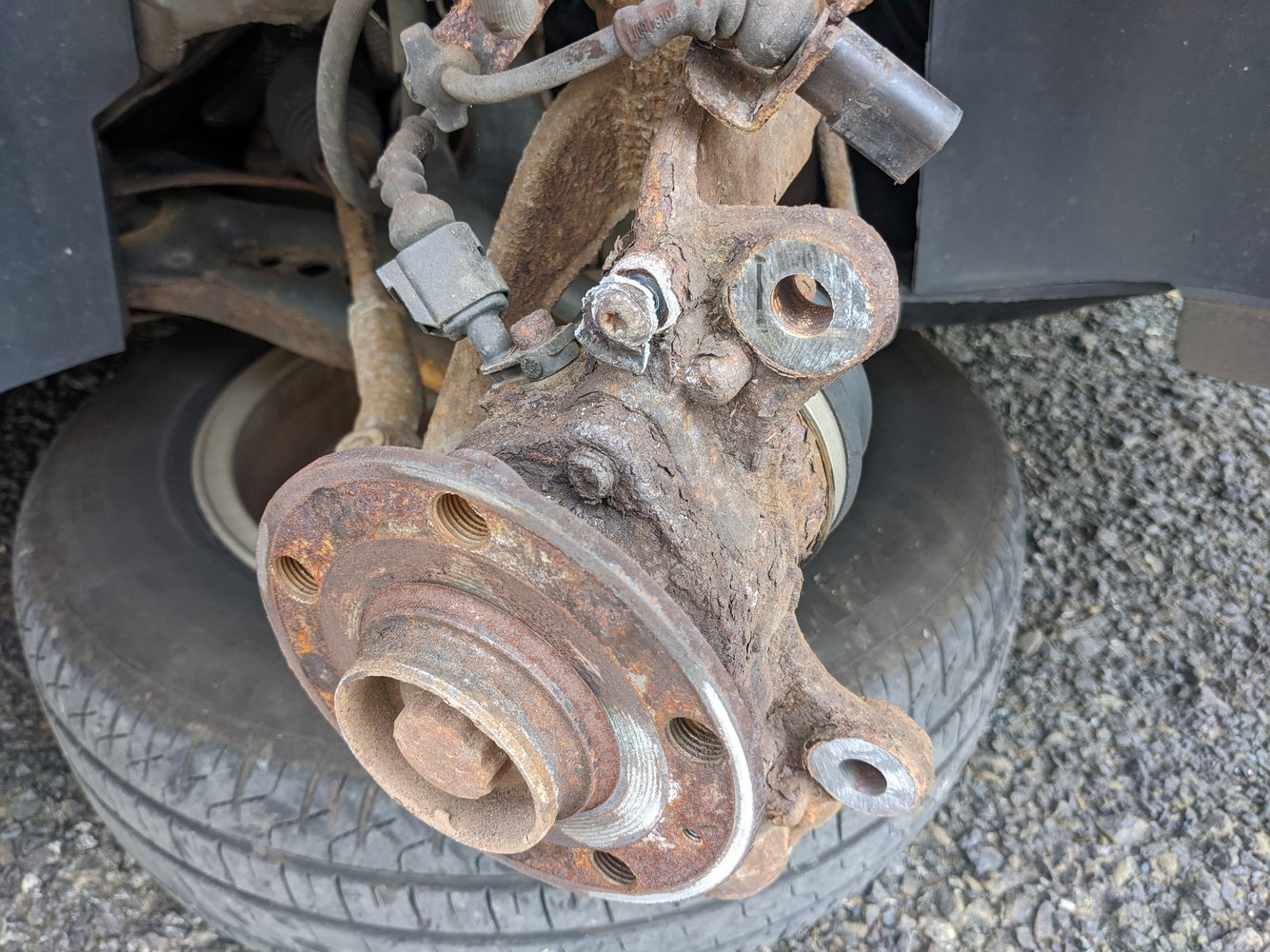

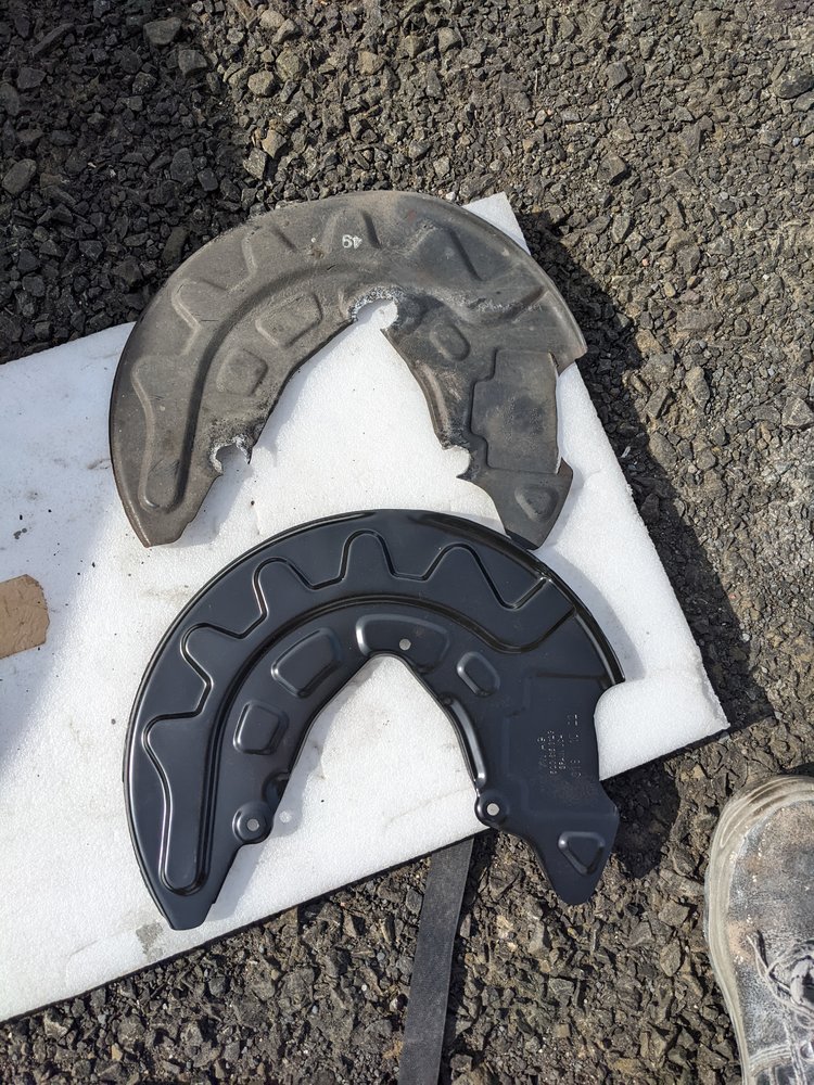

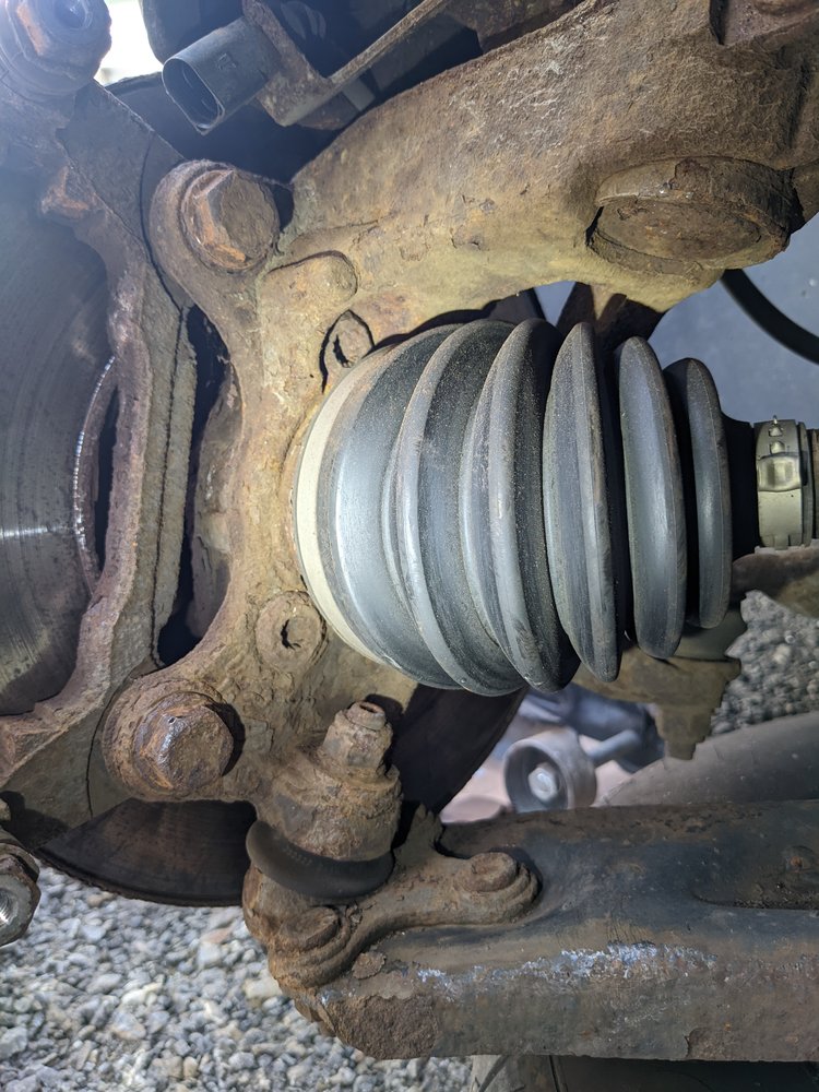

lots of strut tops are 21 too , and you need the special socket etc etc .... nope a sparkplug socket works the very best , and a hex top so you can turn it with a spanner and still get an allen key through the half inch drive bit to hold the shock inners still ,, just thought id mention it for those who dont know.Had a rattle coming from the front right of my 7 year old golf, turns out the brake shield had just rusted off. Never had one just fall off before.
New ~ £25 on eBay and old.
Calliper carrier bolts turned out to be 21mm luckily I had a wheel nut socket the correct size and they broke free with a breaker bar.
Last challenge, will the torx screws come out or round off.
Well luckily all three came out without drama.
All went back together without a hitch.
That's quite typical of golf's of that age unfortunately, as is the dust shield falling offI’ve seen 40 year old Golfs with less rust on the suspension, do you live near the sea?
Spent most of its days in Dunfermline so not too close to the sea, but we do have salt on the roads up here for at least 6 months of the year. My A3, TT and XK8 all went the same, however my 40 year old 155000 mile 450SL was in much better shape when I stripped and restored it.I’ve seen 40 year old Golfs with less rust on the suspension, do you live near the sea?
