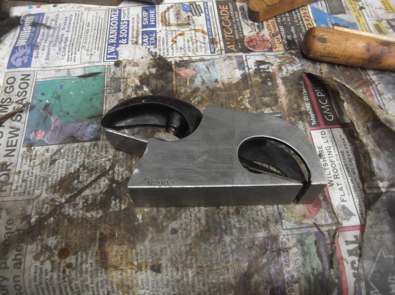

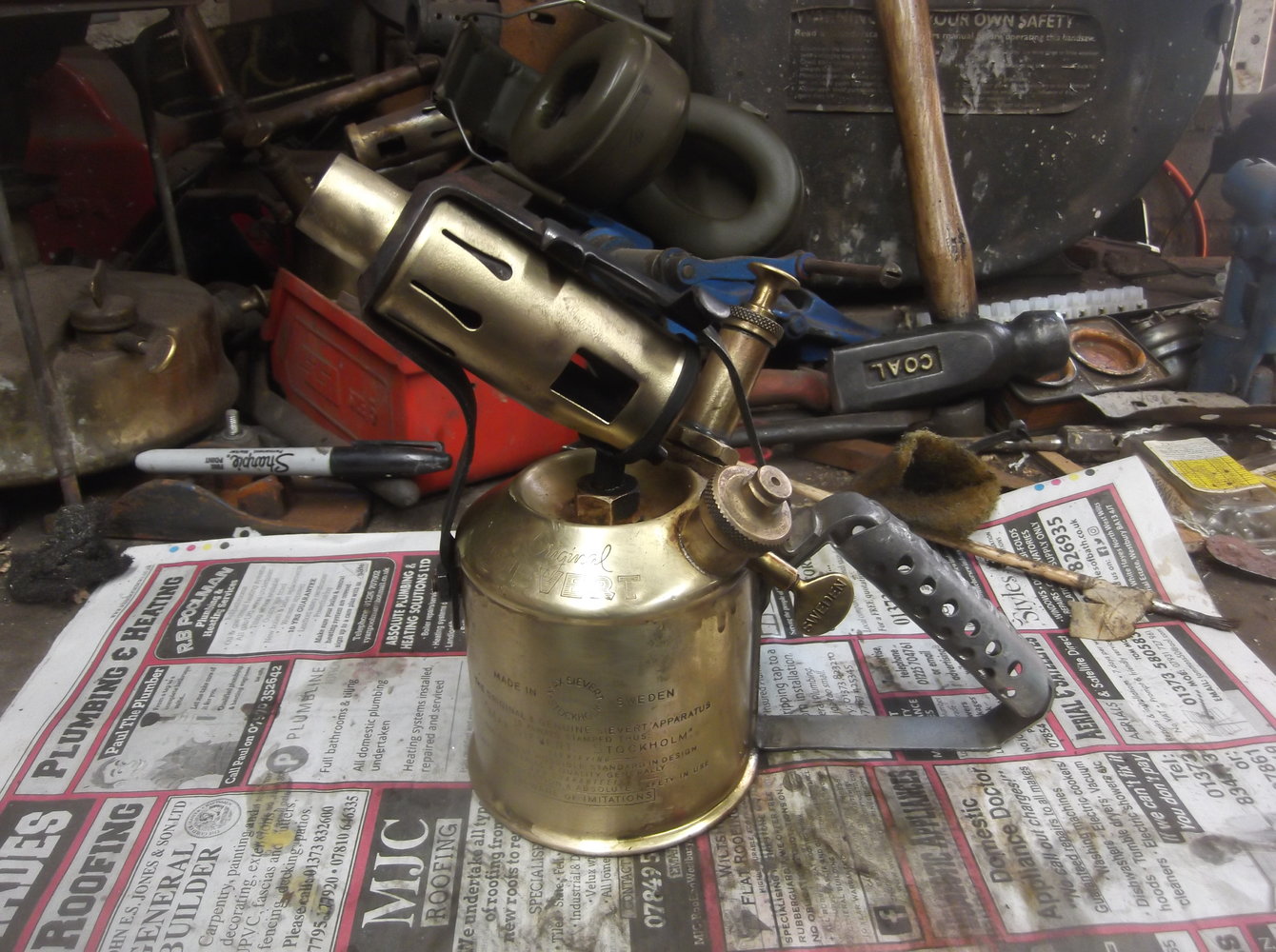

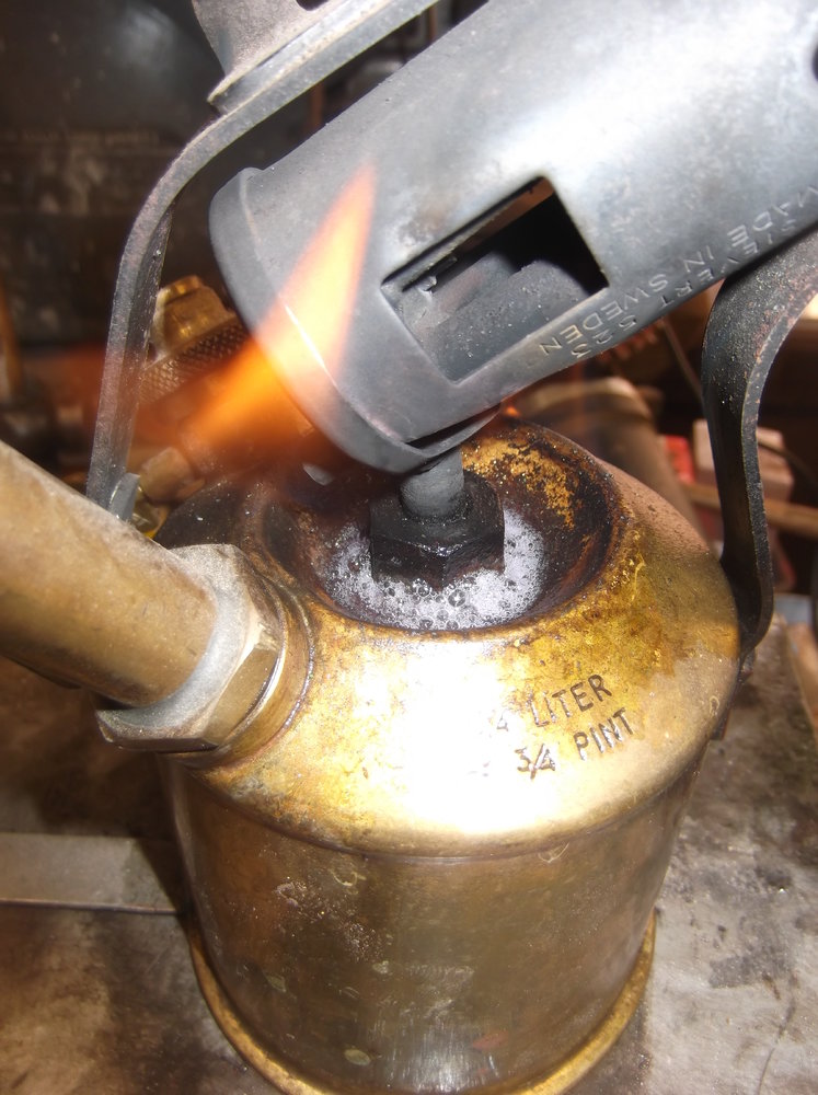

Paraffin boiling. in the burn off/ preheat , not meths ?View attachment 372397

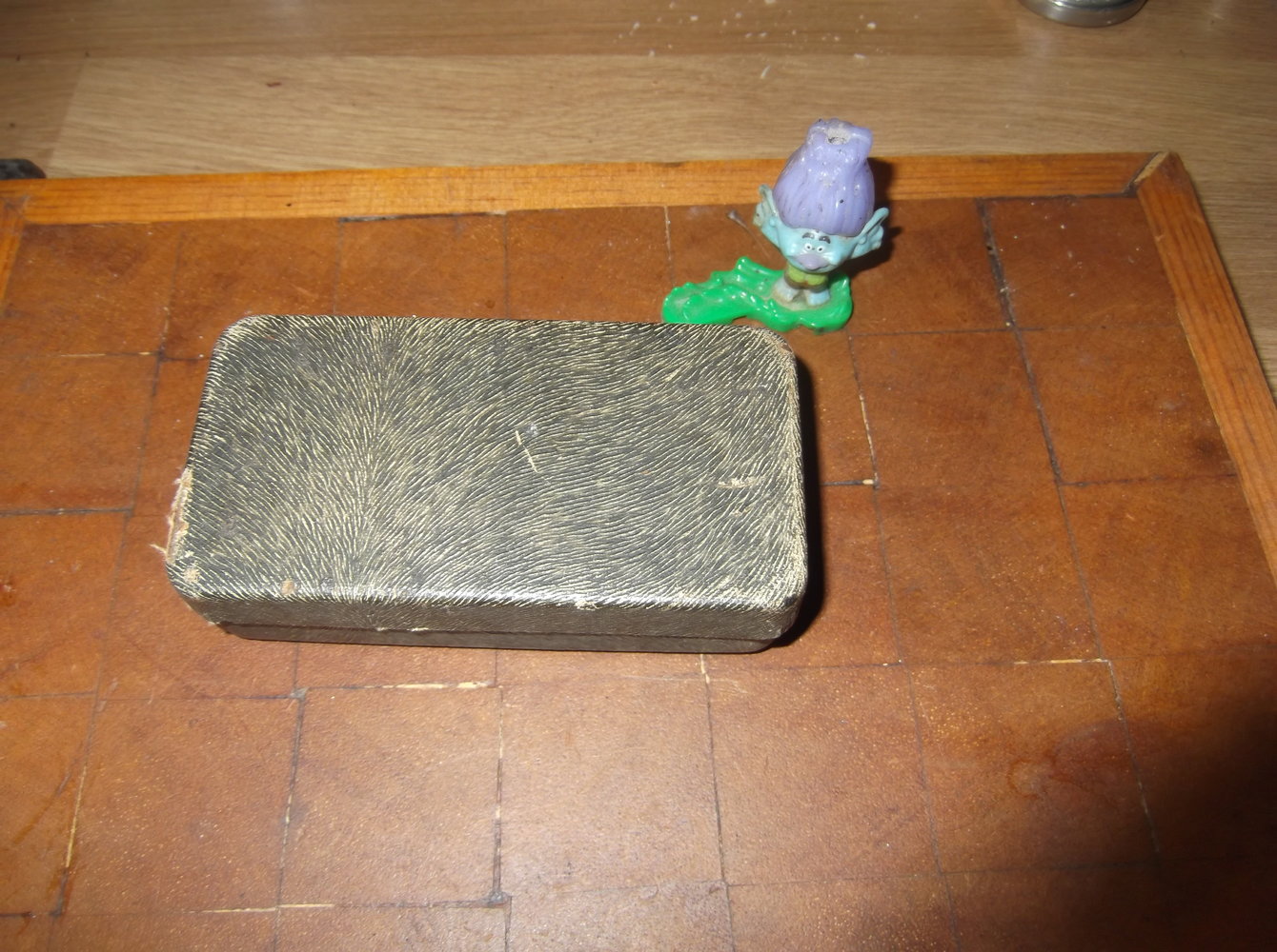

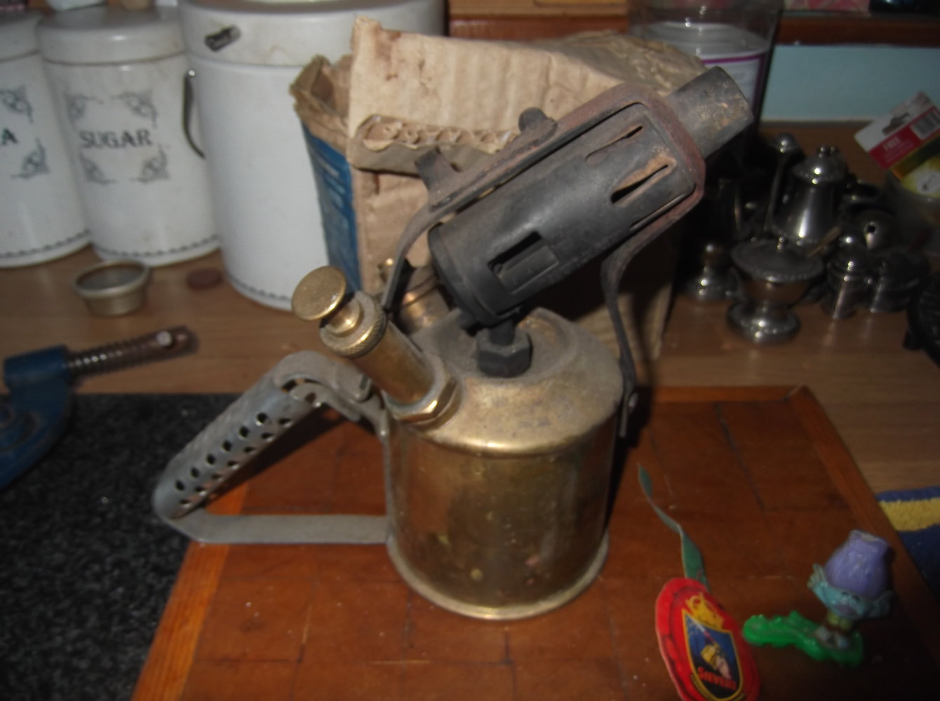

This boxed up Silvert Blow torch came my way the other day.

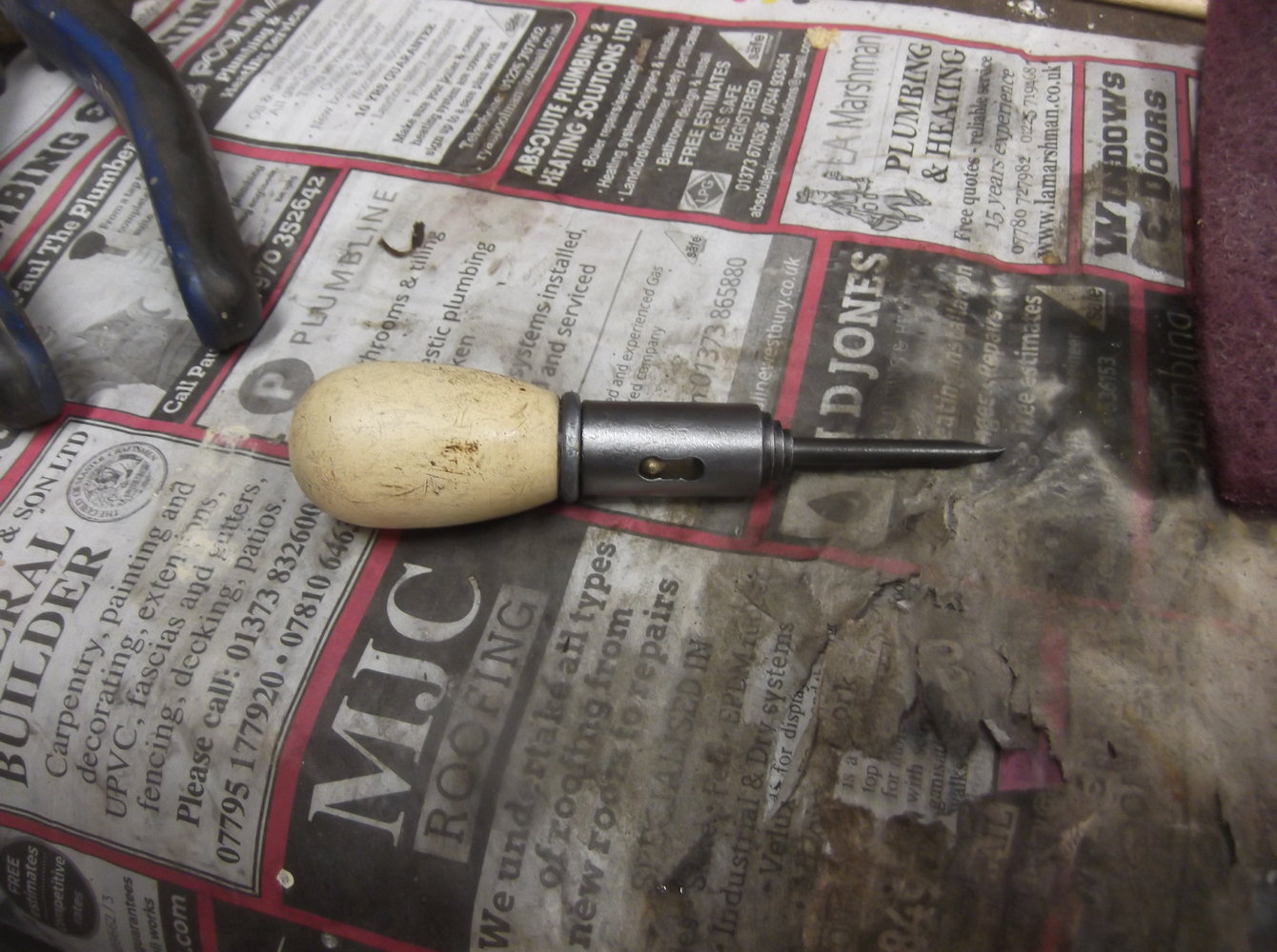

In the box it came in, there was the pricker, brass filling funnel and a spare set of seals.
A nice image of the paraffin boiling. The fuel was from me pressuring the tank before the heater was fully warm.
No. When I pressuer the fuel tank, neat paraffin was ejected from the jet and flooded the pre heating bowl.Paraffin boiling. in the burn off/ preheat , not meths ?

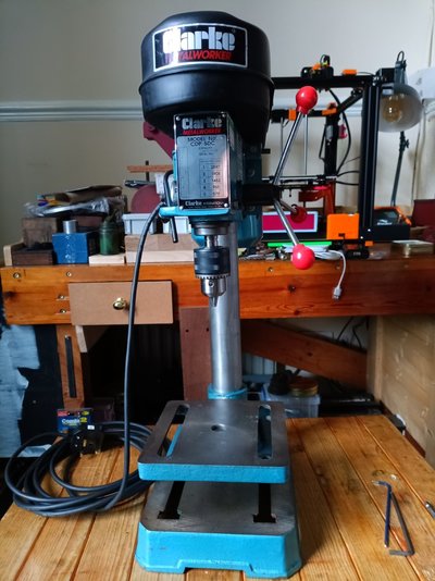

www.bearing boys , have a handy help measuring section on their site to get the size and often can supply it just by name & drill press model .More a tickle than fix. Been doing it over the last week or so. Cleaned surface rust from the base, table & column, fitted a new chuck due to runout with the old one, fitted a longer mains cable, (rubber flex), & popped a bit of oil on the top bearing, to see if it may seep down over time, (sounds a bit rough, but not overly bad).
Did order a replacement belt, but either I've lost the ability to measure a belt, else the replacement is incorrect in size, so it's still running the old belt, currently.
No you have not.
It took them 8 tries to get me a belt of the right size.
What I do is take the old one to a local car spares place and get a 10mm V belt of the shelf.
That drill press is very similar ( identical ? ) to my old 1989 NU tool press.
Bearing boys supplied me with a new belt two years ago , I've cleaned the top cover off on the inside & written the part number in the cover so I have an idea of the part number next time round .
Done the same on all equipment for all other belts & driving tyres etc.
Just popping out to the mancupboard for it.
Bearing boy's Pt# Belt 099-0

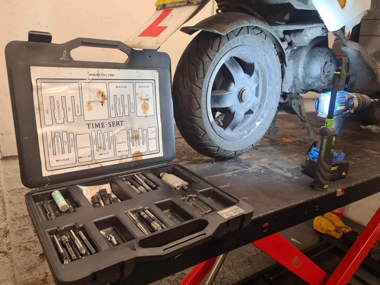

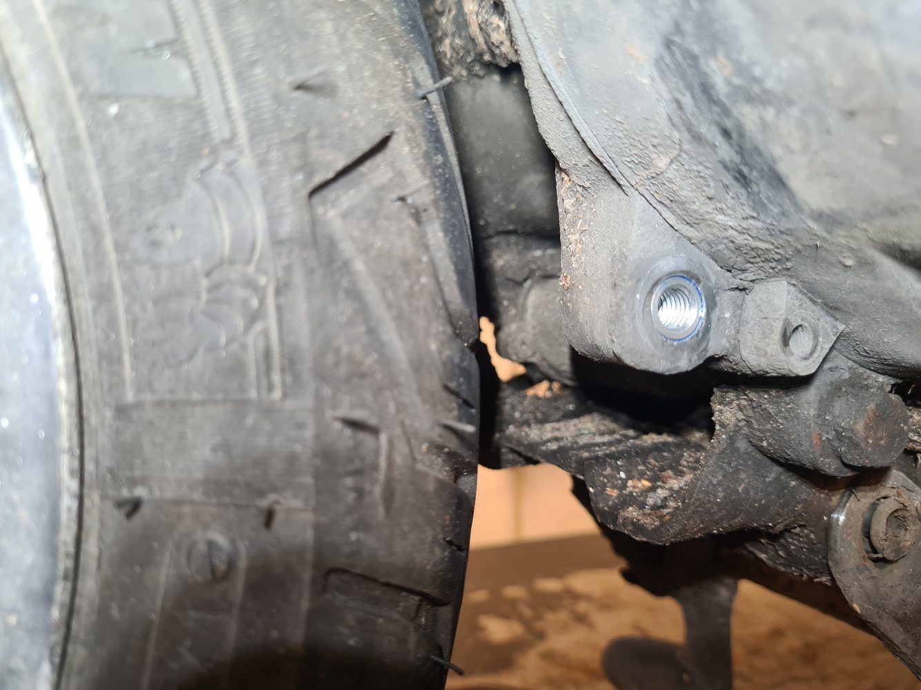

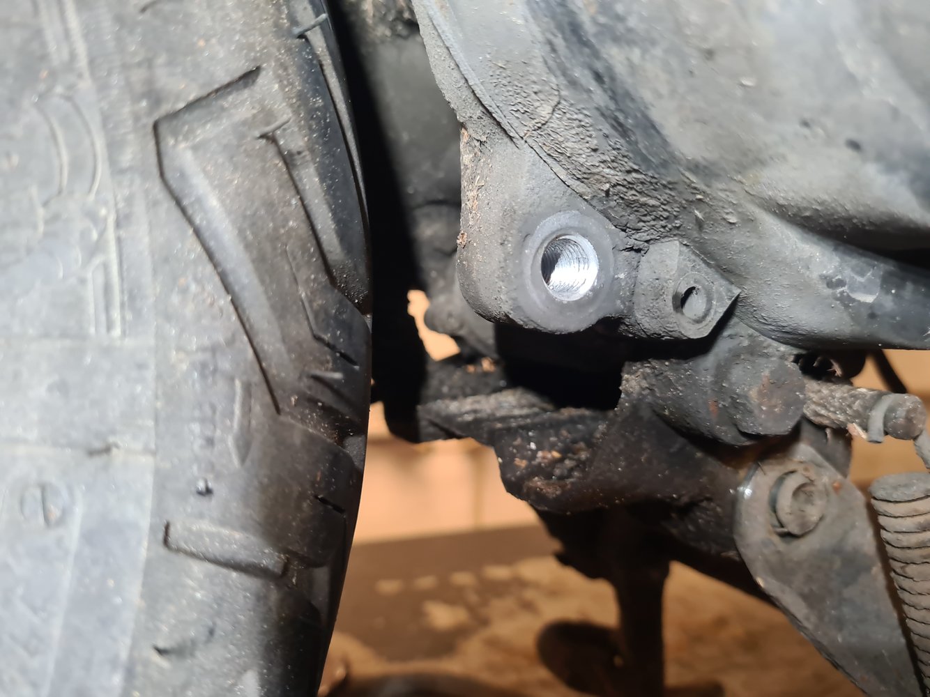

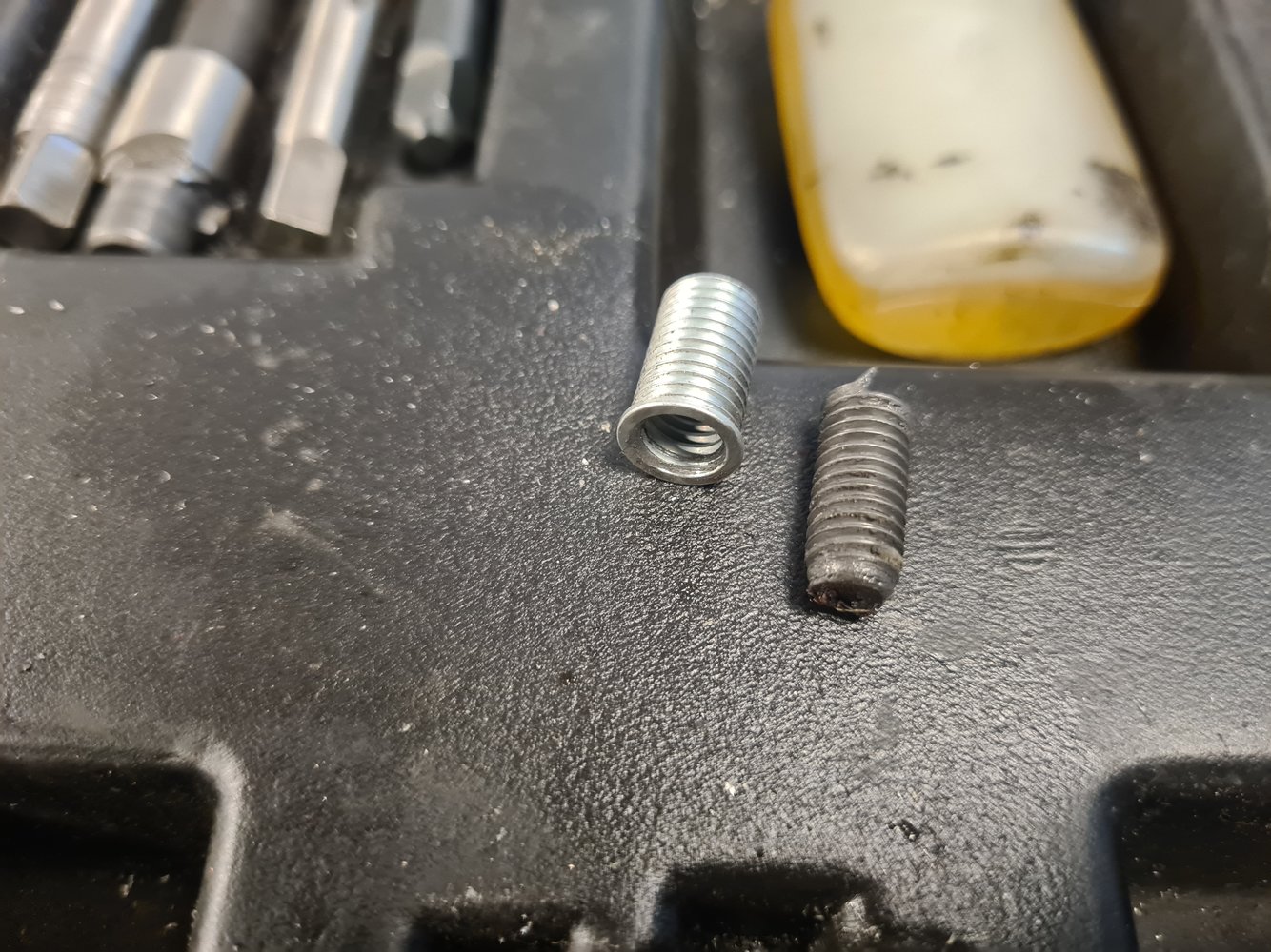

I like that insert idea , it looks much better than the old helicoils . I take it that the OD of the insert & insert tapping drill bit are in their own sizes and thread anglesShowed my lad how to repair threads in aluminium on Saturday, someone had bodged a nut on back of stripped out engine casing.
Quite satisfying really, Wurth Timesert. Expensive outlay for the kit but worth every penny.

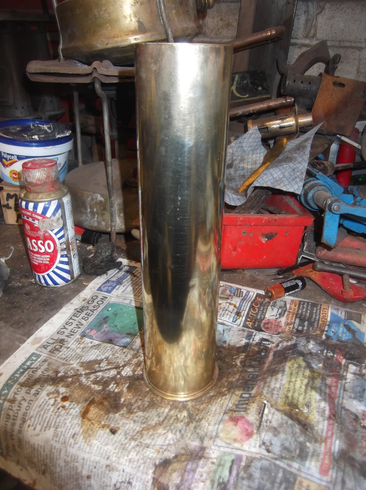

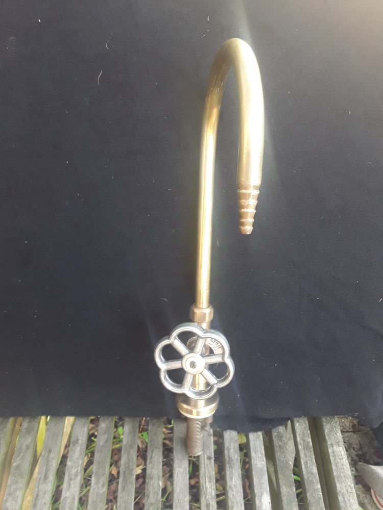

Upcycled a horrible old powder-coated laboratory tap into a " genuine vintage polished brass industrial look luxury boat tap"
Thank god for the Norton Rapid wood stripping disk, makes recycling any painted metal easy peasy.View attachment 372334
