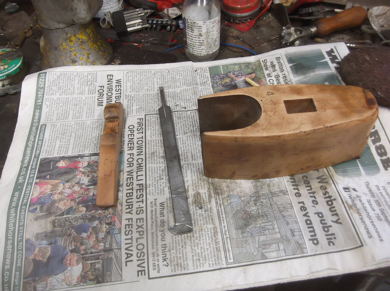

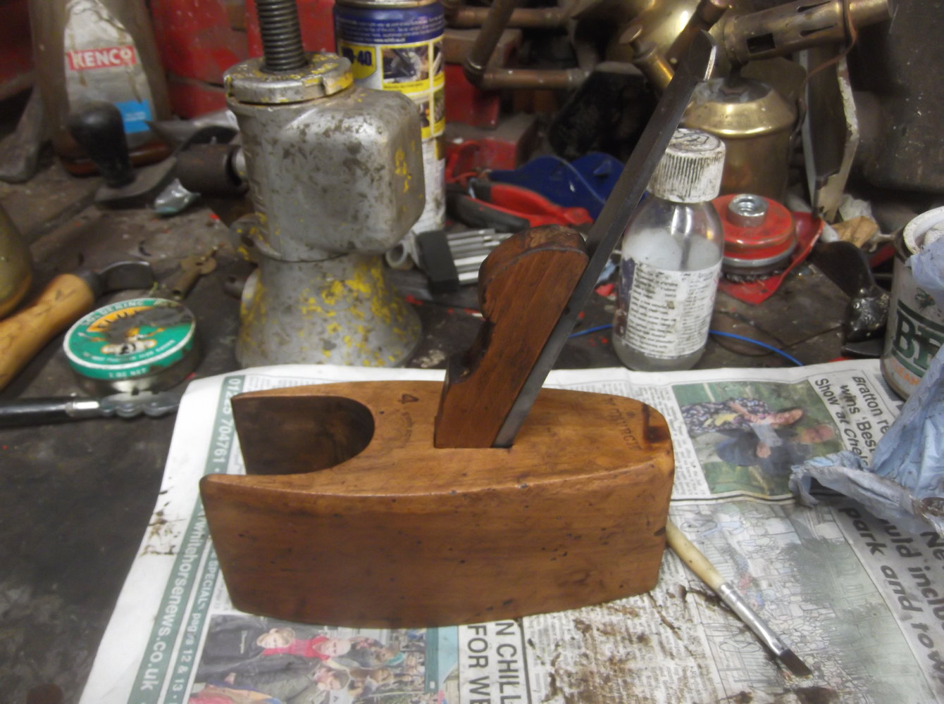

How do you get the old one out and new one in place? Glue/resin??Another easy fix. How many people woukd chuck this away and buy new?
£1.49 spent at Toolstation, 5 minutes extracting the broken piece, job done!
View attachment 388917View attachment 388918
Ah - I was looking on my phone and couldn’t see the threadIt's screwed in. Grip the handle in a vice and with a very small cold chisel and ball pein hammer, tap the old piece tangentially to shift it. After one turn it wash free enough to unscrew by hand.

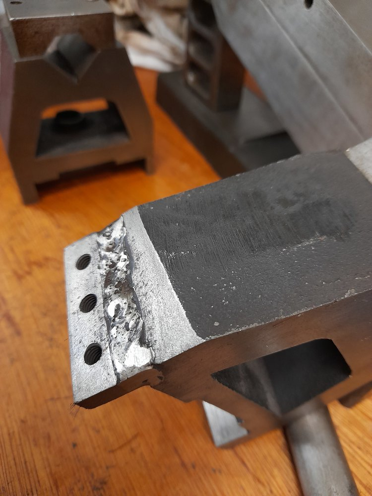

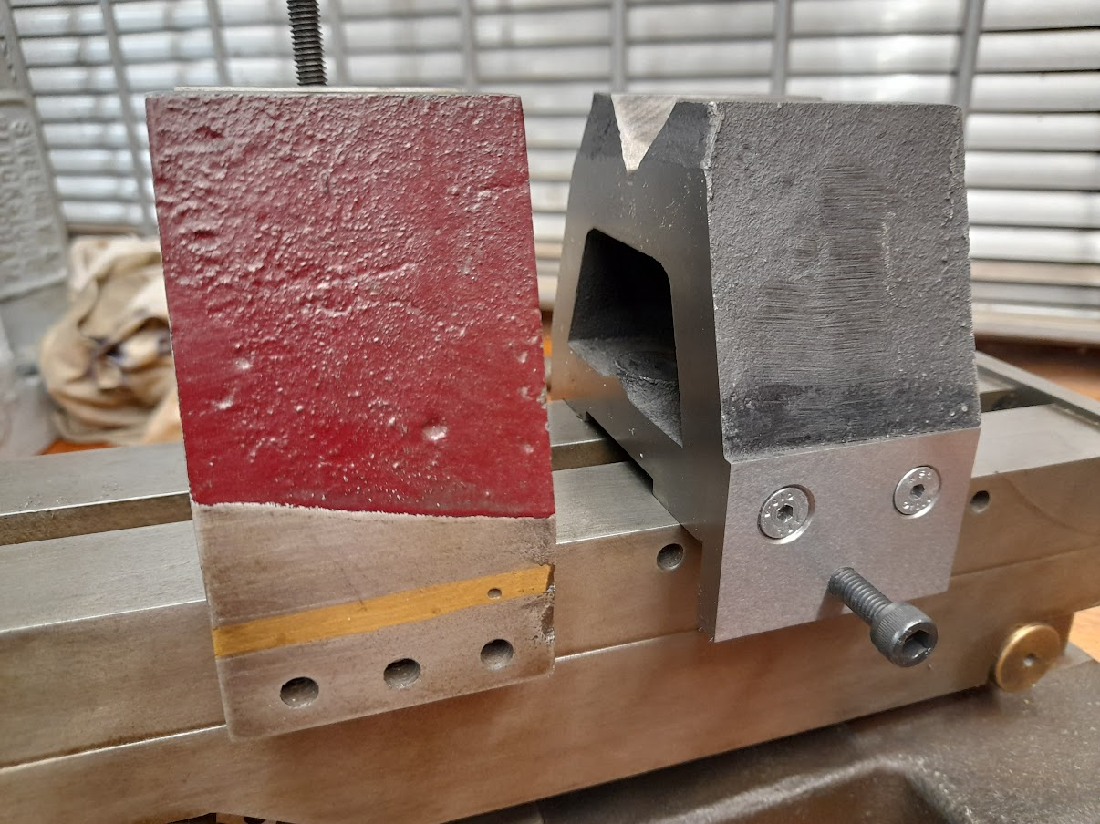

how did you manage to not melt the paintI recently acquired a between-centres sine table at a very good price. The castings on both movable supports have in the past been broken and repaired. Although it does not affect operation, I considered the weld repair hideous and deserving of immediate repair. I'll probably repeat the same repair to the other casting that has been brazed.
Here are the before and after photos:
The brazed repair wasn't mine. I did the other one with the two countersunk socket screws.how did you manage to not melt the paint
