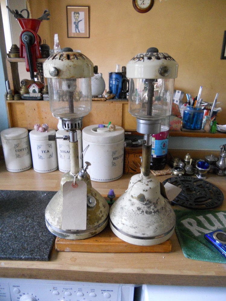

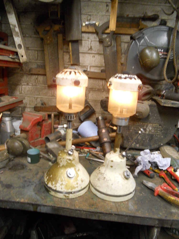

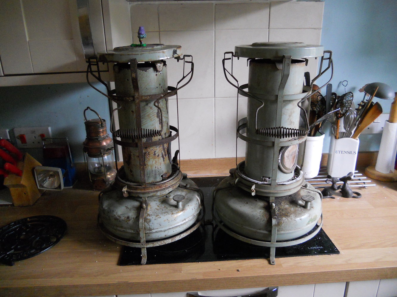

A nice pair of Bialaddin Pressure lamps was acquired by me.
Both needed some attention.

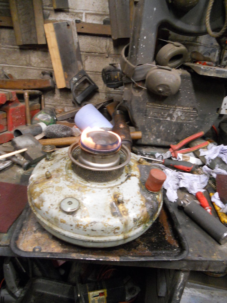

The test light showed a few issues.
Leaks from the seals and a pump not working.

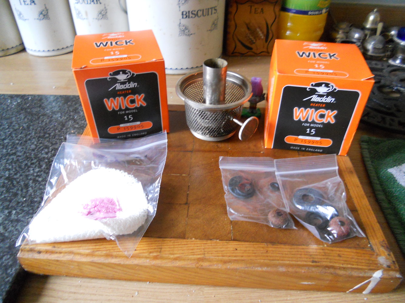

Spares ordered.

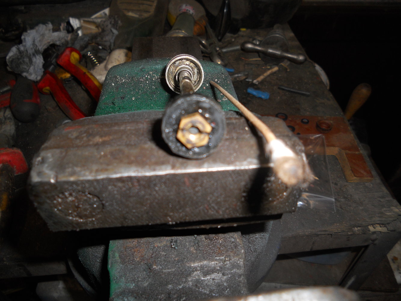

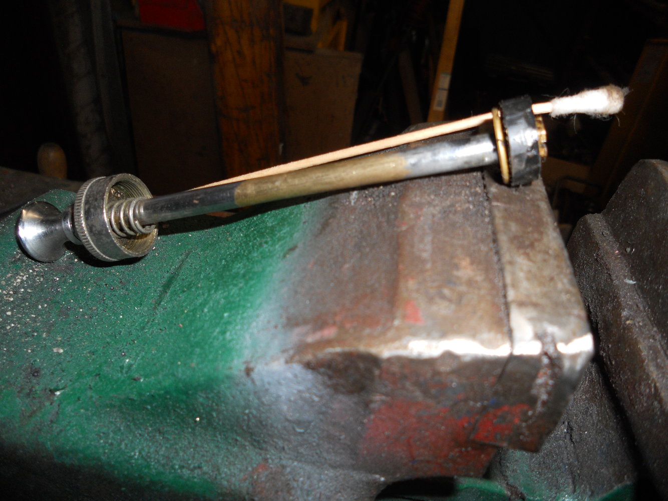

Oh that is why the pump does not work.
That is because it is a lump of butchered rubber.

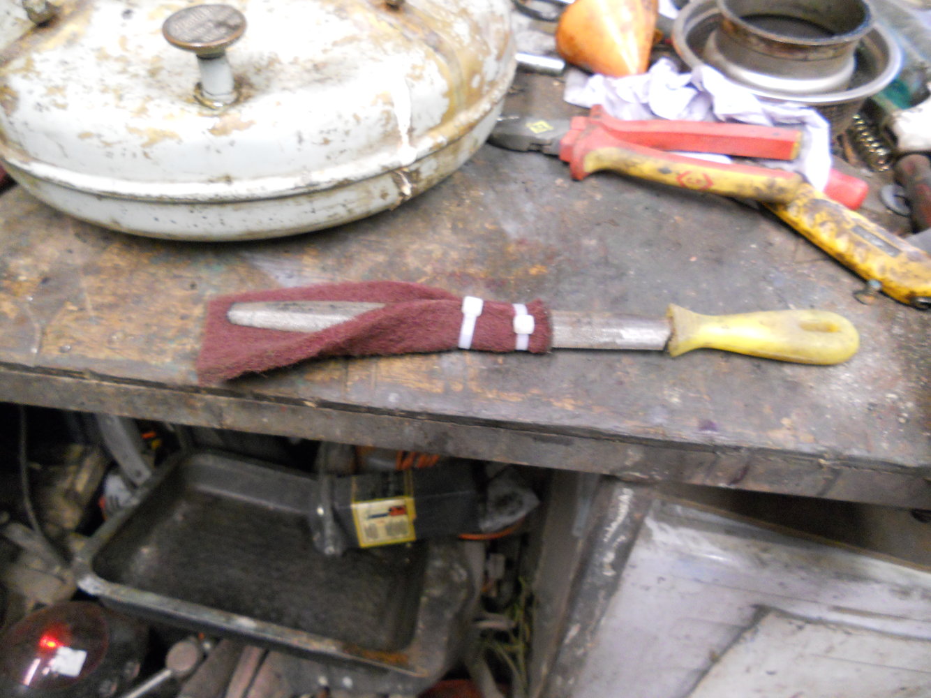

On the cotton bud you can see the dirt and metal that was common to both lamps.
This is not meant to happen.

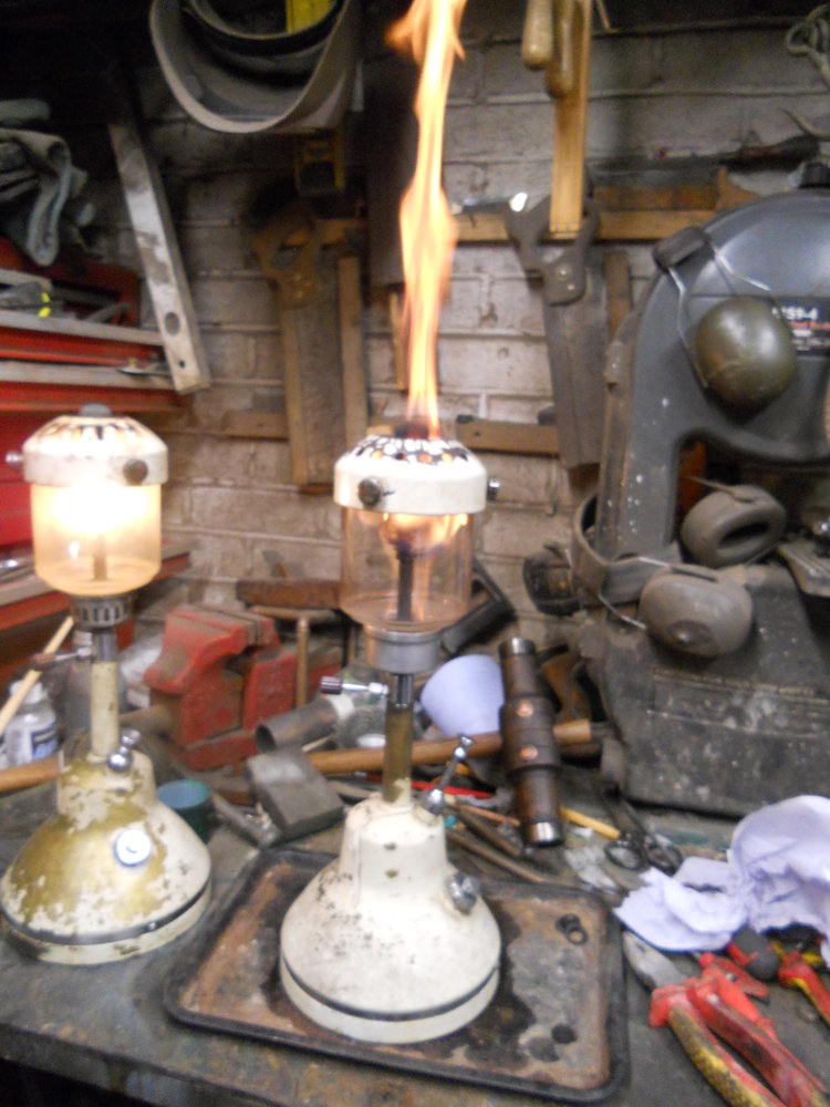

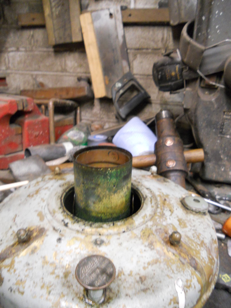

It was stripped down again, rebuilt and tested.
